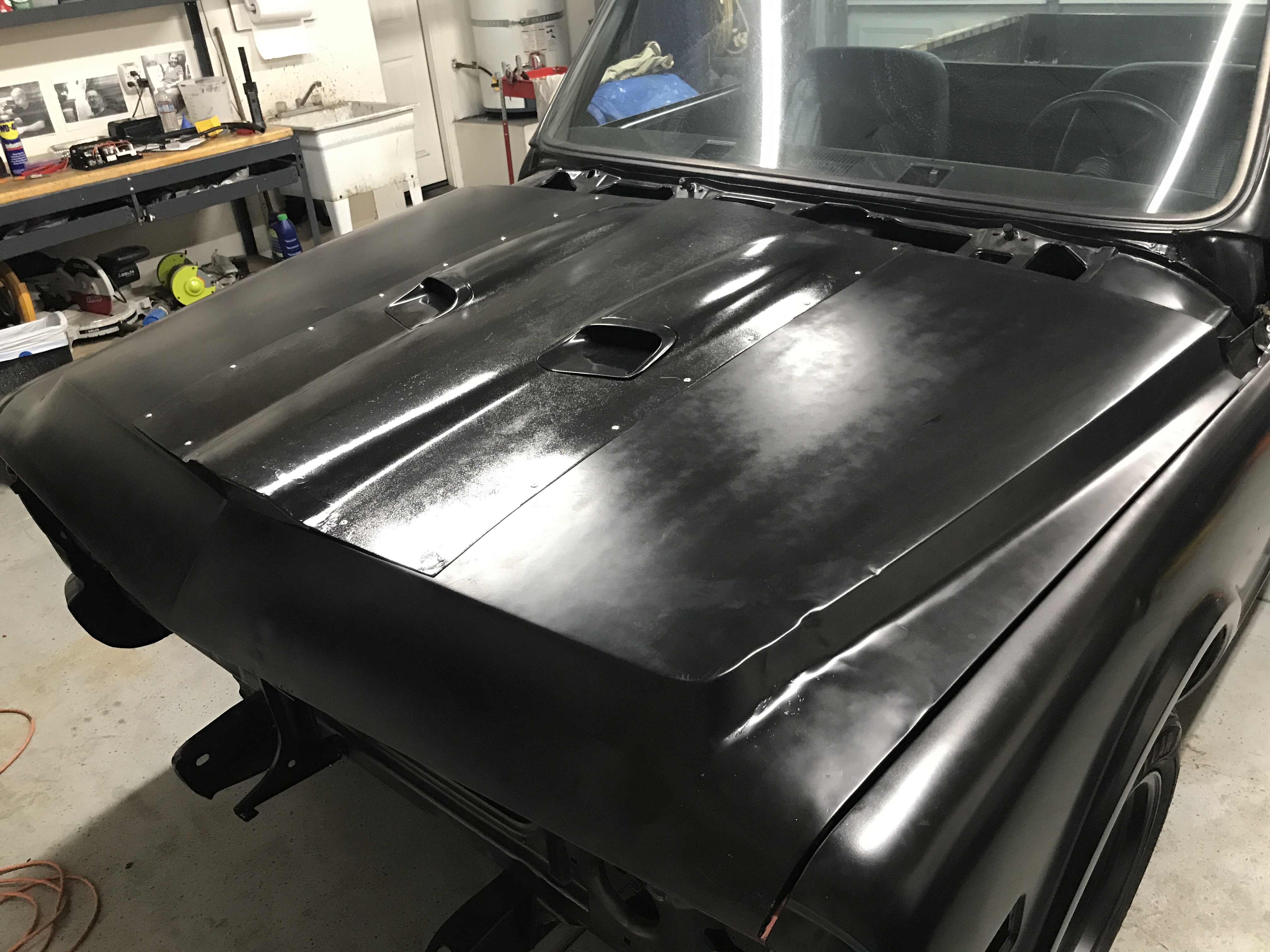

two bit coin to the first person to tell me what hood these nostrils came from

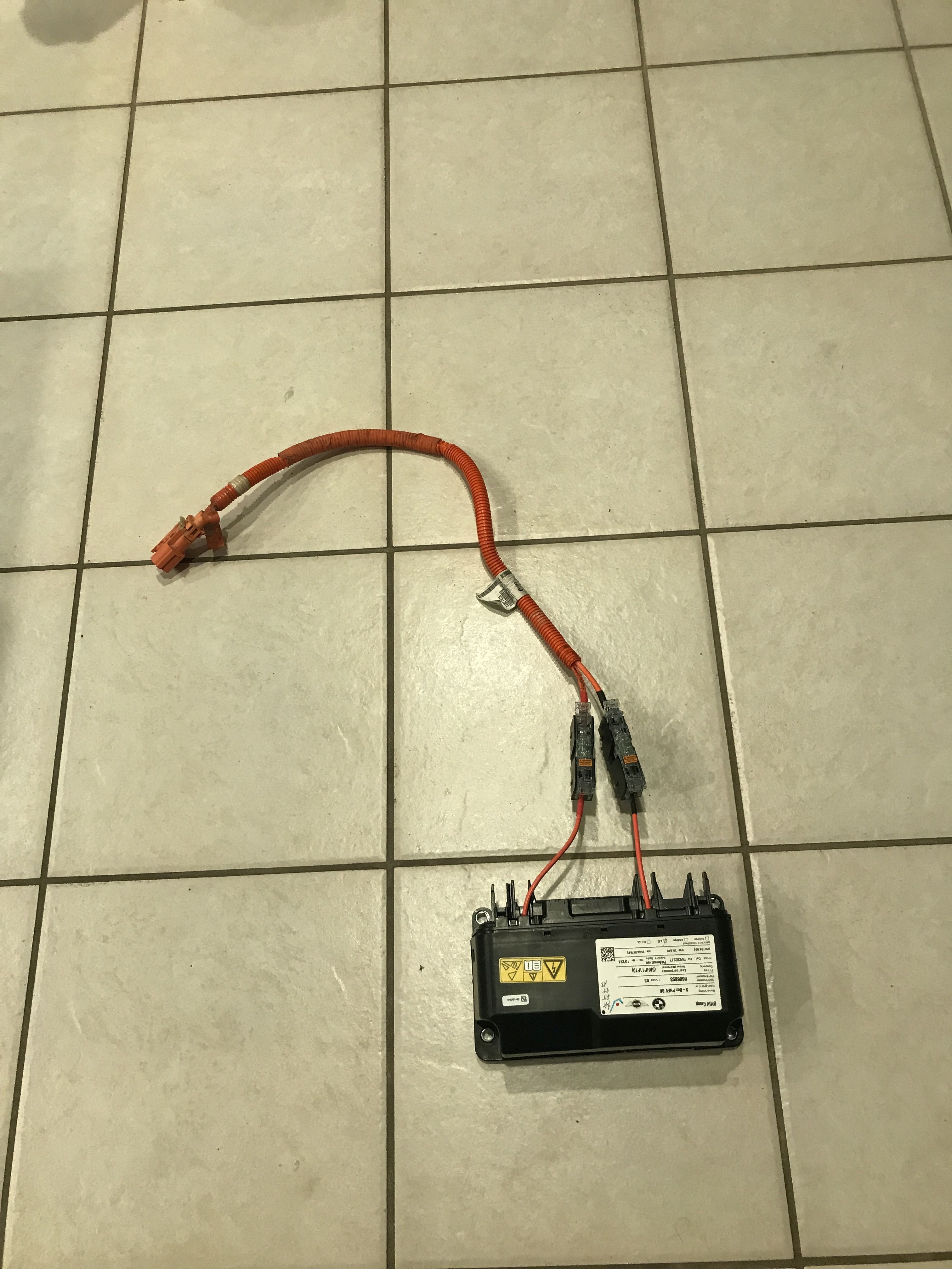

so the plan is to remake the DC-DC HV cable that runs to the BMW Safety Box in the air conditioned house and wait till the temps drop below 40°your degrees and then get back out there, and see if we can pull her out of the garage under her own power and drive her back in point A to point B straight line baby, cause last night it was still 35°C at 10:00 PM outside
only reason I am fusing both sides the negative as well as the positive leads is to use them fuse blocks as junction blocks so I can send the thinner wire through the existing holes in the BMW Safety Box (this is a bit more cleaner and improved design than my prior one where I drilled small holes in that flimsy S-box lid and went in from the sides)

just a high tech truck with a low tech hood (bonnet) brace
all wired up except for the Chevy Volt onboard charger, I just didn't have the [ahem] energy to deal with it this month, so we will run on whatever charge the battery pack has in her (per SimpBMS "Lite" 347 volts = 50%)
the inner fenders still need to be installed, we left them off just in case we need access to what ever signals it needs accessing during the test drive type of thing
not sure why that dual fuse block insists on flipping over like that, it was fine and right side up on the work bench !

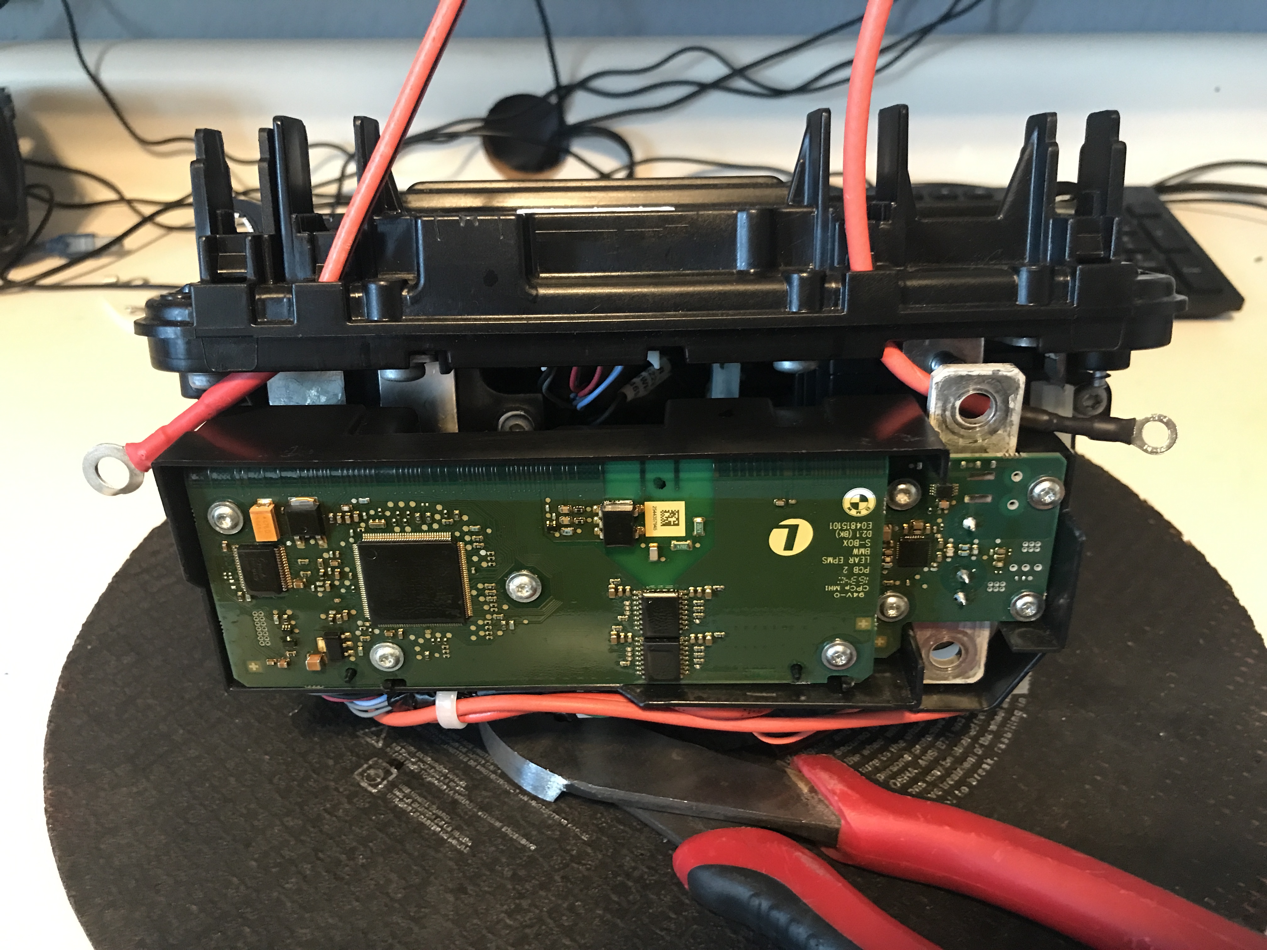

happy to report that with the help of our honorary forum member Patrick I automated Damien's BMW Safety Box code so that the VCU pre charges the Inverter and if the bus voltage reading is above 300 volts closes both the (negative and positive contactors) this eliminates the need for a laptop directly connected via the USB umbilical to the VCU

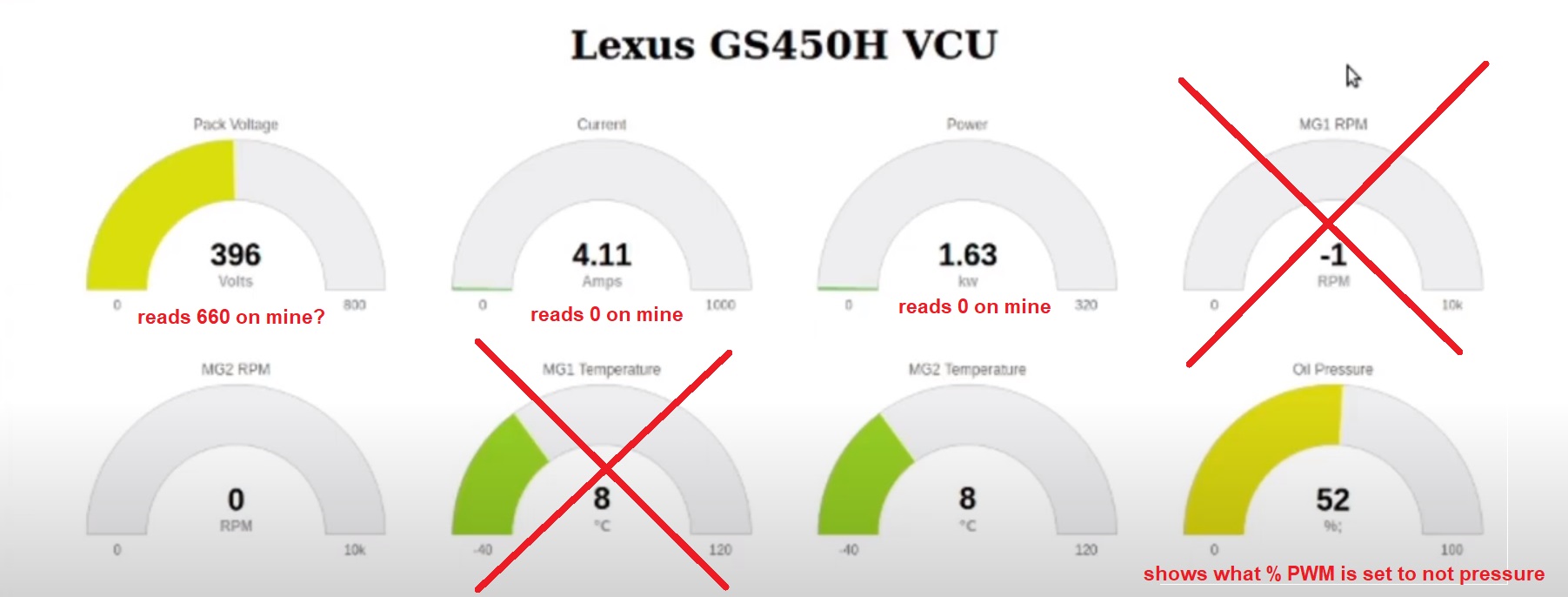

Post by Gregski »
this is what the default digital gauges look like and what mine read, I suspect Amps are not working because I am not using the ISA shunt but the OEM one in the BMW Safety Box, so I will be looking at that code next, as it will obviously fix the Kws as well
also since I did not lock the input shaft, and set MG1 torque to 0, MG1 is not spinning the rear wheels, that's why I just crossed out it's RPM and Temp gauges
and this is how I dumbed them down, and what Josh in the passenger seat was trying to show us on the laptop
