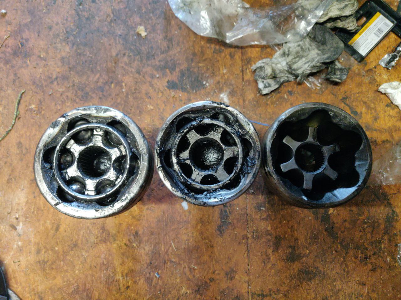

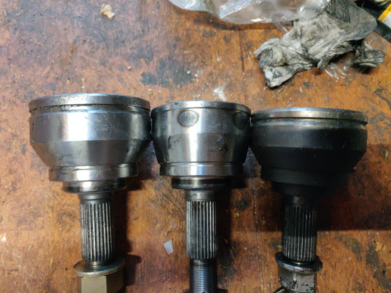

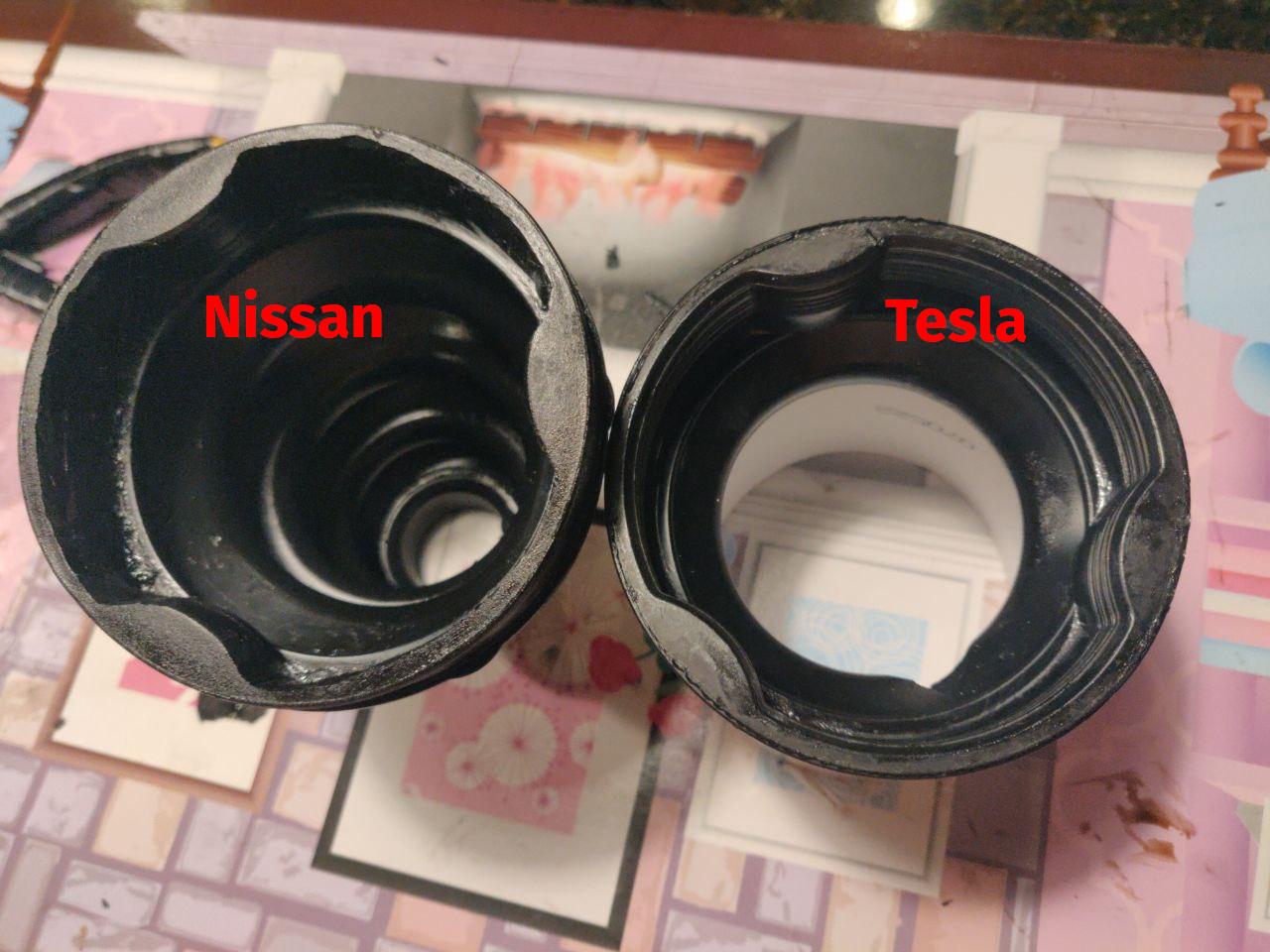

This CV axle thing is getting annoying. nothing I buy matches the original one.
the star size and spline numbers is different on all 3.
Next I need to either go to the dealershipp and spen $300 if they match and the dealership is not doing the same thing, or go and find CV axles from old cars.

Idea maybe (trying to help you):
Do you know / have the original axle diameter? Maybe the diameter is also different but the diameter is easy to measure by the sellers so you can compare.
Yes the splines are not 1:1 related to it i know; but it could be that its an indicator to know which axle you have/need.
Since your tesla axle is made custom maybe you can find the Nissan donor part somewhere and measure it up.

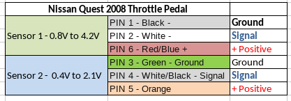

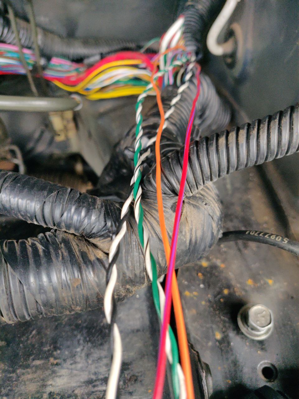

I just opened the harness and there are 2 twisted pairs. is that supposed to mean something. are the standalone wires the 5V+ ?crasbe wrote: ↑Mon Jul 17, 2023 10:05 am The Service Manual includes a schematic, I found one online (without registration bullshit) for a 2016 model: https://procarmanuals.com/pdf-online-ni ... ce-manual/
As usual, the Nissan manual is quite outstanding, here are some screenshots, which are relevant for you:
(Page 1819)
Black and White are twisted together.
Green and White/Black are twisted together.
Orange and Red/Blue are standalone.

Do you still have the ECU in the car? Then you could just measure it?

I used a volt meter inline with a power supply and it seems that they are paired:
1-2-5 Black - White - Orange
3-4-6 Green - White/Black - Red/Blue
At this this point I am suspecting
Orange and Red/Blue as 5V+
Black and Green as GROUND
White and White/Black as signals
On the first pair when I press the acceleration on the White I get between 0.6v to 2.5V
and
2nd pair when I press the acceleration I get on the White/Black wire between 0.7v and 4.6V
Which voltage is better?
Update:
Went with the 2nd pair. Still need to test it.

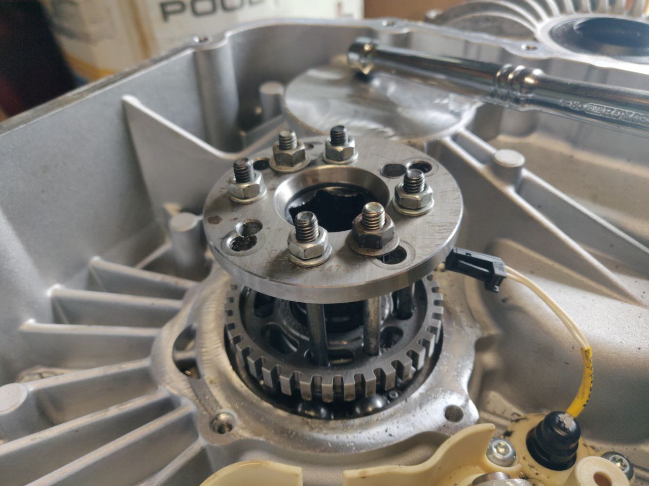

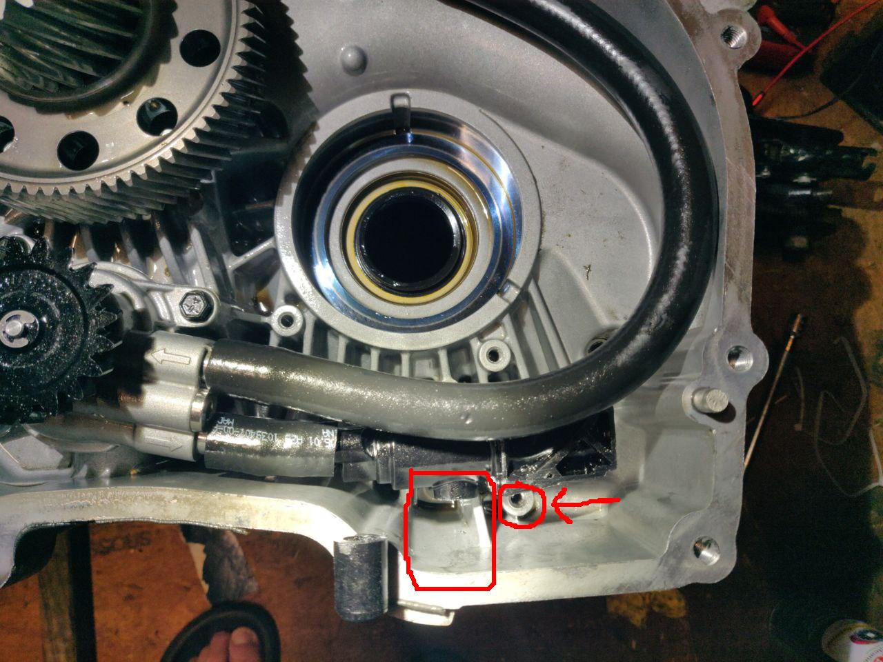

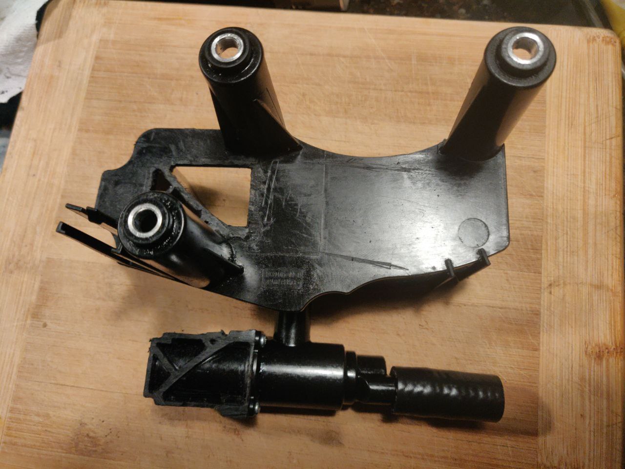

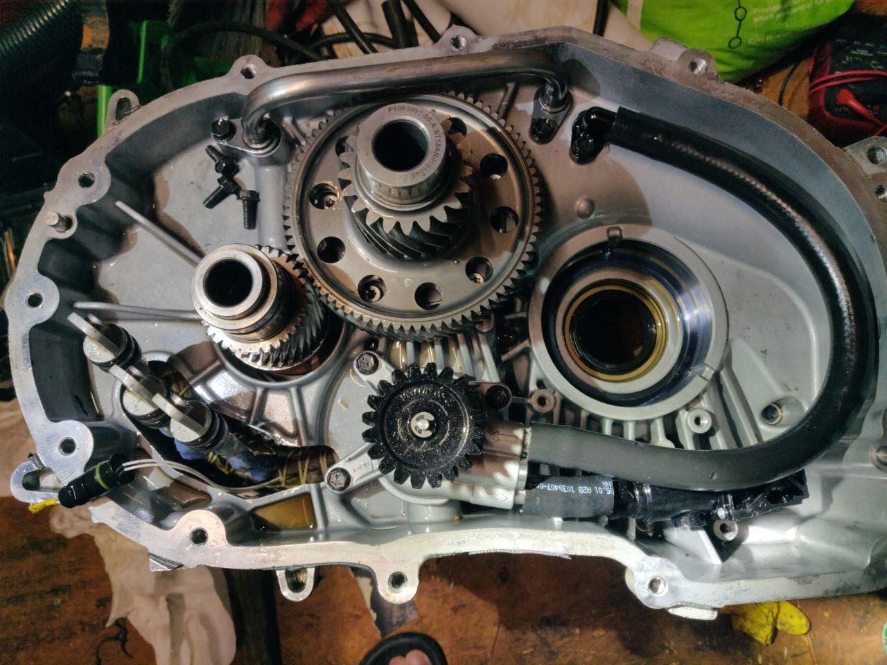

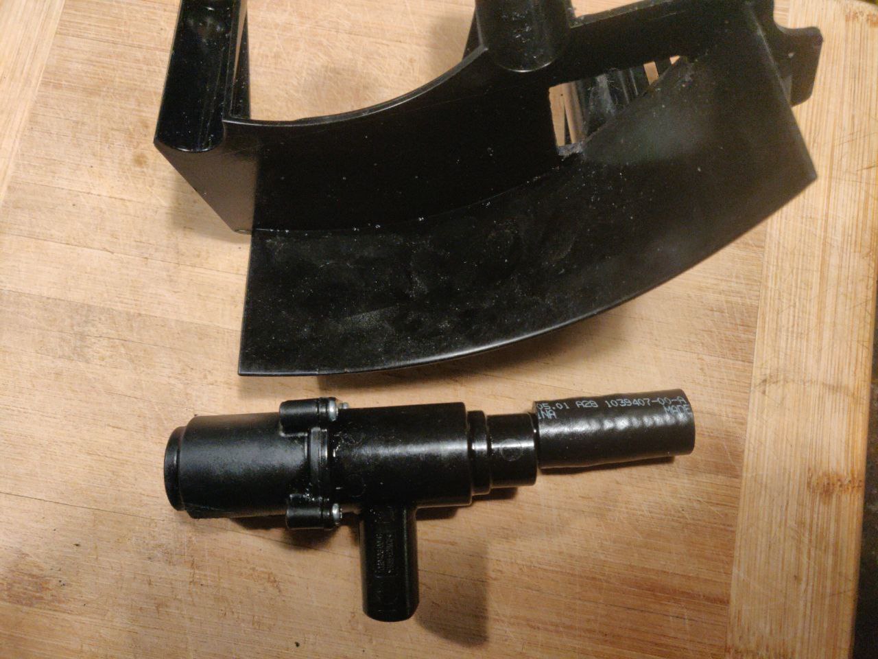

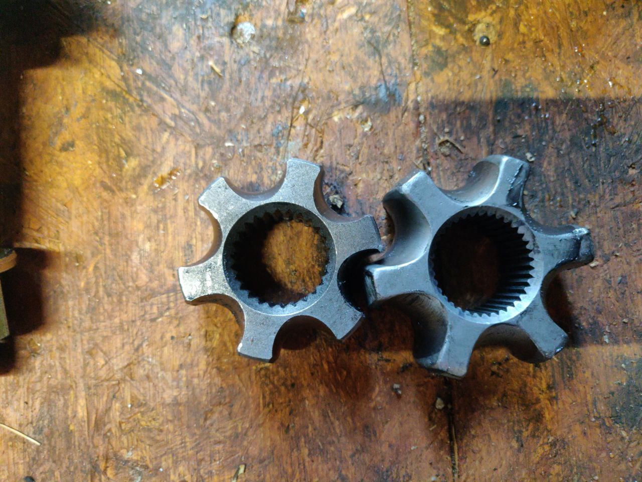

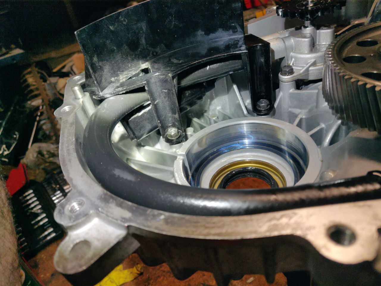

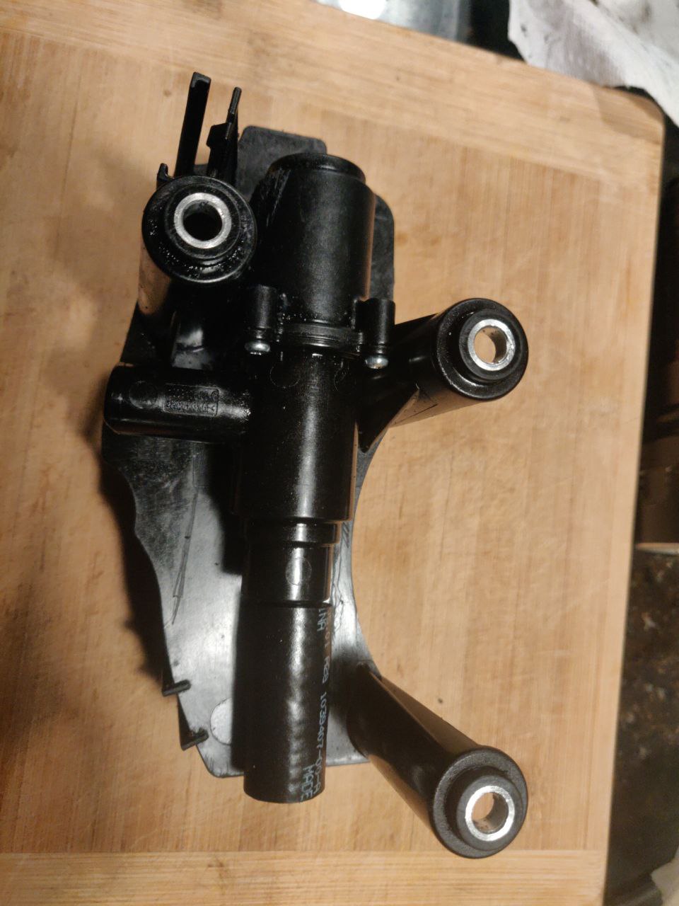

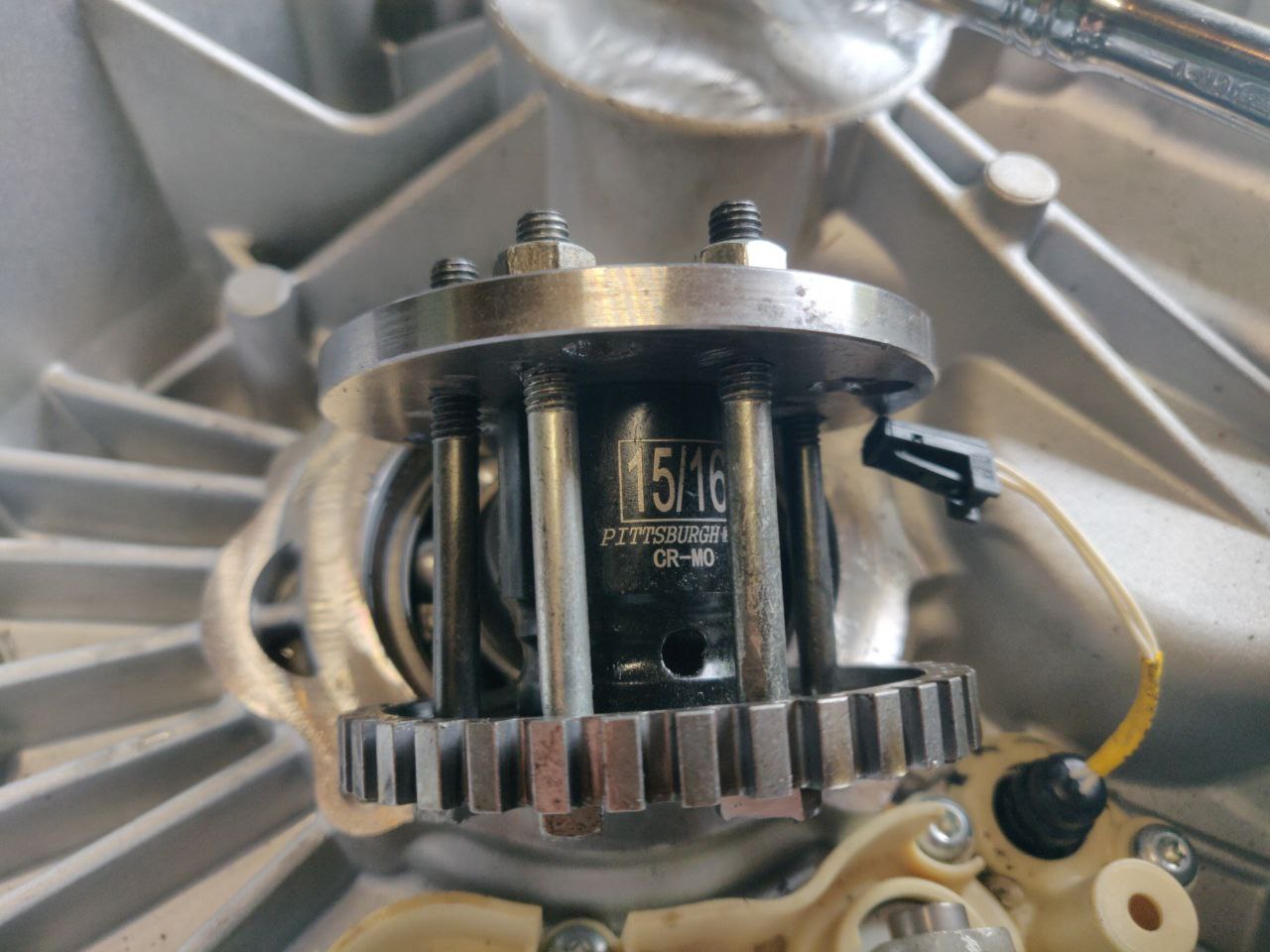

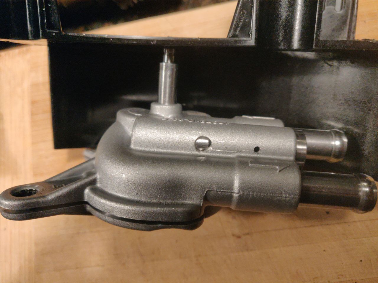

I decided to use the existing oil filter housing instead of machining something new.
I think I still need to work on the oil pump based on this thread.. viewtopic.php?p=38369#p38369
But I cannot figure out from pictures exactly what modifications were made to the pressure relief valve inside.
- Proton
- Posts: 325
- Location: Georgia/US
- Has thanked: 190 times
- Been thanked: 49 times

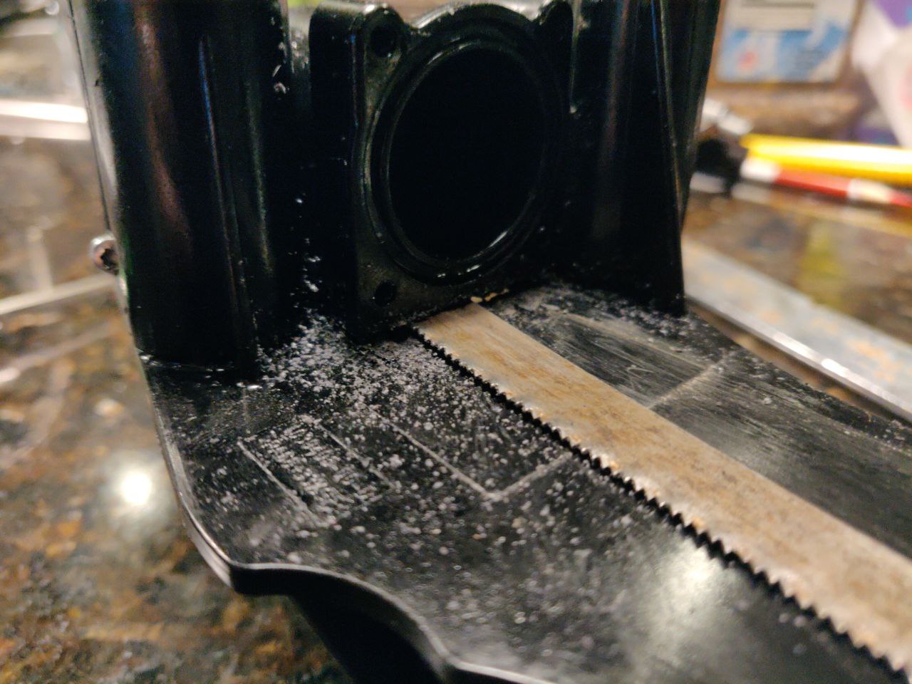

I am done modifying the Oil pump and it works in reverse.
It can be done using the original filter.
The only mistake was to cut the intake. I cannot move the original intake lower because of the cover support. Pretty much the back of the oil pump sits in the same position, but lower and it is connected to the original exit.

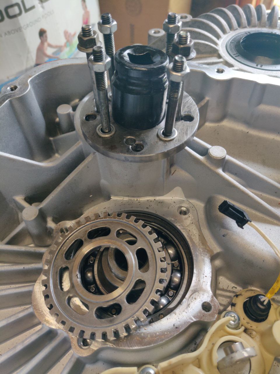

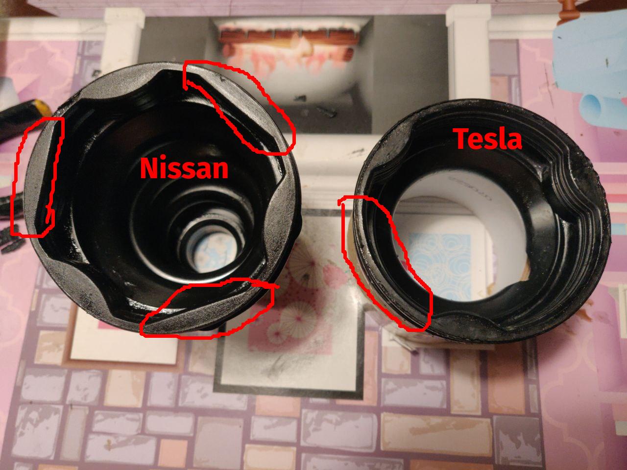

The CV axles do not want to give me a break. I installed the motor back in the car and I destroyed one of the Tesla CV bots and now I can't find one to buy. For now I modified with a cutter one of the old Nissan inner boots and will test that next few days.
if anyone knows where to buy a Tesla Inner cv axle boot please let me know.

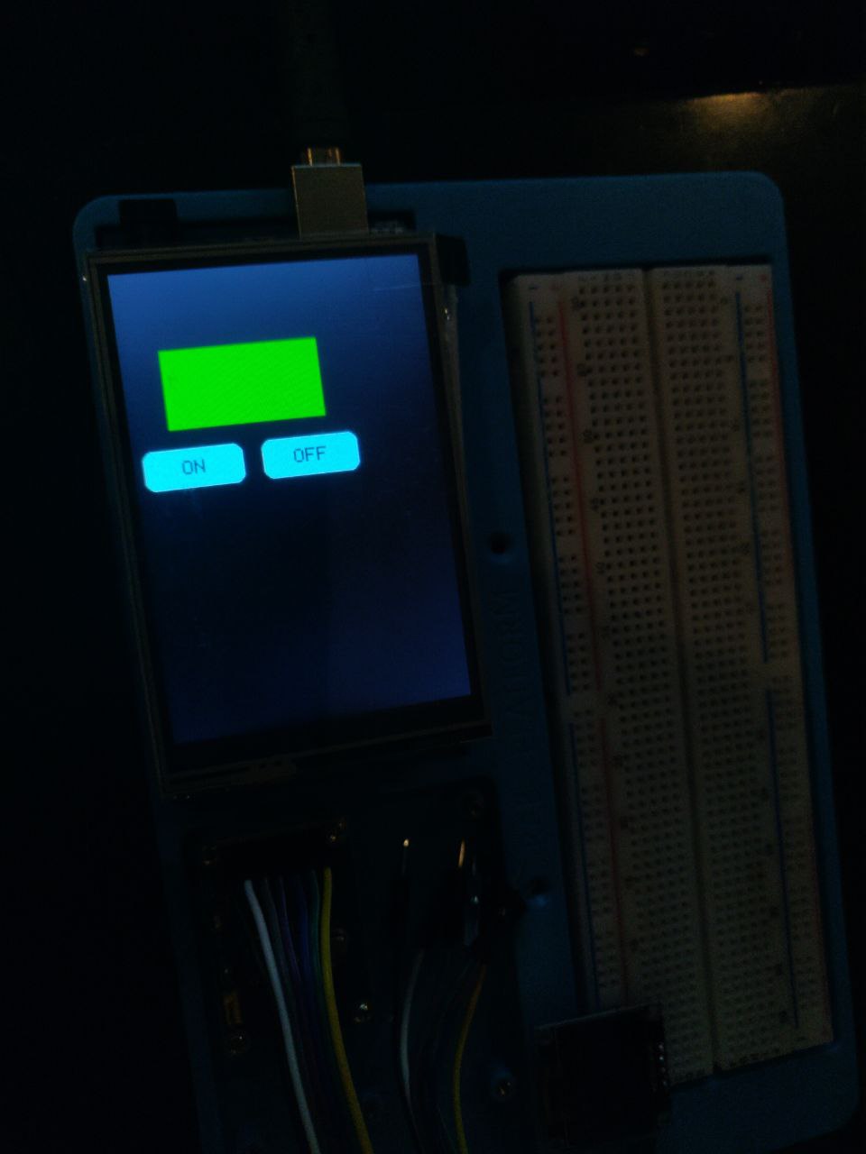

Only progress was to learn how to install some libraries in Arduino and test the screen.
- EV_Builder
- Posts: 1205
- Location: The Netherlands
- Been thanked: 37 times
Send mail to the custom shaft producers they sure know.
There is also a brand on autodoc for driveshafts they sell the boot too If memory serves me right.

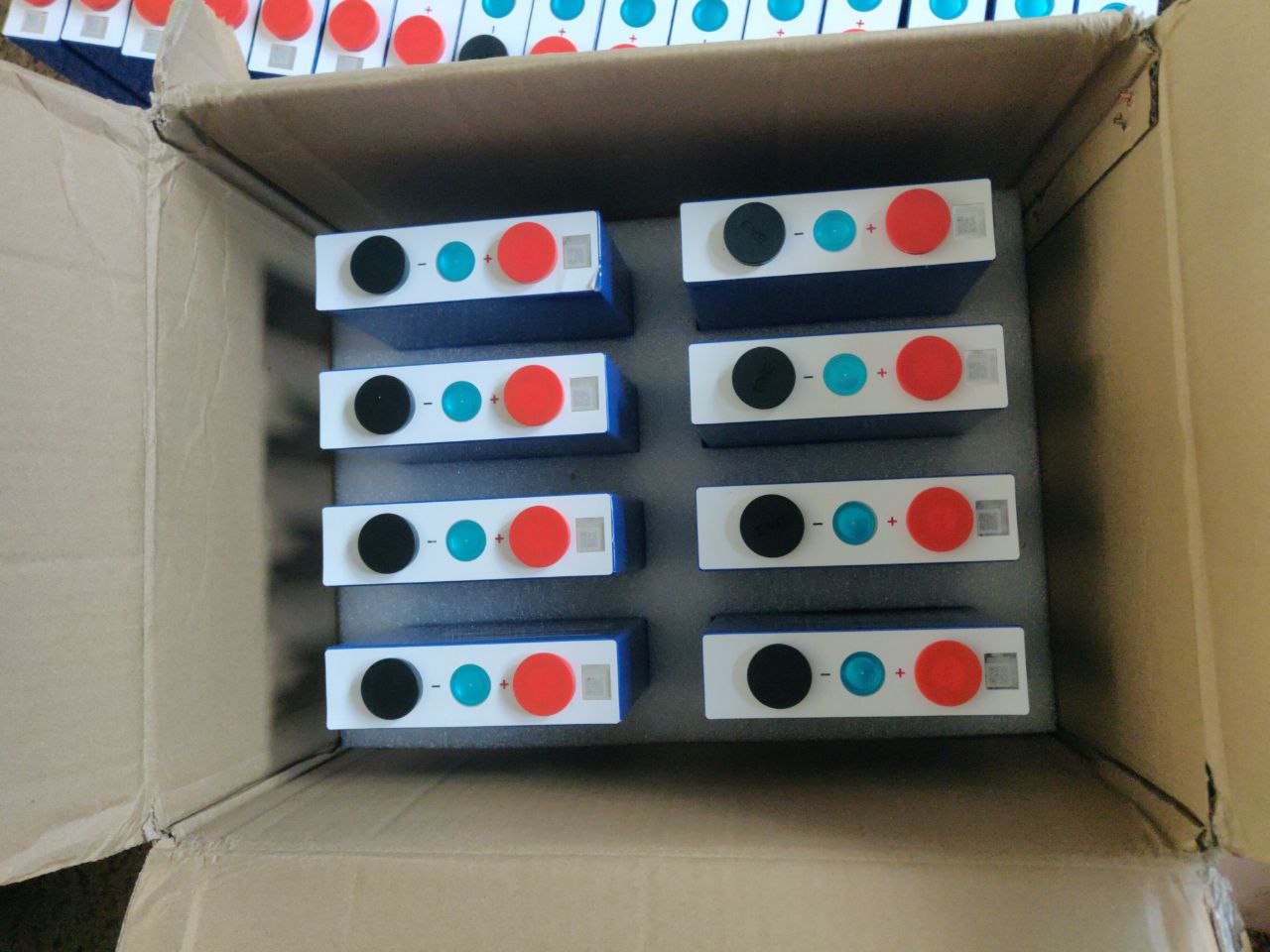

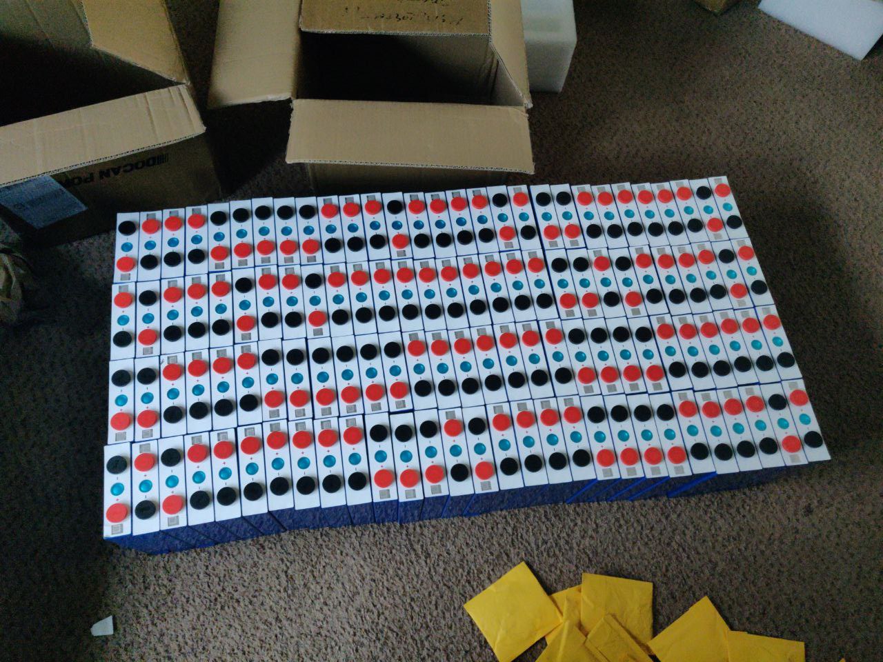

Got the batteries from China.
I went for 105AH. If I need they ca do 3C discharge rate for 60 seconds. around 220kg if I remember correctly. I should be able to have 120 mile range.
If I need to change them for more amps, I can use them in my solar system, or convert one of the Toyota Prius cars have.
This is 39KW. I bought 116. can use 4 for a 12v battery.

Open inverter BMS. I have one BMS for now and trying to learn some canbus.
For batteries I have 116. planing to use 112s for the car and 4 of them for a 12v battery .
112 / 16 = 7 BMS-es
112 / 16 = 7 BMS-es

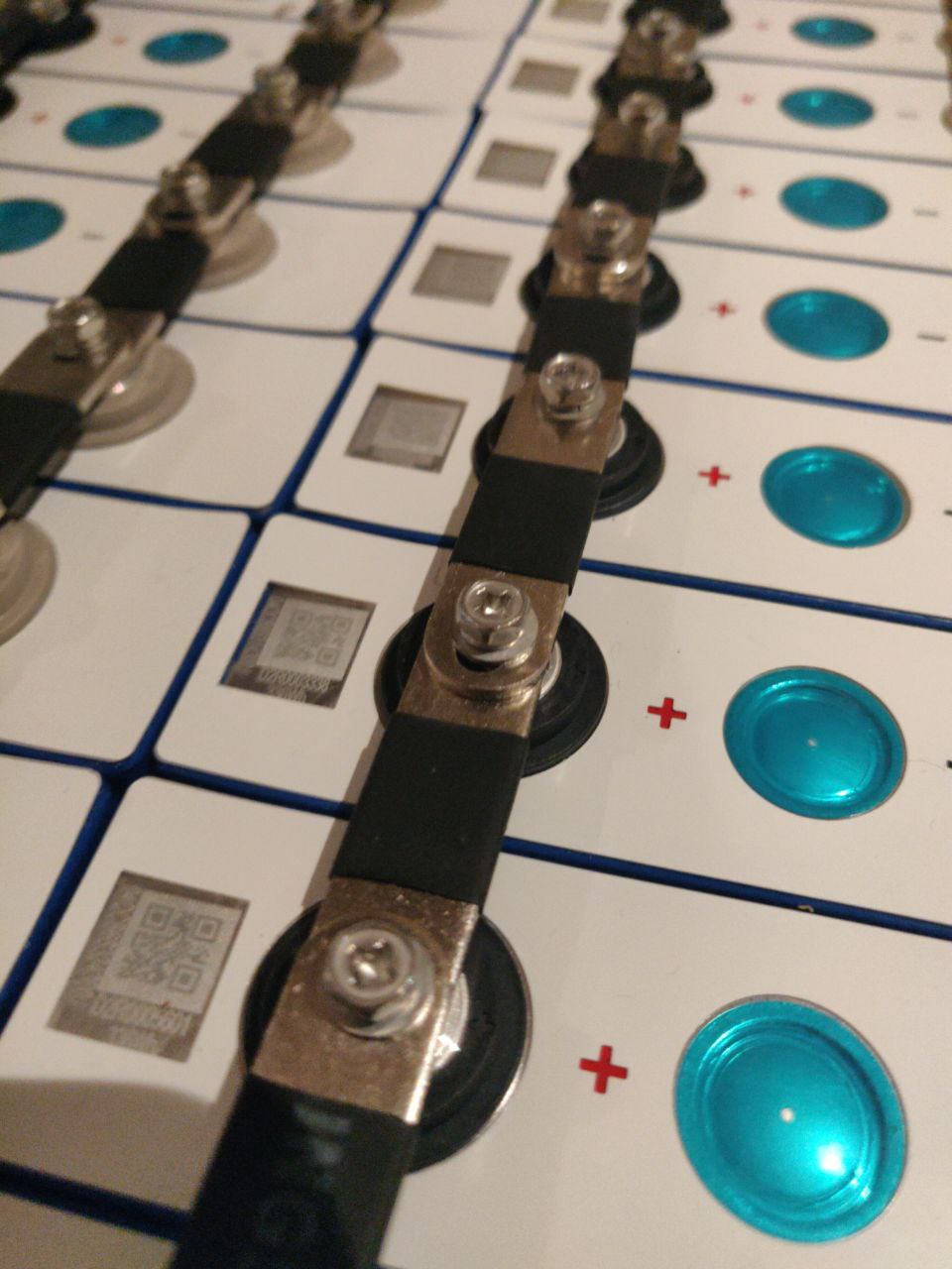

The only thing I do not like is the bolts that hold the buss bars; they are M3. (Not good) The bus bars are 1.5mm x 12 mm wide. The batteries I currently have in my solar system have M10 bolts. That is a big difference. So this batteries will probably end up in my solar system in the future.
Those are the batteries I was thinking about getting for my Nissan D21. Do you still think they are worth it for a starter battery pack in my project, or should I look for batteries with better bus bar bolts?
- Proton
- Posts: 325
They will work but the 160Ah have M6 bolt which is more sturdier.
For these batteries I have to make a box the keep them in place and does not let them move around to loosen the bus-bars. I have an infrared camera I I will monitor the bus-bars to make sure they do not get lose and heat up.
