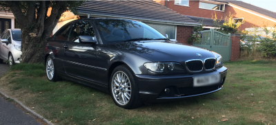

Time to introduce my project car, a 2005 BMW E46 Coupe
It's had one careful owner and 9 not so much who have done 125000 miles in it. Most of the oil and water is on the outside of the engine. It runs on petrol, but sounds like a diesel some of the time, but not to worry about any of this.

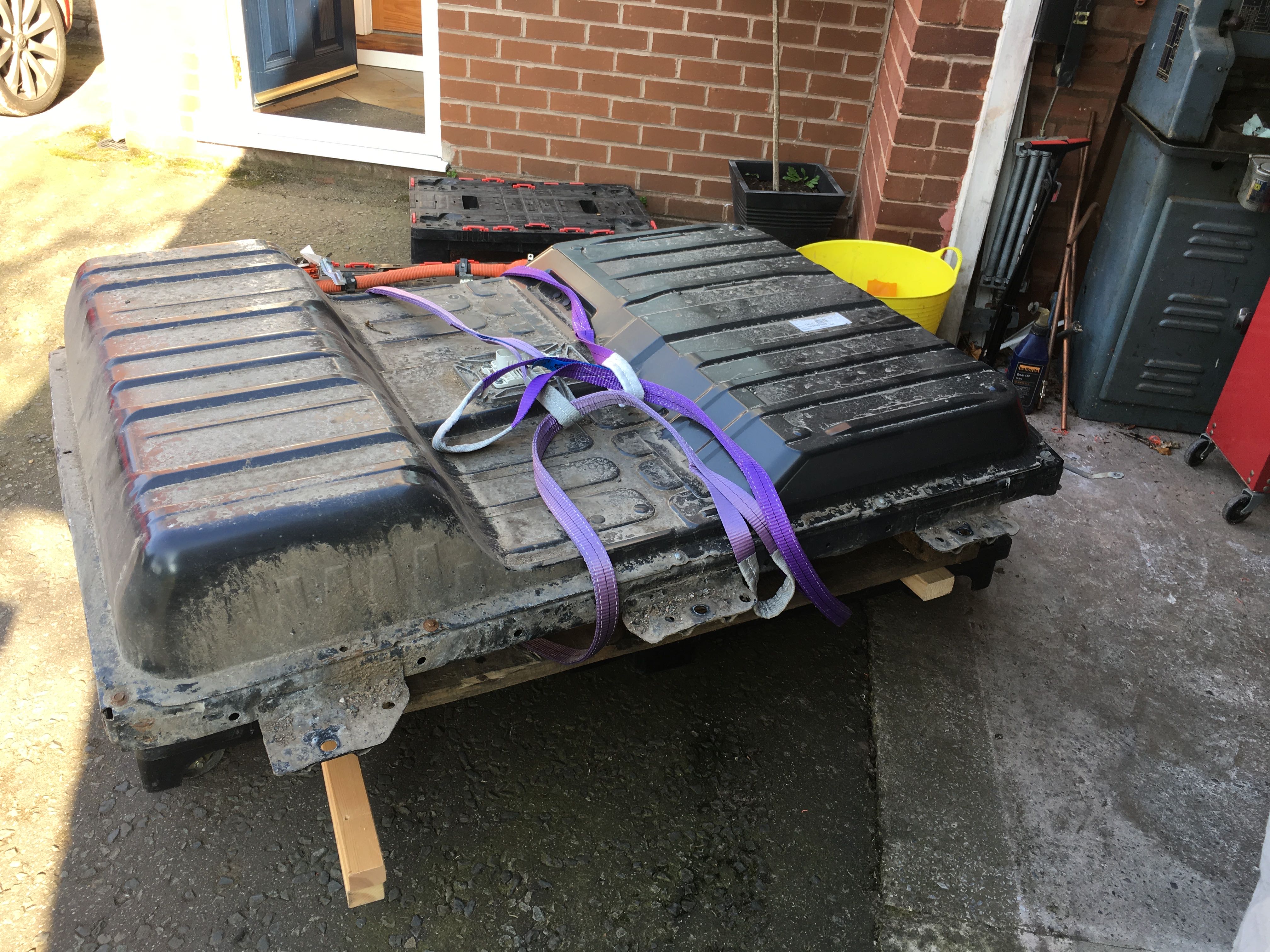

Battery's arrived. 30kWh Nissan Leaf. Will probably do some reverse engineering of the Canbus while I'm here.

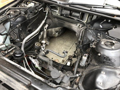

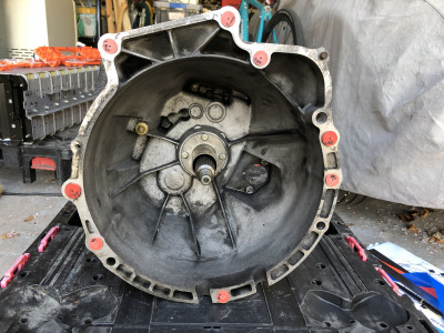

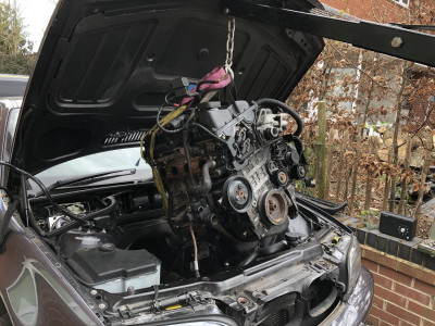

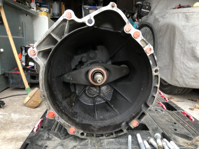

Not wanting to be outdone by Mr Bauer, I finally got the engine and gearbox out of my E46 coupe.
Here's the engine coming out and the hole that's left over:
I started thinking about how to measure the flange on the gearbox. I decided to make some plugs with a small hole in the centre to measure to. Here's the gearbox with its protective layer of oil. No wonder the clutch juddered!
Here's the same gearbox cleaned up:
Next up, get the motor mounted up and get the inverter sorted!

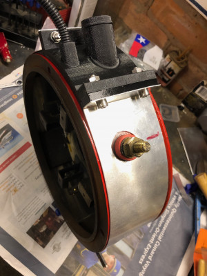

My conversion is DC, and one of the problems was the air vents on the motor which need blanking off and ducting away from any direct water and dirt.
After a bit of cowboy modelling on Fusion 360, I came up with this duct which fits quite nicely with some bent and rolled aluminium plate. After a few hours on the 3D printer:
The corrugated tube is for wiring for a couple of temperature sensors.
The duct for the other end is on the printer now.........

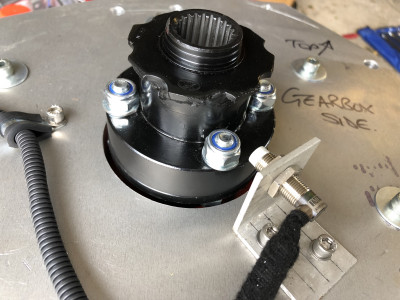

Had a couple of good days on the E46. Got the coupler sorted out and the proximity sensor to measure RPM:
and got the motoring gearbox back in:

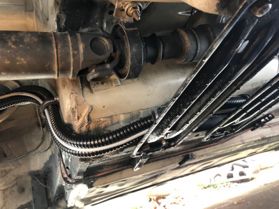

Been a little while since my last update, but made a bit of progress.
Added some conduit under the car for the rear battery cables:
Got it back on 4 wheels and ran the E46 on a 12V battery and achieved 'First Roll'!

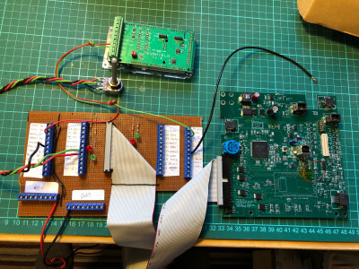

Meanwhile the PCBs turned up for the Prius based DC controller. After a bit of microscope action, I'm ready for a bit of testing:
Its a mash up of a couple of Damiens designs. The simple DC controller generates the PWM for the motor, the Arduino Due Sam 3X from the Tesla Gen 3 controller will be controlling the contactors and sending Can signals to the rest of the car and the board layout is from the Prius controller! There's also a space on there for either an ESP8266 module, or an ESP32 module which I'm thinking will be able to transmit using BlueTooth LE.
Once I've corrected a few errors, I'll post the circuit on Github for those who are interested.

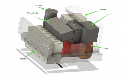

I think the next thing is to build up the HV Junction Box and where to fit it. Had to resort to a bit of CAD:
The slightly opaque parts represent the engine bay components.
Time to order some bits and hope the rain holds off for long enough to get the welder out!

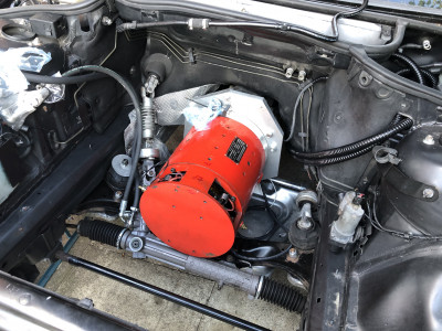

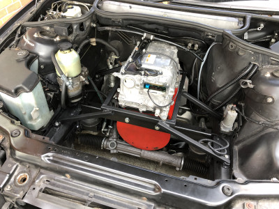

There are some days when you suddenly feel like you're making some progress and I have a couple of those this weekend!
Got the front motor mount sorted. Zafira PAS pump installed and running. No leaks!
And made a mounting frame for the inverter:
Decided to put all the batteries in the boot, no need to worry about waterproofing them in there. Next thing to build up is the HV contactor box. Have all the parts, just need to work out where to put them.

Its a mash up of a couple of Damiens designs. The simple DC controller generates the PWM for the motor, and the board layout is from the Prius controller
