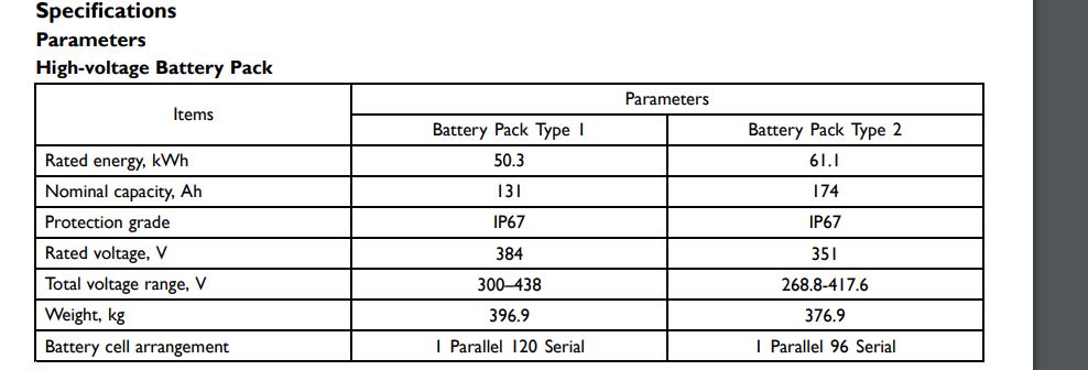

Hi, what do we know about the internals of these packs?Specs and configuration? Anybody has any details? 😊

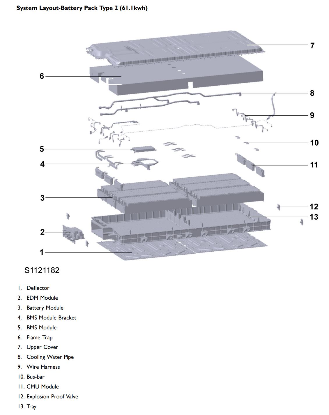

Battery module (battery pack—61.1kWh): consists of 6
modules, and each module contains 16 battery cells;
