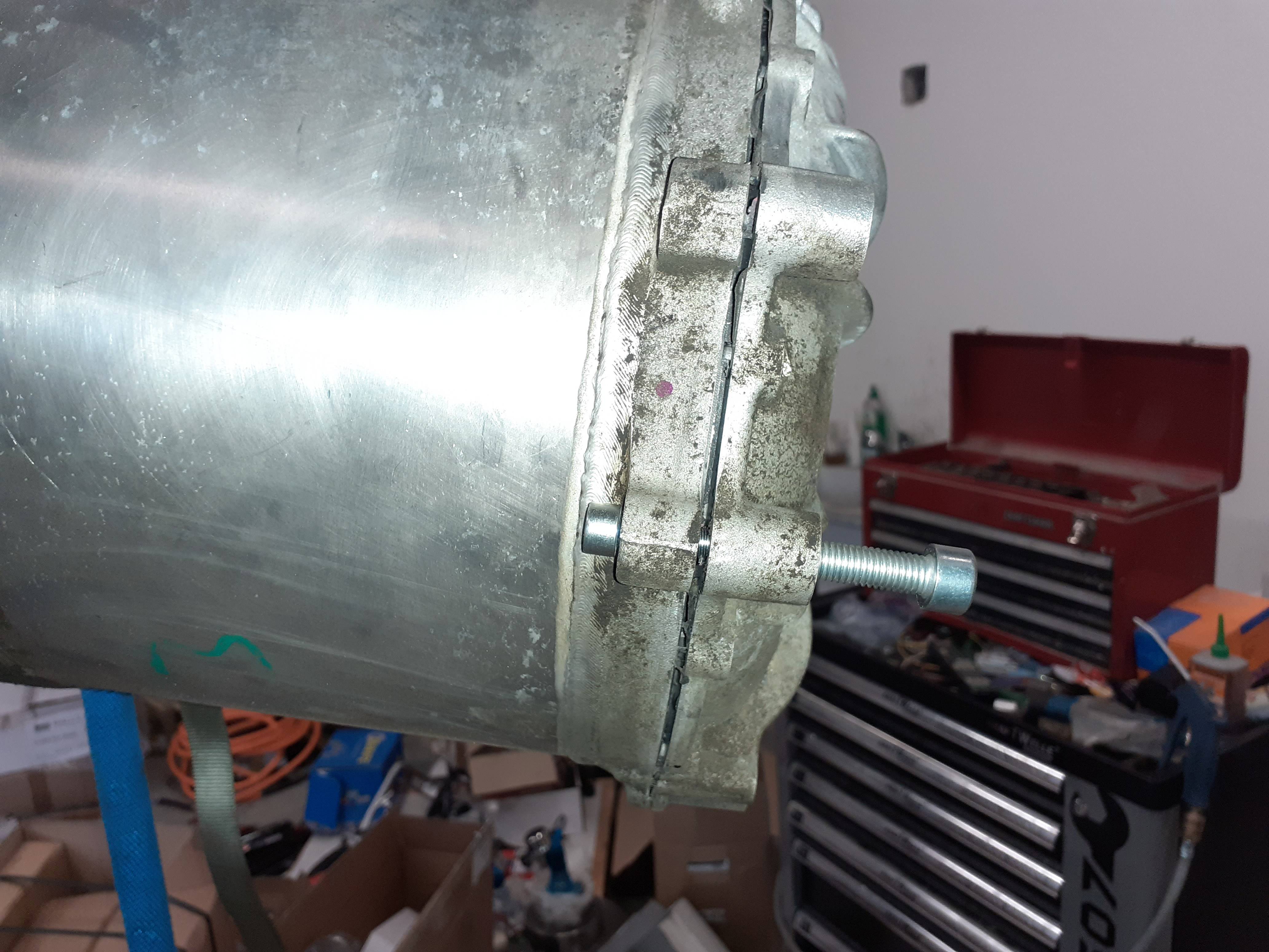

Disassembly Notes:
I cut an M10 thread into the through hole and screw in a screw. Then I press from the opposite side with an M8 screw. For blind holes I use self-made push-out screws. Also works with the case halves. The last picture shows how I push the rotor out. No hammer needed and won't destroy paint on nicely made engines.

muehlpower wrote: Sat Jul 29, 2023 8:44 am Disassembly Notes:
Are the self-made push out screws dog pointed bolts or the threaded collar ones you showed?
Could also probably be made like this but likely stepped down more than this image shows..
That's an old Audi I5 timing belt idler "puller".
It's too bad Tesla didn't do this from the factory. Nice solution muehlpower!

Post by muehlpower »
I use Allen screws DIN 912. With your one-piece design, the depth of the blind hole is important, with the two-piece design, the large screw can be screwed in completely and the small screw can be adjusted or simply be very long.
