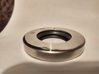

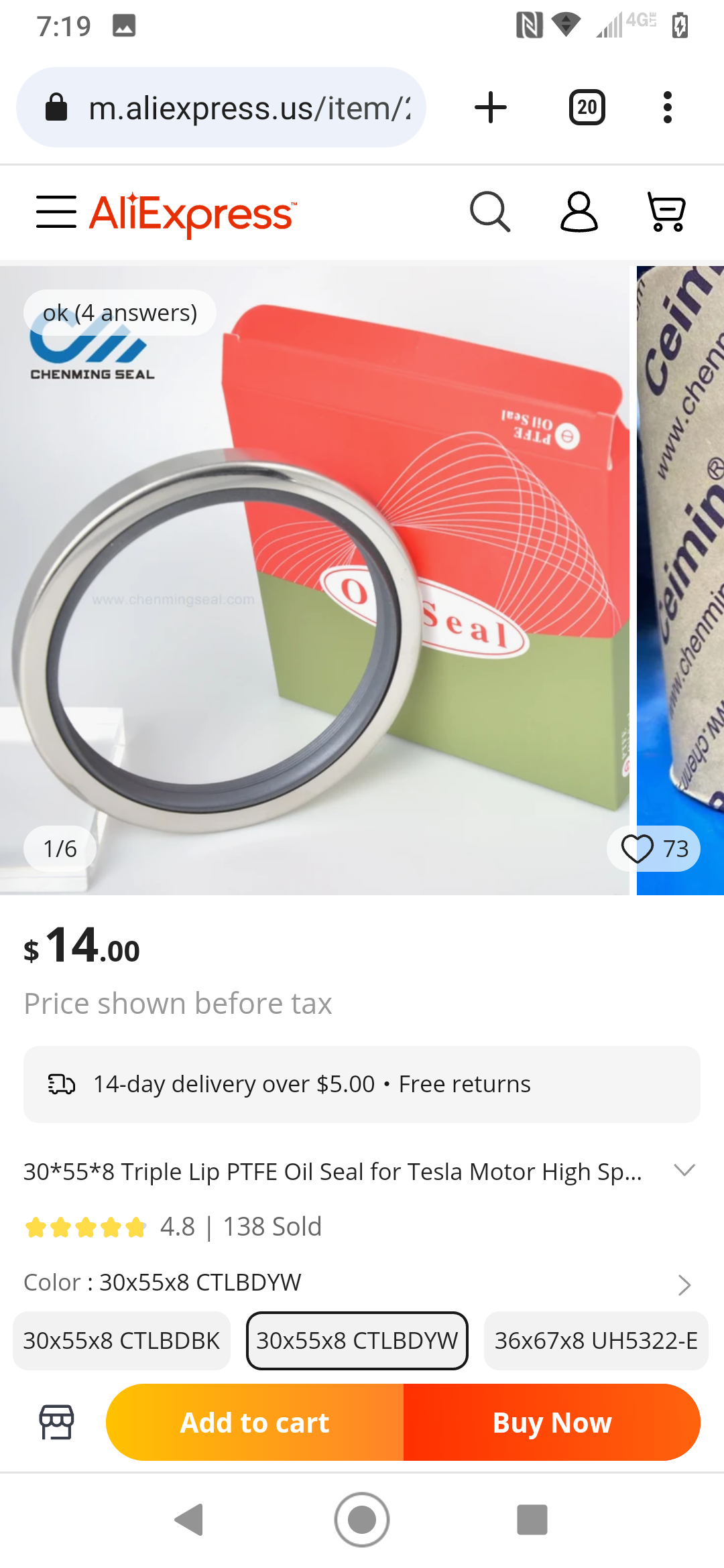

Ceimin triple lip seal cage is a lot stronger than original Tesla's single lip seal cage. Multiple stainless ring blocks pressed together and a lot heavier. Removal is much greater challenge than original seal but pretty easy this way (thanks to @Boxster EV)
- drill pilot hole through top stainless steel layer (closer to the outer edge as interior rings have larger ID and can be missed drilling at an angle), maybe 1/2 way through the 2nd layer of steel (slow speed with oil to cool, getting stainless hot only gets it harder) Drilling will be at a slight angle since the manifold pipe is in the way.
- screw in self tapping screw. Preferably one can turn and lock in tight with ratchet
- bite screw head on a vice, lever out the seal
Came out pretty easy. Ability to apply high leverage properly makes it easy.
Here is a better look at the seal interior. All PTFE seal lips intact, rust packed in between.
My best guess now is prior reman removed the protective plating and didn't reapply. My light sanding probably wouldn't have taken off the plating (unless of course I did take off whatever surface finish protectant). Fresh O2 is introduced via drain port. Cooling contracting volume coolant probably vacuum pulls air into the seal lip chamber from dry side sucking in fresh air. Can't prove any of this but seems most likely

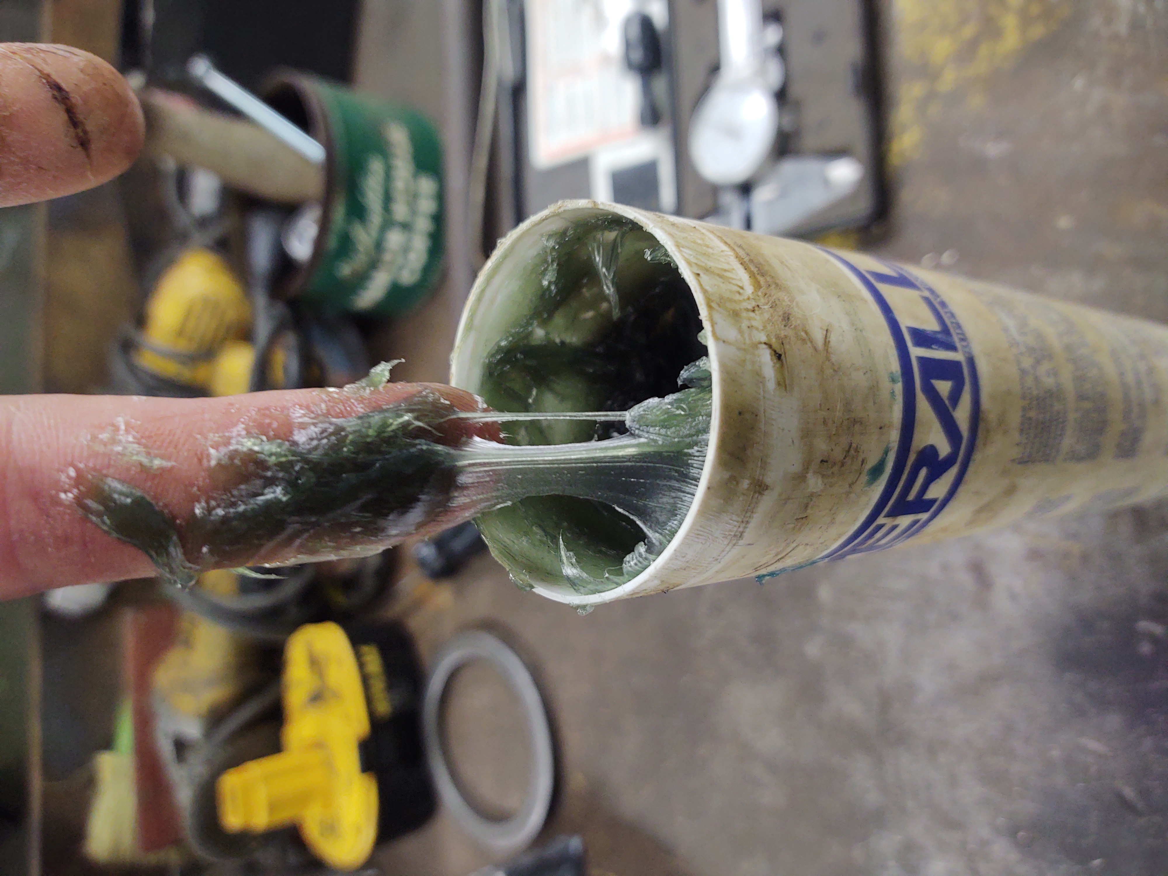

Spline Grease
Anyone know what this stuff is? Saving it 2x now means I have less and less of it on the spline coupling. It looks like really thick grease. Perhaps electric insolation property too? No idea.
Anyway, way beyond my knowledge domain but posting it for reference. But I'd imagine the proper material choice would be a more robust solution than sleeve and even chrome plating.

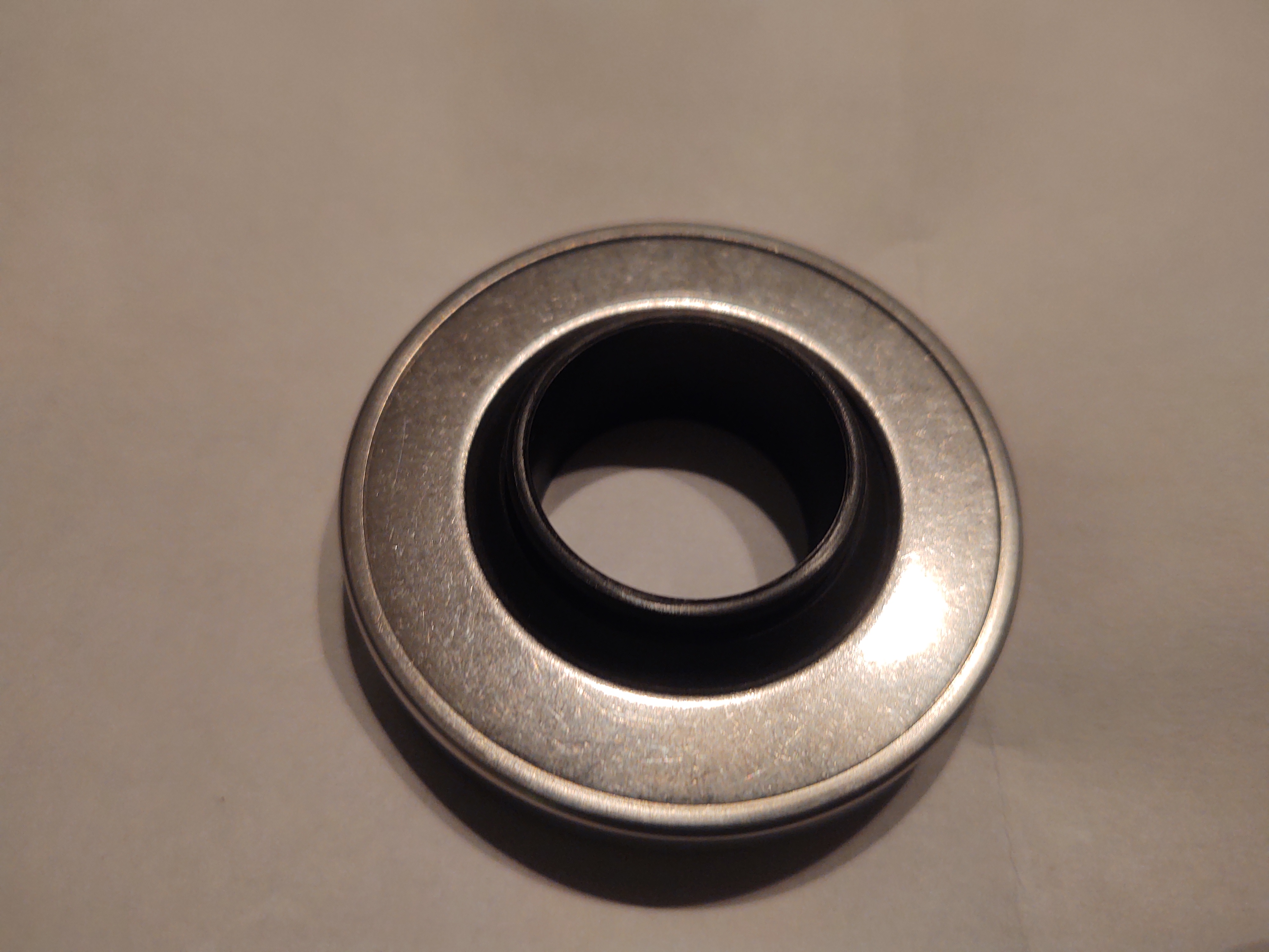

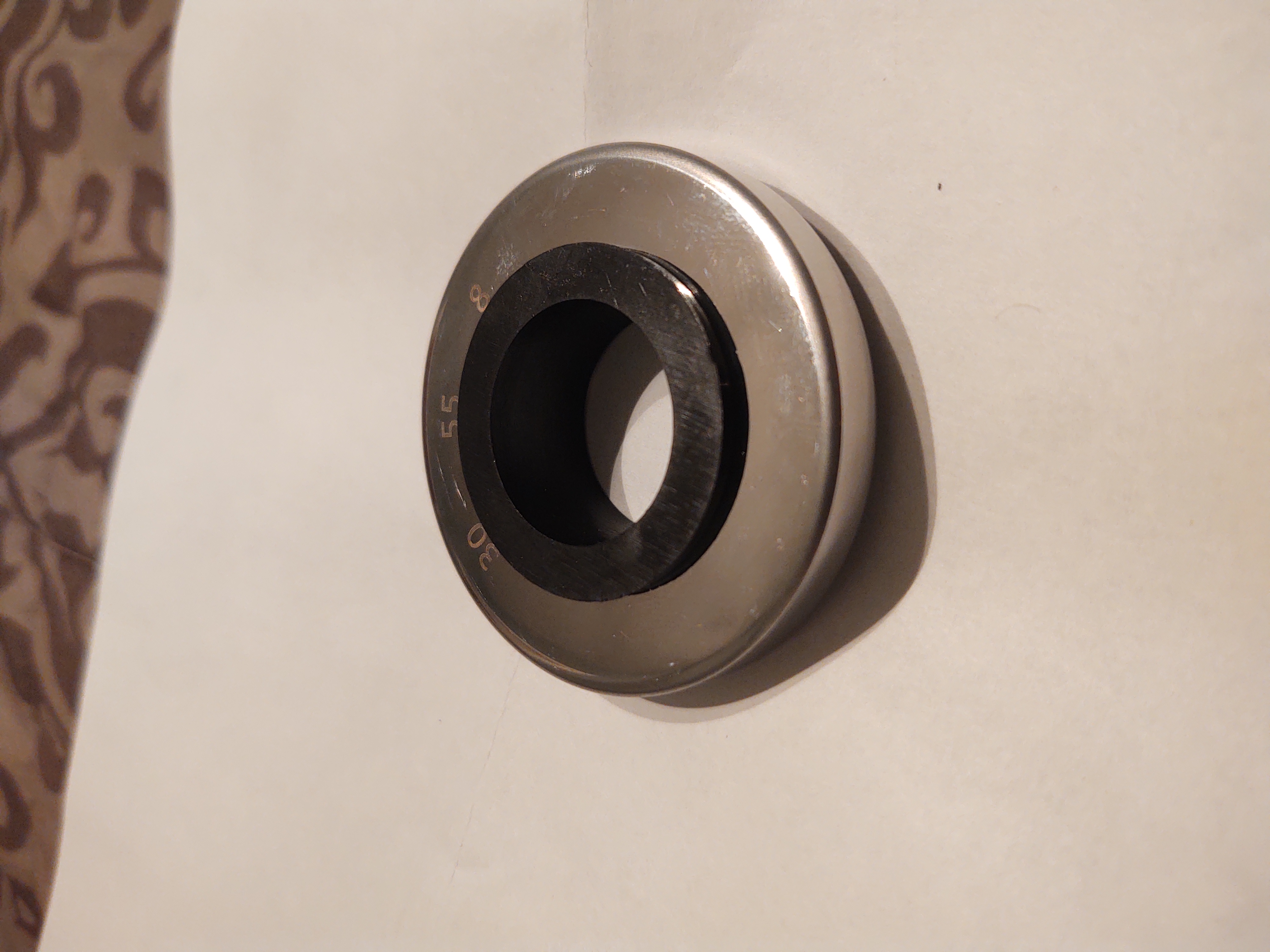

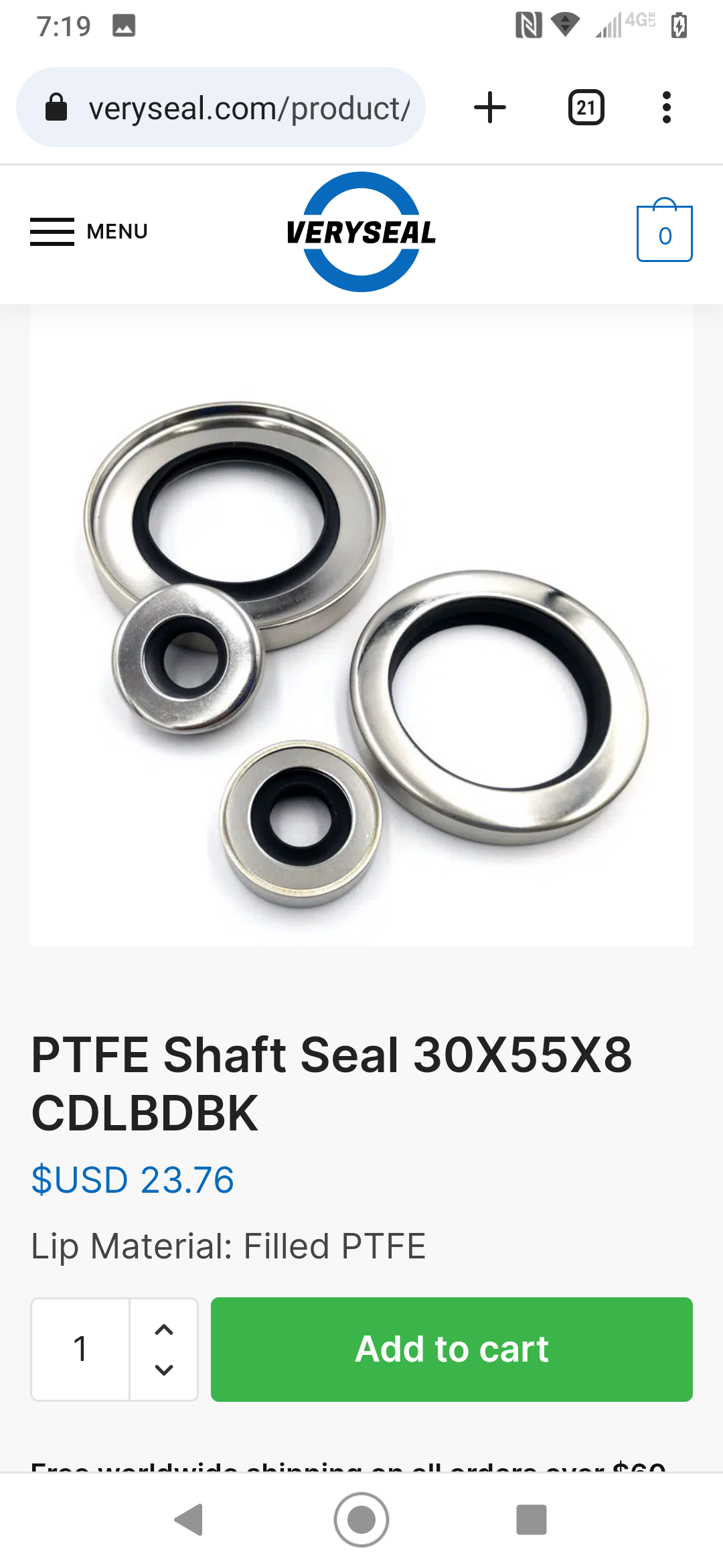

I'm going to try this 2 lip PTFE seal for my 2012 P85. It took 8 days to come in the US mail from New Jersey to the Chicago area. It ships with an internal collar spacer fitted to keep the seals oriented and stretched until installation.
2012 P85, 2013 85, 2013 85 parts car.

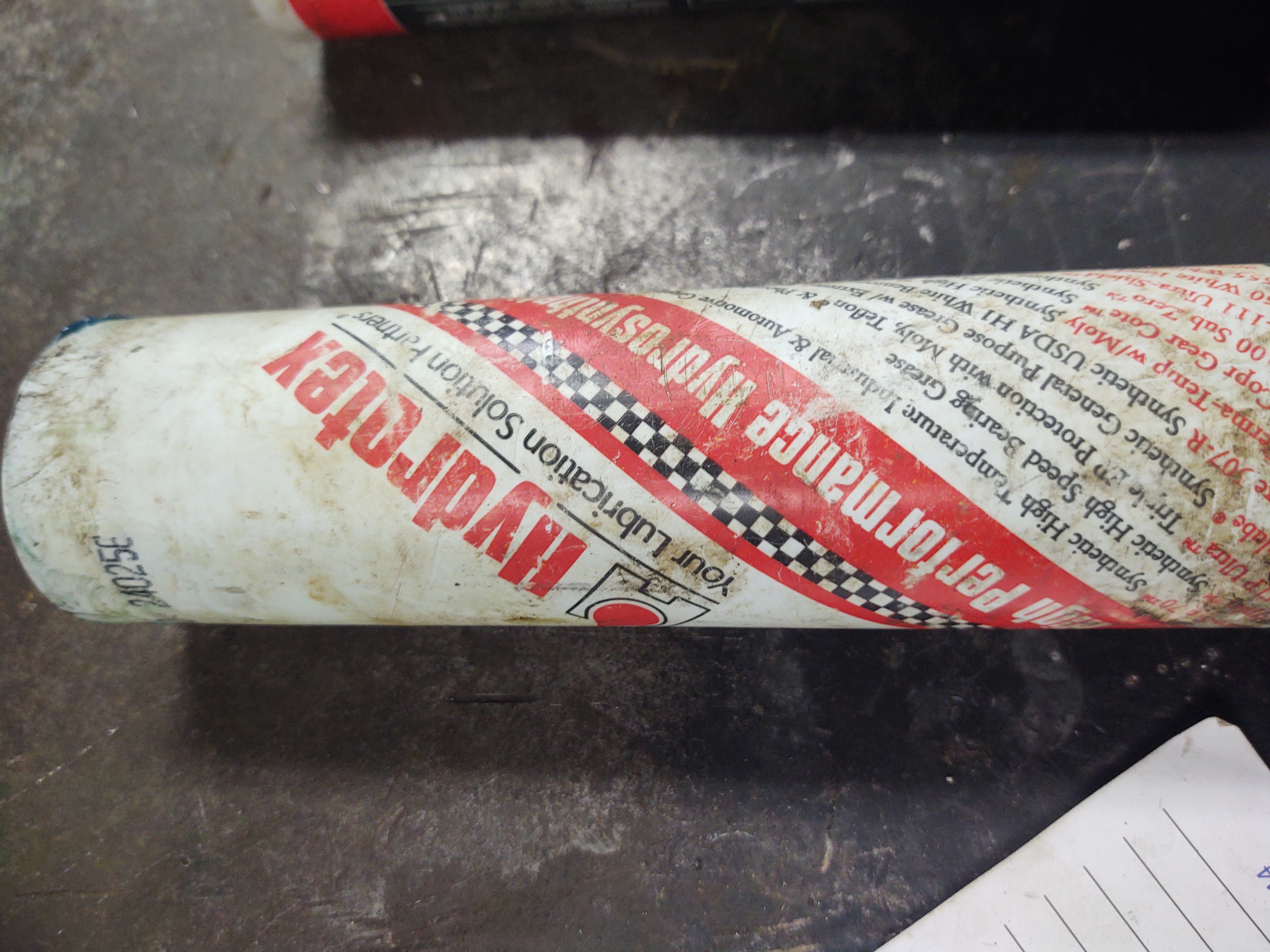

Howardc64 RE: Spline grease.
A good sticky grease used for propellor shafts is made by Overall Supply Inc from New Jersey. It is called "super grease" and is very sticky. It worked well on tug boat prop shaft bearings and seals. A couple other synthetic greases are made by Hydrotex and Certified Laboratories. I used the super grease on my rotor splines.

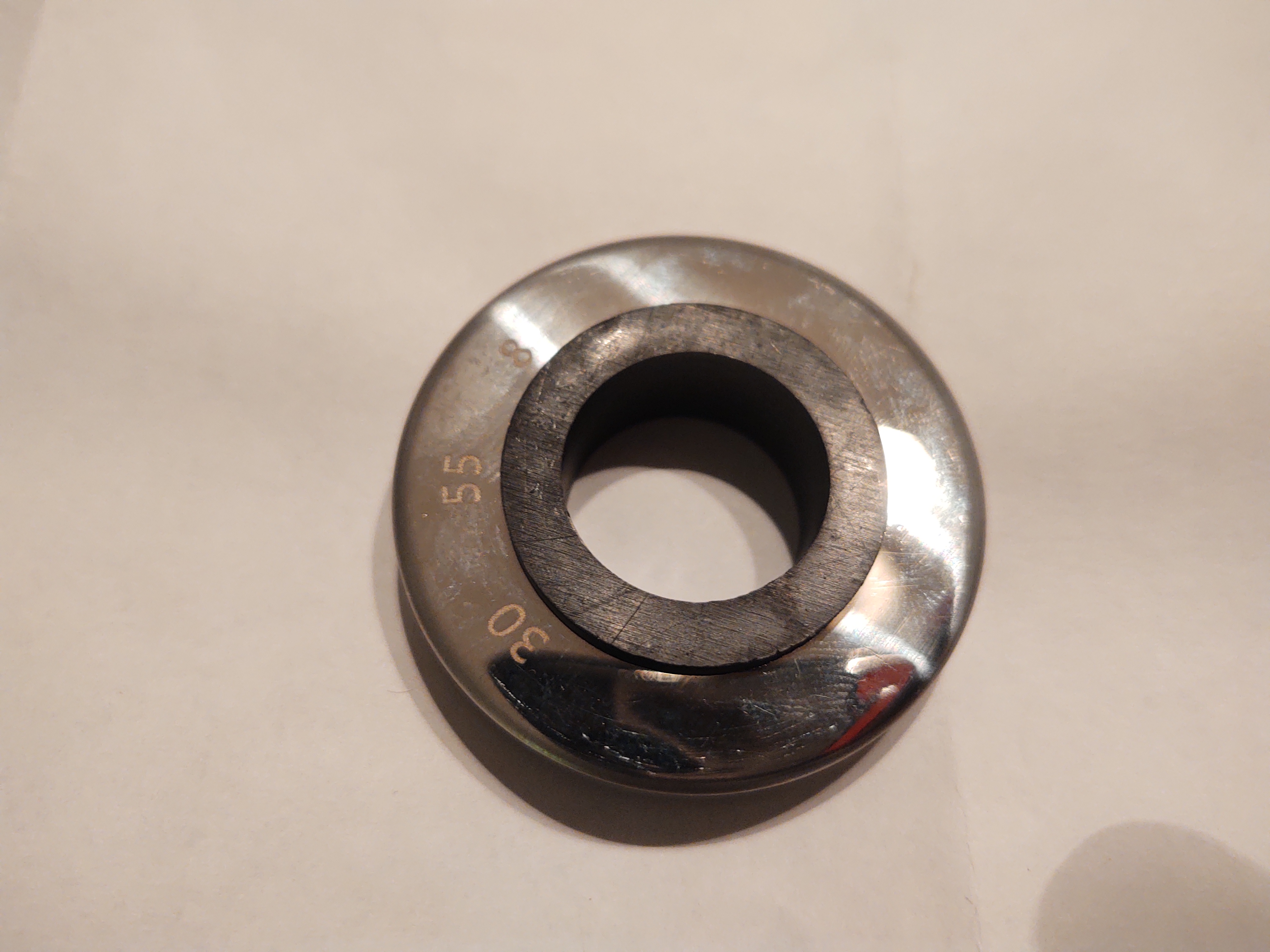

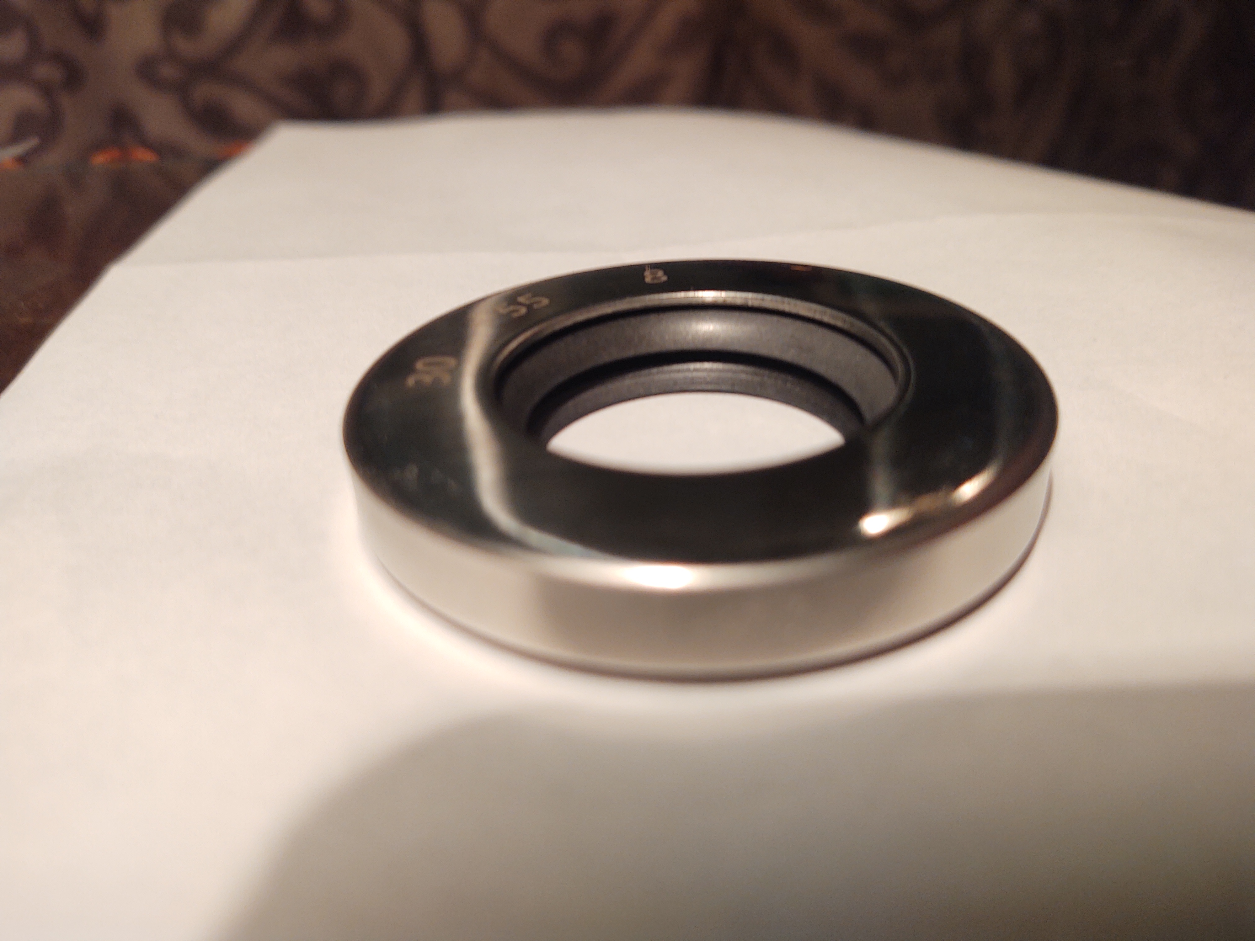

2oldteslas wrote: Thu Aug 03, 2023 12:45 am I'm going to try this 2 lip PTFE seal for my 2012 P85. It took 8 days to come in the US mail from New Jersey to the Chicago area. It ships with an internal collar spacer fitted to keep the seals oriented and stretched until installation.
Another PTFE seal from China. Interesting. Pic shows both lips face coolant side (no excluder) so much easier to install over the beveled shaft opening without risk of folding the lips.

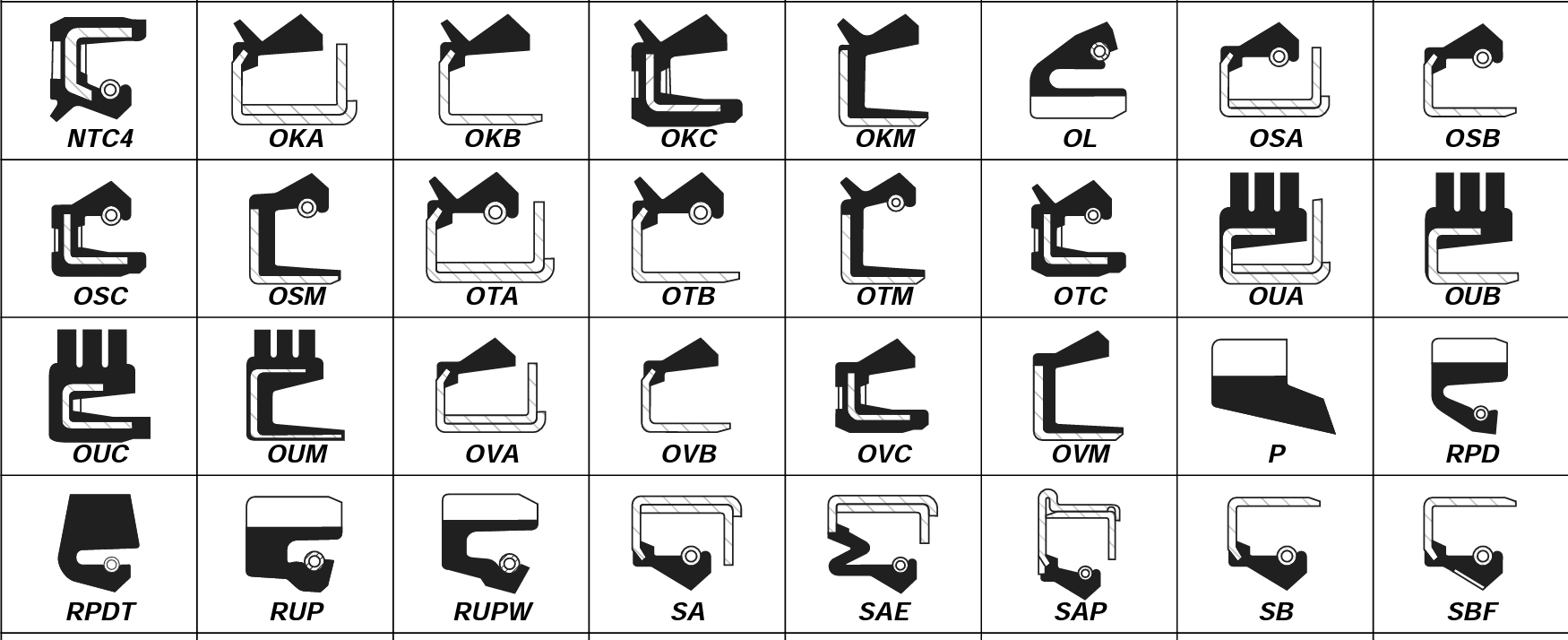

This is generic info but worth a read for people considering multi-lip seals. PTFE might be allowed to run dry but I wouldn't expect that to be the case at the speeds that these are spinning.
https://www.skf.com/us/products/industrial-seals/power-transmission-seals/radial-shaft-seals/technical-specification wrote: For a radial shaft seal to seal efficiently over a long period, the sealing lip must be lubricated. This reduces friction and wear to the sealing lip and shaft. Dry running of sealing lips made of standard materials should always be avoided. To prevent dry running, coat the counterface surface with a suitable lubricant prior to seal installation.
The lubricant must not only lubricate the sealing lip to reduce friction and wear, but also dissipate heat generated by the seal. To promote heat dissipation, a sufficient quantity of lubricant must be able to reach the sealing lip from start-up.
Some rolling bearings, such as angular contact ball bearings, tapered roller bearings and spherical roller thrust bearings, as well as gears, create a pumping action by virtue of their design. This means that the sealing lip can either be starved of lubricant, or subjected to excessive quantities of lubricant. In either case, steps must be taken during the design stage to make sure that the proper amount of lubricant reaches the sealing lip, as too much or too little can affect seal performance.
To prevent lubricant starvation, lubrication ducts can be provided. If the seal is subjected to excessive amounts of lubricant, a flinger can be installed between the bearing and seal.
In applications where the sealing lip is not exposed to a lubricant, for example when two seals are installed in tandem, grease or oil must be supplied separately to provide lip lubrication. In some cases, it may be sufficient to provide an initial grease fill between the two lips.
under lubrication.
Trick would be to find a PTFE compatible lubricant that doesn't gum up when expose to g48.

Post by howardc64 »
2oldteslas wrote: Thu Aug 03, 2023 1:04 am Howardc64 RE: Spline grease.
Thanks, that grease looks thick! haha
Few questions
- Did you mix it with the original grease?
- Any longevity data? I guess need to pull again to see for sure.. PITA haha
- Any thoughts on electrical conductivity characteristics?
2oldteslas
Posts: 11
Joined: Sat Jul 22, 2023 8:25 pm
Post by 2oldteslas »
howardc64 wrote: Thu Aug 03, 2023 6:25 pm Thanks, that grease looks thick! haha
Few questions
-I cleaned off most of the old grease but not all so a small amount is mixed in with the super grease.
-no information on longevity or conductivity. Judging by experience it is a good heavy duty grease.

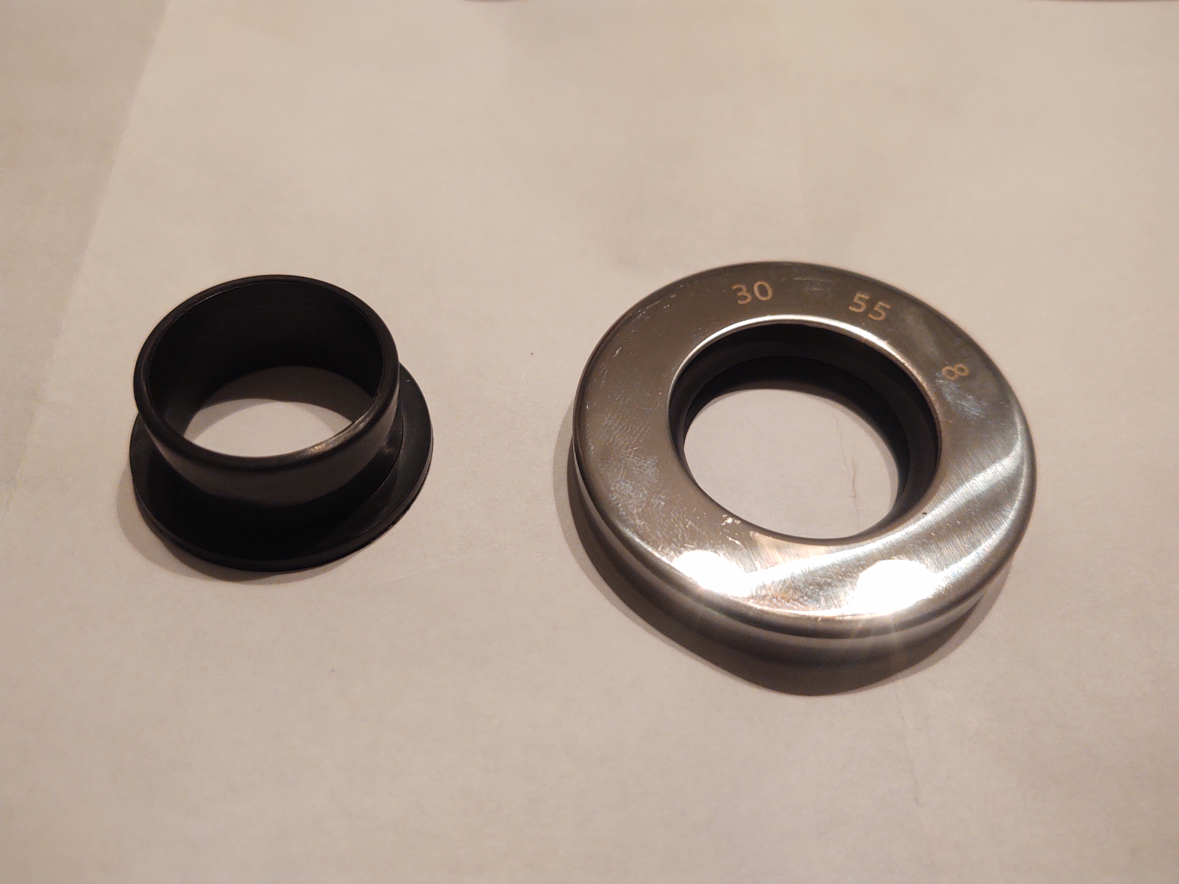

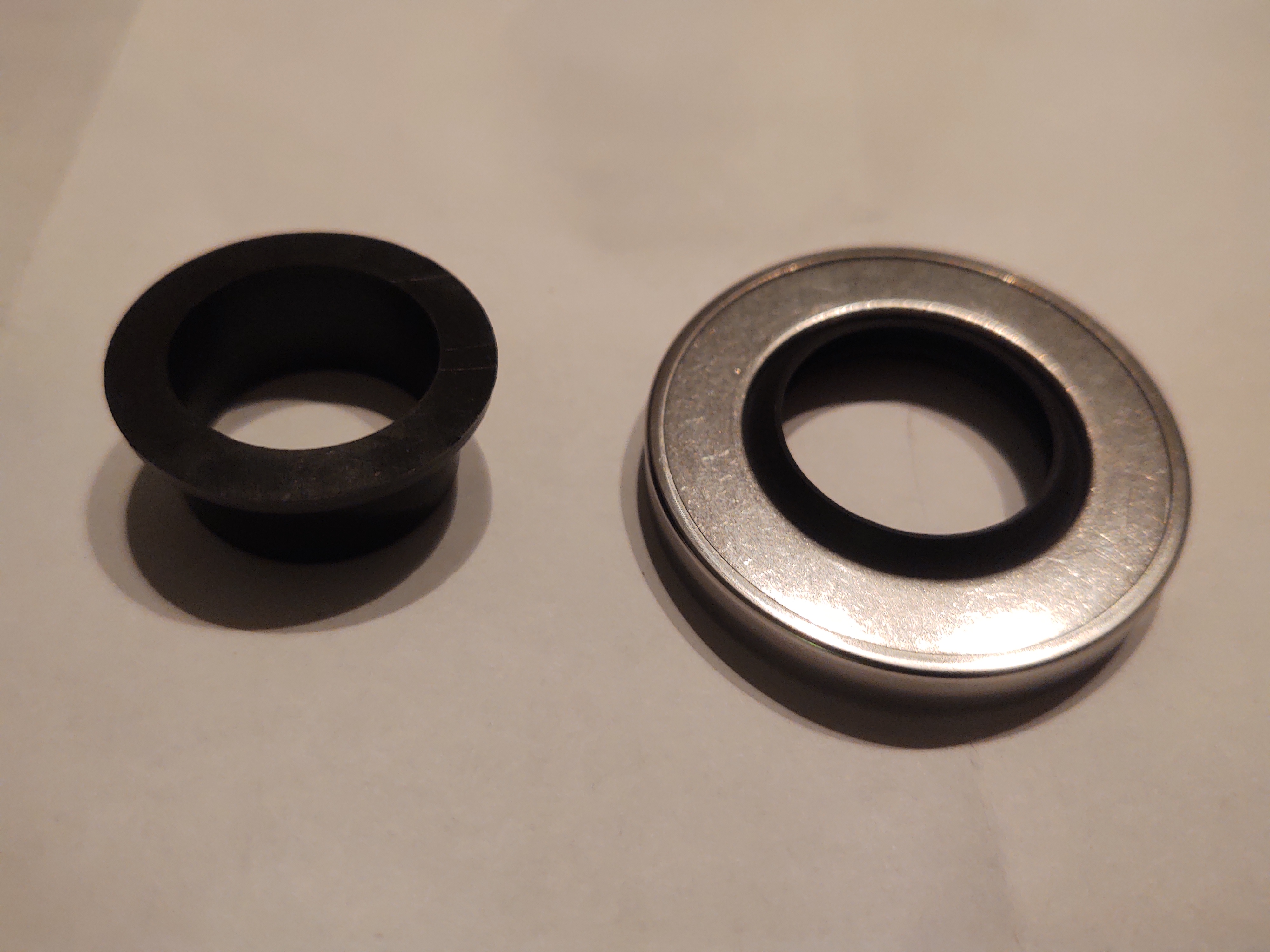

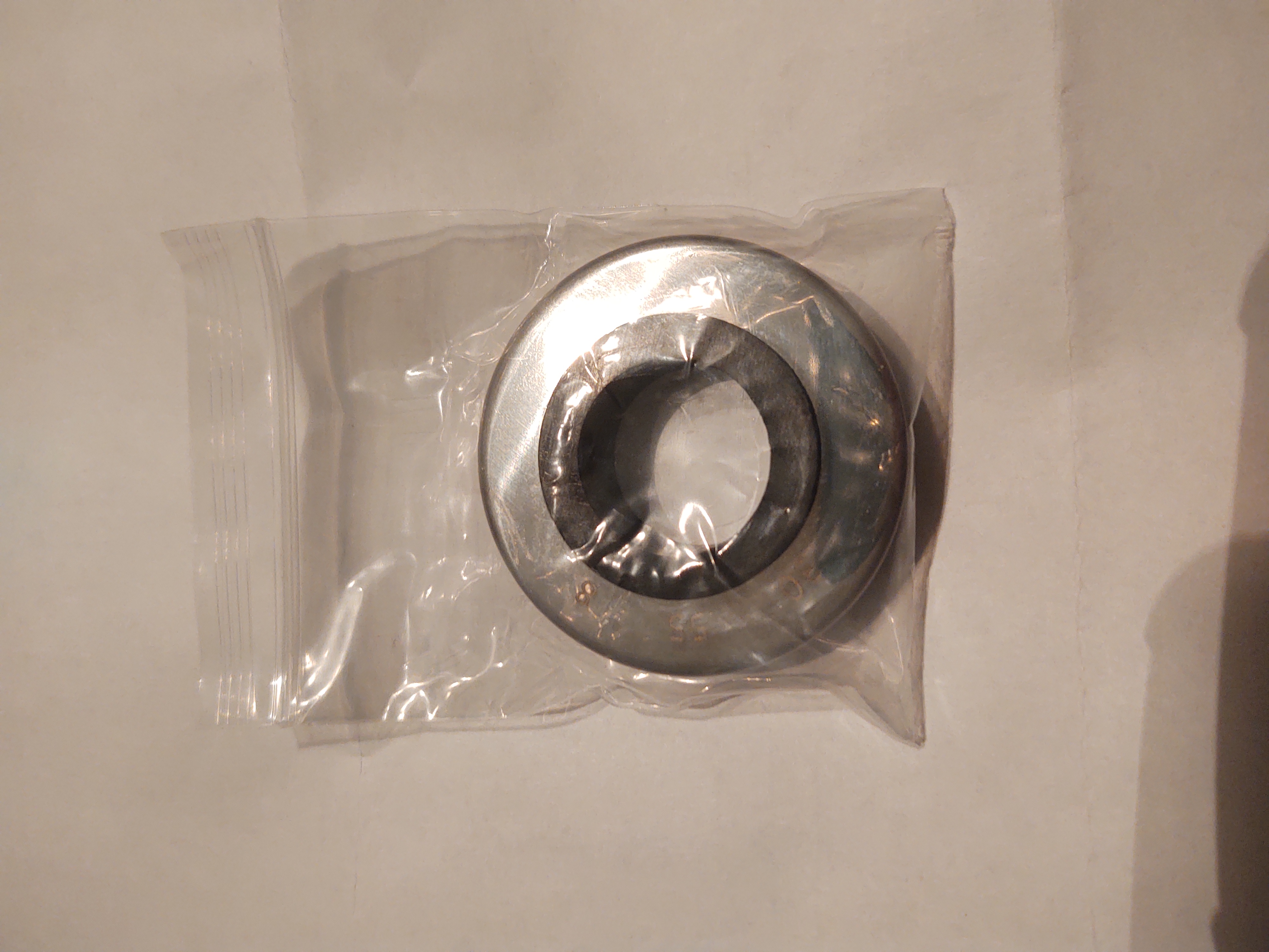

These are the 3 coolant seals I bought. Single lip, double lip and triple lip. Time will tell which works best.

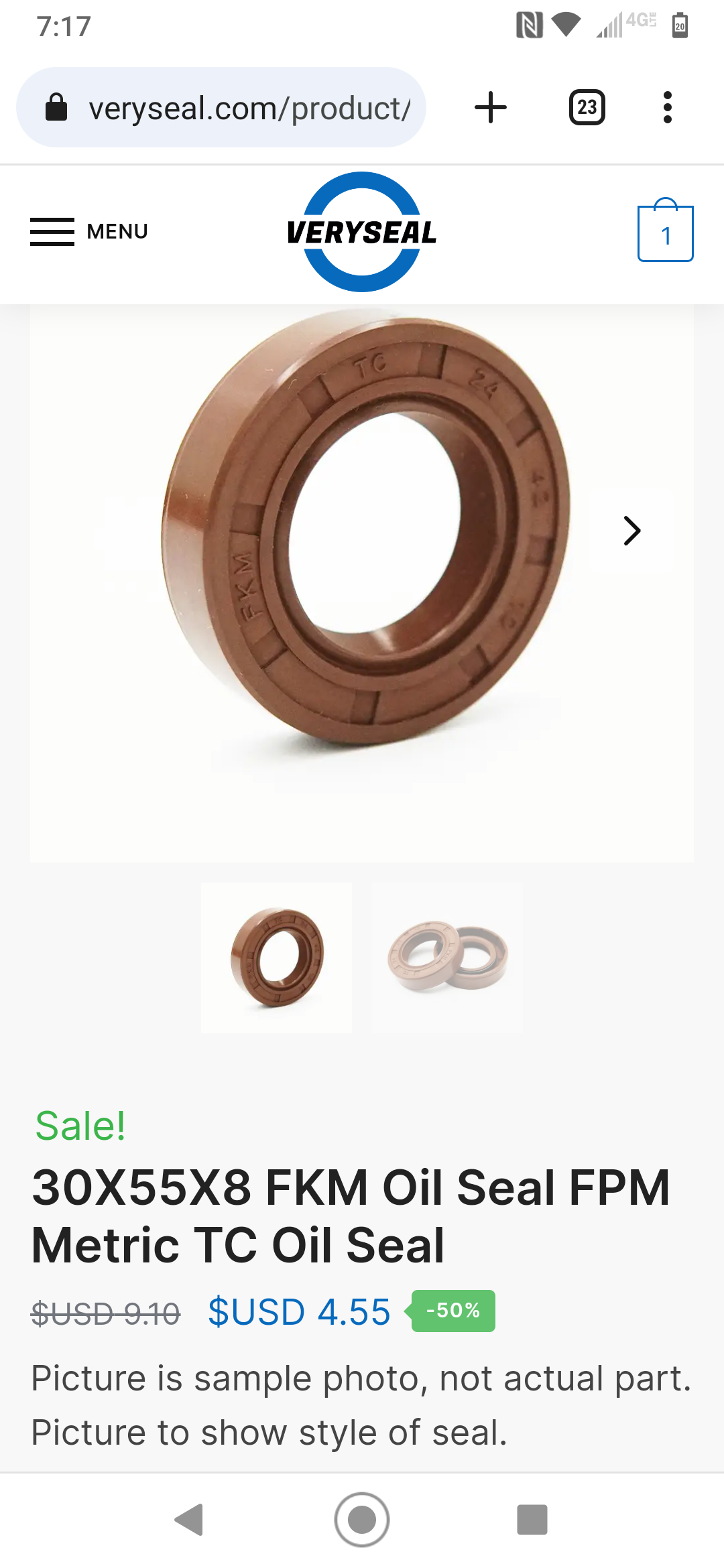

2oldteslas wrote: Thu Aug 03, 2023 10:32 pm These are the 3 coolant seals I bought. Single lip, double lip and triple lip. Time will tell which works best.
For the FKM seal, you can get better qualify SKF with and without excluder lip. ~$5 each at Acorn in UK (but $30 international 2 day DHL ship) so best to combine with bearing purchase.

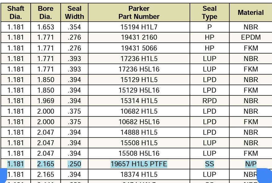

Has anyone reached out to Parker Hannifin for a 19657H1L5PTFE seal?
I'm not sure why they couldn't list that as a metric seal.
Might be worth trying through motion industries or other reseller if they don't want to be bothered directly.
It's an ss style lip,
Screenshot_20230805_072510_Adobe Acrobat.jpg (9.88 KiB) Viewed 30811 times
My previous scribbles on this might not work out well as I first thought. I added an edit note to my post on that. With a seal in the shaft spinning, centrifugal force will probably open the seal lip. But they have a bunch of external lip seals if someone wants to experiment with flipping the sealing method inside out. With a sleeve pressed (and sealed) inside the hollow shaft it could give a decent surface for an external lip seal.
They also have FKM seals with a bonded PTFE section to have the flexibility of rubber and a sealing edge / wear / friction surface of PTFE. Click on the image and zoom in, white rectangle is PTFE,

jrbe wrote: Sat Aug 05, 2023 11:57 am Has anyone reached out to Parker Hannifin for a 19657H1L5PTFE seal?
But no off the shelf offerings for this that I saw in their design guide / catalog.
They also have seal designs with a molded in spring like section to allow for greater misalignment (some shown in the design style image above.) I don't think it's needed here though. Lots of interesting things in their 400 page design guide,
https://www.parker.com/content/dam/Park ... s/5350.pdf

howardc64 wrote: Sat Aug 05, 2023 12:26 pm Yes, I reached out to Parker and Saint Gobain custom seal divisions. Neither wanted to engage. Saint Gobain said the seal was proprietary in nature so didn't want to provide services. I'm guessing all these big manufactures already contacted by Tesla/Tier 1 supplier. Maybe some are past/current LDU seal manufacturers.
viewtopic.php?p=49553#p49553
viewtopic.php?p=46858#p46858
Sorry I missed those posts.
I find it strange that potential OEM suppliers are not willing to sell parts. I could see them not using a Tesla logo or the Tesla part # on it. Maybe they know it's a bad design, they might just see it as a liability that they know will fail and shut it down asap. Maybe that's Tesla's refusal to sell seals too.
For clarity, 19657H1L5PTFE should be an off the shelf part. No need to go the custom route or even mention Tesla while trying to order some. It doesn't seem to be a thick sealing surface but that could be a good thing given the speed it can run at.
For the rotor cooling temperature reference, using an IR sensor should get the rotor temp without complications or assumptions. They should be pretty immune to electromagnetic environments. There are also temp recording paints that could be manually checked for testing / verification.
