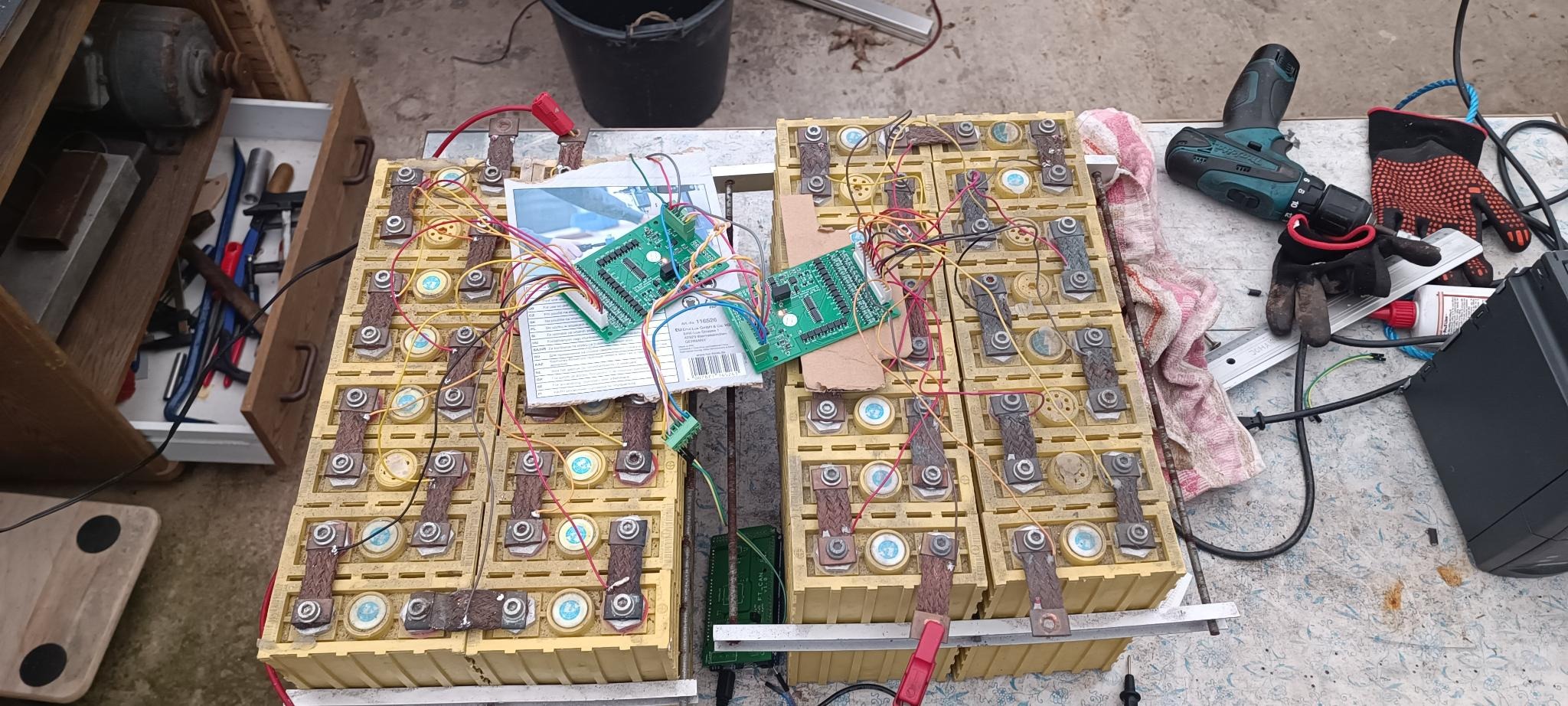

Finally got around to some more BMS testing, now with two modules, i.e. the configuration that kept blowing up back in London. With the opto coupler armada the problem seems solved. Restarted around 20 times and it never smoked.
I did hook up one module completely the wrong way around. It seems this killed the upper two channels, they show too low readings. Will replace the mosfets and see. Apart from that no damage.

By design there isn't a limit, only the CAN bus bandwidth. The software currently limits to 6 modules but that is easily extended.
I've done all tests that I'm currently capable of and have done a minor design change that isn't super critical. Before selling larger quantities I'd wait for feedback from a few projects.

I received a new batch of BMSes and they will become available in the shop soon. I will sell a few more as with the "early adopters" discount then will raise the price to something viable.
Apart from that there is still some discrepancy between channel 0, 1 and 15 compared to the other 13 channels. I.e. channels 2-14 will measure the exact same voltage when applying a known input, channel 0 reads 5 mV too high, channel 1 reads 5 mV too low and channel 15 7 mV too low. This is down to different transistors being used on the lower two channels and to an extra load resistor being switched in for channel 15.
I have now decided to compensate this in software where a correction factor can be entered for these 3 channels. It defaults to something I have measured here.
