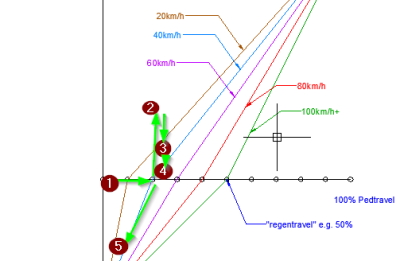

In the example with 20% throttle, you will not reach 60km/h.
Step1: At zero speed, the user pushes the pedal from 0% to 20%
Step2: ECU uses the curve for 0km/h, and the 20% result in a large acceleration.
Step3 and 4: With increasing speed, the torque goes down. When reaching 40km/h, the torque is zero.
Step5: The user releases the pedal from 20% to 10%. The software looks at the 40km/h curve at 10% pedal, and produces moderate regen torque.
Afterwards, when the speed decreases, the regen torque calms down a little bit.
If the pedal is slowly reduced from 20% instead of stepwise, we went the 40km/h line downwards a little bit, create small regen, and the speed decreases. If the pedal is hold e.g. at 15%, the stable point with zero torque is around 30km/h.
When releasing the pedal to zero immediately, the software creates always the full configured regen torque.
For me this makes sense, even if I'm used to have no "knee" at the zero-torque point, but just a straight line.

The accelerator pedal is not primarily a "speed controller" in any car, but a torque controller that ideally reacts immediately. When you start, you press the pedal according to the desired acceleration. When you reach the desired speed, you reduce the torque until it is sufficient to overcome the current driving resistance. To go up a hill you have to push the pedal harder to keep from slowing down. There is no need for a time factor other than dampening the pedal.
The time results automatically from the mass of the vehicle and the acting torque.

My suggestion is based on parameter. It may well be that a maximum of 30% pedal value at 70km/h or other values ​​turn out to be optimal. Of course, other things such as personal preferences, vehicle weight and engine performance also have an influence. Also note that in my example it is static over 100km/h, that means over 50% travel no regen at all.

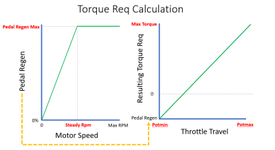

The way I have implemented this feature in the past and on my EVS products
So all I have is a "steady regen rpm" from which it tapers the off pedal regen to 0 at just above +/- 50-100 rpm.
Results have been very good in many vehicles from small light classic Minis to Tesla LDU powered vehicles.

tom91 wrote: Sat Aug 12, 2023 9:53 pm The way I have implemented this feature in the past and on my EVS products
This looks exactly how it is now. Dead zone of 25% ("regentravel") at e.g. 300Nm max torque and 100Nm max regeneration and the appropriate value for "regenrampstr".

muehlpower wrote: Sun Aug 13, 2023 7:55 am This looks exactly how it is now. Dead zone of 25% ("regentravel") at e.g. 300Nm max torque and 100Nm max regeneration and the appropriate value for "regenrampstr".
You're right. I didn't get graph because I thought that it does not have dead zone, but it did :D

No the clue is that it has a dynamic regen based on speed so it tapers at low rpm to remove the dead zone. That is why two graphs and the arrow.

tom91 wrote: Sun Aug 13, 2023 11:00 am No the clue is that it has a dynamic regen based on speed so it tapers at low rpm to remove the dead zone. That is why two graphs and the arrow.
That makes sense. This means if the current RPM is half the set limit and the pedal is at 0%, regen is also half the set value. Above the set RPM, the distribution of the pedal travel always remains the same. With an LDU with 400kW and 70kW regeneration, there is approx. 15% for regeneration and 85% for acceleration.

uhi22
Posts: 1117
Location: Ingolstadt/Germany
Has thanked: 206 times
Been thanked: 617 times
Re: Accelerator pedal dead zone
Post by uhi22 »
Do I get this right: When I'm slowing down with pedal 5%, and want stronger slow down so releasing the pedal to 4, 3, 2, 1, 0%, in the end the deceleration jumps from "strong" to "nothing"? This would be a shock moment for me, seeing the brake lights of the car in front of me coming nearer.
mane2
Posts: 251
Has thanked: 40 times
Been thanked: 41 times
Post by mane2 »
uhi22 wrote: Wed Aug 16, 2023 7:18 am Do I get this right: When I'm slowing down with pedal 5%, and want stronger slow down so releasing the pedal to 4, 3, 2, 1, 0%, in the end the deceleration jumps from "strong" to "nothing"? This would be a shock moment for me, seeing the brake lights of the car in front of me coming nearer.
At 1% it could be like -99 (very strong) and at 0% its -100.
So no jump at all, just smooth transition from -99 to -100. See the first row of data for 0%
Aragorn
Posts: 157
Has thanked: 6 times
Been thanked: 65 times
Post by Aragorn »
mane2 wrote: Wed Aug 16, 2023 1:57 am But this is the way commercial cars works and I never realized that before starting to think about it.
Its definately NOT how the LEAF or Skoda works.
In your example, if you opened the throttle to 35%, you'd have 35% torque request. Now you reach target speed, so you reduce throttle to 25% to maintain speed and instead it goes into regen, and then you need to open the throttle back up to 44% again just to achieve the 25% you wanted.
That is NOT normal throttle control and would surely feel HORRIBLE on the road.
mane2
Posts: 251
Post by mane2 »
I have no idea how Toyota or Skoda does it, but BMW works very similar to that and it's not horrible at all.
I think the main thing is, that your foot does not remember the position where to lift or to what % you used to press the pedal. You lift it, and you feel what happens.
How do Skoda or Toyota do it?
Aragorn
Posts: 157
Post by Aragorn »
i'm actually amazed that BMW would really do that TBH... Having a situation where a tiny lift of thottle takes you from +35 to -15 is going to feel awful, especially when getting back to +35 then requires a huge additional extra throttle input. A small bump in the road could cause a small lift of the throttle and suddenly your in regen instead of accelleration...
The LEAF and Skoda both seem to act similarly to me:
At zero speed, zero throttle, there is a small positive torque, upto around 5mph. Emulating "creep" from an autobox.
Once at ~5mph the zero throttle point becomes zero torque. On a flat road the car will find an equilibrium point and just roll along around 5-6mph. If a hill is encountered and the car slows the positive torque will reappear.
As the speed climbs past 5mph the zero torque point moves along the pedal travel gradually. By 10-15mph it settles in around 10-15% (my guess based on foot feel) and doesnt move further. Thus in the above example of rolling along at zero throttle, if you started going downhill, with zero throttle the car would start blending into regen once it gets past 5-6mph.
The exact zero torque point changes slightly depending on drive mode. The higher regen modes move the zero torque point slightly further into the pedal travel.
mane2
Posts: 251
Post by mane2 »
creep/idlespeed is another function of open inverter, let's not mix it into this one. Also speed is unrelated to accelerator, as accelerator only controls torque, not speed.
So with Skoda or Leaf, once you start accelerating and you're pressing the pedal like 35%, so you are probably applying about 35% of torque. What happens when you lift off the pedal and keep it in 15% position? Would you still be applying torque or regen? How much?
Aragorn
Posts: 157
Post by Aragorn »
creep or not the rest of the stuff still applies.
the zero torque position moves from 0% to about 10-15% as the speed climbs from ~5 to ~10mph. Thereafter it stays put.
To answer your specific question, moving the throttle from 35% to 15% would probably be pretty close to the zero torque position, or maybe slight positive torque. Moving it back to 35% again would be exactly where it was before.
I will see if i can log throttle pedal position and torque with CarScanner and take some actual readings.
mane2
Posts: 251
Post by mane2 »
If you're doing 35% of the pedal, you might be going already like 60kmh or more. Having only 15% of the pedal travel for regen at that point, sounds small.
Anyway, this is that kind of thing that can only be tested by driving. It could be that my guess how BMW does it, is completely off :) I'll test this soon and let you know.
