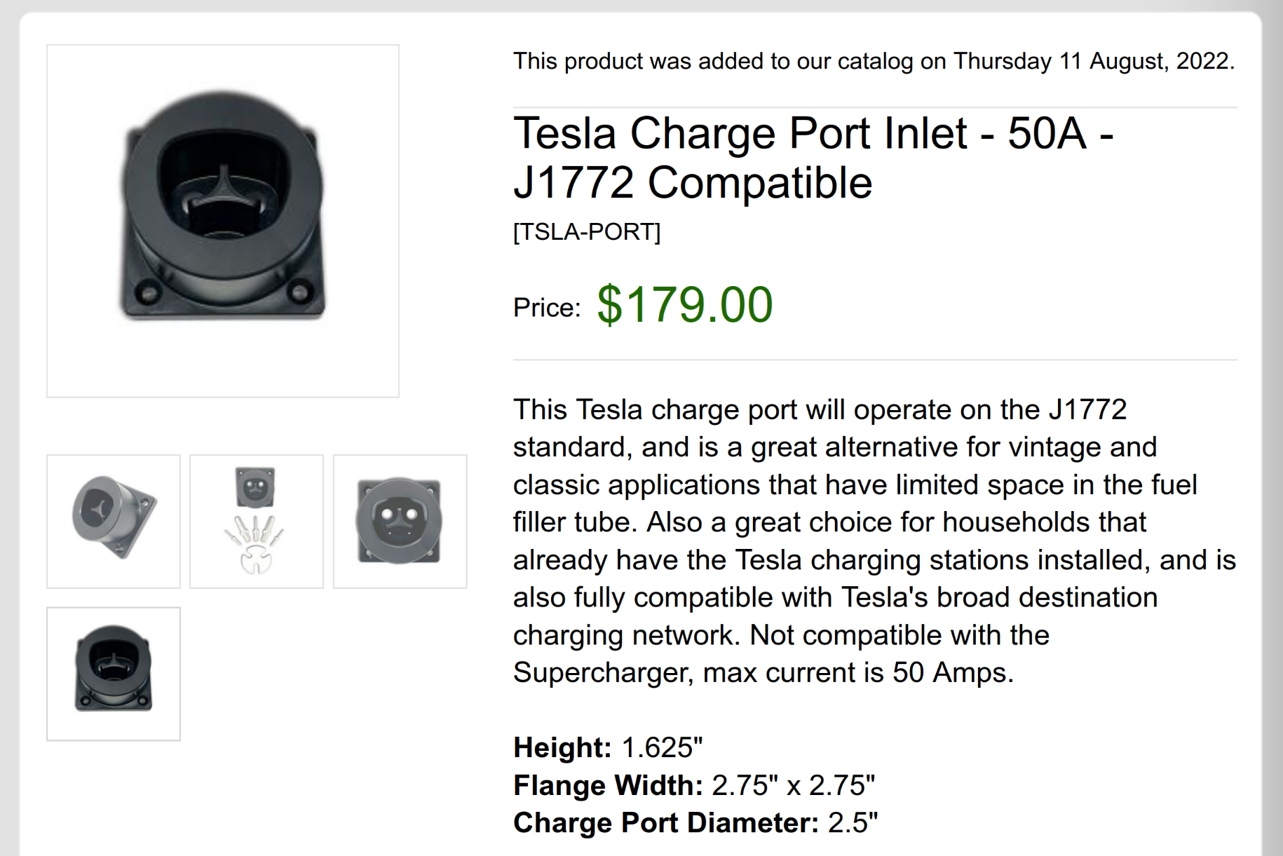

The landscape has changed, we have other CCS add-on options, but now in the US NACS is ascendant. If I wanted to install a NACS inlet, for purposes of DCFC, and use a non-Tesla controller for the CCS comms (BMW i3 LIM, AR7420, or QCA700x), what options are there for the physical port?
EVWest sells a NACS charge inlet:
But it's limited to 50A, and offers no nozzle lock. For my purposes, I desire 125A and nozzle locking.
Are there NACS charge inlet options other than used Tesla bits?

To the best of my knowledge, only used Tesla stuff at this point.

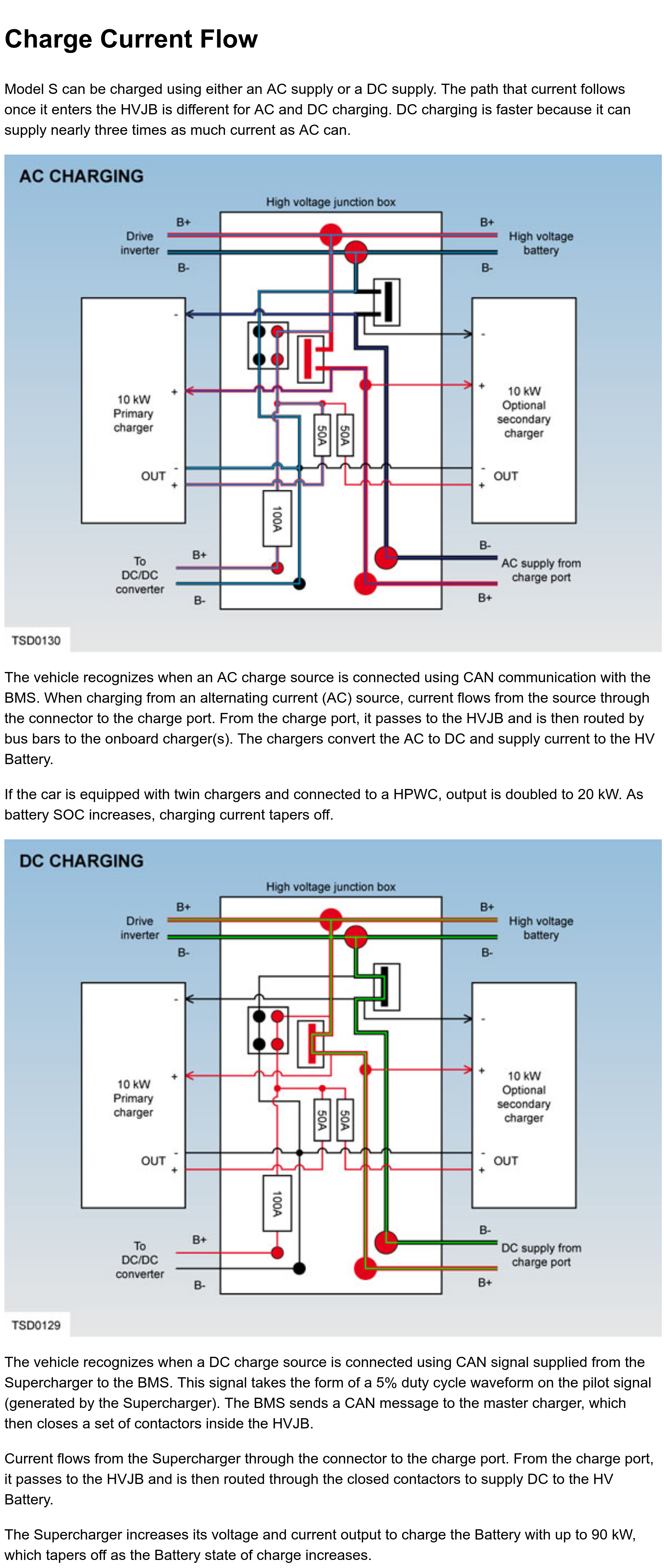

In my case, I don't need to cut off AC when DCFC, because the Tesla OBCs always have tolerated HVDC at their AC input. That's the way the Model S (and our RAV4 EVs, which use the same OBC) do it.you will need contractors to cut you AC lines when configured to DCFC
So when DCFC, just need to close the HVDC contactors in the new HVJB -- via CCS controller doo-dad (in progress).

I had always assumed Tesla used a complex arrangement of switches to do the magic of sharing the same contacts for AC or DC charging.

Nope, I have a GEN1 Model S OBC sitting on the shelf next to me, it's hardware-identical inside to my RAV4 EV's, I've had them both apart, and I bought a Model S GEN1 Rear HVJB to which the OBC attaches, and that's how it works: the OBC can handle AC or HVDC on its input. Operation is described in Tesla's 2012 Model S Service Manual, Theory of Operation section. From our Wiki:
If you follow the Charge Port leads to the OBC's input, you'll see that there is no switch or contactors: it gets whatever is put on the Charge Port's leads.
The Rear HVJB's DCFC bypass contactors close when the SC sends a signal (variously described in that doc as either CAN or PWM 5%, you decide which is correct: I think it's both, personally), the BMS sends CAN to the OBC, which drives the DCFC bypass contactors.
It's a pretty clever idea.

I haven't found a generic J3400 charge inlet with locking, but then I haven't been looking since I posted over a year ago. I expect that more scrapyard options -- besides Tesla -- will become available shortly, as several mfgrs are now selling BEVs with J3400 charge inlets in the NA market. I've still got a modified early MS, plus a later M3, charge inlets hanging in my garage.

Amprevolt has the Amphenol and says that a lock is coming this month.

I never heard back from KST but I found out that Amphenol sells an E-lock attachment for their inlets (Part #: HVEL12NS001) and Mouser has them in stock. They are compatible with the HVCONF01 inlets also in stock at Mouser. I bought one of each and they seem to work pretty well.
