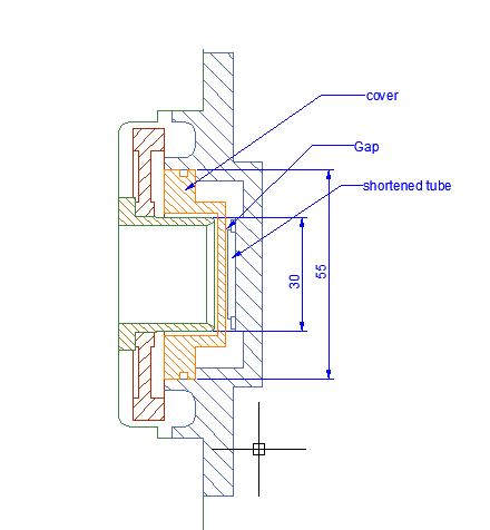

I have a Tesla Model S2014 Rear wheel drive LDU renovation ongoing. I just replaced the bearings and noticed that the rotor shaft is is very worn out by the seal so the shaft is uneven. I tried with speedi sleeve but it did not work- it still leaked.
Therefore I have machined the shaft end to be good and then i have done the hard chrome treatment on the shaft.
I will then have to machine the shaft into right measurement before installing the ring for the vehicle speed sensor ring and the chenmin 3 lip PTFE Seal.
Question:what is the exact tolerances for the shaft end.It should be 30mm but does someone have the exact tolerances?
The vehicle speed sensor ring was 30,2mm in diameter.
Ptfe seal requires Ra value of 0,4. Is this true?
Thanks in advance!

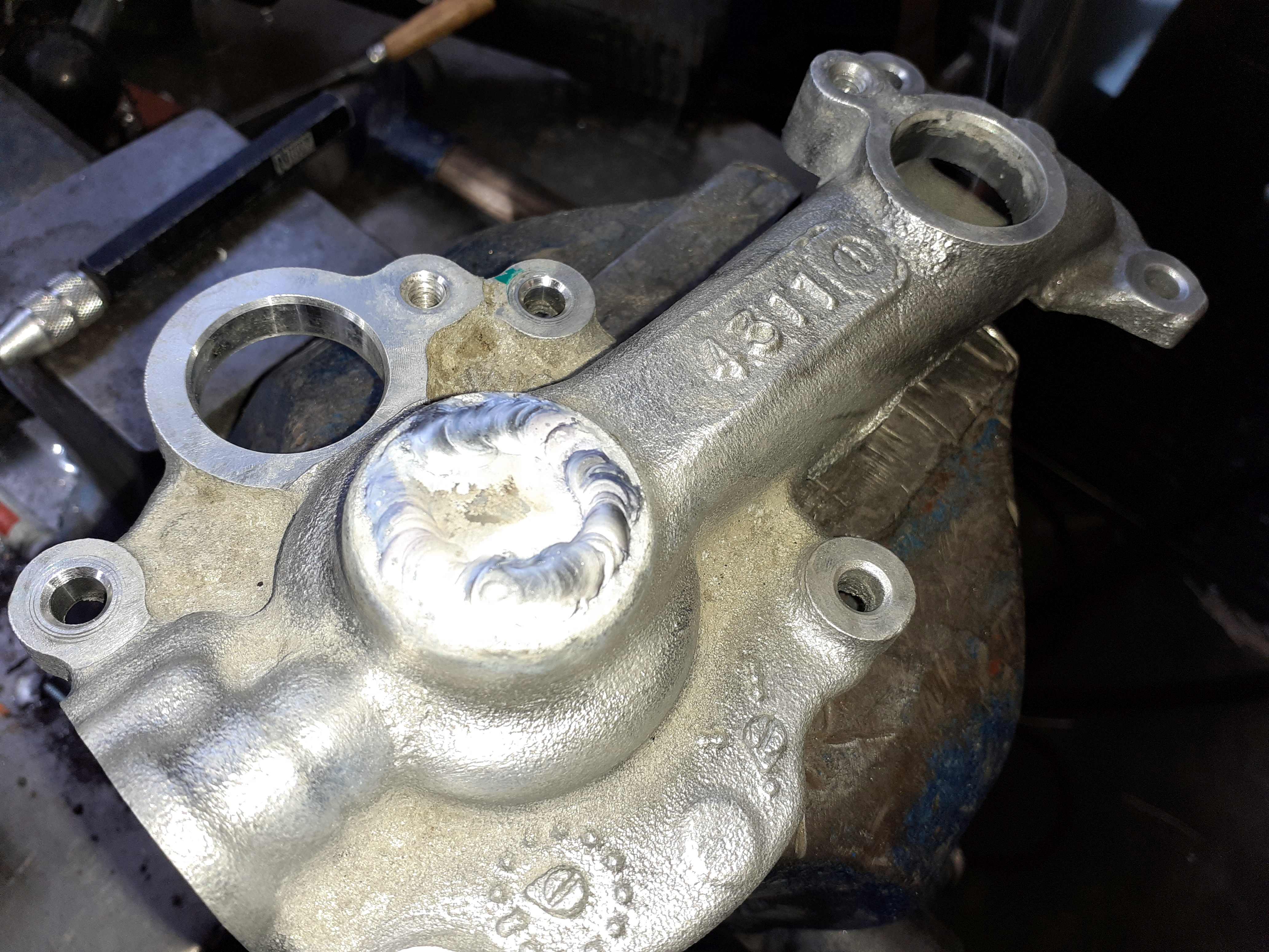

Moodifying an existing manifold should be easy. The tube is difficult to press out, but shortening it up to the retaining ring should work. Then you only need a cover in place of the sealing ring that leaves enough space for the shaft and has a gap to the shortened tube. If the gap becomes too small, a hole can be drilled into the duct below the pipe. I could imagine that omitting the rotor cooling works for lightly loaded engines, but I don't want it for my sport unit!

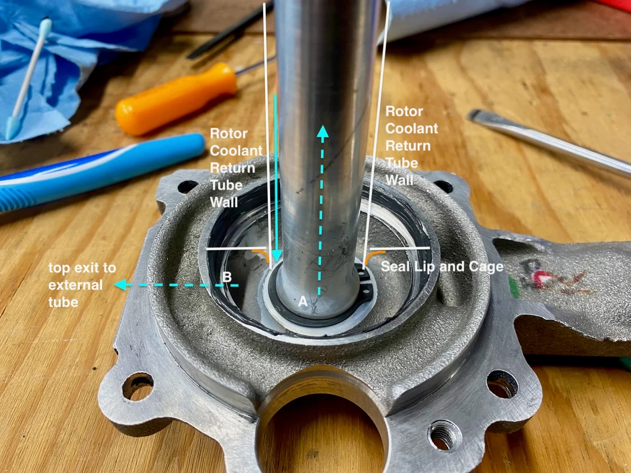

I think may also need to solve the coolant feed on top of the manifold. That feed is from a hole marked X in the diagram
So either seal that hole and route coolant externally or cut the external tube and feed it directly from a T junction in the coolant inlet hose.
If the coolant circuit through the 4.5mm hole just blend with the much higher volume out of stator inside the gearbox casing, then maybe this small circuit is unnecessary. But I don't know the circuit inside gearbox casing.
Would be good to have induction motor engineer evaluate the cooling rather than just assume Tesla's design mod is robust.
Also highly desirable to have additional confirmation Rev U LDU comes with coolant delete manifold for both base+sport LDU. Tesla provides no information so best to collect statistics.

It's a reasonable guess that the purpose of that external tube is for air bleeding the circuit (connects to high point of the LDU, moves trapped gasses on), and that it doesn't contribute substantially to thermal transfer.

There is no reason to run anything externally. The water comes from below, flows around the cover and exits at the top as before. Only the space for the gap could become tight, so it makes sense to drill a hole in the channel. The hole would then be where the word "seal" is in your picture.

muehlpower wrote: Wed Nov 08, 2023 5:39 pm There is no reason to run anything externally. The water comes from below, flows around the cover and exits at the top as before. Only the space for the gap could become tight, so it makes sense to drill a hole in the channel. The hole would then be where the word "seal" is in your picture.
Ok I understand your proposal. Very nice!
- Remove manifold rotor coolant tube
- Custom cap to insert into coolant seal bore to close off the chamber, cap shaped to avoid touching rotor shaft and provide enough gap to let coolant flow into the closed off chamber and exit top of the manifold.
Internal routing solution would be best as there isn't much clearance externally when removing/installing LDU into Model S rear subframe.

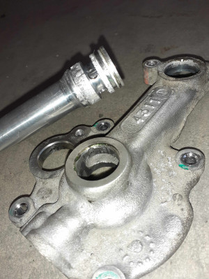

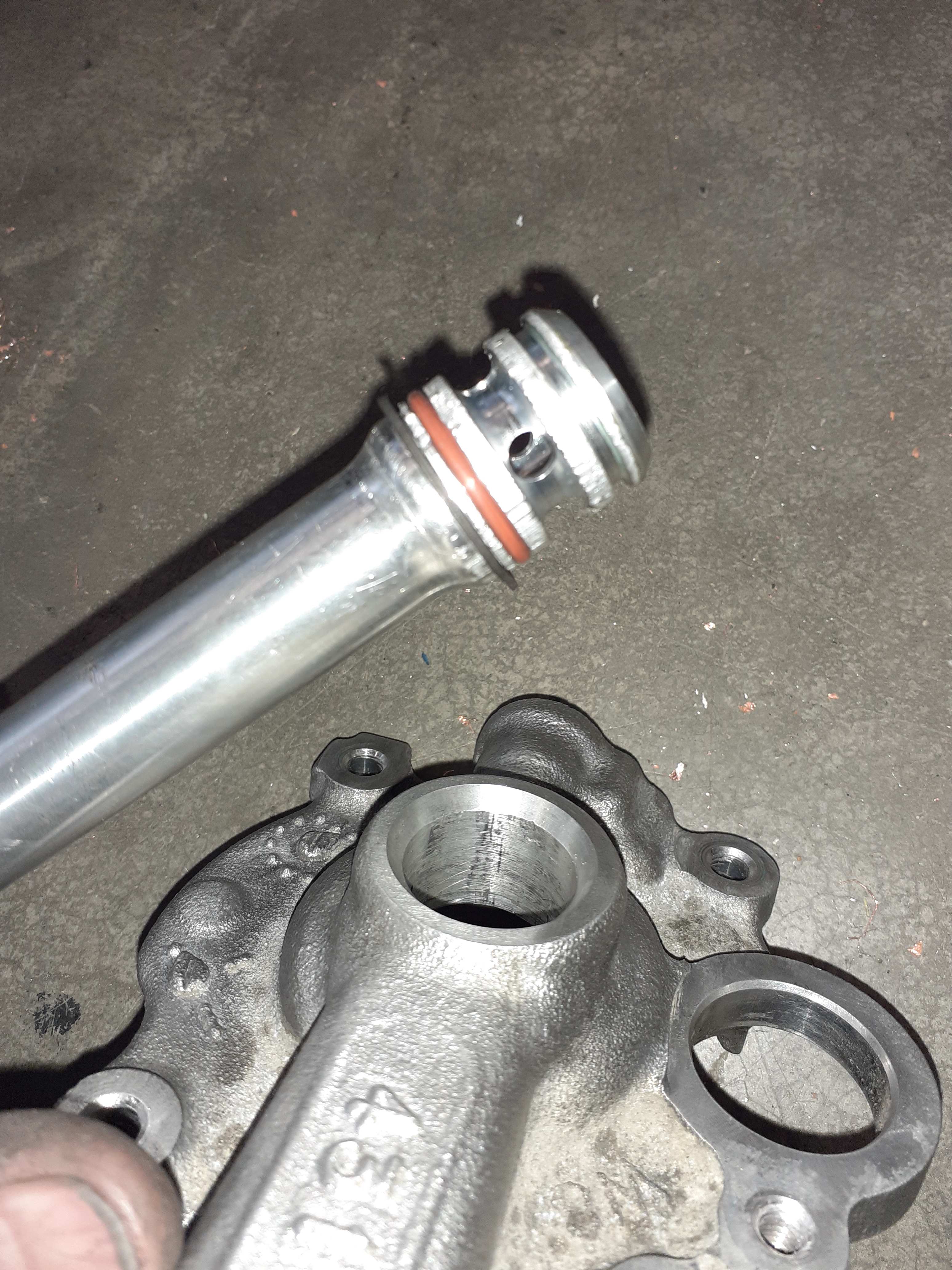

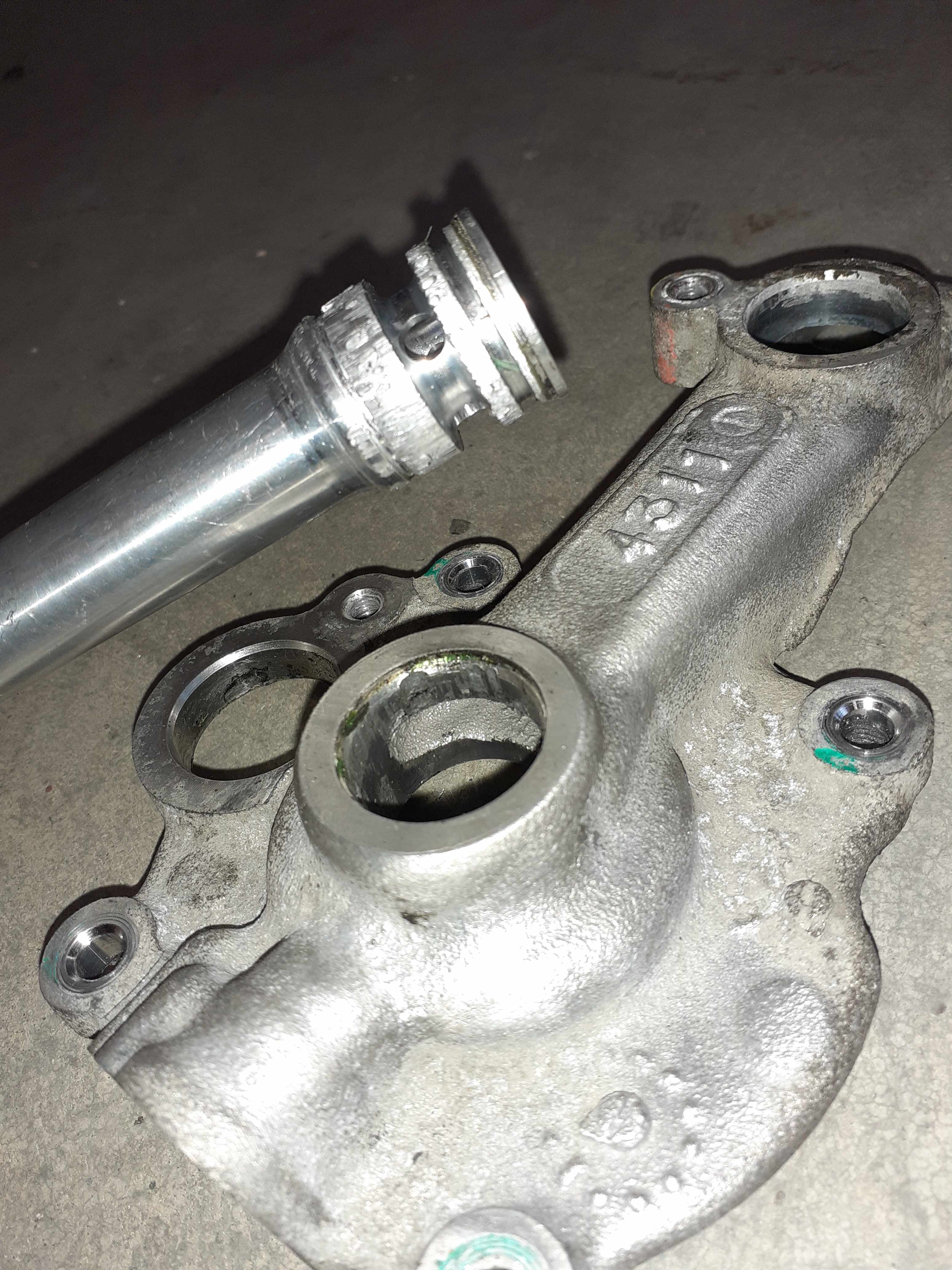

muehlpower
Posts: 807
Has thanked: 18 times
Been thanked: 186 times
Post by muehlpower »
In case anyone has the idea of removing the pipe. I have tried it. It seems to be pressed in and secured with Loctite 271 (high-strength). I welded mine at the end to get it tight, as the bore was very damaged.
