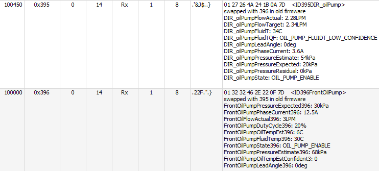

davefiddes wrote: Tue Mar 28, 2023 5:24 pm Ah. I misunderstood. The oil seal housing != oil pump. :)
The oil pump defaults to limp home mode if not plugged in to the Tesla SW. It's controlled over LIN using an as yet undocumented protocol. There are some captures to decode if anyone wants a simple(ish) project. It's down Damien's and my priority list due to the limp home behaviour.
Is it possible that in the last month someone has figured out the Oil Pump LIN bus controls?
It appears to do the following at startup:
0x0A | 0xFF | 0x00 | 0x35 (csum) - First LIN command received - presumably assigns 0x0A to Oil Pump motor ??
0x0A | 0xFF | 0x0D | 0x28 (csum) - Enables oil pump motor controls
0x0A | 0xFF | 0x11 | 0x24 (csum) - Sets default speed when wheel/motor is not spinning
Anyone do session captures while the motor/wheel is spinning and save the actual wheel speed / vehicle speed so we can get the speed setpoint command and actual speed feedback scaling?
Anyone create an LDF of the oil pump motor controls?

I have been sifting through some model 3 can logs and came across this data. Thought it might be useful for the LIN decoding. That data has to be gathered over LIN to be put on the CAN bus.
