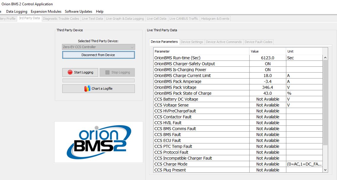

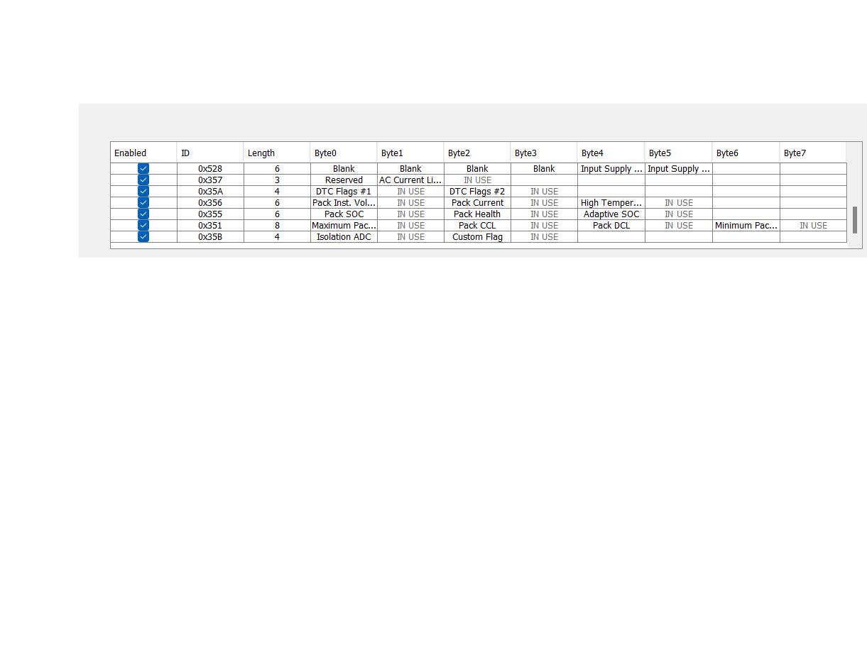

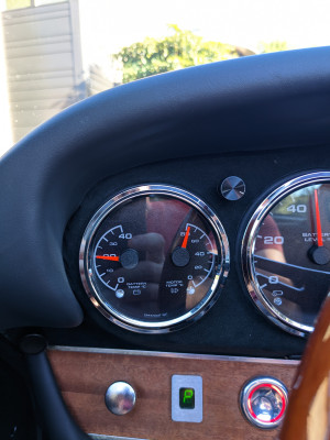

Hello,
Thanks for all the help this forum has provided. The electric Fiero has achieved about 800 miles with the SDU, OI board, charger interface board and Orion BMS. Only a few pesky kinks, one of which is CAN messaging from OI board.
I have Speedhut CAN Gauges and all but the motor temperature are working. Granted, all the working ones are getting their messages from the Orion.
Can anyone offer suggestions on what I may be missing? Based on BMS screenshot, I'm feeling like no CAN traffic is coming from the inverter. Do I need to manually insert a line for this rather than the CAN mapping already done?
Thanks, in advance, for any help here.

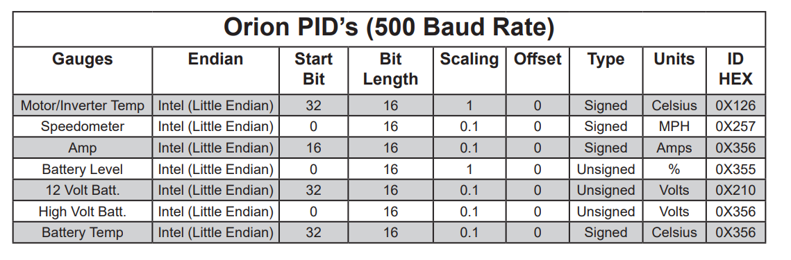

timbradley wrote: Wed Sep 06, 2023 2:11 pm I have Speedhut CAN Gauges and all but the motor temperature are working. Granted, all the working ones are getting their messages from the Orion.
I've got Speedhut gauges and it took a bit to get things working from my LDU. One thing to note: you need something else on the bus other than just the drive unit and the gauges. I think since their EV CAN gauges are based on their OBD2 gauges, they don't acknowledge the messages (so that they don't freak an OEM car out, they just silently observe), so the drive unit doesn't keep sending. It sounds like you do have the Orion on the bus, so that's likely not the issue.
To the best of my knowledge, they don't have separate Inverter and Motor temp gauges. The Inverter message looks correct, based on the attached table, but I'm not sure what you're sending the motor temp to.

Thanks for your note. I have deleted all CAN mapping and tried for just the sole inverter temp and get nothing. Both by a direct entry in the table, and as a command. You're right, that is the only gauge I'm running for temperature around the motor.
Time to get it up on the rack and dig into the CAN wires to see if anything is coming out.
