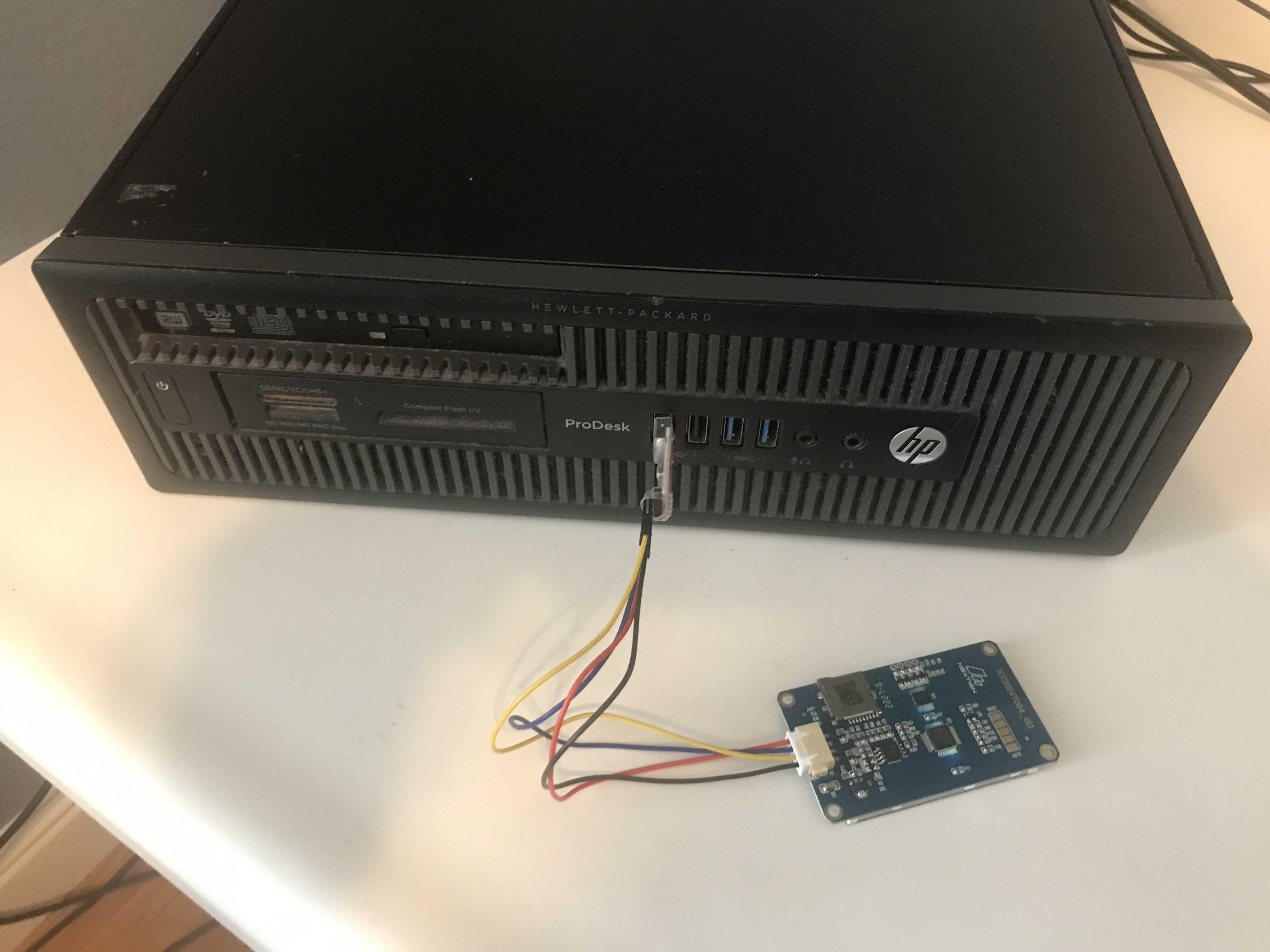

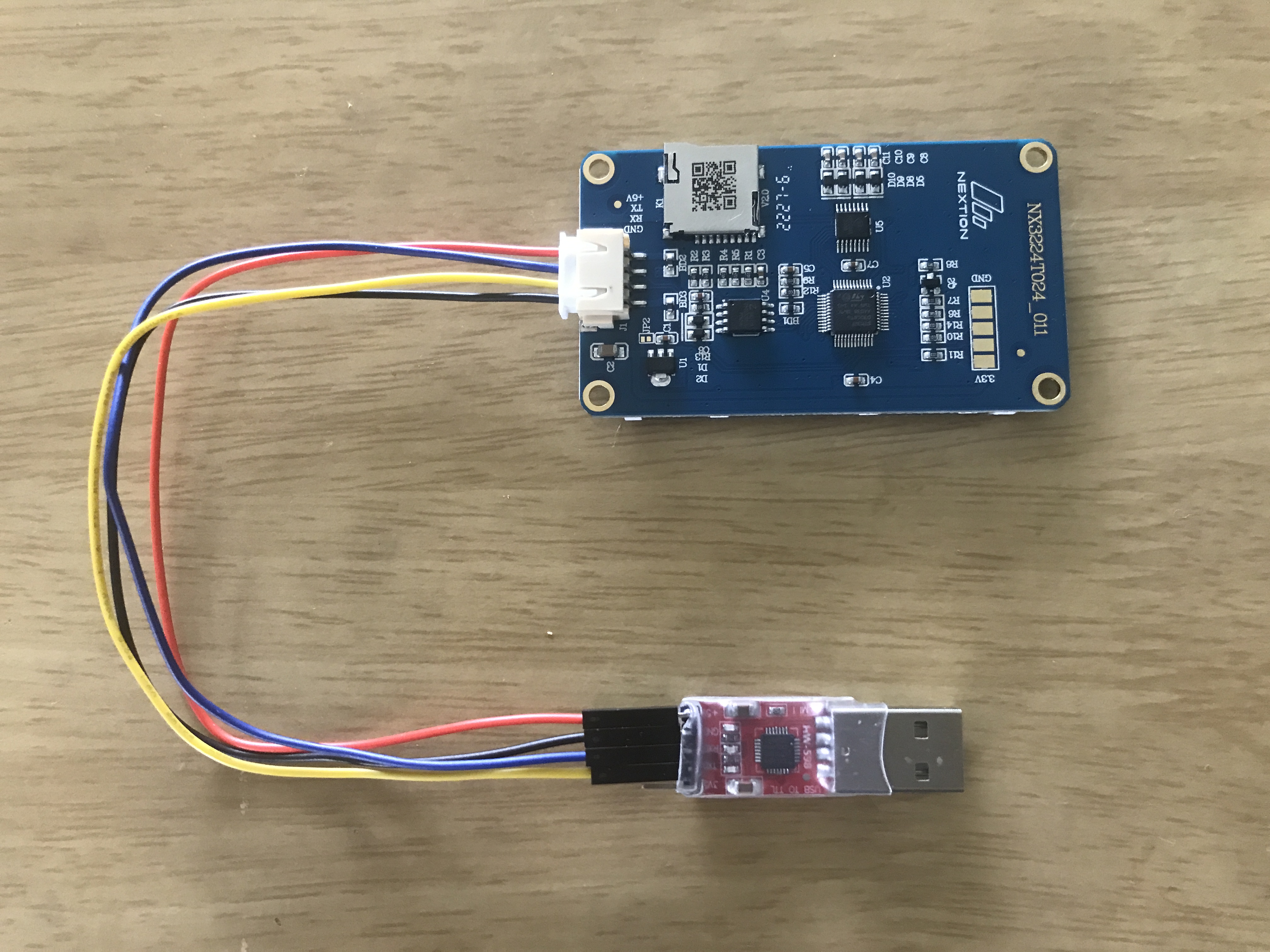

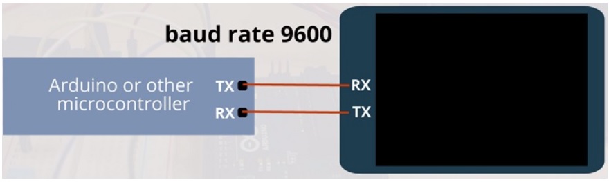

so after the drivers are installed you can physically connect the four Dupont like wires to the CP2102 adapter, it's pretty straight forward, just remember that the Tx goes to the Rx and the Rx goes to the Tx, that little red thingie is labeled as is the Nextion side
Red - you can use either the 3.3v or the 5v (I put mine on the 5v, more is better, lol)
Black - ground
Yellow - Tx (comes from Rx on the Nextion)
Blue - Rx (comes from Tx on the Nextion)
Black - ground

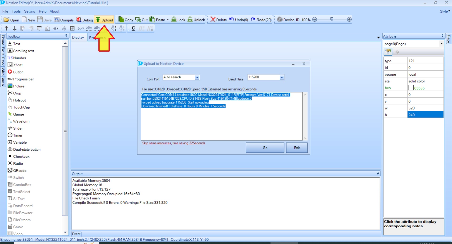

OK, now that we are tethered to the PC instead of clicking on File \ TFT File output, we will click on the Upload button on the menu, leave everything as is aka Com Port: Auto Search, cross our fingers and simply click Go... and watch the magic happen, and that's it that's the other way of saving that TFT file to the Nextion display, so you do you
found this video on YouTube for you

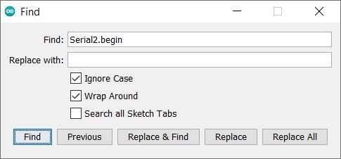

please keep this in mind as as you sharpen your coding pencils
The Nextion has a built-in ARM microcontroller that controls the display, it communicates with any microcontroller using serial communication at a 9600 baud rate, so it works with any board that has serial capabilities like our beloved VCU.
this means the first thing we need to do is search for a line of code that has this string in it: "Serial2.begin" and change the baud rate in it to 9600, it may look something like this:
Serial2.begin(19200); //setup serial 2 for wifi access
I like to just remark the original line of code by putting two whack whacks in front of it then copying that line directly below it and making my changes in the copy, and since everyone is watching add some internal documentation inline
// Serial2.begin(19200); //setup serial 2 for wifi access
Serial2.begin(9600); //setup serial 2 for Nextion display

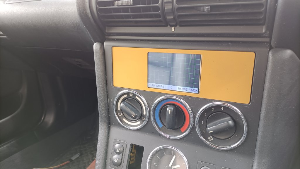

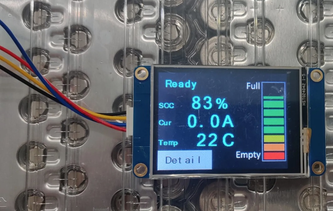

I like the way this went from a question to a tutorial
I have to say once you get used to the nextion editor and get the hang of how you send data to and from the device they're really flexible and simple I started using them about 4 years ago when I used one in my airide setup and haven't looked back I currently use one in my Z3 to monitor bms, charging and even interface with my VCU to give an eco/sport function
the only issue with them is that they can be pricey

very nice, I see that Nextion makes four lines of displays, so which one did you go with, I ask because my Basic Series struggles with displaying all the data I am trying to send to it at 9600 baud rate and I am not sure if we can increase it on those models, I think maybe one can on their Enhanced seriesandybpowell wrote: ↑Fri Aug 25, 2023 8:22 pmI have to say once you get used to the nextion editor and get the hang of how you send data to and from the device they're really flexible and simple I started using them about 4 years ago when I used one in my airide setup and haven't looked back I currently use one in my Z3 to monitor bms, charging and even interface with my VCU to give an eco/sport function

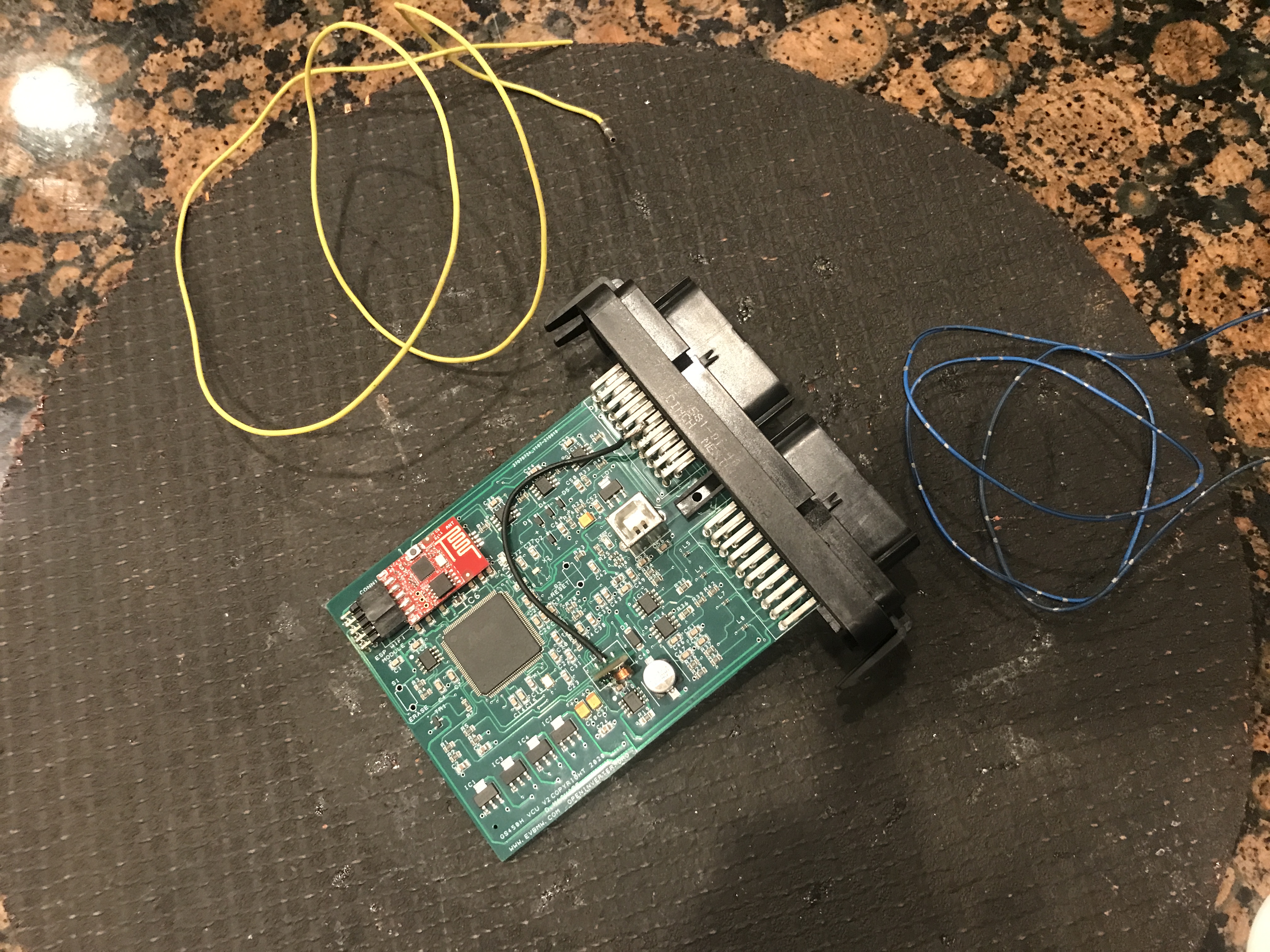

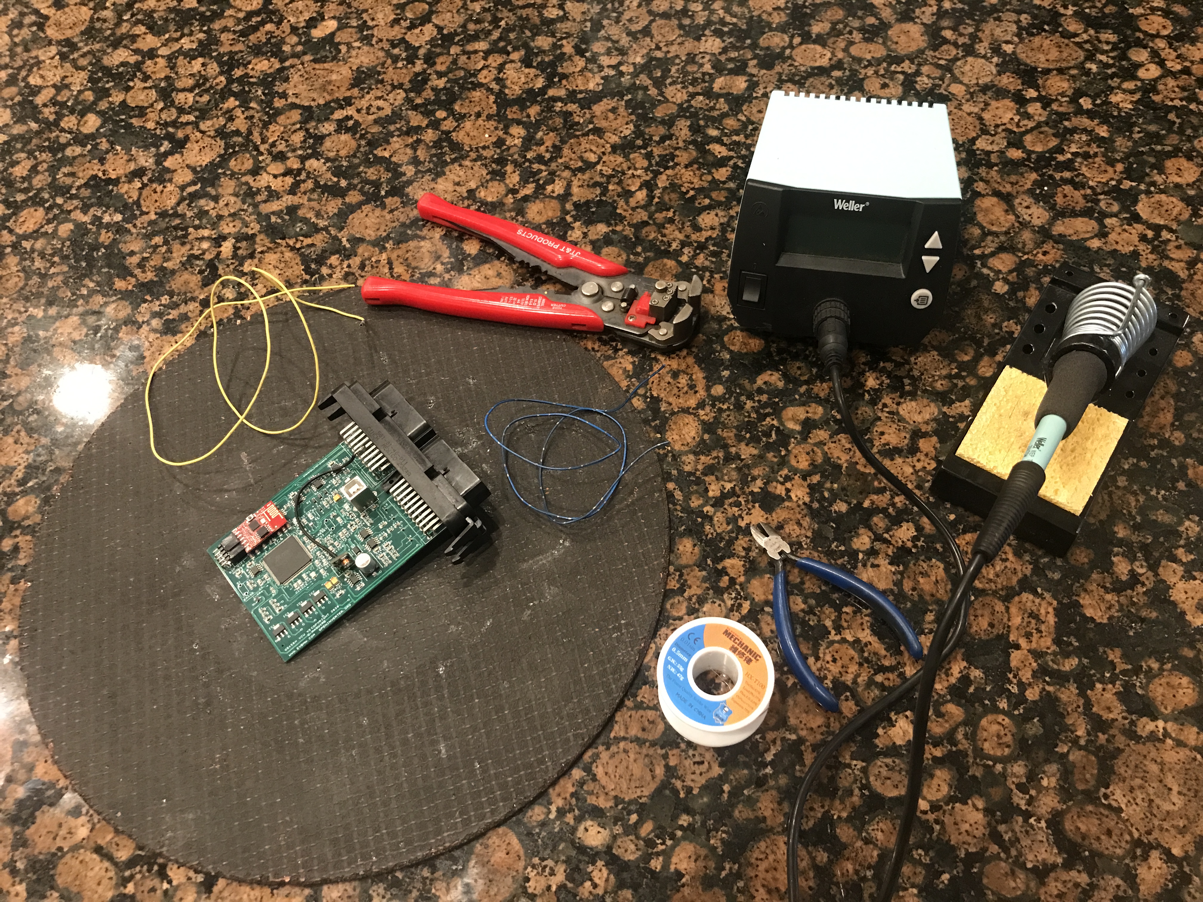

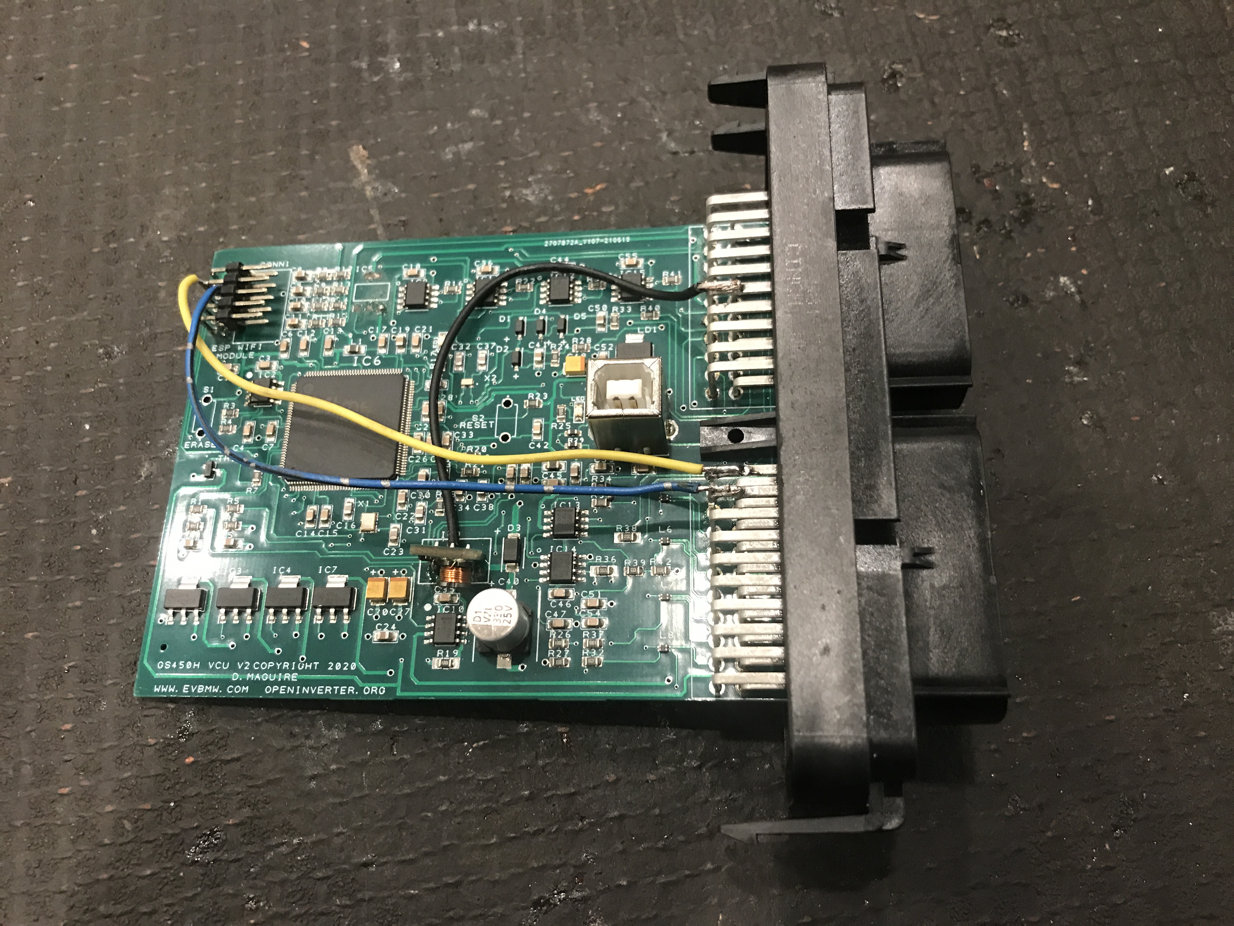

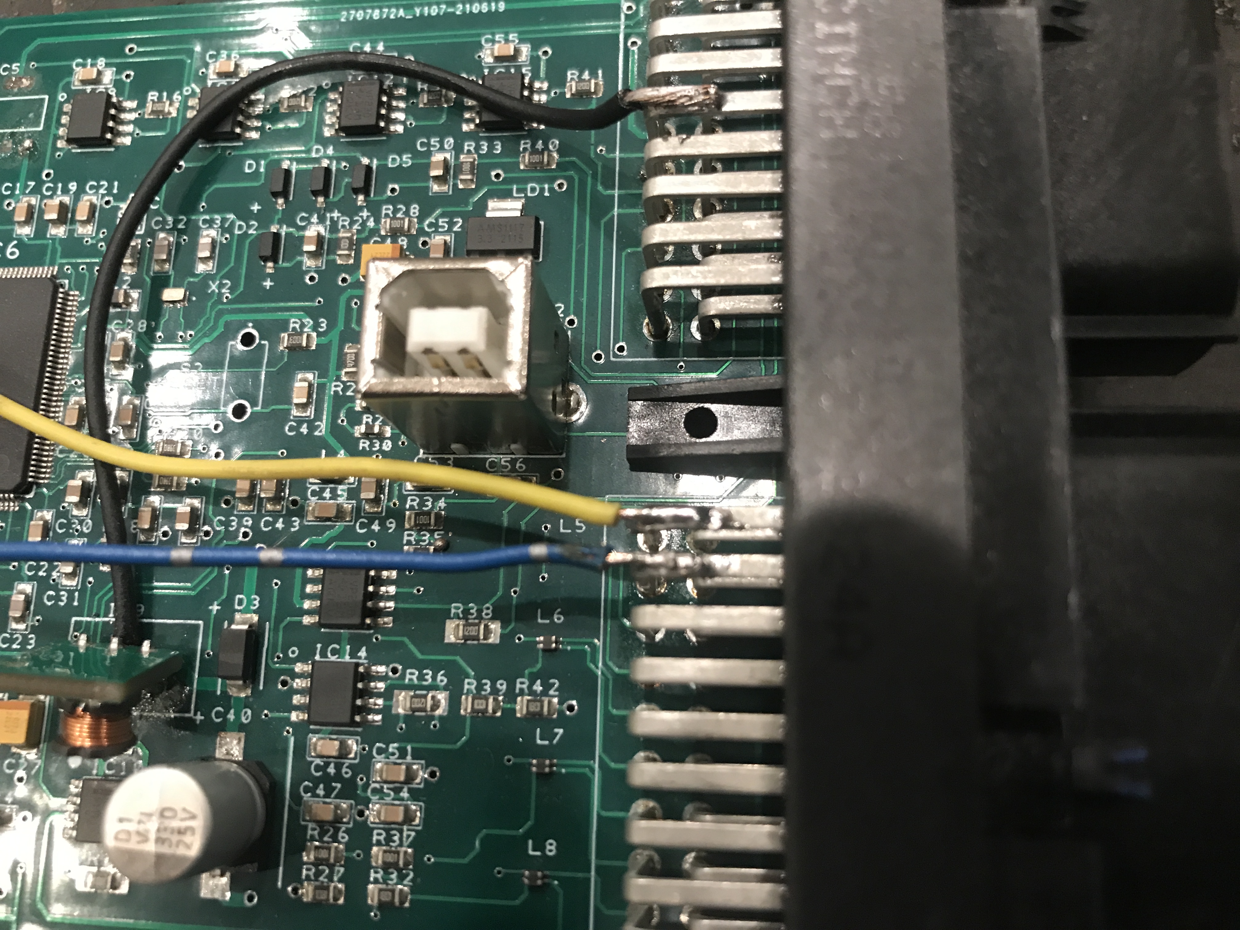

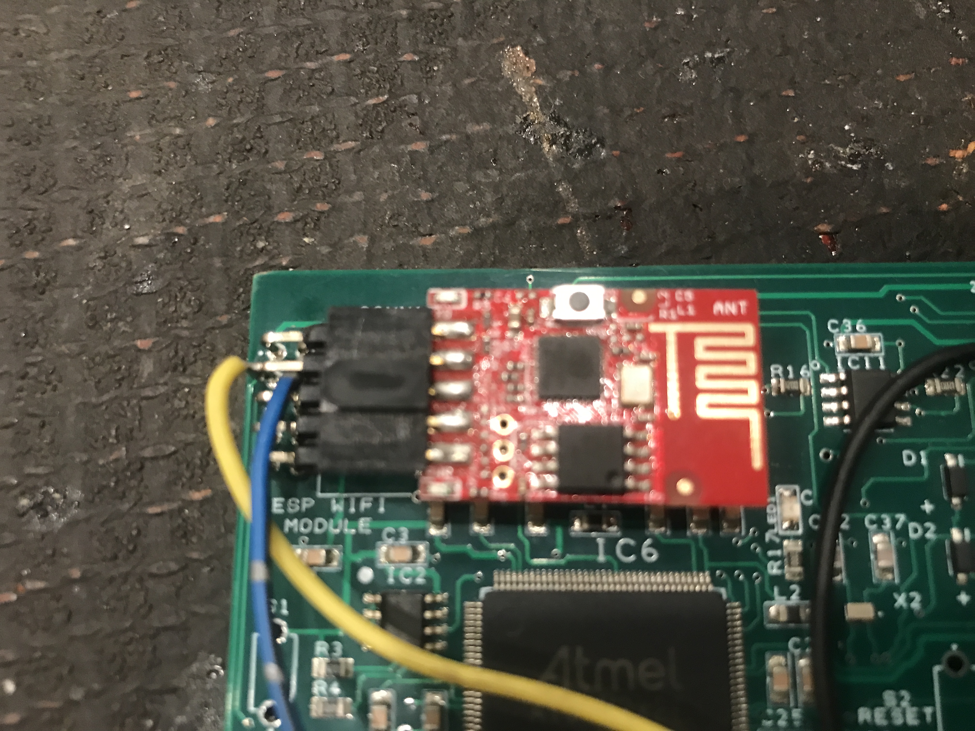

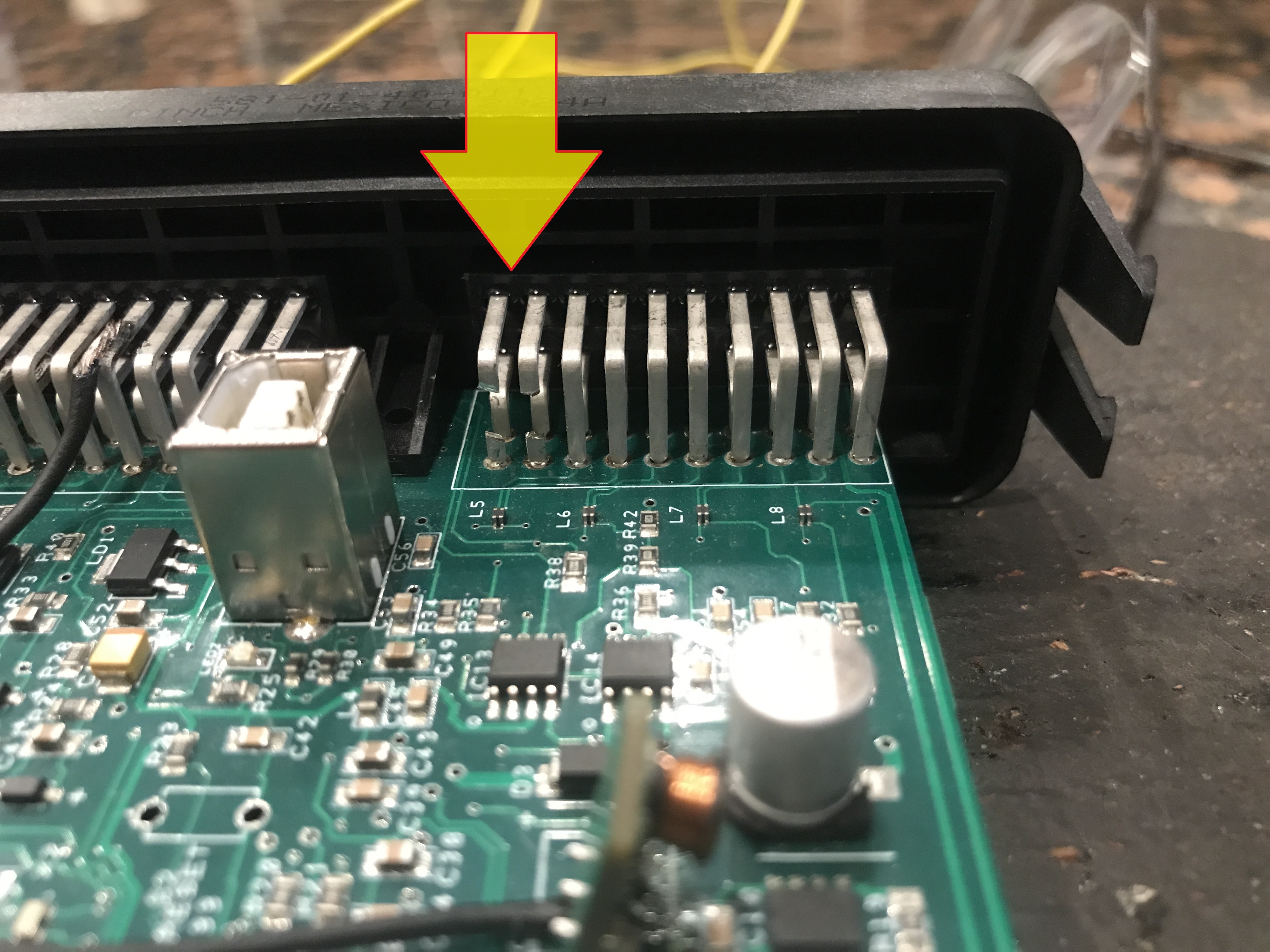

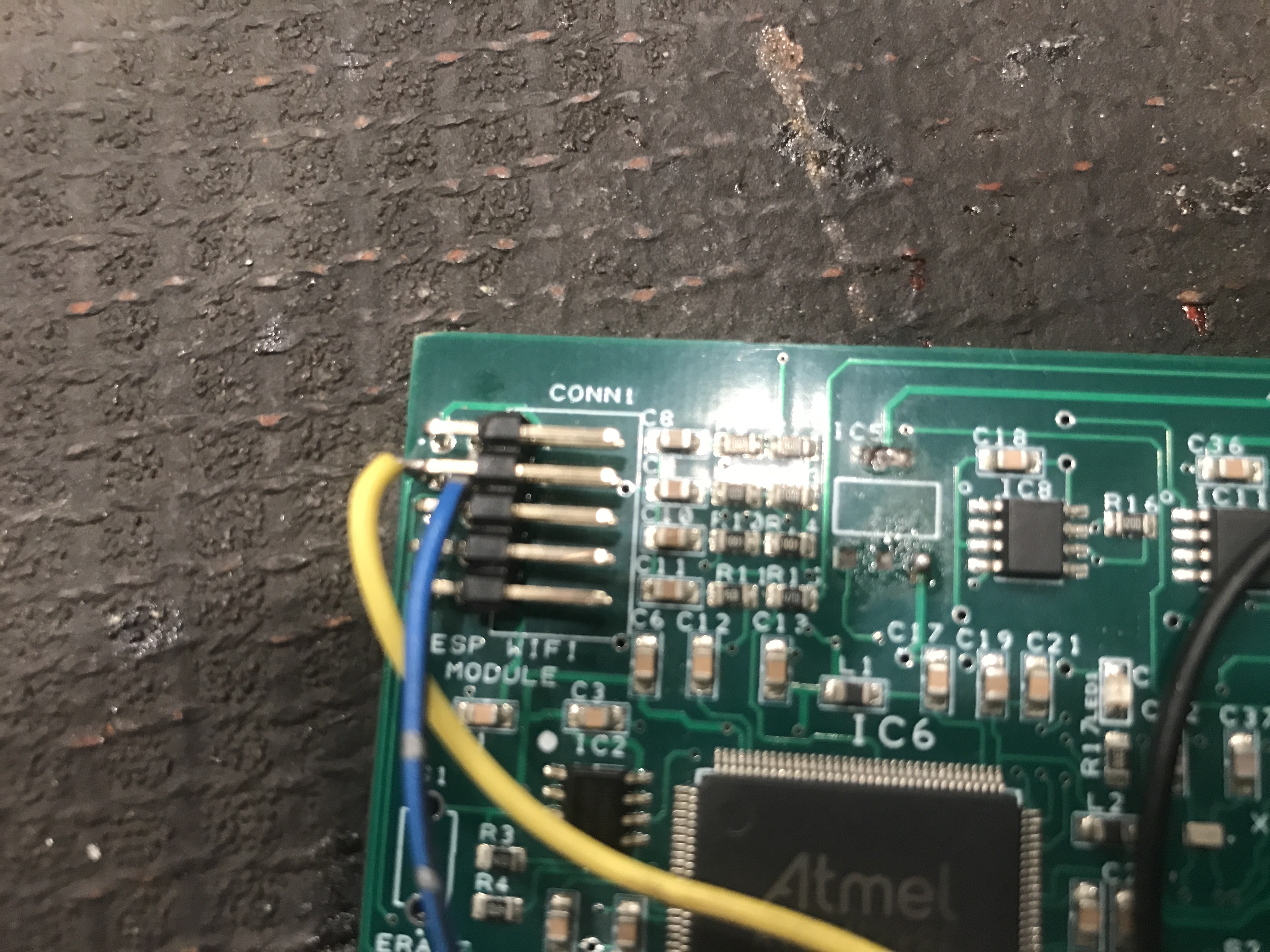

a little VCU VooDoo to make the UEXT connector spew out data via one of the regular 20 pin connectors so that we can put the case back on the PCB
the red thing is the older design WiFi card, it's pretty bad @ss for that little thing, it is literally a WebServer/DHCP server, yes that little guy
please don't mind the black wire, it's from a prior voltage regulator repair (the ground in middle earth of the PCB got destroyed)

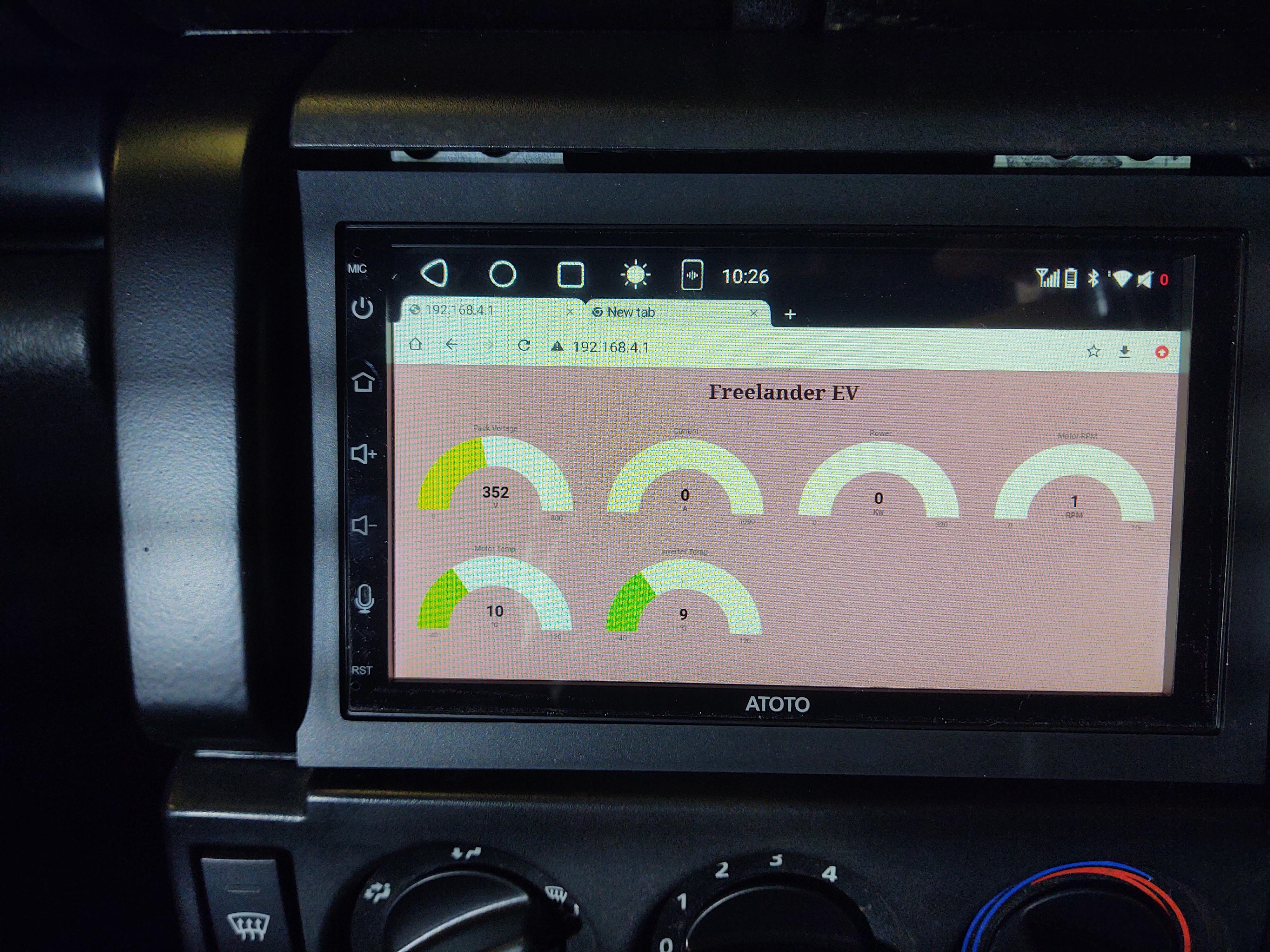

the best part about this crazy solution is that you can still plug in the WiFi card back in, so I hope to use it to display digital gauges on my Android tablet, and charging status on the Nextion when I am in Charge Mode

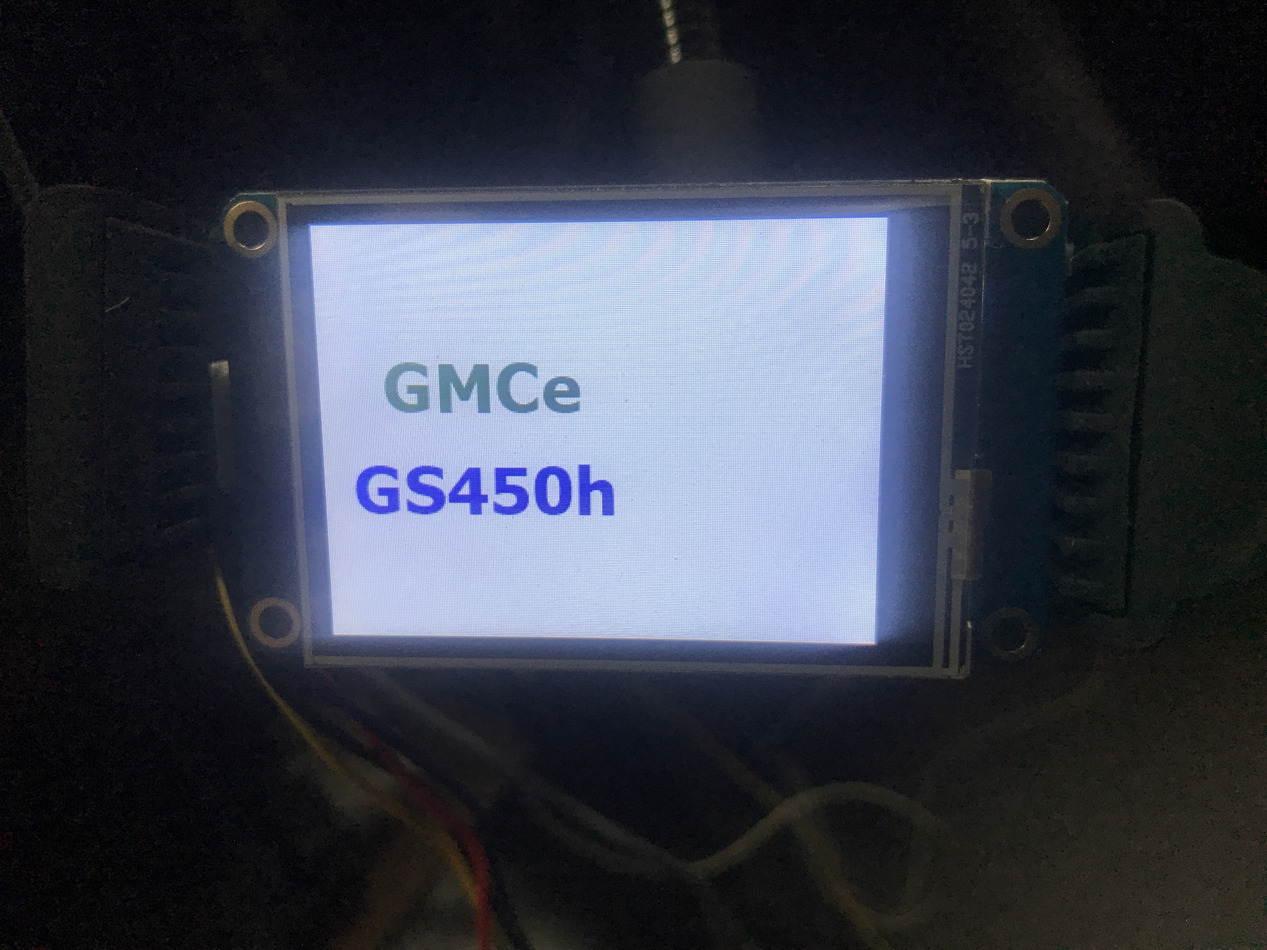

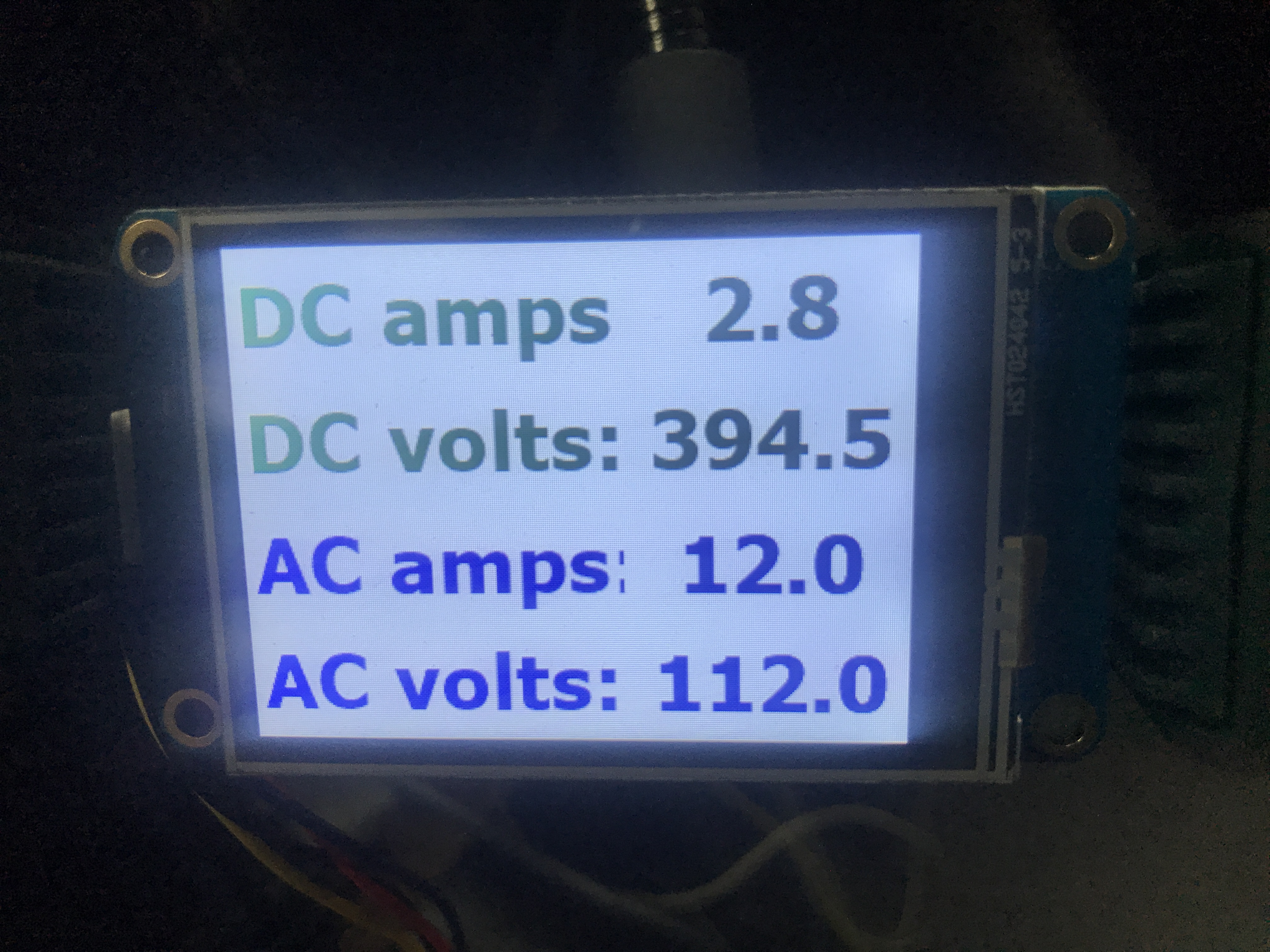

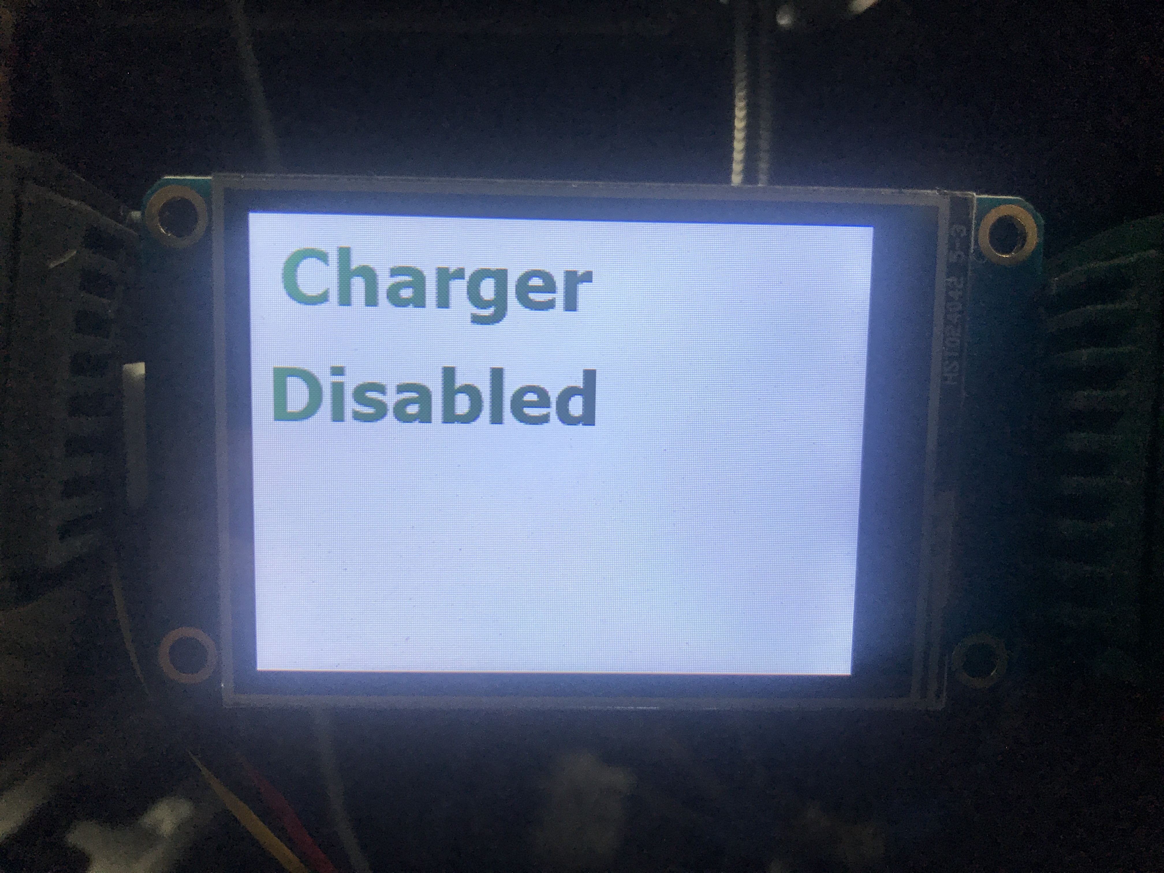

Another Enuff About You and More About Me Update: AEAYaMAMU
so just made some more better screens on the Nextion to show my super very simple charging cycle (there is an explanation for some of the text not being centered on the scree, I am simply sharing / reusing the already defined text boxes)
1. The Nextion display is simply powered on and waiting to see which way I turn the key in the ignition switch (Left = Charge and Right = Not Charge, lol aka Drive)
2. Here we are charging showing AC electricity going in (what I call "pulling") into the Chevy Volt charger and DC electricity going out (what I call "pushing") electricity out of the charger and into the BMW PHEV battery pack
3. and this is a simple message that tells me the charging is done
so I just used the same 8 boxes/fields to display all this, essentially 4 on the left for labels and 4 on the right for values, but at this time still all four created just as text boxes, still learning and trying to figure out this Nextion VooDoo

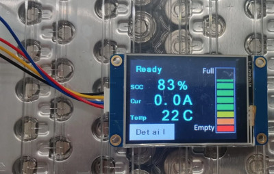

hey! these guys stole my idea, but they did it a few years sooner
VERO ELECTRIC 2.4″ BASIC BMS DISPLAY
