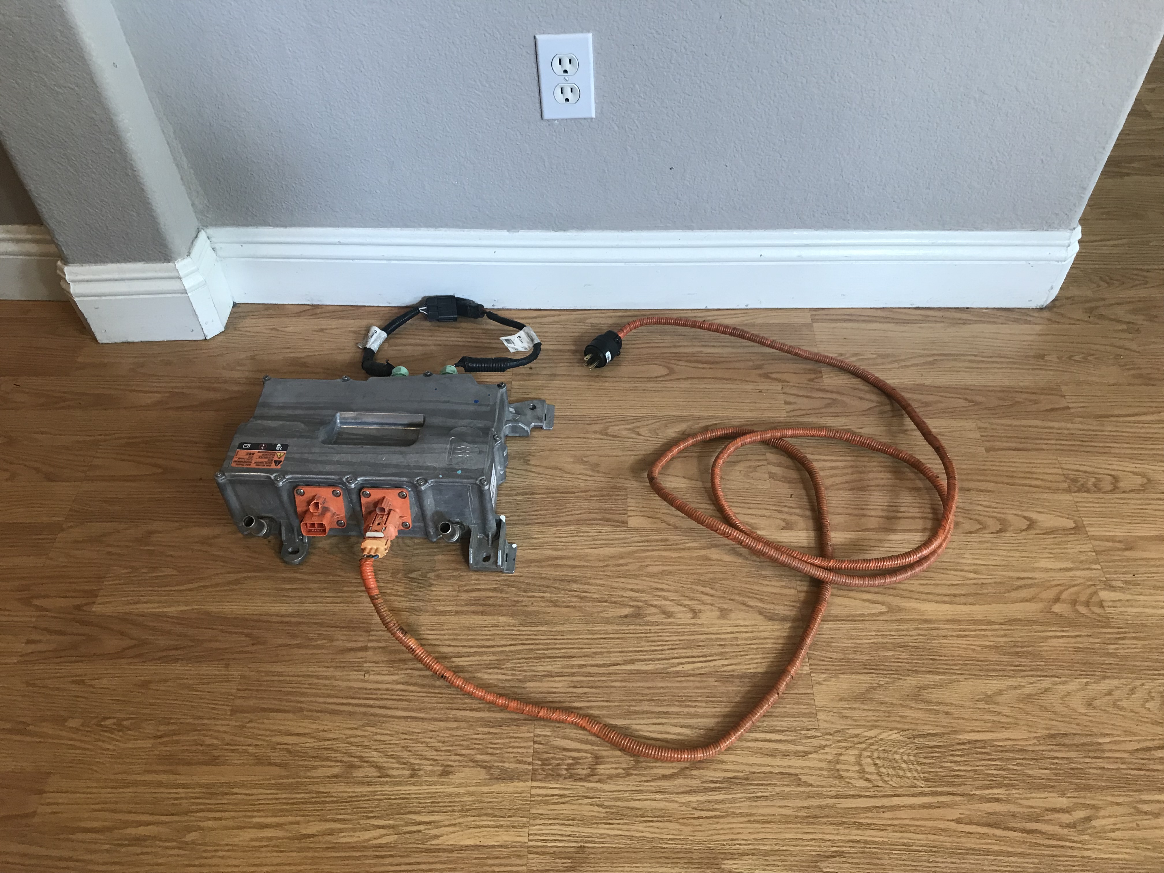

so if you take my first gen Chevy Volt charger and plug it into the wall here in the States it shows that it's pulling 12 amps AC at 112 volts (so 12x112=1,344 watts) so does that mean it's charging at 1.3 kW
~ OR ~
since it's pushing 3 amps DC at 378 volts (3x378=1,134 watts) so does that mean it's charging at 1.1 kW?
[shown below for demonstration purposes I do not charge it off the truck without liquid cooling it]
well of course I had to do it

Yeah... well it is a good marketing. Whenever you are selling a device you look at the AC side and brag about how much current it DRAWS from your outlet. That is your power draw. The opposite side would come in handy if you would have to declare power imprint for taxes ;).
In europe you would draw 230Vac x 12A = 2760W from AC for example (courtesy of single transformer output vs split transformer in US...).
While with that particular draw charger would push about 6A x 370Vdc = 2220W on the DC side. What is missing we chalk up to 540W losses (switching and resistance) in an inperfect world. Of course i made the numbers up for better clarity but when i had Volt charger here i remember i observed about 370W losses. The higher the load was the lesser losses were proportionaly....
About the best efficient charger i observed was Volvo V60 hybrid charger = Eltek 3000W charger. It had only about 220W losses...
