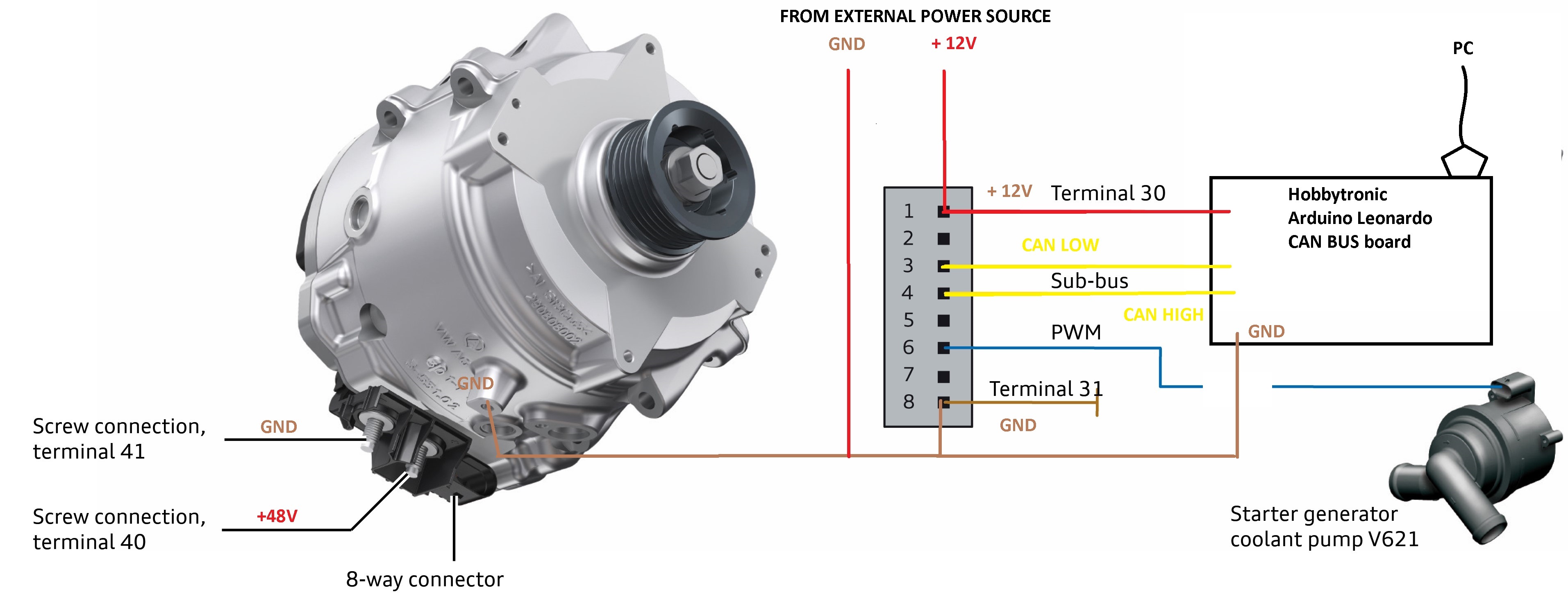

Hello
My setup for reading 48v starter-alternator CAN BUS messages without the car looks like this:
48V Power supply is not needed if you only want to read CAN BUS signals coming from starter alternator.
GND connection from terminal 31 to 41 or alternator body is needed.
Arduino code:
CAN_Sending_And_Reading_Alternator.zip
(5.66 KiB) Downloaded 1028 times
(I only know basic stuff about coding so most of the code copied)

CAN logs without the starter alternator connected to the car are useless and even CAN logs from car are useless without description what was done at the time logging.
With Audi Belt Starter Generator (BSG) I have some experience. Audi BSG sends out some data like rpm, temp, voltage and that's it. Mimicking engine ECU signals does not help to get BSG to rotate. First engine start is always made with 12v starter, then BSG checks if everything is ok and then it starts engine if needed.
There probably is a diagnostic tool function to activate BSG on the table and this is how the Chinese made tools are driving BSG, this diagnostic tool function is not present in ordinary ODIS -vag diagnostic tool.
The whole project is very coding heavy. A lot of code needs to be written in order to make this BSG useful.
I have had fun written some code and learned a lot. My current setup is based on Arduino Uno R4 WiFi. Currently
I m working on basic diagnostic functions like reading identification, coding, measured values, fault memory. It all takes time to learn, but I'm having fun.
