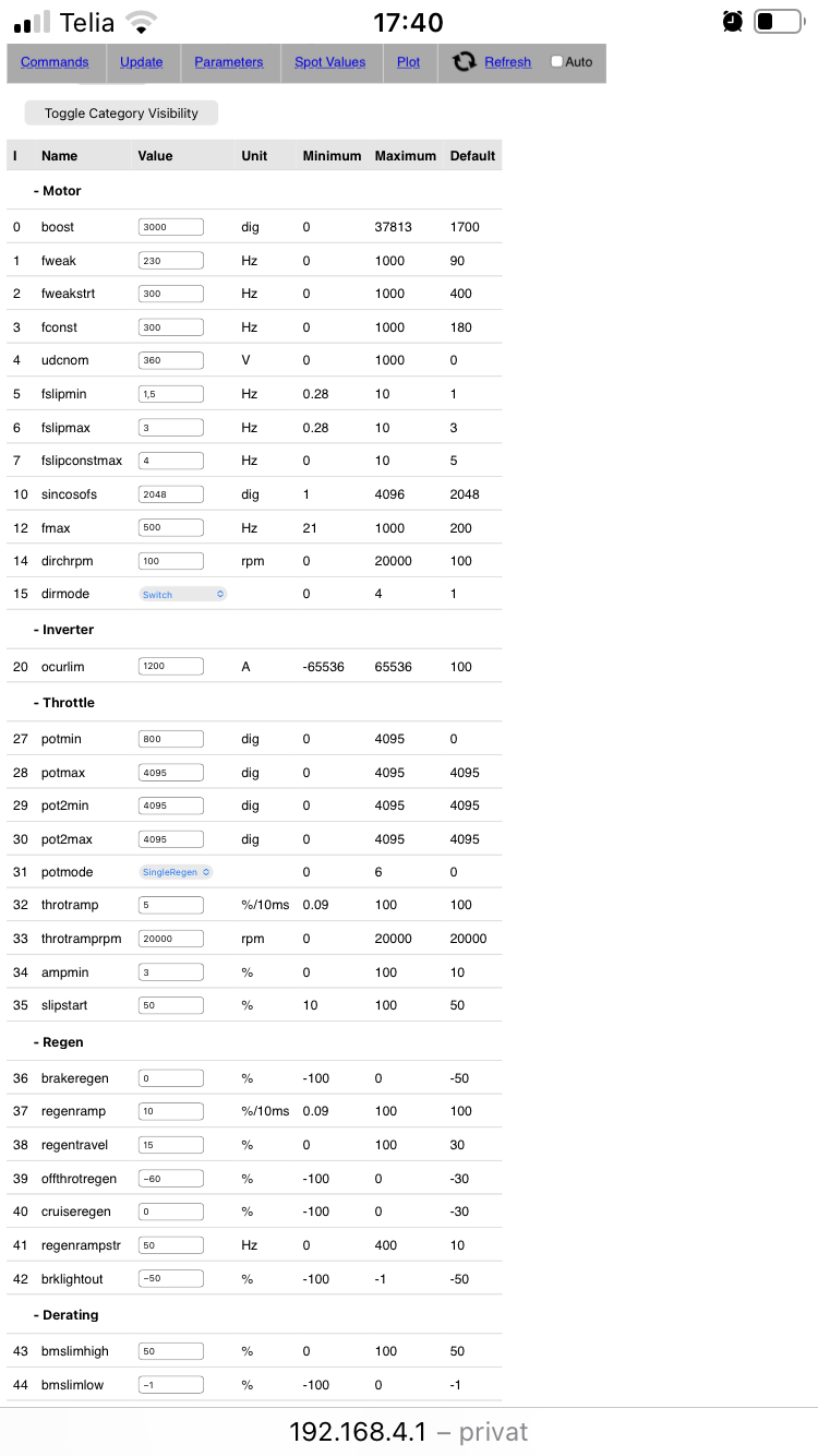

Im running R sine 5.20 and almost unchanged values from dellivery of my v6 board from Johannes. The car felt almost perfect so I have only tried different settings with regen and lowering boost from 3800 to 3000.

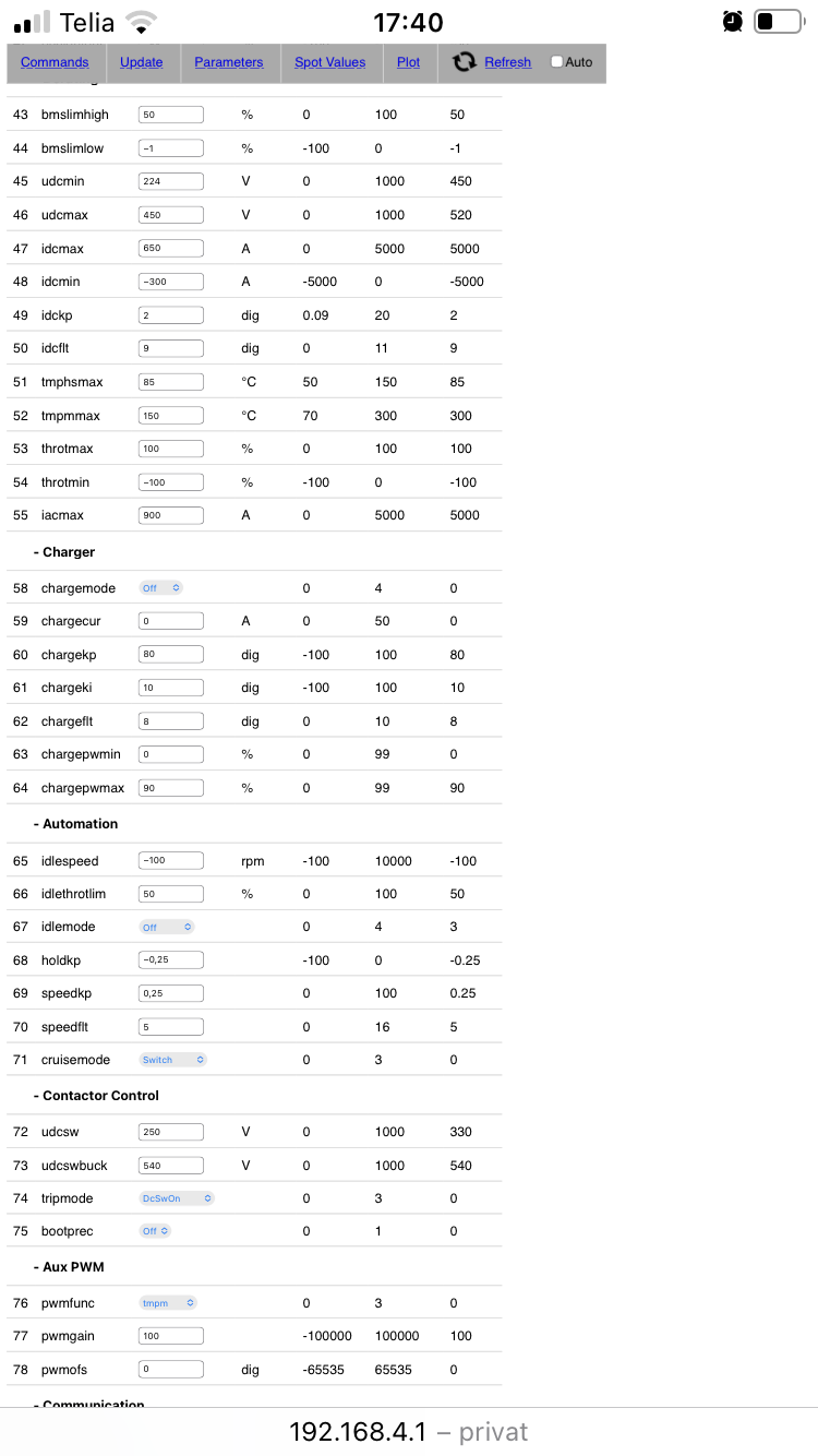

I think it must be the temp derating. Check your cooling works ok and raise tmphsmax to 110°C.

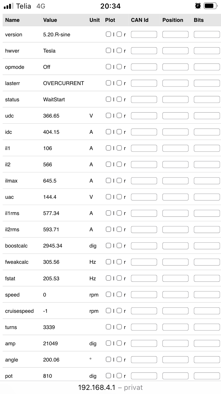

Waterpump not flowing enough or have given up and tempsensor far away from inverter fooled me. Indicated 24 deg celcius on guage is much more deg in inverter. Long but gentle driving and first full pull day after then charger heating water and inspired drive from start lead not to limp home but overcurrent and inverter shut down. Testdrive tonight lead to annother overcurrent when I did a 50% throttle pull so inverter have got beaten up for sure

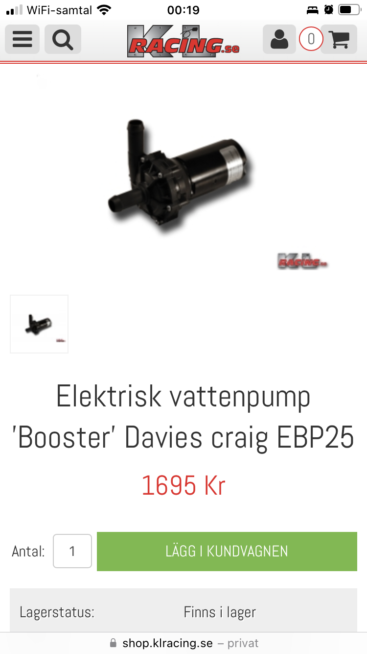

Any ideas what pump to search for? Craig davies?

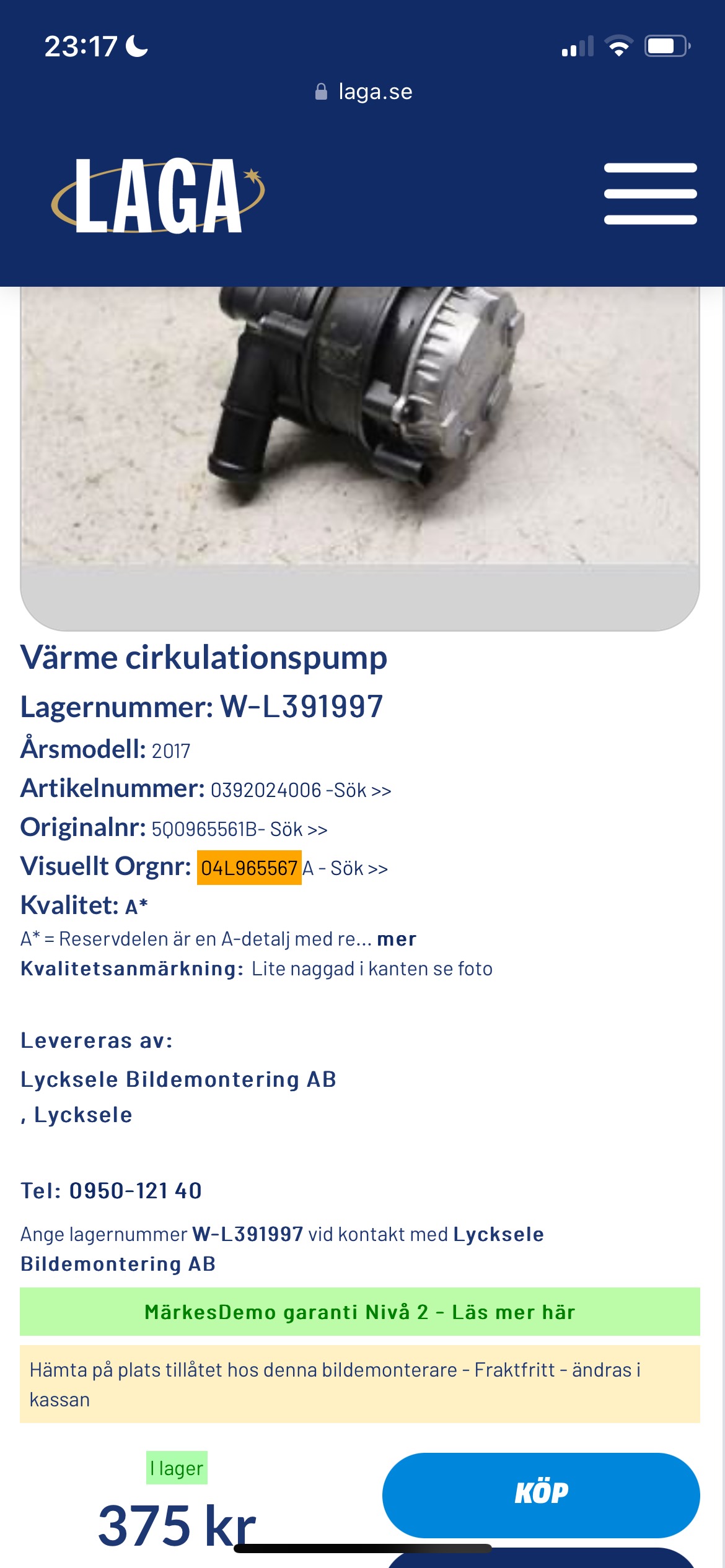

Very good. Nissan Leaf pump perhaps?
Also just noticed tmphs can't reach 110°C so more like 95°C should be the maximum

I’ll check leaf pump

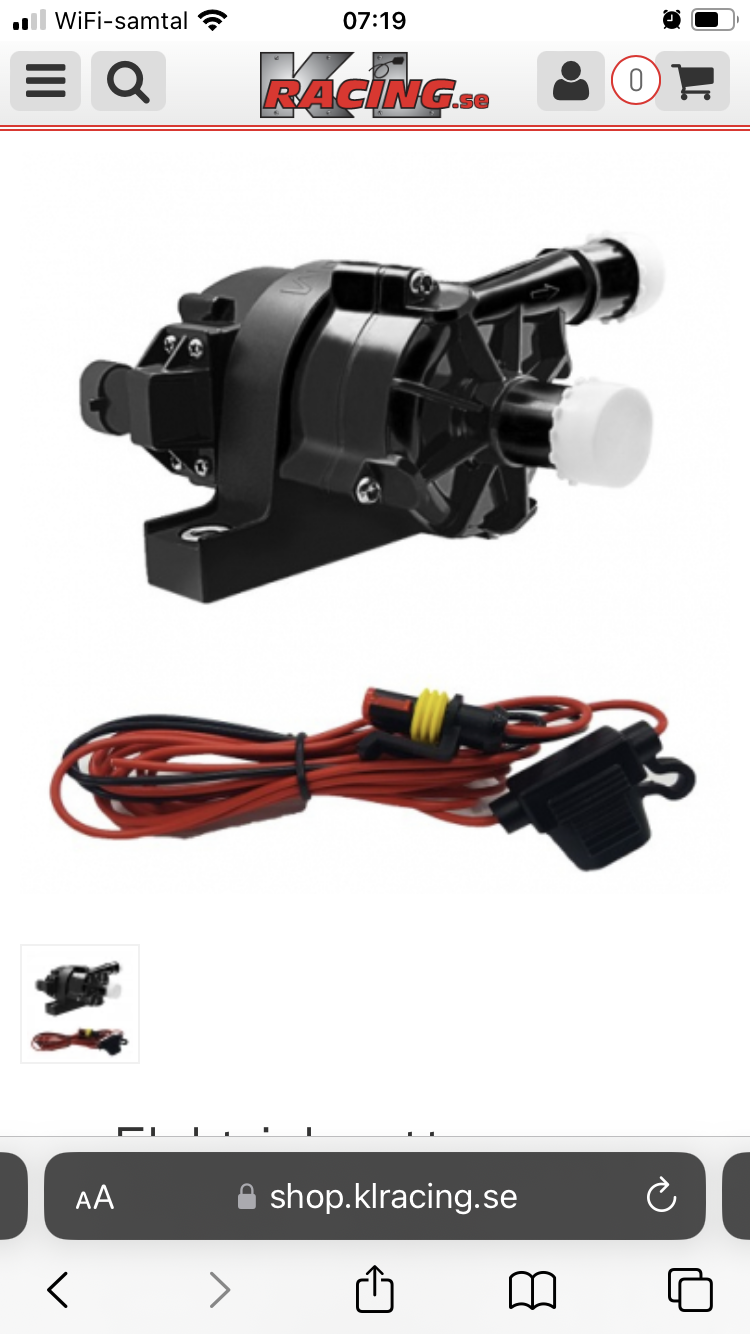

Got an diy alternative found in vw hybrid and electric cars with 19 mm tubes otherwise 2 models that could work from davies craig called boosteroump. First one dellivers 25lit/min and a more powerful version with 27lit/min with a pump outlet pressure of 0.85 Bar for just under200 Euros.
