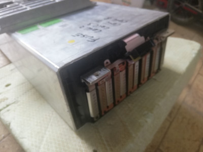

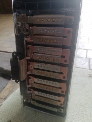

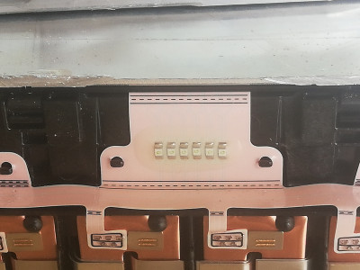

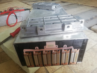

I found out that one of my 12S modules has a problem. Actually they might be 2.
My BMS cant see 4 cells since it seems two fuses are broken.
I inspected the contacts by multimeter directly and indeed i couldnt get a contact with 2 cell lines.
I decided i have to see how to make those lines detectable again.
1. I purchased 10x Fuse 1206 750mA from aliexpress
https://www.aliexpress.com/item/1904023 ... 1802520TjT
2. I used the angle grinder to cut into the welds and knock the side plates off the 12S module.
Under those plates were the cell tabs where i could directly measure the cells. All the cells were fine. 3. I identified the broken fuses and tried to replace the fuses. I found out the fuses were glued by some resillient compound which didnt let me fet to the fuses directly. I tried to get to the fuses via soldering iron heat and replace them but it didnt work i managed to overheat the track and it seems it still doesnt provide the clear line to connector.
I posted some photos of 12S internals for posterity
I have to think on a different plan of how to get access to cell lines...
Anyone has any suggestions? I will accept any idea...
tnx

I'd try to flex the compound over the fuse away, so that there is clean access to both pads. And just solder the new fuse on top of the old one, this eliminates the risk of breaking the tracks. The "dremel way":
When the tracks are already damaged, then the next quesion is: Is this copper or aluminium (like I saw on the tesla batteries)? If copper, then just scratch the covering plastic until the clean copper is there, and solder a (very) thin wire. If it is aluminium, I have no idea.
- EV_Builder
- Posts: 1205
- Location: The Netherlands
- Been thanked: 37 times
Re: ID.3 and other MEB battery packs in conversions
Dremel the fuse away but leave the tinned part.
