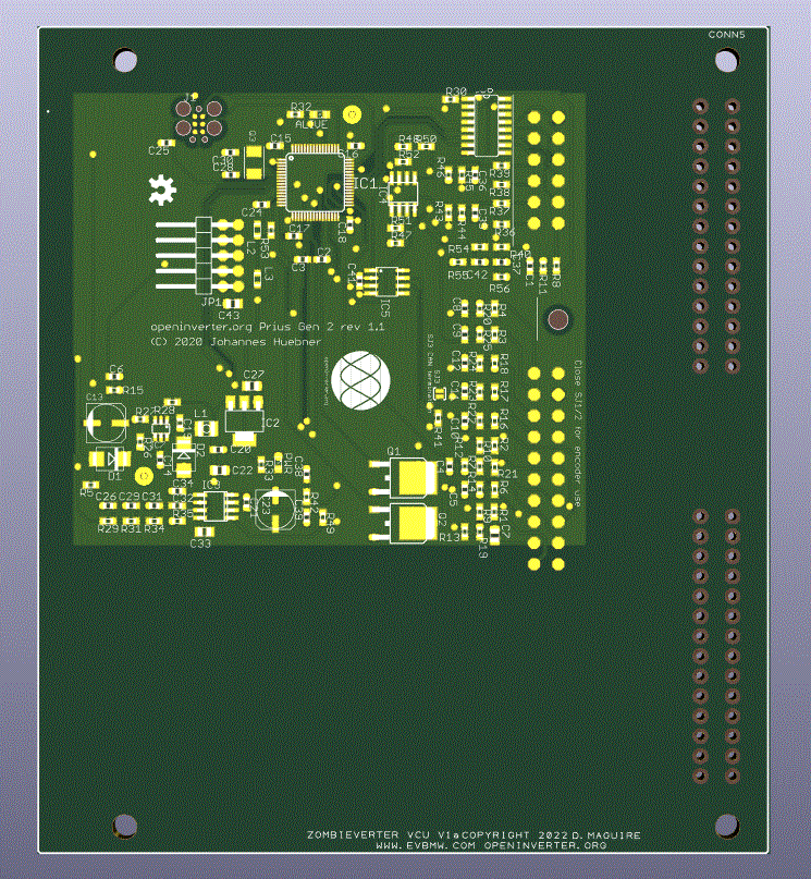

Testing Prius gen 2 on pcb for Zombiverter enclosure.
turnip73
Posts: 55
Joined: Wed Dec 26, 2018 1:38 pm
Location: Greystones Ireland
Has thanked: 15 times
Been thanked: 41 times
Re: Next Prius Gen2 "ECU"
Post by turnip73 »
Making my way through pcb errors... Plan is to implement charging updates and A/C inverter support. Plan is to use an esp32 for A/C support but open for suggestions. Could also use same ecu as Zombieverter and make a mini Zombie?
