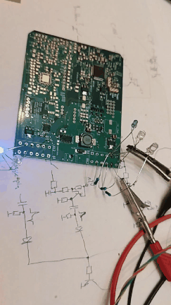

The "direct" connection of the CP line to the gate implies the risk of killing the gate by a high voltage on the CP. For the moment, I just use 100k series resistor directly from the CP to a port pin of the STM32. Yes, this is also ugly, but I guess the protection diodes at the STM ports and the 100k series should cover the use case (I did not study the data sheet. Is it ok to rely on the port protection circuit, does it withstand some milliamps worst case?)
- catphish
- Posts: 961
- Location: Dorset, UK
- Has thanked: 98 times
- Been thanked: 195 times
Re: Develop a QCA7000 board?
Don't do that. The STM32 you're using may be rated for some current injection on GPIO pins, but this is never an acceptable design decision.uhi22 wrote: ↑Mon Aug 21, 2023 3:57 pm The "direct" connection of the CP line to the gate implies the risk of killing the gate by a high voltage on the CP. For the moment, I just use 100k series resistor directly from the CP to a port pin of the STM32. Yes, this is also ugly, but I guess the protection diodes at the STM ports and the 100k series should cover the use case (I did not study the data sheet. Is it ok to rely on the port protection circuit, does it withstand some milliamps worst case?)
You're right to want to protect the MOSFET. You can do this with a resistor and a TVS between D2 and Q1.

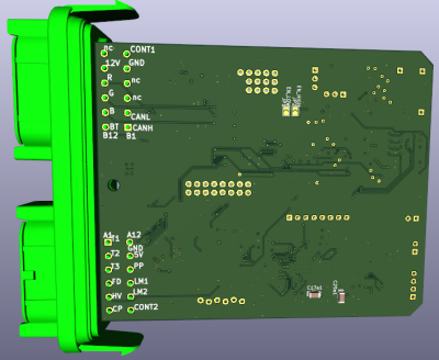

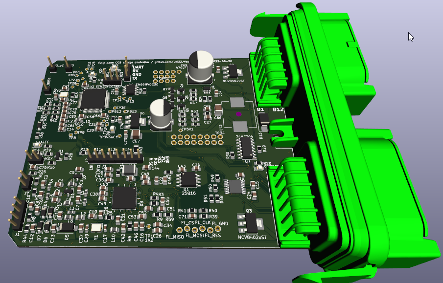

Coming a step further to the JLCPCB process: All components are now on the top, and all passives and all available actives have the correct JLCPCB part number (hopefully).
Nearly all SMDs are 0805, with the goal, to support both, handsoldering and JLCPCB assembling service. For two capacitors, which were only available as 0603, I added on the bottom side alternative footprints in 1206, so overall it should be possible to hand-solder everything. (Also some L's in the filter are 0603, but these can be ommited in case of hand-solder-prototyping.)
Many of the active components are causing "extended part fees", which sum-up to $22 per PCB. The overall offer over 2 populated PCBs including all available parts was $82, plus shipping and duties. I did not order yet, just need to wait until the previous order arrives and the soldering and testing is done.
The connector, the QCA7005 and the big inductor are not included in the JLCPCB BOM. Also the programming/debugging connectors is not in my BOM with partnumbers, but the JLCPCB webside detected and selected also these, so everybody can decide whether to order them or not.
Some of the ICs have wrong orientation and need to be corrected on the JLCPCB viewer during the order process.
I needed to replace the 8MHz XTAL of the STM32 by a 12MHz, because the 8MHz is not available at JLCPCB.
I think it a good point in time, to review the schematic again, before placing the next order. Or, if somebody does not want to wait, feel free to place an order at JLCPCB. Let's find the errors together
This is how it looks now:

Remember to check the price of 5 populated boards. Sometimes it's barely more than that of 2, due to the minimum part runs and extended part costs

I use this "basic" crystal on my CAN STM32 boards with 12pf caps. https://jlcpcb.com/partdetail/YangxingT ... 4SI/C13738
Don't worry too much about the extended part costs, just minimize the BOM and use basic parts where they're available. In larger batches, the extended parts costs become less of an issue.

Thanks for the hints. Went back to the "basic" 2pin 8MHz crystal, with the option to use an other (four pin) on the back side, so everybody is free to use already available parts. Optimized the BOM by replacing the single npn by the same type which is used in the LED drivers. Corrected the part number of these npn, they are now SOT-23 as intended. Kicked-out the internal connectors, they are just test points for development now. Finally also added the part number of the big 10uH inductor. So the only parts which are not populated by JLCPCB are the QCA7005, the connector and the RF transformer. This looks like a quite convenient solution
The JLCPCB price is below $30 per unit (incl shipping, taxes, duties), at 5 units per order.

uhi22 wrote: ↑Sat Aug 26, 2023 11:42 pm ..Many of the active components are causing "extended part fees", which sum-up to $22 per PCB. The overall offer over 2 populated PCBs including all available parts was $82, plus shipping and duties. I did not order yet, just need to wait until the previous order arrives and the soldering and testing is done.
...I needed to replace the 8MHz XTAL of the STM32 by a 12MHz, because the 8MHz is not available at JLCPCB.
JLCPCB's part search function is poor. Lots of duplicate / similar categories that are a mess to find stuff. There are 4 crystals categories that are mishmashed together.
https://yaqwsx.github.io/jlcparts/#/
can be really helpful to work through part availability and actually find what JLCPCB has in stock. Up top right of the web page, click update inventory. It pulls from JLC inventory and sets it all up in the browser to select / search for what you need. It sometimes takes 2 minutes to update it all, especially when you haven't visited in a while. There are decent filters there to find exactly what you're looking for.
There are plugins to auto rotate the components with kicad and JLCPCB. This is one example, https://github.com/bennymeg/JLC-Plugin-for-KiCad

I tested this circuit today. The MOSFET failed after a few charging cycles
Definitely needs protection between D2 and Q1.
I use the same MOSFET circuit for 12V GPIO inputs too. Those also failed. They require the same protection.

Thanks, KiCad and its possibilities are really amazing. I gave a try, added the rotation attributes, and now the footprints have the correct orientation in the JLCPCB viewer. Greatjrbe wrote: ↑Tue Sep 05, 2023 1:18 pm There are plugins to auto rotate the components with kicad and JLCPCB. This is one example, https://github.com/bennymeg/JLC-Plugin-for-KiCad

Do you have a schematic (or rough description) of this approach which failed? I plan to add some debouncing / low pass filtering, to avoid triggering by short disturbances.

Progress: Populated and tested the following new features on the board version 2023-08-17:
- discrete 12V highside drivers for RGB -> works fine.
- HBridge driver for the connector lock, including PWM for both directions -> works fine.
- PWM for the contactor drivers -> works fine.
- Onboard "alive" LED -> works fine.
- CAN bus on the connector -> works fine.
Used a test software which controls the outputs in a sequence (https://github.com/uhi22/ccs32clara/com ... 53d987732a). No control by the real application yet.
This means: no bugs in this board version found so far. Could be the point to order some populated PCBs from JLCPCB, but on the other hand adding the sleep-wakeup logic would be also a nice feature before producing more "soon-outdated" hardware. (This is an animated gif, but is not show the animation inline?)
