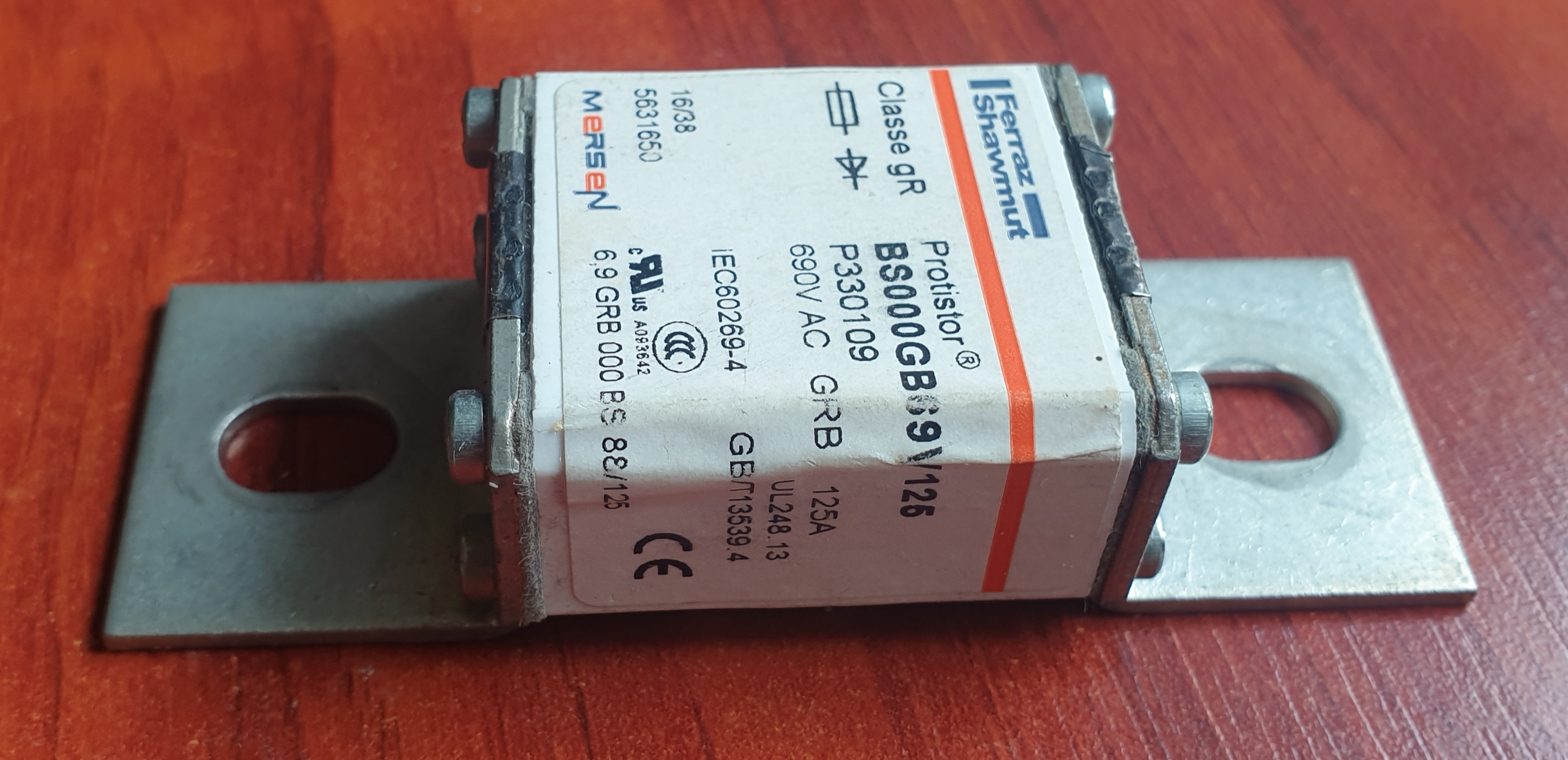

This thing was in line with HV bus in one of the OEM batteries. It says Protistor BS000GB69V125. Does anybody know what it is and what it does?

Looks like those are fancy DC fuses: https://ep-us.mersen.com/products/group ... round-body

Unfortunately rhe fuse I used is a protistor pictured above which in a datasheet is described as a ultra-fast acting. There is no curve given so I assume it would blow instanstly once over 125A?

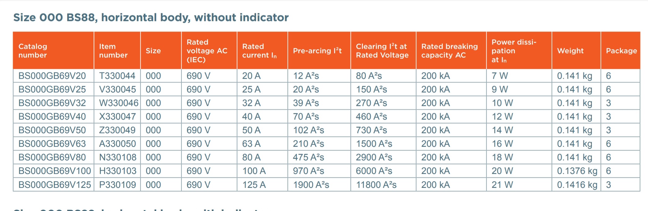

I don't find the word "acting" or "fast" in either the Mersen (Ferraz Shamut) datasheet nor that web page's description.
I do find the "semiconductor fuse" diode symbol on the fuse's labeling, though.

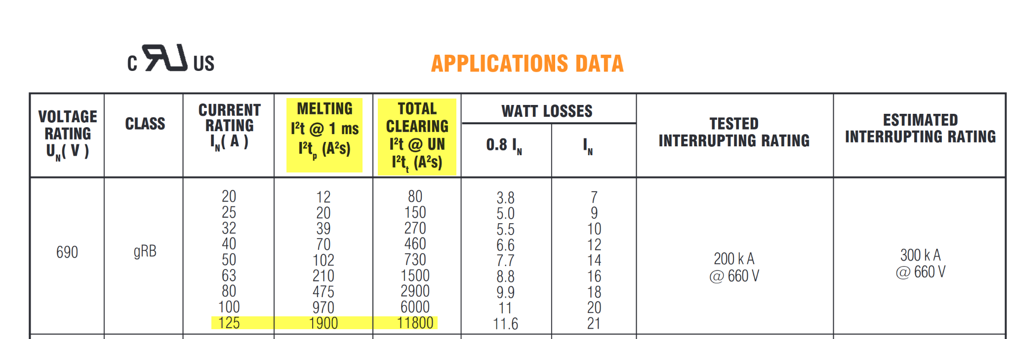

m.art.y wrote: Tue Sep 05, 2023 7:26 am There is no curve given so I assume it would blow instantly once over 125A?
I, too, don't find a time/current graph, but they do furnish the raw I²T numbers for melting amps and total clearing amps (ref.):
Ferraz Shamut Mersen BS000GB69V125 datasheet fragment

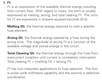

Interpreting this is well outside my wheelhouse, and I'm certain someone will jump in shortly to bring context to those numbers; meanwhile, LittleFuse has more to say about I²T (ref.):
LittleFuse i²T explanation

I2T is a way to describe absorbing capabilities. Like a bucket; when its full it trips. But the bucket has a hole so if the fuse gets time to rest the bucket will empty; is it being over used during T time it will trip.
That's what I2T means and does.
So basically it gives an idea what the above nominal accepted performance is. A "slow" fuse has a big bucket, a "fast" fuse a small one. Often the bucket is drawn in a graph where current and time are plotted.

So how small is the bucket of this 125A fuse according to the datasheet below? If under hard acceleration my amps go to 140A for a couple of seconds would it blow instantly or is there still time to empty the bucket?
