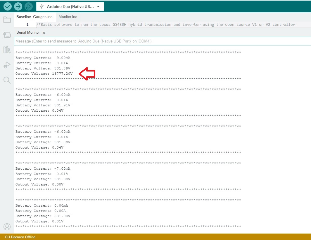

I could really use your help, I have noticed the S-Box intermittently reporting some quirky things, for example with it just powered on, (both contactors still opened) it sometimes shows volts as high as 16,777.20V
now I have been informed that's because it is a signed value in an unsigned int, but aside from GOOGLing that one can hold negative numbers and the other one can't I'm more confused than a blind goat on astroturf and could greatly benefit from your tutelage and really just wanna know how to fix it, ha ha

Can you post a piece of code of that variabele? And especially where it's written too?

EV_Builder wrote: Sun Jul 30, 2023 7:38 am Can you post a piece of code of that variabele? And especially where it's written too?
thank you for taking interest, and offering to help, the variable appears to be called: OutputVoltage and is mentioned three times in the code
first it is defined like so in what I would call the Global Definitions Section
float OutputVoltage=0;
later on it appears in the void CheckRecCan()
else if(inFrame.id ==0x220)
OutputVoltage=((inFrame.data.bytes[2]<<16)| (inFrame.data.bytes[1]<<8)| (inFrame.data.bytes[0]))*0.001;
and lastly in the void ShowRecData()
SerialDEBUG.print("Output Voltage: ");
SerialDEBUG.print(OutputVoltage);
SerialDEBUG.println("V");
EV_Builder
Posts: 1205
Location: The Netherlands
Has thanked: 18 times
Been thanked: 37 times
Re: BMW S-Box Phev (SafeyBox 9846612)
Post by EV_Builder »
A float is quite flexible I think something else is going on....
Normally a float is 4 bytes; in the code i only see 3 being Processed.
I think you should try adding the 4th and maybe the value is just below zero sometimes....
To test you add byte nr [3] and you shift left (<<24).
If you need more help just post. The assignment is the place to check.

Zombieverter code uses int32_t for Voltage and sign extends from 24 bit value to 32 bit.
Voltage=((bytes[2] << 16) | (bytes[1] << 8) | (bytes[0]));
Voltage = (Voltage<<8) >> 8; // sign extend
you could then convert to float with the multiplication by 0.001

EV_Builder wrote: Sun Jul 30, 2023 5:09 pm A float is quite flexible I think something else is going on....
I'm sorry this is Greek to me, if you could actually modify the code I posted above with this change I would really appreciate it

royhen99 wrote: Sun Jul 30, 2023 7:02 pm Zombieverter code uses int32_t for Voltage and sign extends from 24 bit value to 32 bit.
thank you, however I am not sure if you left off the assignment part in your example cause I am a total newb and you are assuming I know how to assign a int32_t, lol
as far as the two lines of code you provided, then the top line is essentially the same to the code I have, the second line is what I will add to my code to extend from 24 bit value to 32 bit

Zombieverter declares Voltage in the header file so you will need to declare in your code, int32_t Voltage.

royhen99 wrote: Fri Aug 11, 2023 6:23 pm Zombieverter declares Voltage in the header file so you will need to declare in your code, int32_t Voltage.
with a big help from a friend, I think we got it working, using your advice, thank you so much, here is the code:
int32_t ov;
ov=((inFrame.data.bytes[2]<<16)| (inFrame.data.bytes[1]<<8)| (inFrame.data.bytes[0]));
ov = (ov<<8) >> 8; // sign extend
OutputVoltage = (float)ov * 0.001;

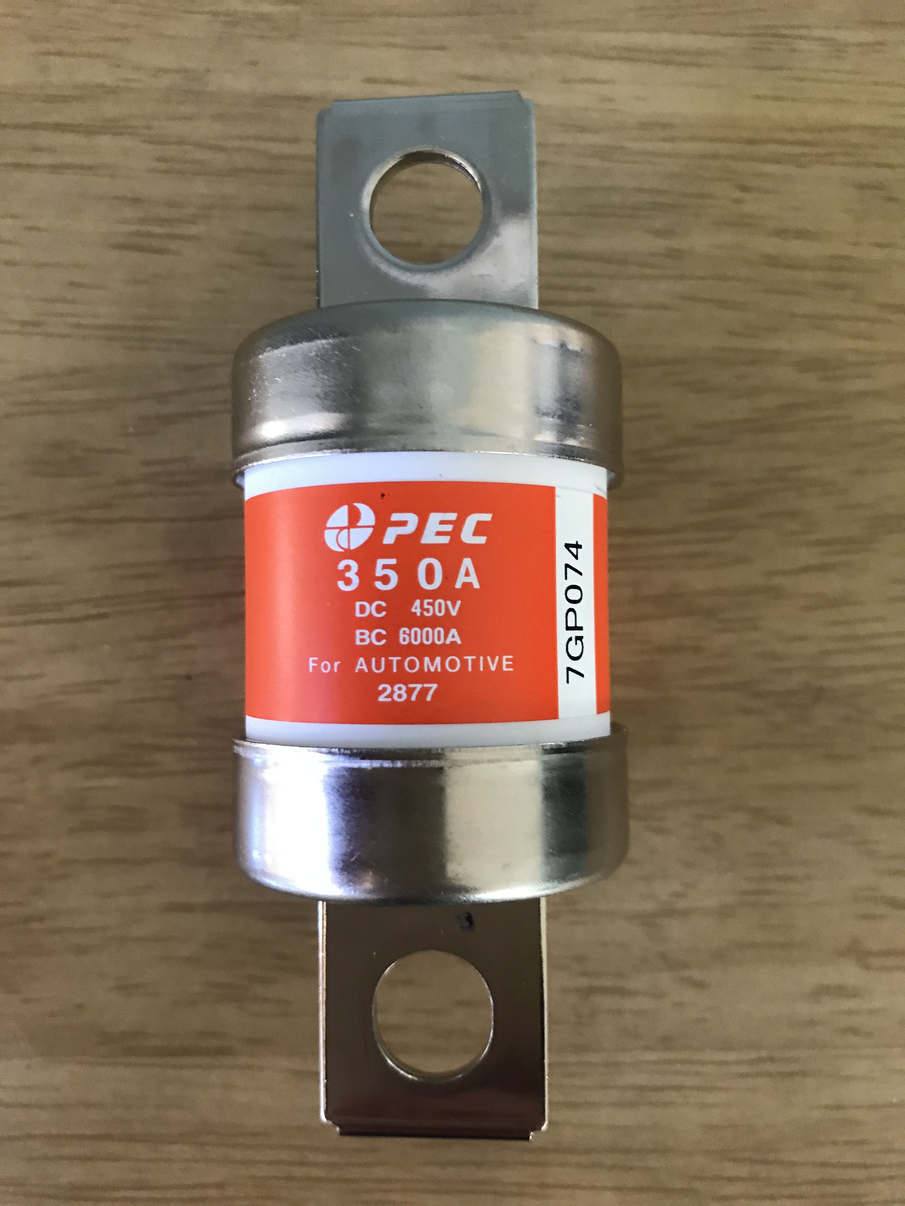

Anybody knows what Amps are the contactors/fuse rated for in an S Box? Some sources seem to suggest 120A which is rather low. In that case what would be the amp range that the internal current sensor could measure?
Gregski
Posts: 2739
Has thanked: 500 times
Been thanked: 946 times
Post by Gregski »
m.art.y wrote: Tue Aug 29, 2023 5:22 pm Anybody knows what Amps are the contactors/fuse rated for in an S Box? Some sources seem to suggest 120A which is rather low. In that case what would be the amp range that the internal current sensor could measure?
the fuse is 350A, the resistor is 15 OHMs, maybe the Panasonic contactor part number AEV14012 below will help you find the specs

royhen99 wrote: Wed Sep 13, 2023 3:37 pm I assume it's just the convention that BMW has chosen, ( +ve = charge, -ve = discharge ). Easy enough to add a "-" somewhere so it displays as positive.
gotcha, fixed it with the abs Arduino function, once again a huge thanks for your help
