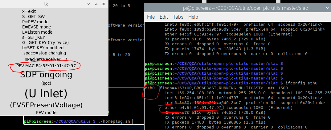

uhi22 wrote: Sun Aug 06, 2023 5:24 pm If it says that it expects CAN, then the ChaDeMo is enabled in the ini file. Just change this setting. And If you do not have serial devices, then remove the Dieter or Celeron devices from the ini.
Excellent! This helped me move forward. I updated the config/ini file to reflect the changes mentioned above and was able to get past these errors. Now at the next step where the EVSE (simulated is trying to query the hostname and then determine the IPv6 address from it)
In my RPi setup the /eth/hosts:
127.0.0.1 localhost
::1 localhost ip6-localhost ip6-loopback
ff02::1 ip6-allnodes
ff02::2 ip6-allrouters
127.0.1.1 evse
This throws the error as below:

And I can see (from additional prints and debugging) that there's no IPv6 address tied to the hostname of this RPi only an IPv4 address tied to
evse -> 127.0.1.1 as can be seen.
One way to resolve this would be to add an IPv6 address to the hosts file mapping to a link local addr of the eth0 interface to hostname or better option would be to use the IP address that the process already identified in above steps:

mhpev wrote: Mon Aug 07, 2023 12:12 am ... so not sure why this hostname to IP mapping is done in lines ( pyPlcTcpSocket.py) 160-176
Good point. These lines are a left-over of some experiments, and not needed. I kicked them out now: https://github.com/uhi22/pyPLC/commit/7 ... 866ace461a
Does this solve the issue?

uhi22 wrote: Mon Aug 07, 2023 2:22 am Good point. These lines are a left-over of some experiments, and not needed. I kicked them out now: https://github.com/uhi22/pyPLC/commit/7 ... 866ace461a
Sure does! Thanks. The EVSE (simulated) was able to open a listener on the port and the conn to PEV (simulated) was established as seen in the snapshot below.
One thing to note - I am using a real TP Link modem connected to the Ethernet port of the Pi and *once these messages get exchanged I notice my modems lose connectivity (based on the LED light status of the link). I've not yet updated the firmware and PIB files so these modems are in their normal modes HomePlug AV mode, as they're not rewired yet but connected to my home network and going over the home electrical/powerline network.
But this is good progress. I am going to start working on the modem rewiring and moving to DC as well as update their PIDs to reflect the EVSE and PEV sides using the open PLC utils. Then will retry getting the 2 sides up and running again. Please let me know if you want me to try something else in the meantime.
Thank you again. Attaching my working pyPlc.ini file

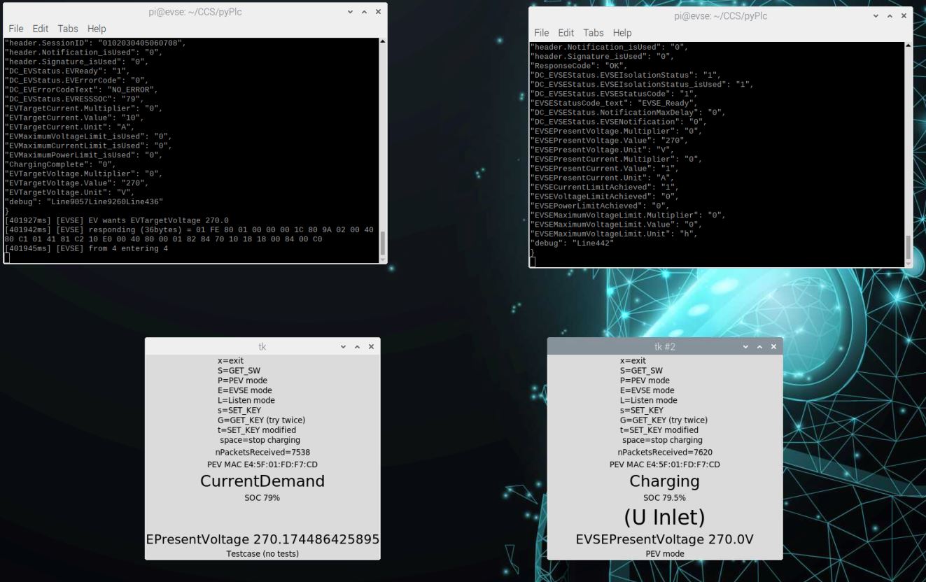

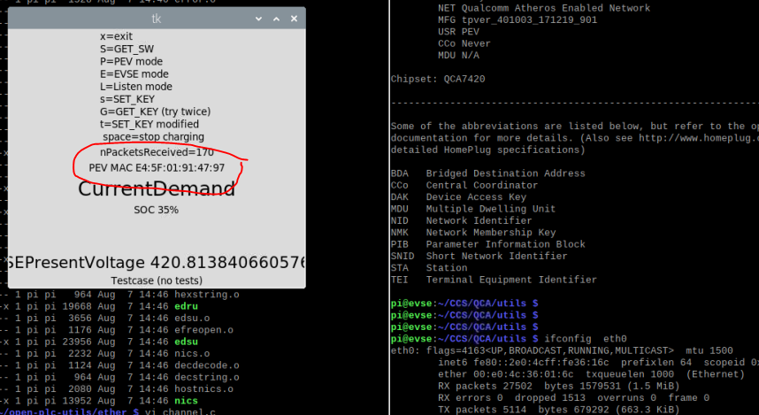

mhpev
Posts: 38
Joined: Fri Jul 28, 2023 2:18 pm
Has thanked: 50 times
Been thanked: 12 times
Re: PP differences for CCS1 vs CCS2
Post by mhpev »
uhi22 wrote: Mon Aug 07, 2023 2:27 am Good point. I was not aware of the differences in CCS1, and updated the FAQ now.
I was able to move much further and also config 2 TP link modems from the 4010 kit - one as EVSE and other as PEV using the docs and links from your github as well as detailed post from @asavage.
I've still not moved the modems to DC but that's the next step. For now I was able to get the PEV and EVSE sides working fine across the modems.
I hit one error after the simulated PEV side reached 100% SoC and stopped the session - the modem conn on EVSE side dropped and when the script tried to reconnect the EVSE code threw and exception and crashed - cause was same as above. So I updated the code to reflect changes you mentioned above in the reconnect section as below:

and now the code works fine without crashing or throwing an exception.
Thx again.

mhpev
Posts: 38
Post by mhpev »
uhi22 wrote: Mon Aug 07, 2023 10:44 pm Perfect, thanks for testing and proposing the bugfix. I pushed an update: https://github.com/uhi22/pyPLC/commit/c ... 307c556c13
thank you! I was also able to validate across 2 TPlink modems and they did come up, all 3 LEDs on both the modems were on. How do I ensure that the modems are config correctly? and the correct PIBs for EVSE and PEV mode are loaded up. Because next step would be to remove the AC ckts from the modems and power them via DC (5-12V) and if there's no issue hacking up the h/w will move to validating with the real EV/Chevy Bolt that supports CCS1 charger (and pyPlc in EVSE mode).
Any other things i need to take into consideration?

Moved one step further today. Hacked 2 TP-Link modems from the kit and removed all the A/C xformers and related electronics working using 12V DC PS for now.
Used the approach described in this thread to connect 2 cables back2back from the PEV <-> EVSE. after some initial issues was finally able to get all 3 lights on the modem and comm going from/to EVSE/PEV.
next step get the conn to gen 5% PWM constant to keep EV side tricked and to establish comm (as a DC charger/discharger) ... thanks to all especially @uhi22

I am continuing to use the pyPlc to make both the sides comm EVSE with PEV (with 2 RPi having the ini config and 2 mod TP Link modems as mentioned above).
Before I connect to a real EV (my goal is to mainly act as an EVSE using the EVSEmode doc as my blueprint) - I was checking some of the params on both the EVSE as well as PEV side - mainly the changes to PIB side for both and ensure nothing is incorrect.

One other thing I noticed on the Tk windows the PEV and EVSE Mac addr are diff from what we see in the above - mainly the mac addr of the modems.
eg on PEV side:
and on EVSE side it has the same PEV side eth0 addr (shown above)
shouldn't the PEV mac be the modem's MAC and not the eth0 interface mac on Linux of PEV?
Just trying to eliminate any issues before I connect to the actual EV.
