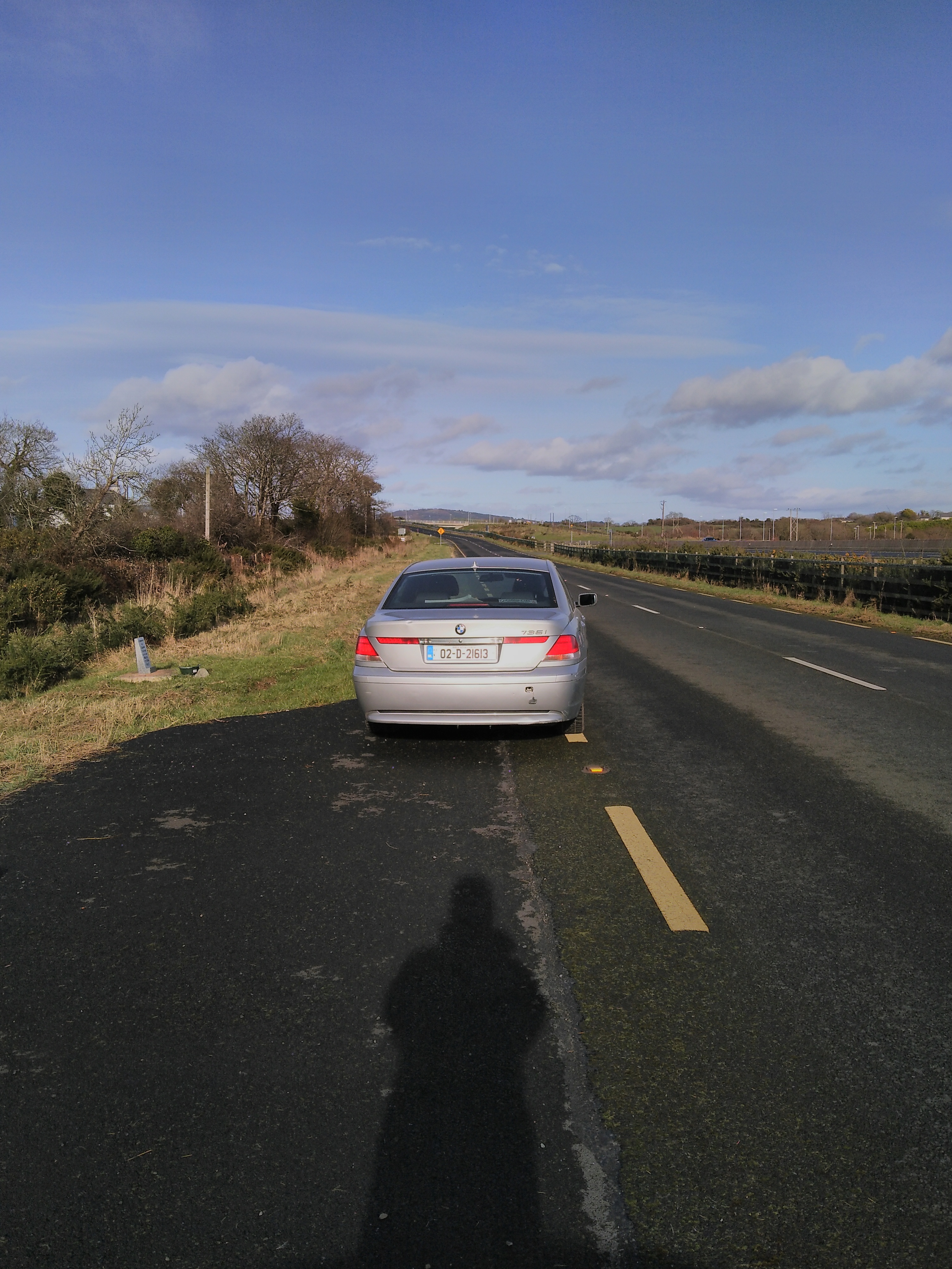

The Super Yacht (aka BEXUS) was inspected and passed by an automotive engineer today... next steps include changing the taxation class to electric drive, NCT, and testing on track and road 8-)

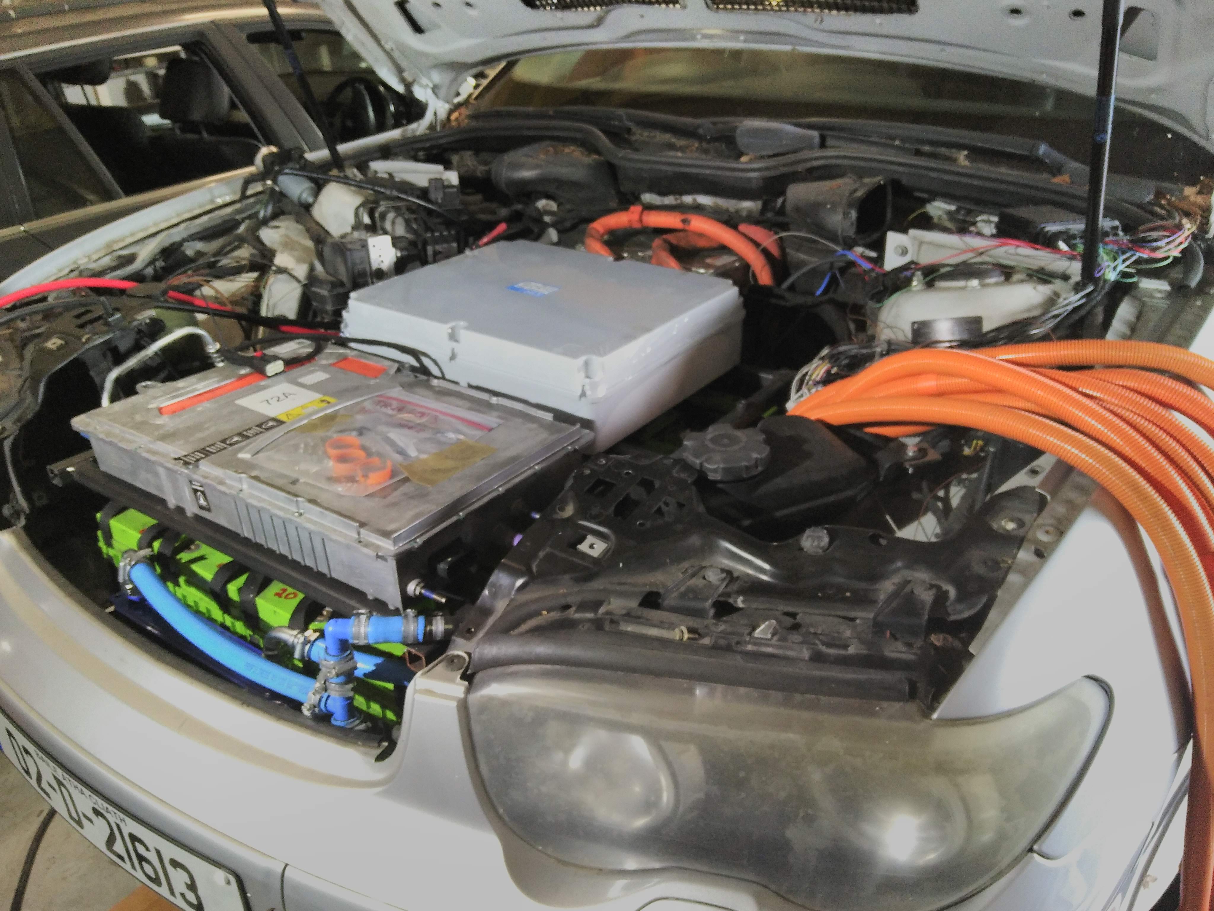

Nice. I'm using the same Tesla charger and TRW pump on my project :)
What are you using for a DC-DC converter?

I can't imagine that the GS DC-converter is suitable, as it's rated to 288v input.

From what I have gathered:
GS450h gearbox
GS450h inverter w/ his opensource control board
Tesla Gen 3 (?) charger w/ his opensource control board
I also would like to know if he has BMS with the batteries, and what else is inside that high voltage junction box.

RE3Rotor wrote: Fri Feb 07, 2020 7:01 pm I also would like to know if he has BMS with the batteries
No physical BMS is used with the test pack (it's monitored manually). When the long range pack is fitted then I suspect it will use the BMS fitted to the modules (if OEM) or Johannes BMS.
RE3Rotor wrote: Fri Feb 07, 2020 7:01 pm what else is inside that high voltage junction box.
Contactors and Precharge relay/resistor.

So with today's testing of the Bexus (current weight 2050kg) and a crappy 450v battery that sags like a ton of bricks under load the car was pulling like a train up through 70mph up a hill. So imho we don't need 650v.
