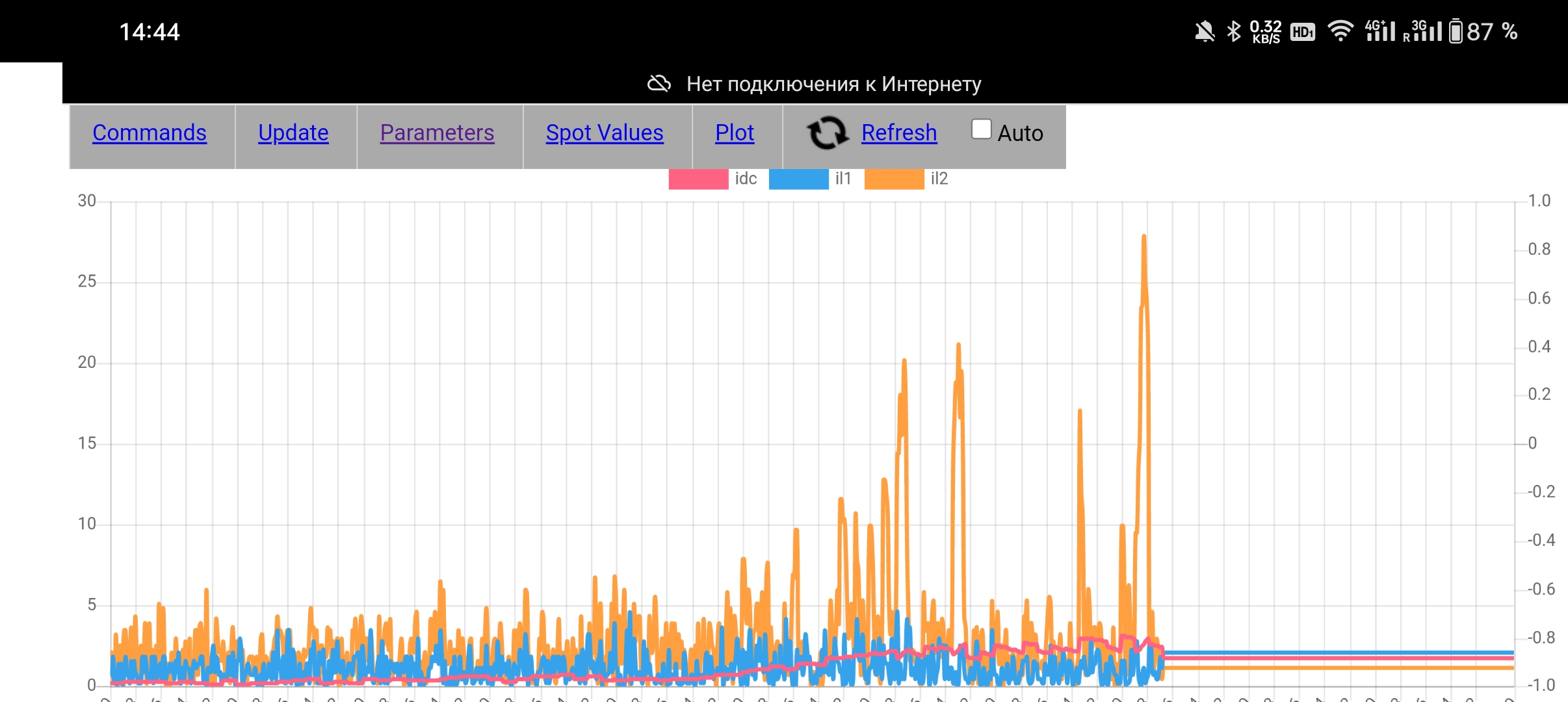

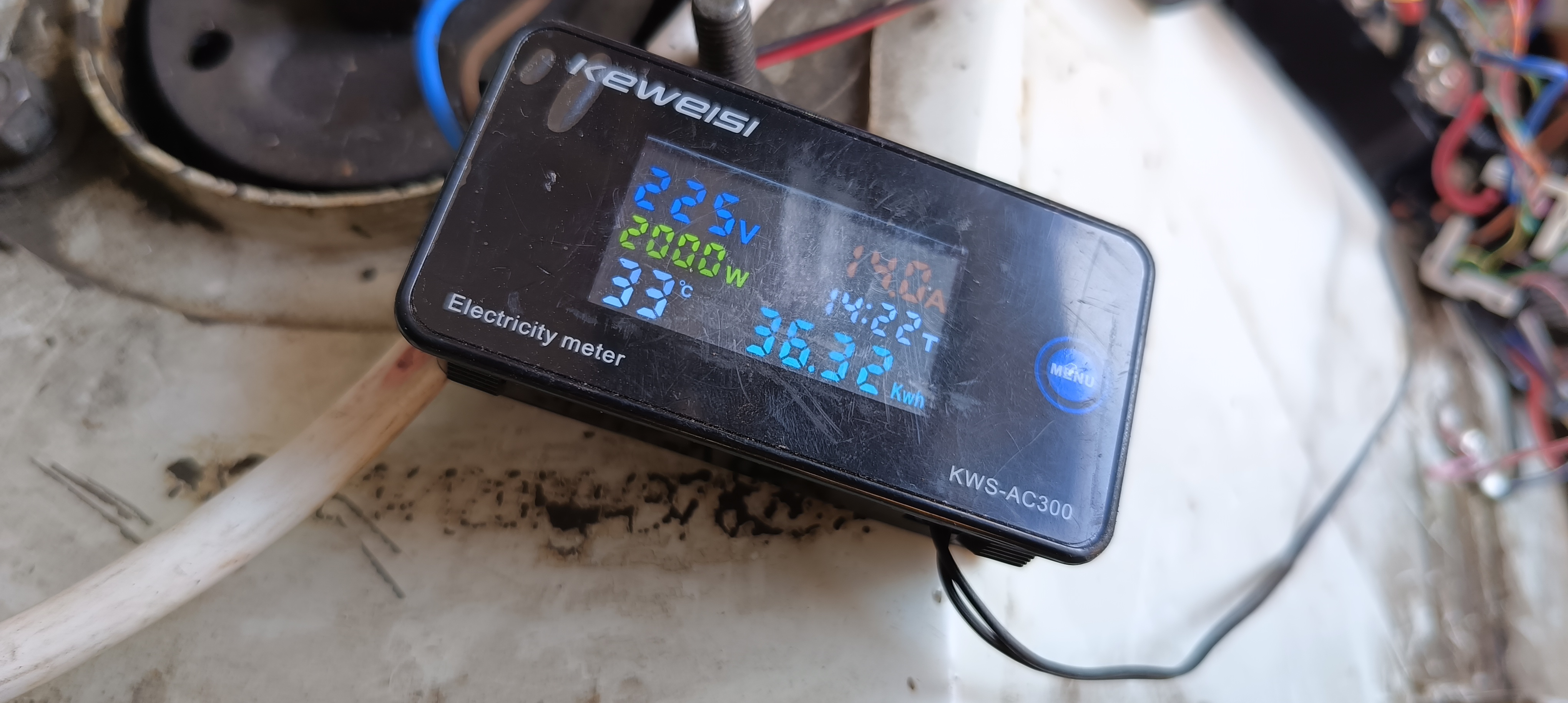

the efficiency of the system is 85% (2 kW from the mains = 1.7 kW to the battery) . 36c battery (151 volts fully charged) . the current sensors are calibrated at 90 amps and their gain is 4.31 (Honda ima inverter) probably there is a very large error at a small current, if I set the charging current to 2 amps in the settings, I get "overcurrent" after a minute of the system working with a real current from the 14 amp network. when the 1.5 amp charging current is set, then the real consumption over the AC network is 12 amperes and 10 amperes current into the battery. at the same time, the inverter itself believes that the DC current of the line is only 0.5 amperes. When I get an overcurrent, in fact, the current on the current sensors of the inverter will not exceed 25 amps. Maybe there is some parameter that can make the system more stable? (in boost charging mode, I could stably have 75 amps at the input to the inverter and nothing turned off)

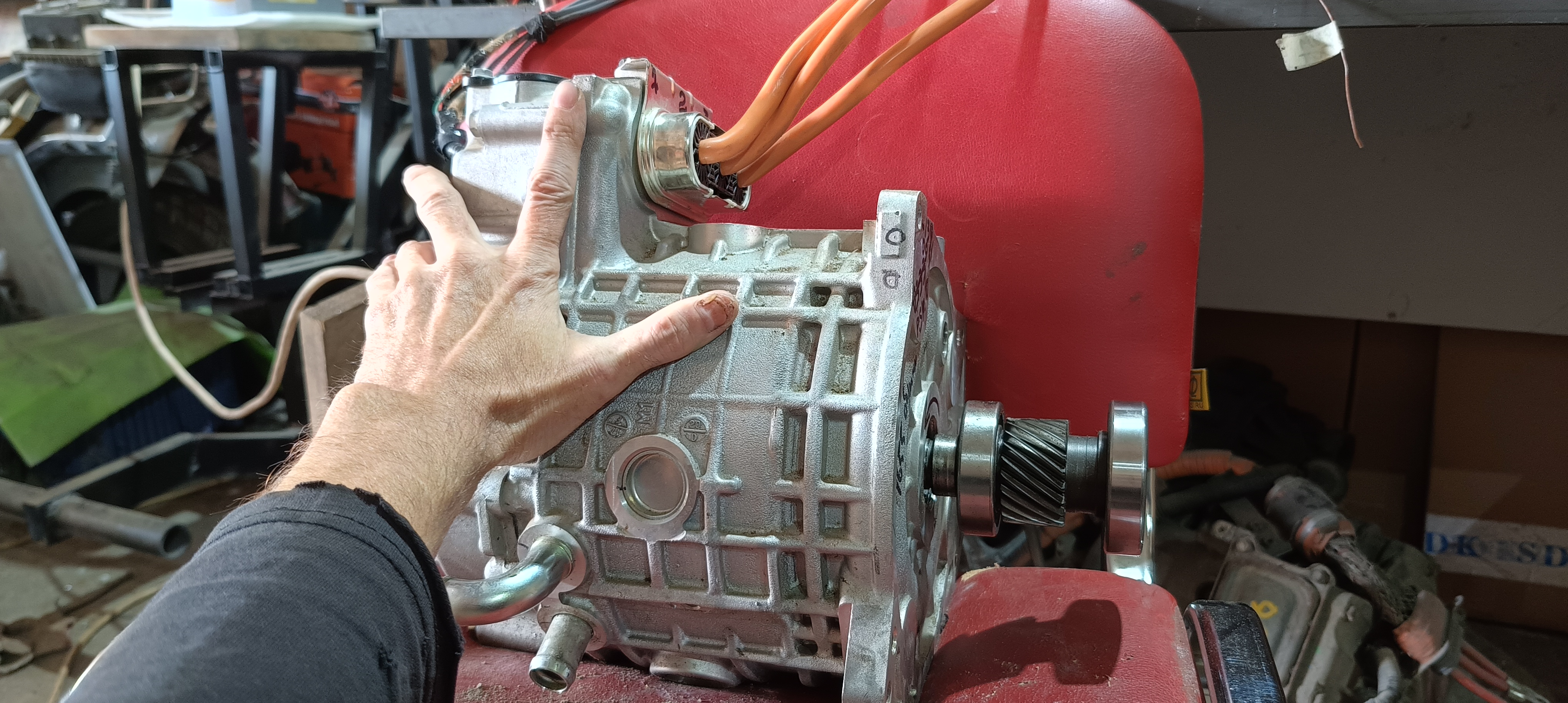

at the expense of noise, a very quiet squeak. it is the same for any mode of charging with any inverter and motor. now I have a honda ima inverter + a nissan serena motor (small starter generator)
as a connection between the motor and the gearbox, I used gear parts and a rubber coupling from a gimbal from some kind of car.
