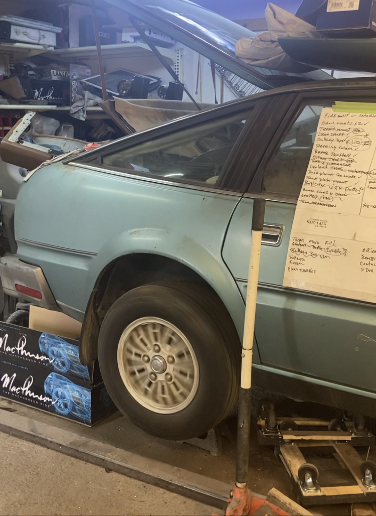

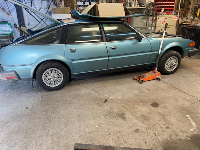

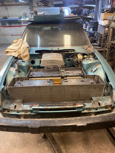

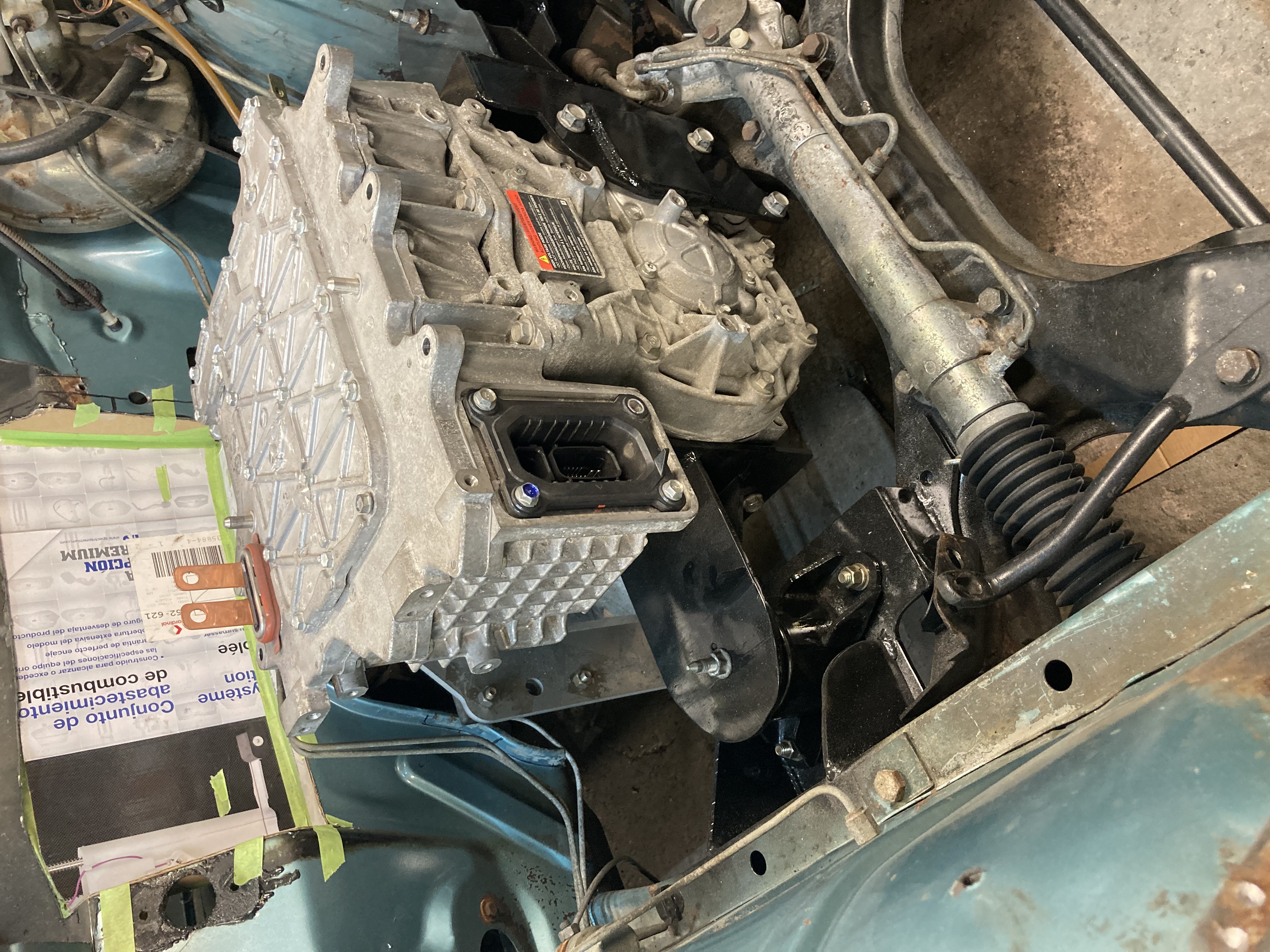

Hello everyone
Been assembling parts and just got wheels to spin.
Lots more work ahead:
Donor is a 1980 Rover SD1
ZOMBIEVERTER VCU
Using a full Gen 2 2013 Leaf Stack motor/inverter/PDM
Chevy Volt Gen2 battery pack
Orion2 BMS
Removed auto and replaced with BW T5 transmission
Brat Industries Coupler and mounting plate/ spacer
Shoutout to Bratitude for lots of great advice and parts
I’m located in Ontario Canada
