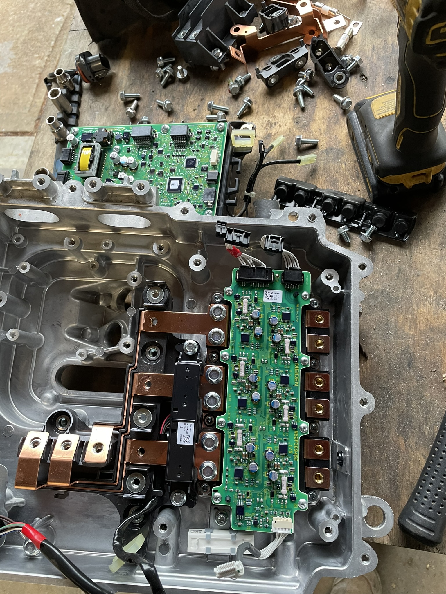

did a little brief tear down of the rear inverter, as id like to de bulk it and save some weight/space.

Under those mainboards there are some igbt with their classic connectors that can be managed with a classic openinverter setup (gates driver+sensor board) ?

the great would be that Bratitude will send a photo with all motherboard unmounted, so we can see the naked igbt

I dont have the pinouts anymore, but i can tell you that the signals you need are on the white connector.
The black side needs to be plugged in to supply the gate drivers isolated voltage.

as you can see. the driver power is on the top board. However, I could not identify the main entrances at random.
I also have a desire to saw off the extra part of the case and try to get at least 150 kW from this invertor using the OI v3 board, but the main difficulty is not knowing where the input is.
Is there someone here who knows exactly the purpose of all the pins on this inverter?

I figured out a bit about the pins on the board.
it remains to find out where the output of information about HIGH volts, temperature and which numbers to give a low sig to open the drivers?
Is anyone familiar with this information?
