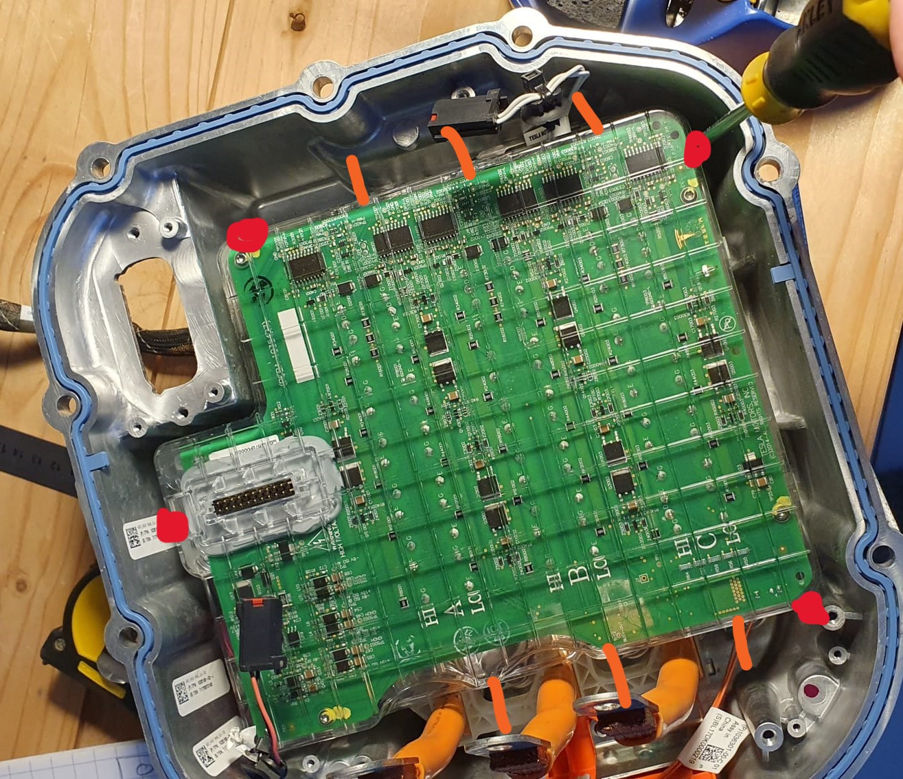

With the inverter now removed from the car, I checked:
* IGBT (diode test) test results are OK;
* A visual inspection of the driver-board seems OK;
* HVIL circuit was not working (bad contact in DC- connector), So I disconnected the HVIL on the OI board (conn 2), no result;
* I tested the OI udc-read by simulating a voltage on pin 1 of the IGBT-drive connector, and then the UDC-value was reading something, so the IO board seems OK;
* I tried to measure the UDC directly from the driver-board (pin 1), but there was no voltage.
Conclusion, the UDC measurement of the driver-board is bad?
But it seems impossible to remove the driver-board, so I guess the only option is to look for a new inverter (or drive unit)...

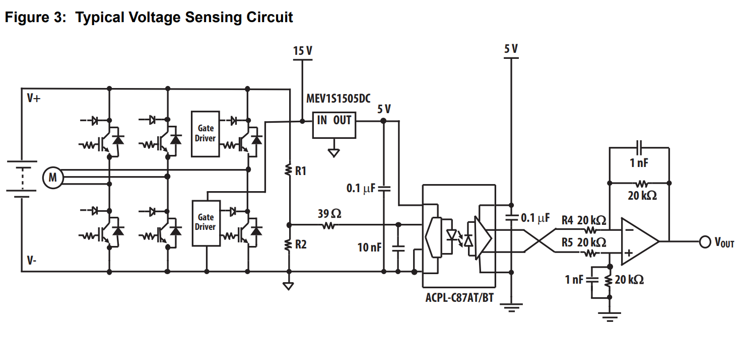

I think I will open 1 of the inverters, and have a look at the UDC circuit (viewtopic.php?t=2345)

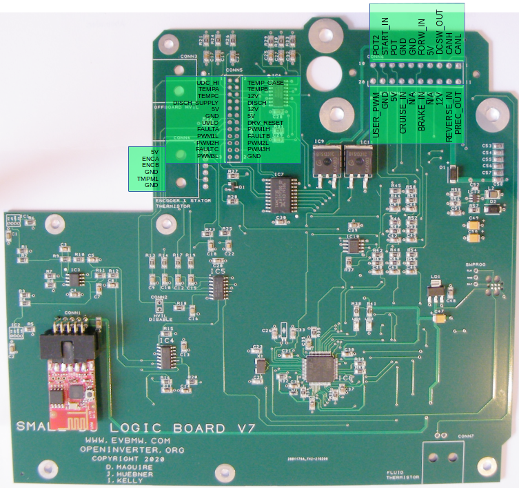

OpenInverter Board:
I have a V8 board,
* The 3.3V circuit is at 3,297V but the 5V circuit is 4,90V. Is this a problem? (I read in some topics that it should be just over 5V?)
* The soldering looks OK by visual inspection
* The board draws approximately 250mA with nothing external connected
* version: 5.20.R-sine
* I have changed the parameters with HV attached (the positive contactor was always open, but the precharge contactor was closed)
* How do I properly turn off the inverter? First, switch off 12V to the inverter, and then switch off HV?

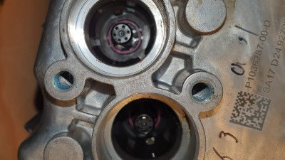

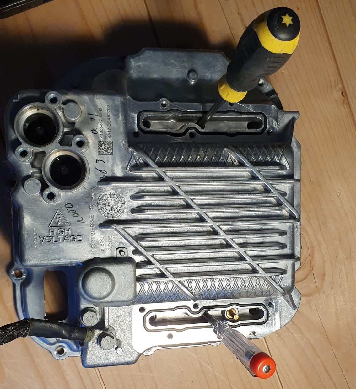

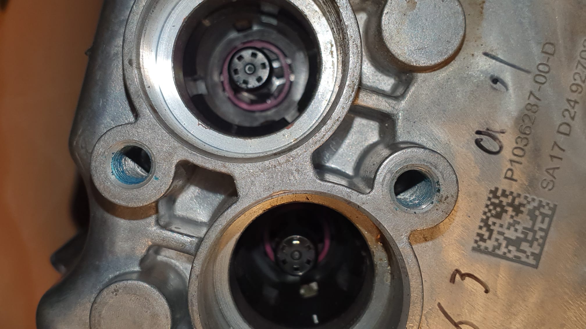

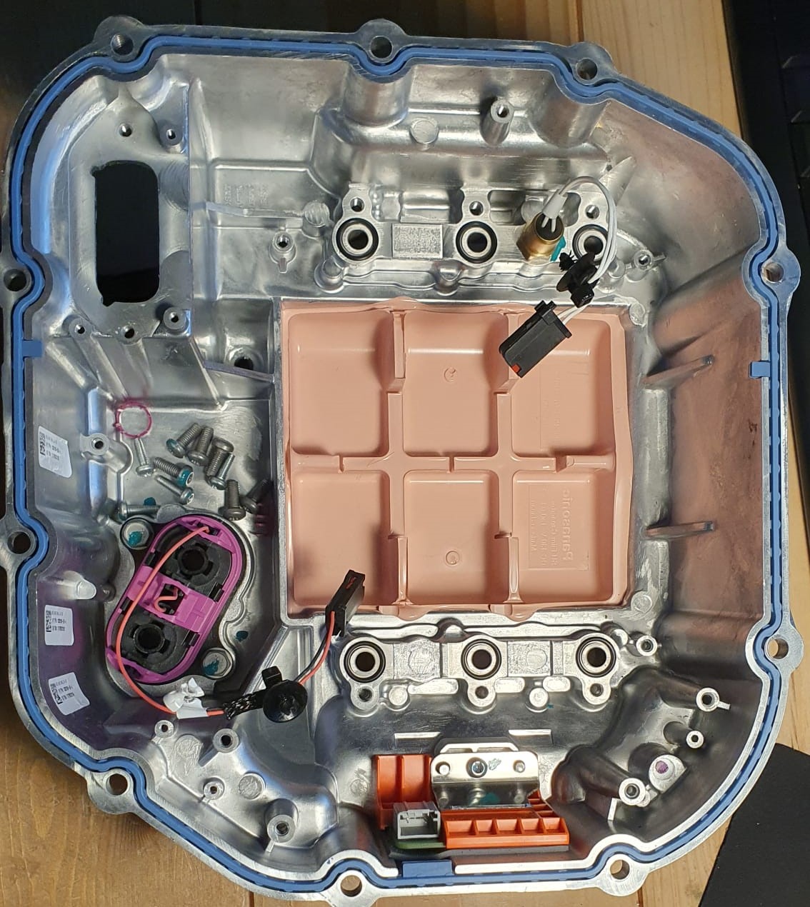

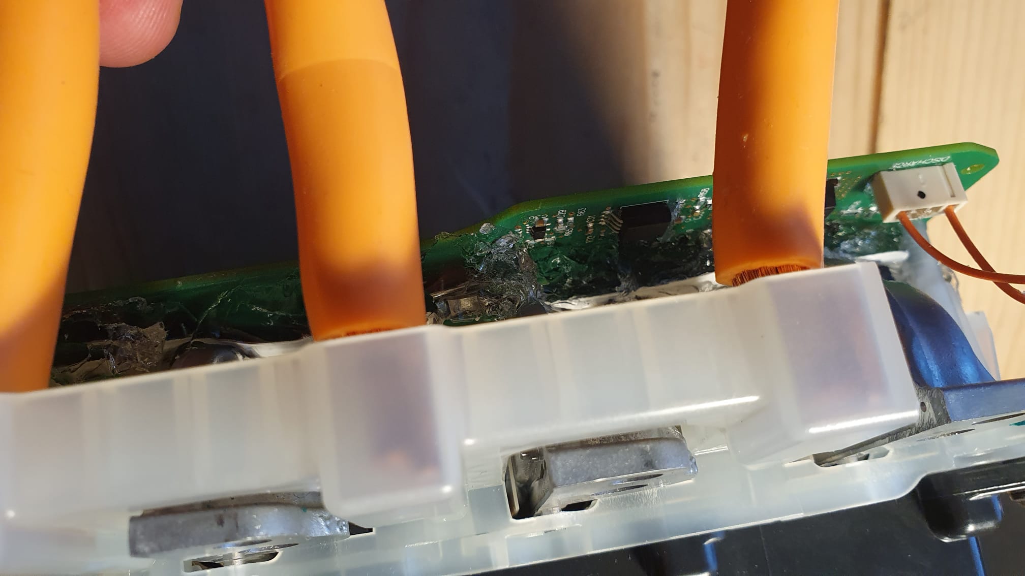

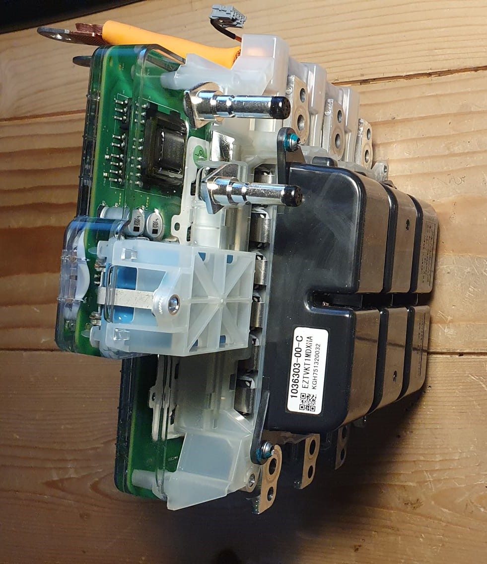

Removed the power-stage from the casing (like this viewtopic.php?t=2345)
You can also remove the power stage without removing the cover.
Remove the orange screws (easy) and red screws (with a thin screwdriver T20)

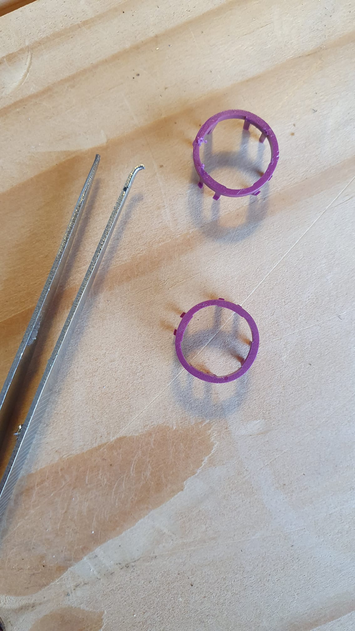

Remove the purple clips from the battery terminals, put a little hook in the gap, and just pull them out.
Now the capacitor is stuck in the bottom of the case. Remove the cooling covers and push the unit out of the casing with a screwdriver.
the udc measuremnet circuit is located on the bottom side of the PCB, near the C-phase cable:
It is a C87BT, circuit is like this:

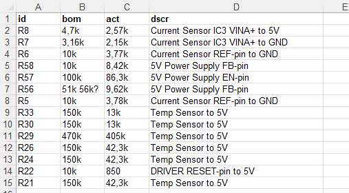

Anyway, I checked all resistors on the Open Inverter board and compared the values with the BOM (V8):
there were some differences:
I assume the temperature sensor resistor values are not that important.
Can these differences cause any issues?
