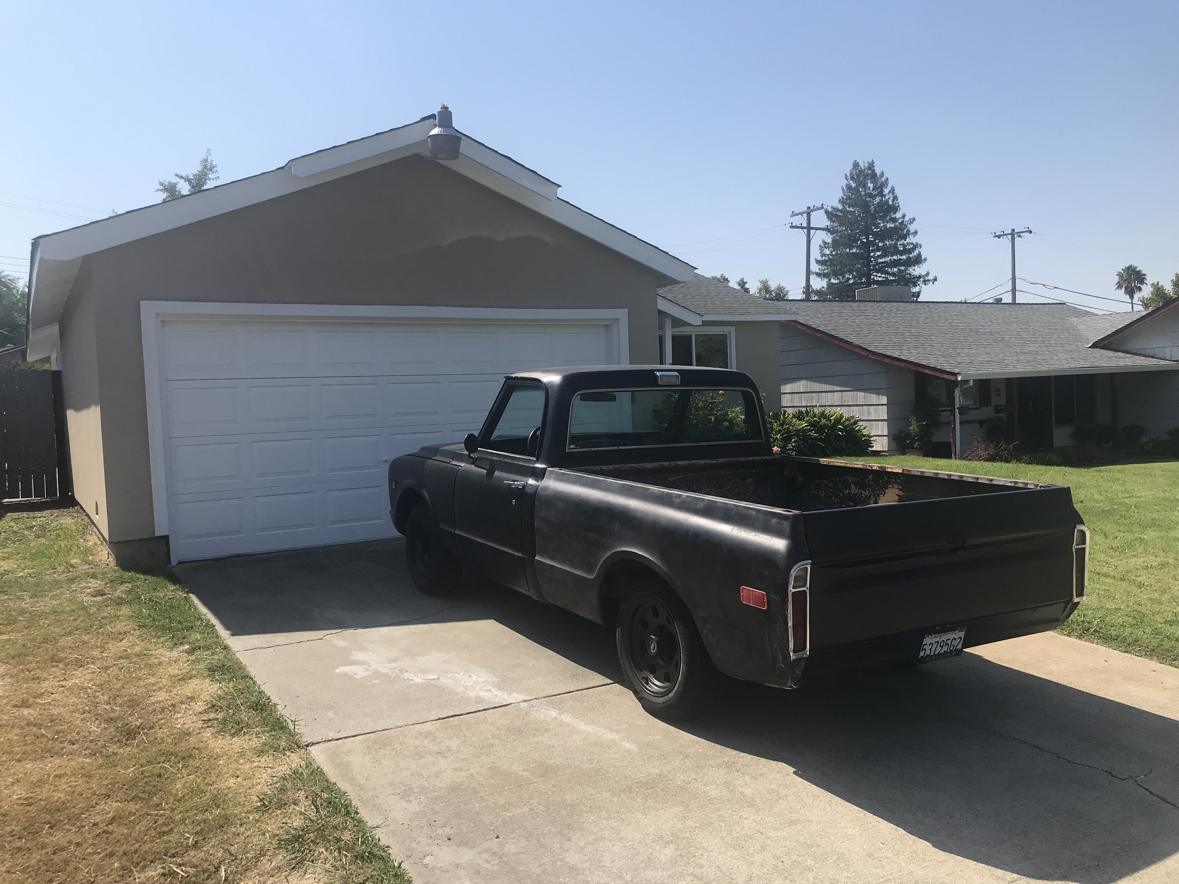

So I bought this truck back in 2017 as a Mom & Son project to force myself to spend more time with my newly retired mother. [that's a big lie] the truck was a total POS and her house was closer to the seller's place than my house, so I two wheel UHAUL car trailered it there instead ! but it's the thought that counts
we did wrench on it together and took a ton of pics which then I lost when my SSD failed literally as I was backing stuff up to the Google
Destination: Mom's House, where it all begin
Distance: 13 miles
Terrain: Streets (no freeway)
and here she is back where it all begin: (yup took mum around the block in this one, like I have done in all my prior builds)
have fun with all your projects you all, be silly with it, enjoy it !!!

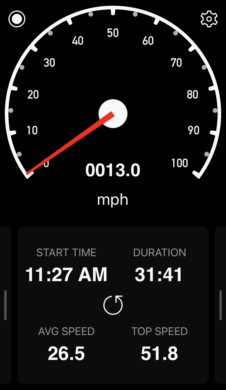

Re: [DRIVING]1971 GMCe Lexus GS450H BMW 530e Tesla Model S powered Electruck
TOP SPEED TEST #2
Still Powered by MG2 Only
88.9 MPH
Explanations Not Excuses:
88.9 MPH
- I don't have BMS so I am only charging to 90% capacity
- I have to drive out to the test site and that depletes my battery a bit already
- No windows in my doors yet, and I can feel the gushes of wind
- 3.73 stock rear differential gears, and I know nothing about differential gears

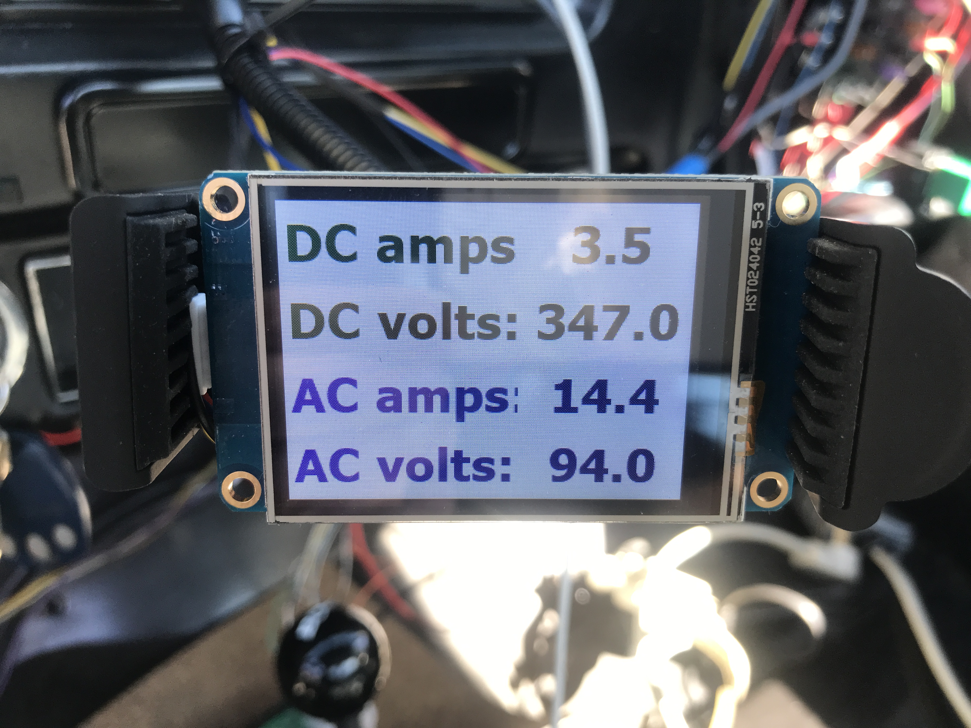

EV Charging Lessons Learned
Stay away from long extensions cords.
So drove Black Sunshine to my mates house and he offered me the world's longest extension cord so that I could charge, and this is what we saw on the Charge-O-Meter 3000
we was pulling 14 amps on a 15 amp circuit at only 90 volts, no bueno
and this is after we replaced it with a 20 footer
