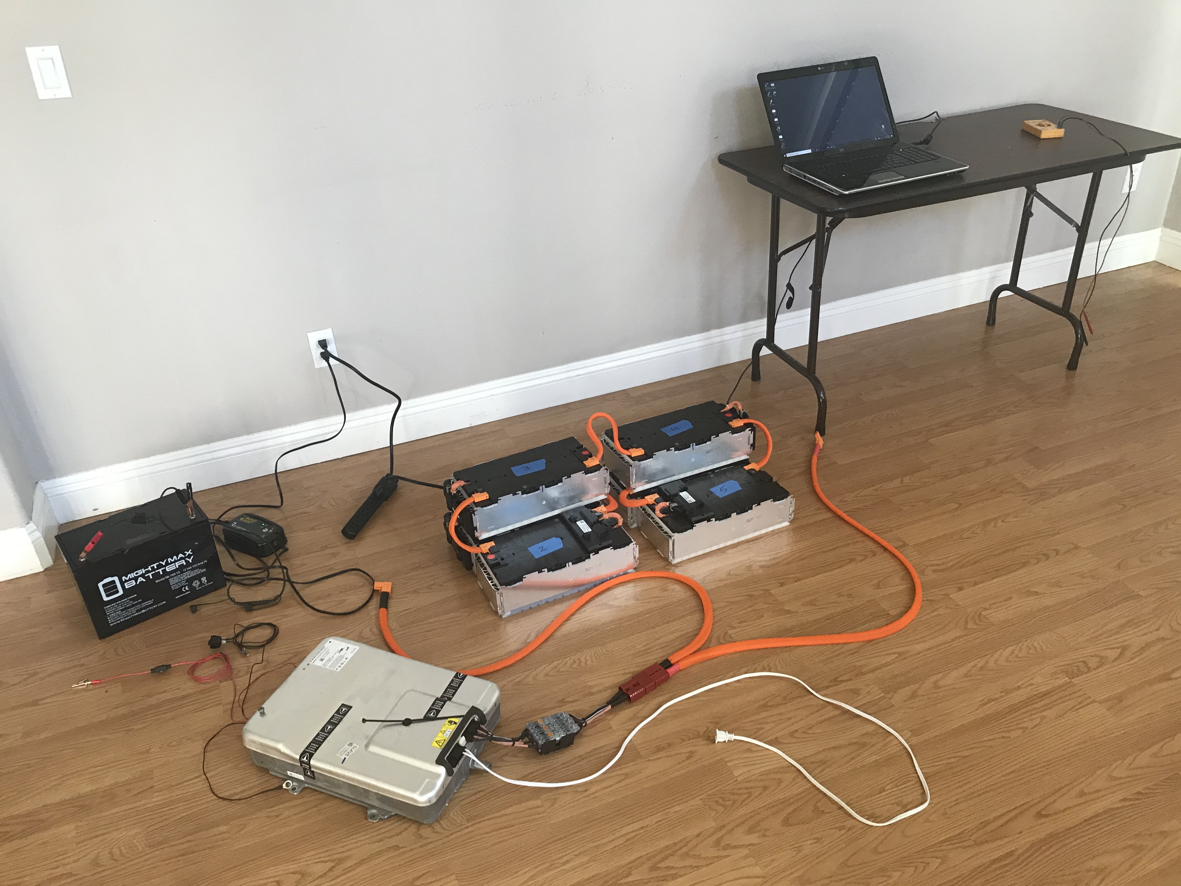

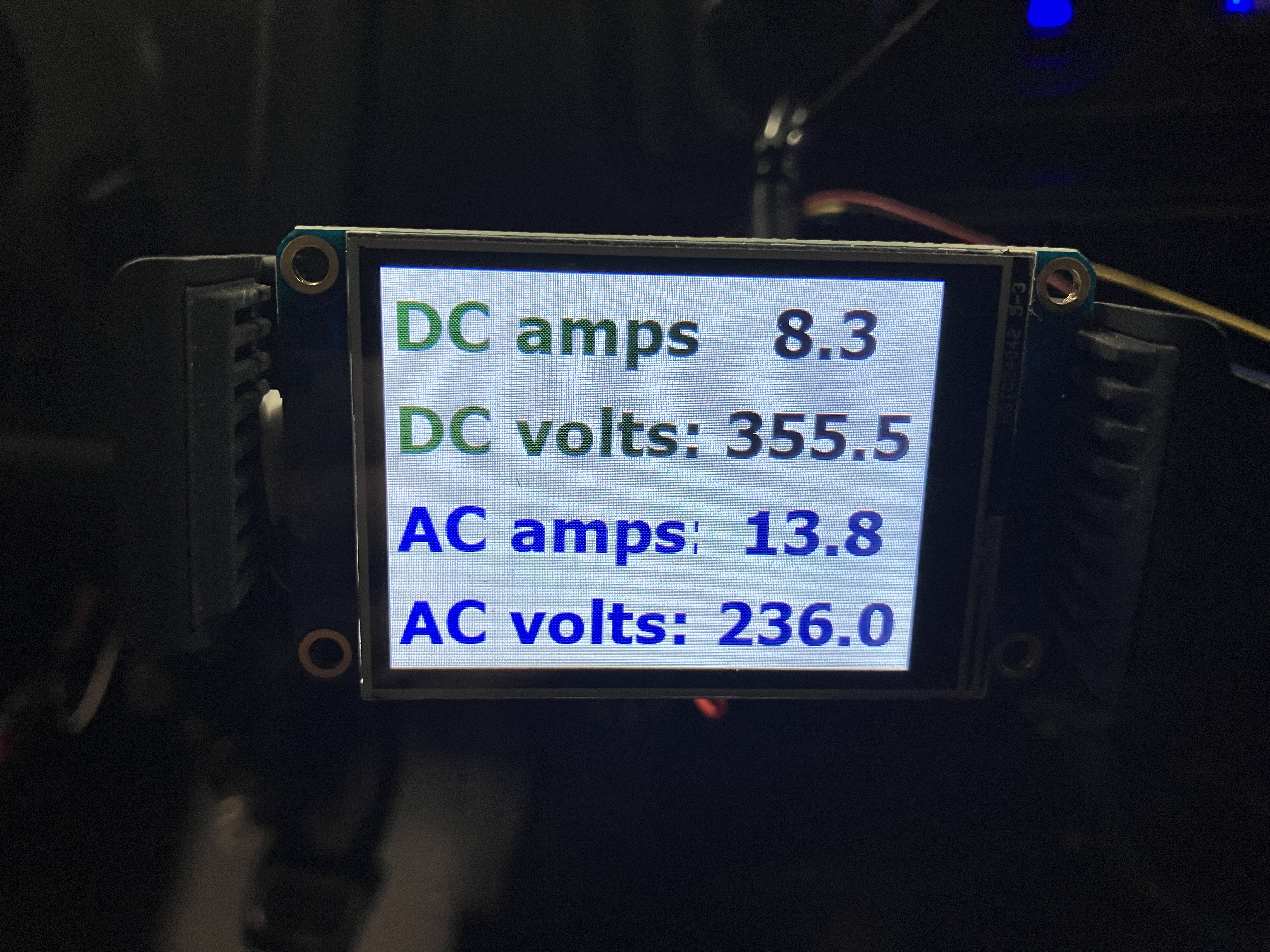

So I am using the widely popular in EV Conversions 1st gen Chevy Volt Charger and it works great. It speaks CAN and that is documented and supported. It also charges the regular car battery in addition to the big high voltage traction battery pack. It's younger brother the 2nd gen Chevy Volt charger speaks PWM and though folks have got it working on their test benches I have yet to come across people running them in their vehicles successfully, please correct me if I am wrong.
I bought the Tesla Model 3 combo unit because it is two things in one: it is a charger and a DC-DC converter in one box, and that means less cooling hoses to plumb, and less engine bay clutter. It may even have built in EVSE chargebility in it I don't know. I am slowly trying to build up the courage to use it.

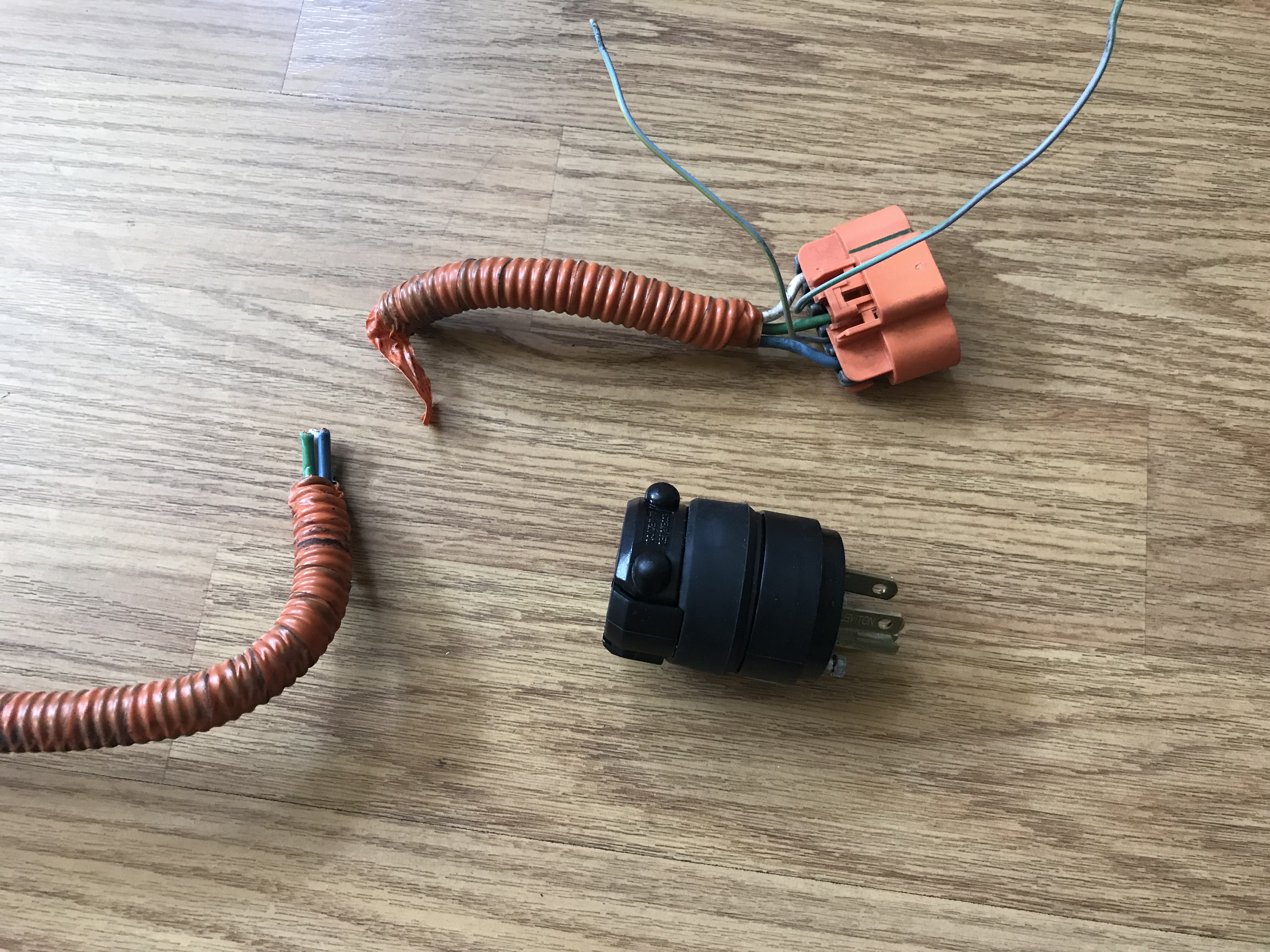

"Level 1 - aka 120 volt 12 amp AC" Homegrown Charging
So although the 1st gen Chevy Volt onboard battery charger is made out of metal, is water cooled, and happens to be bolted up to your vehicle, it is still just a brick, a overgrown AC adapter if you will, no different than the one for your laptop. So I just simply lopped off the OEM connector off it's AC cord and fandangled a standard dime a dozen 120 volt 15 amp NEMA (pronounced: "American") plug on it, and called it good, and I charged the truck with it for a month or so
but you already knew that

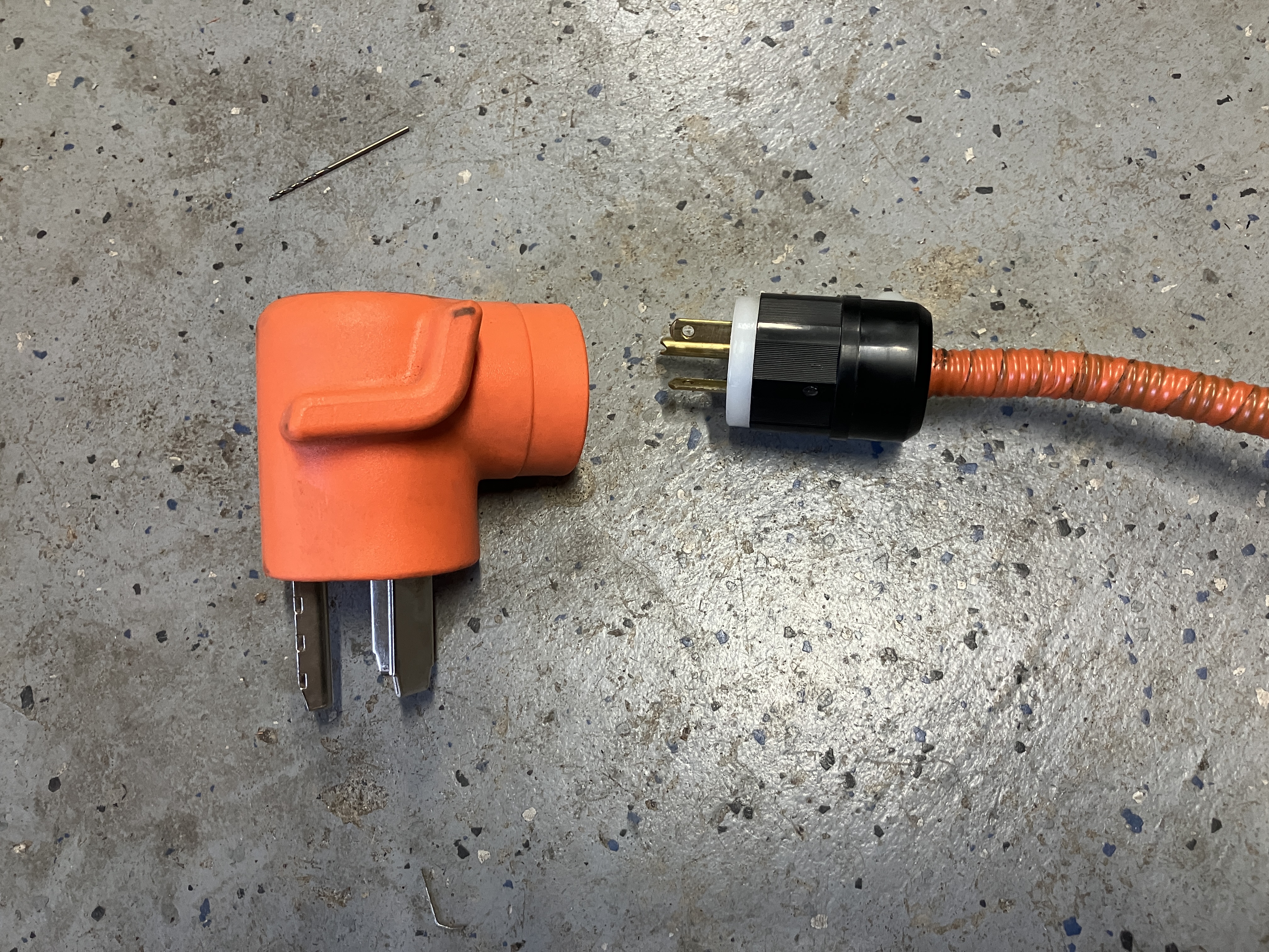

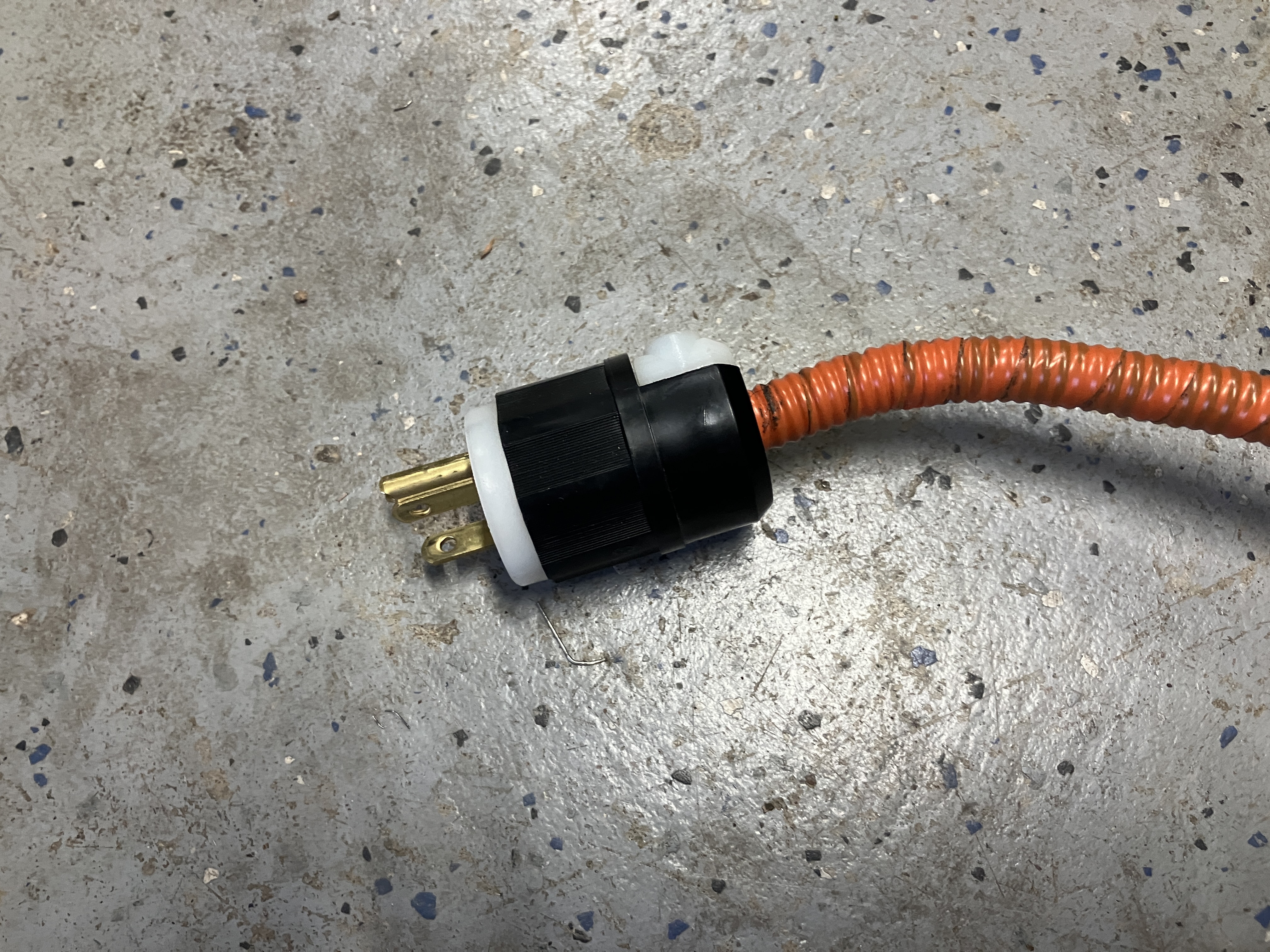

"Level 2 - aka 240 volt still 12 amp(ish) AC" Homegrown Charging
The conversion from 120 volts to 240 though clever was super easy! So forgive me but I can only speak about electricity outlets in the States. Charging at 120 volts has its perks, you can find a standard 110 /120 volt outlets everywhere, but when you want to charge faster, your choices of outlets narrow.
In the "American" homes we have a choice of three outlets:
  • 1. 3-prong clothes dryer outlet
  • 1b. 4-prong clothes dryer outlet
  • 3. 3-prog cooking range/oven outlet

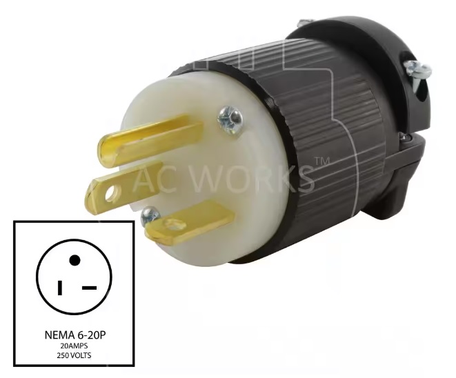

Let's start off by eliminating the range/oven one first. It would be nice to use this 240 volt 50 amp circuit but lets face it, the kitchen is way too far to reach from the garage and we don't recommend extension cords for this level of current. Also most of the time the ovens are hard wired into the wall anyway so there is no oven plug easily accessible to unplug and plug our vehicles in.

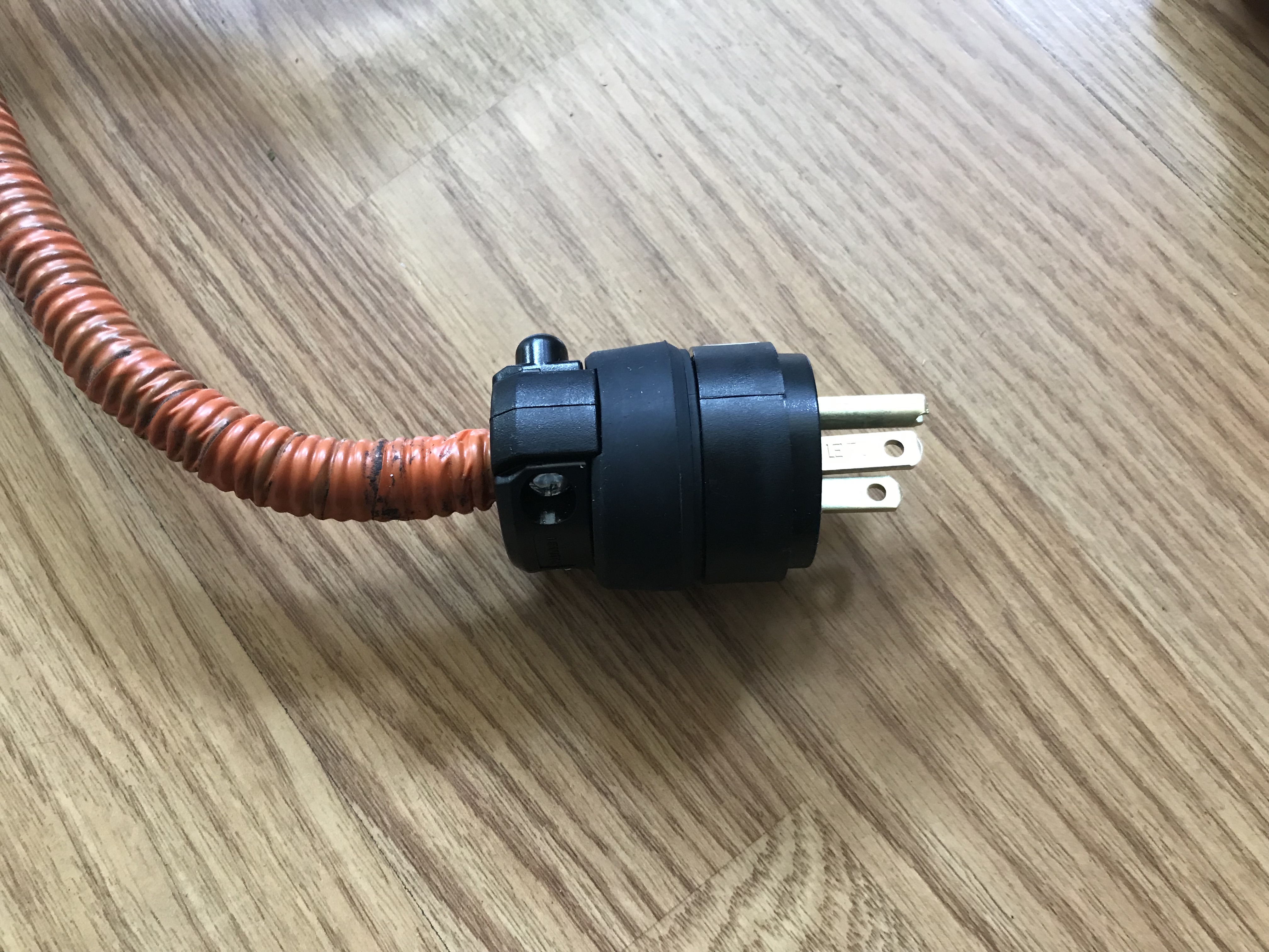

So that left me with the clothes dryer, and regardless if mine was a 3-prong older style of the 4-prong newer kind, I had to first replace my 120 volt plug with a 240 volt one.
20 Amp 250-Volt NEMA 6-20P 3-Prong Industrial Grade Havy Duty Male Plug - from Home Depot
and this is where things have to get worse before they get better...

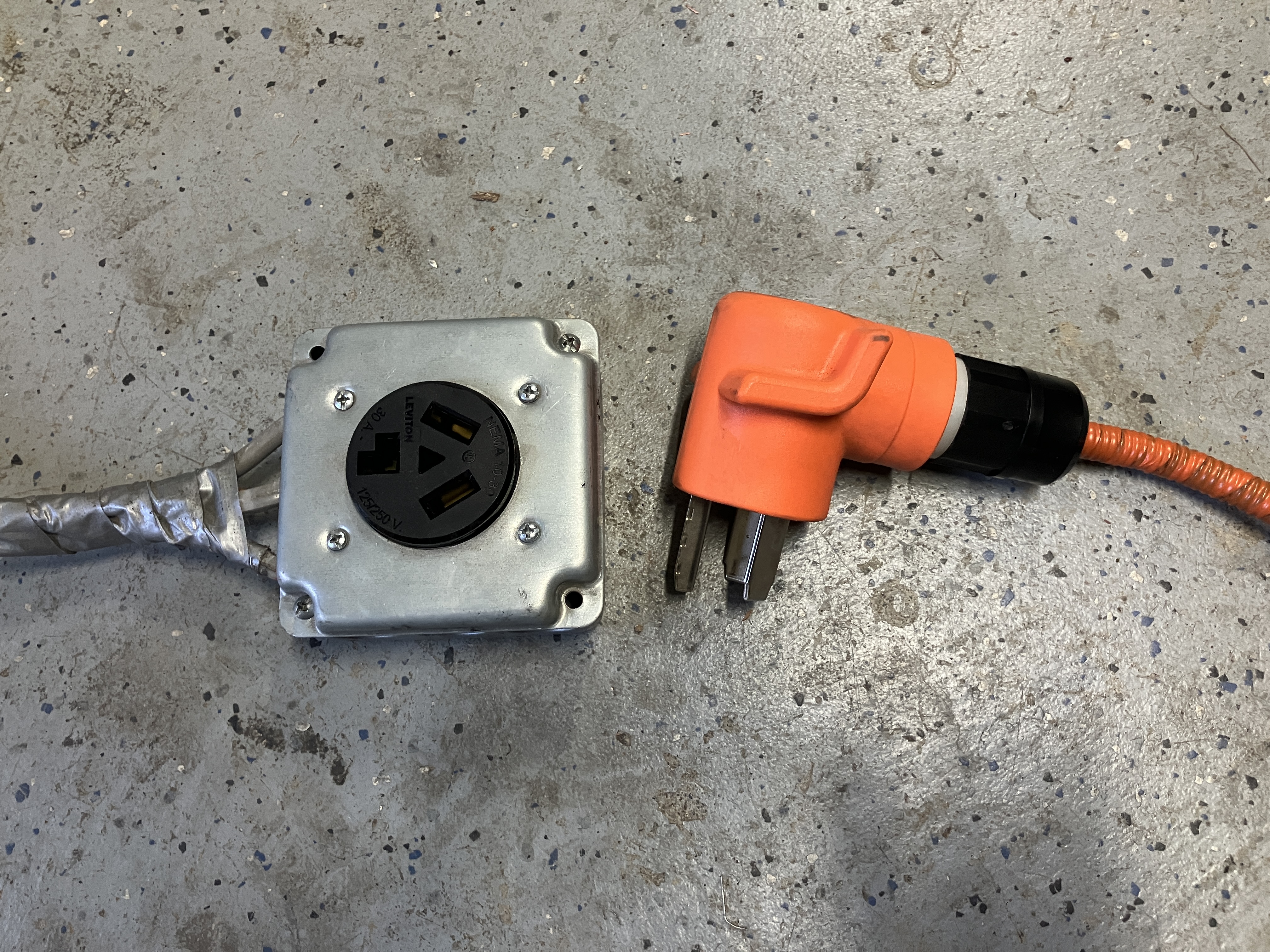

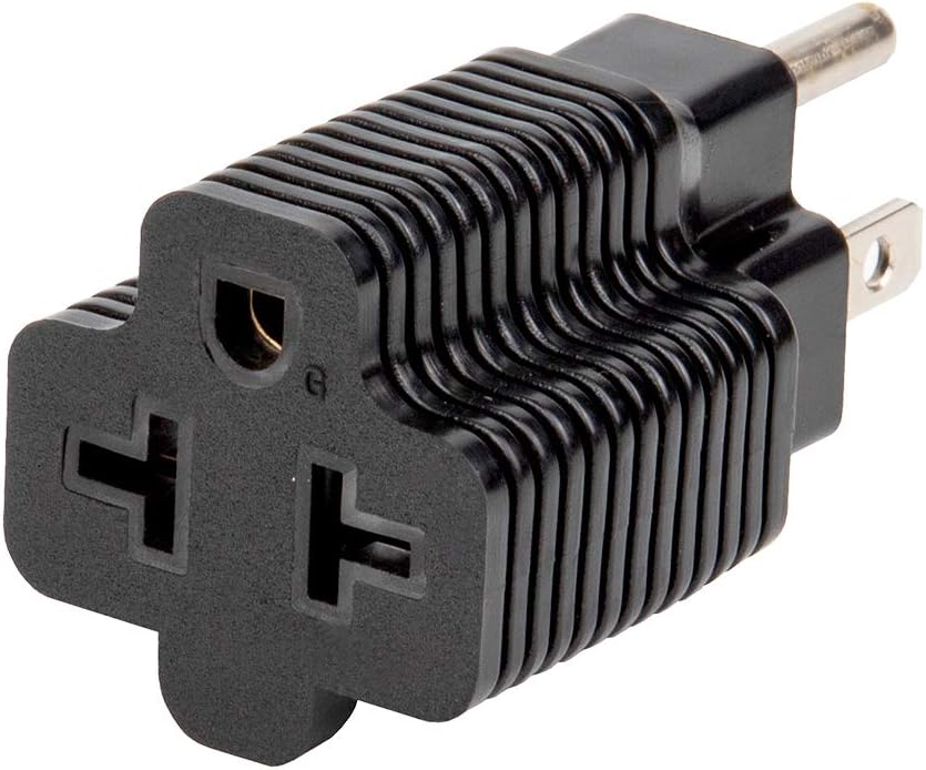

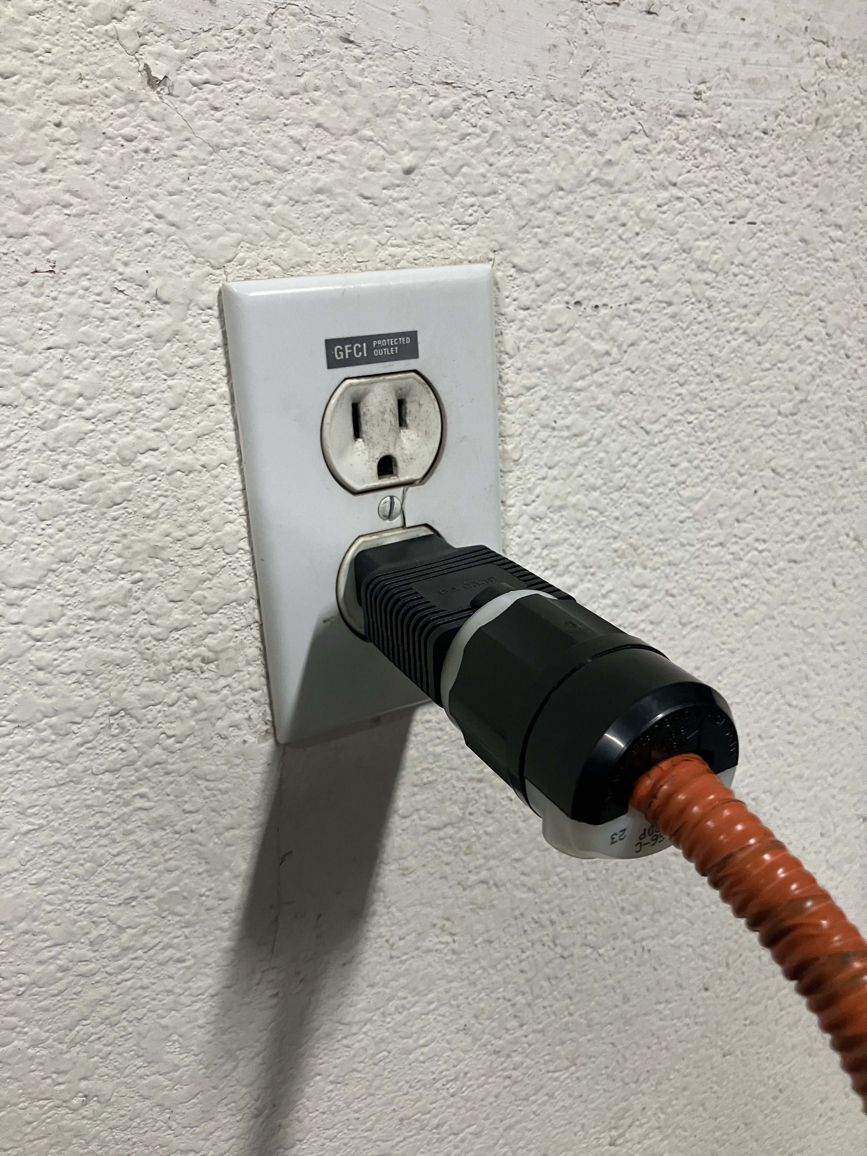

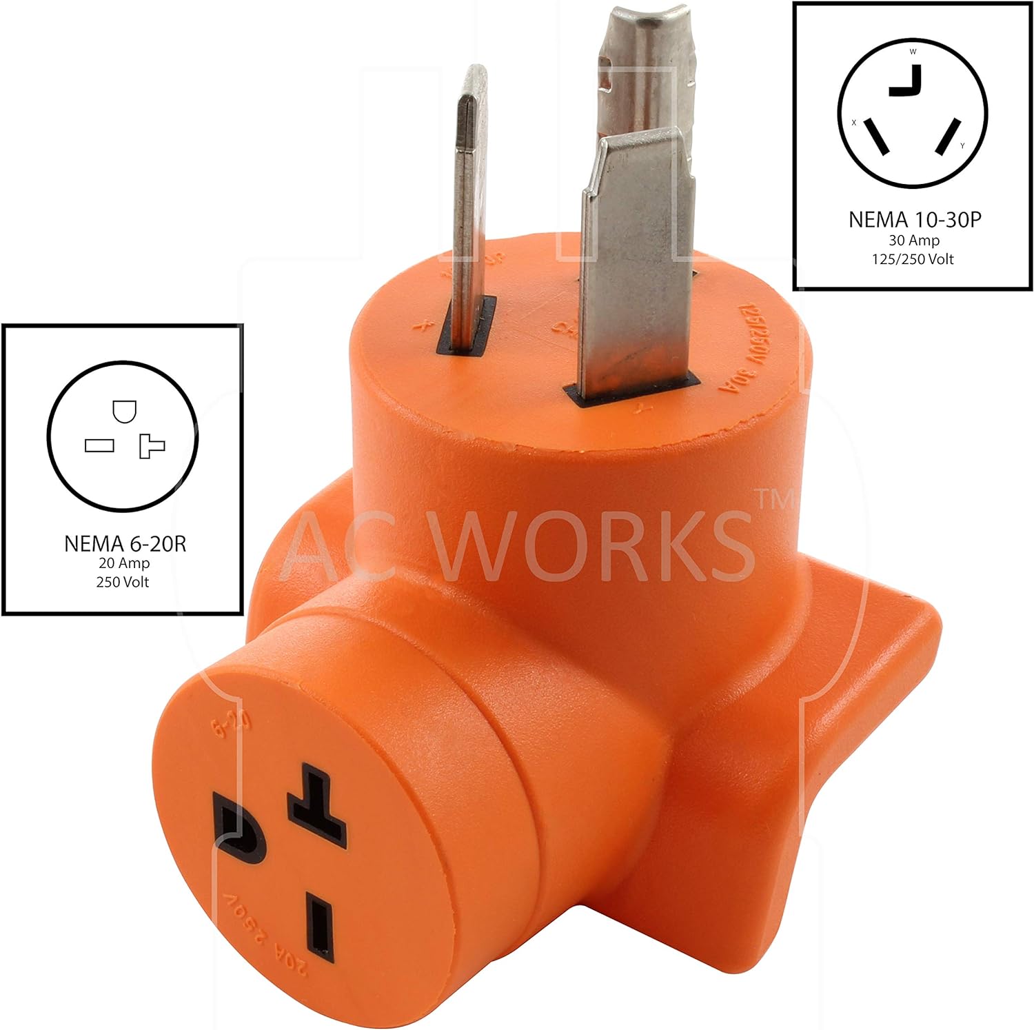

great, now I spent money and time on a plug that left me unable to charge on either Level 1 or Level 2
So first I bought this 4 in 1 AC Power Adapter on AMAZON to be able to charge at Level 1 again
15 Amp Household AC Plug to 20 Amp T Blade Adapter:
  • 5-15P to 5-20R
  • 5-15P to 6-15R
  • 5-15P to 6-20R
  • 15A 125V to 20A 250V

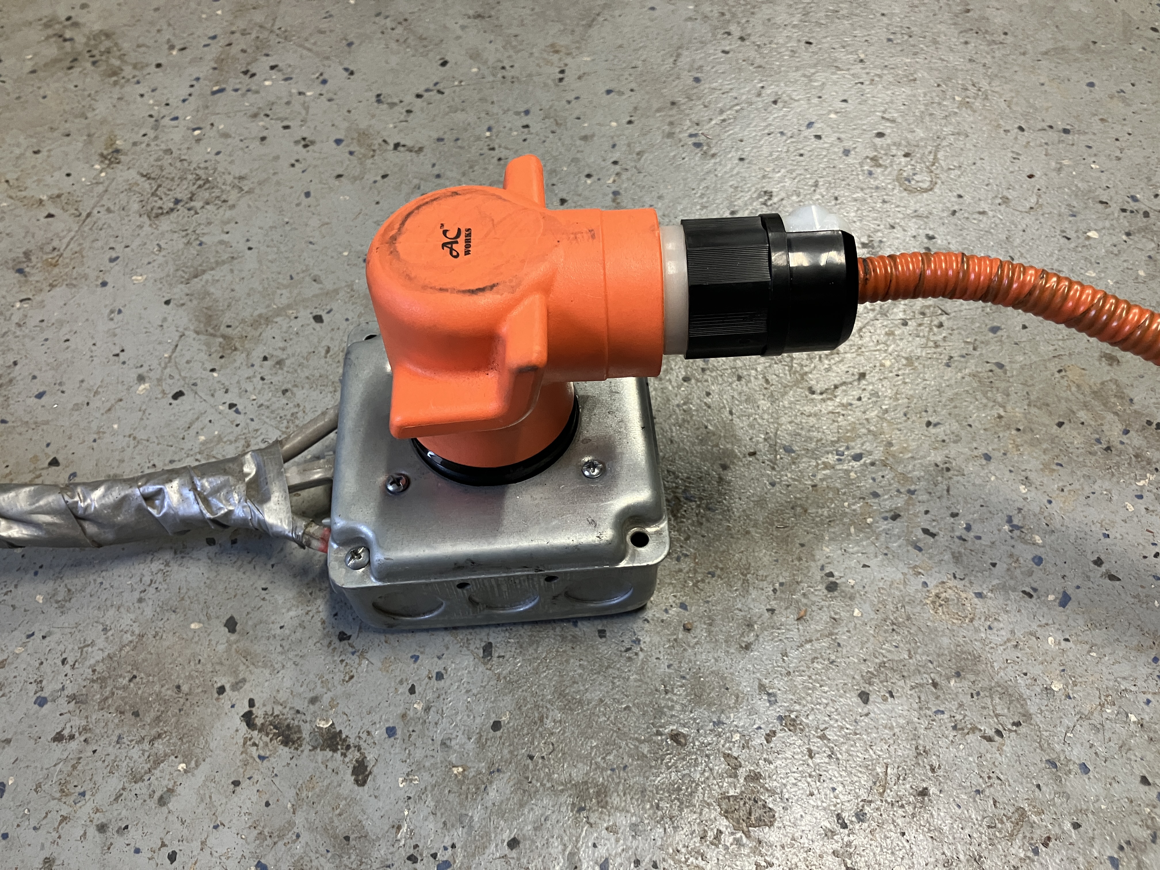

and then to finally be able to charge at Level 2 I bought this AC WORKS 30 Amp 3-Prong Dryer Wall Outlet Adapter also on AMAZON

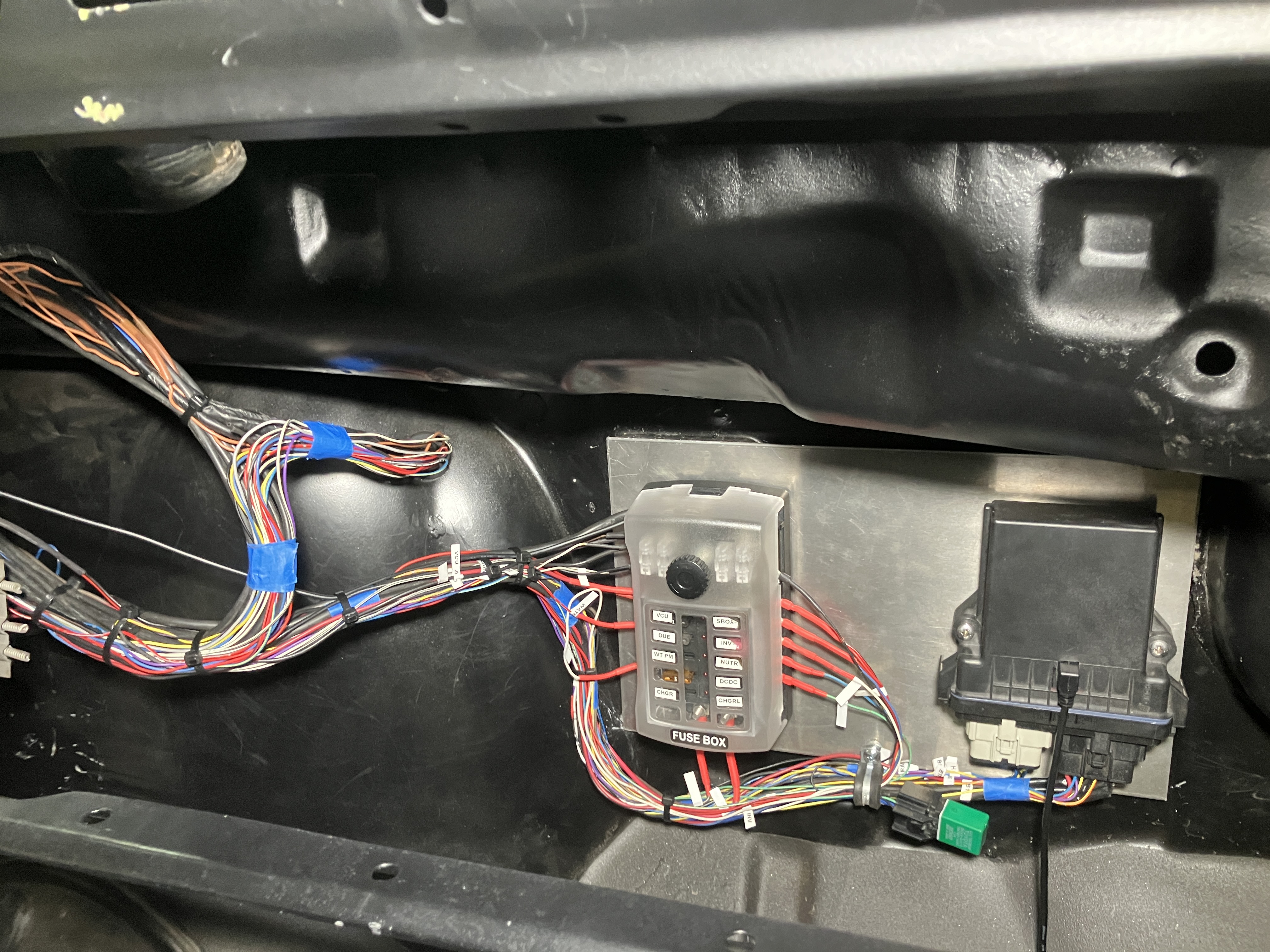

one of many trial fidaments
and here we add the VCU

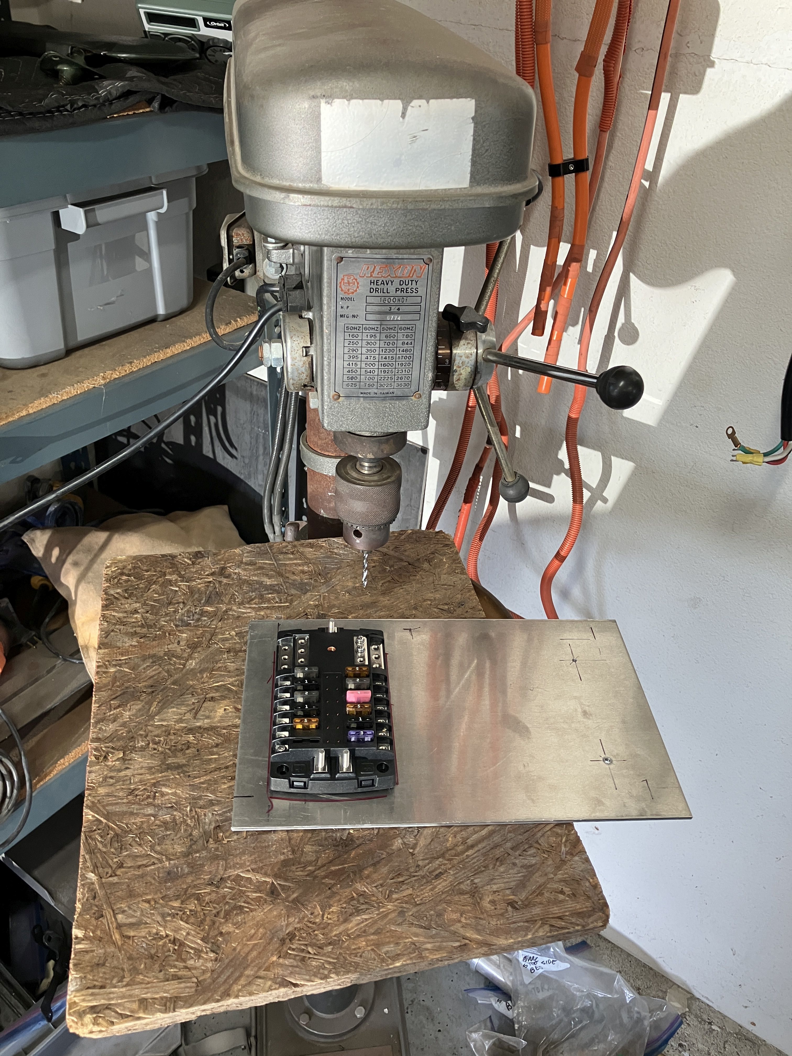

Post by Gregski »

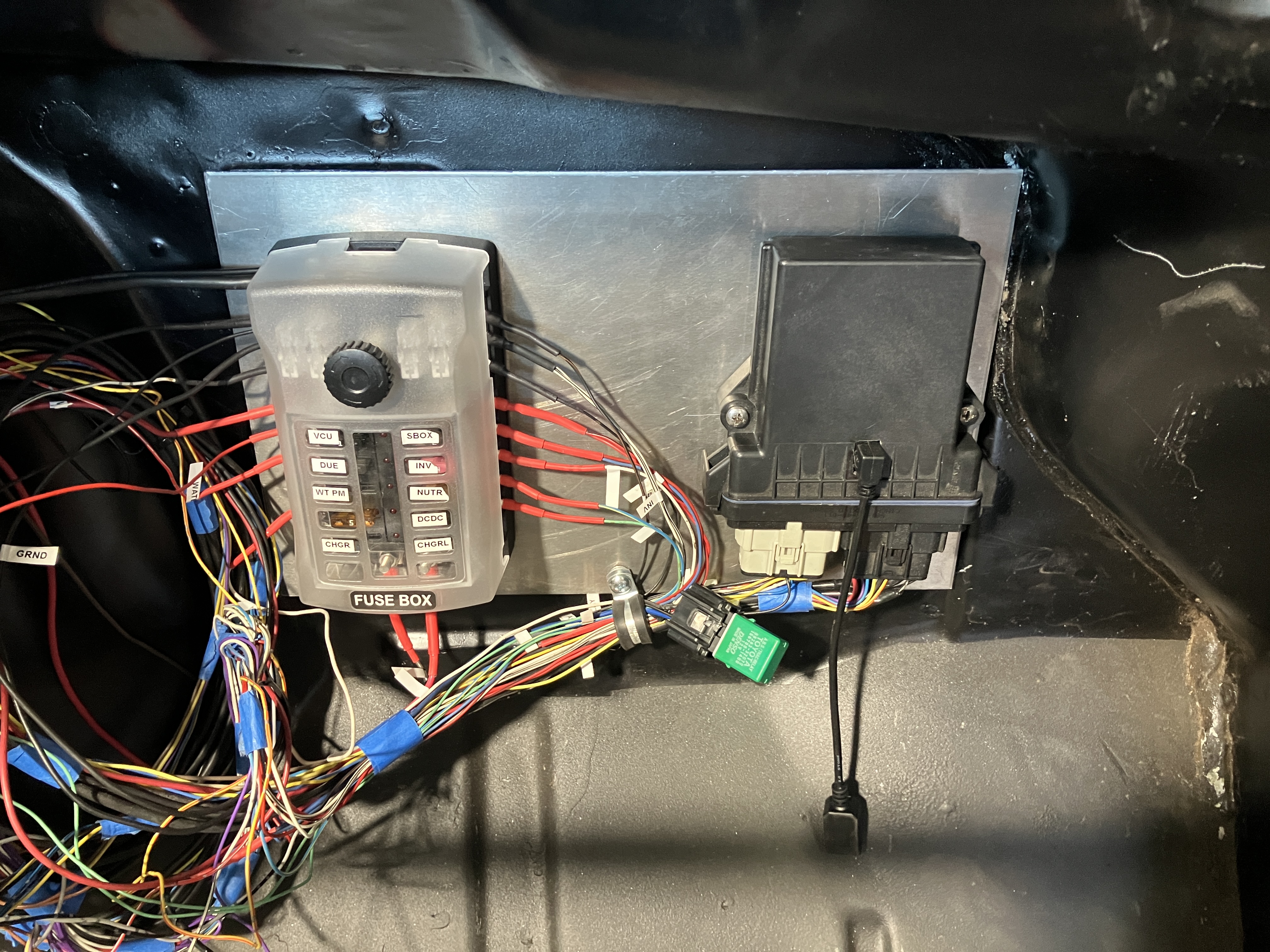

I really didn't want to put holes in this firewall especially after days of welding the ones that were originally there all up, but I think I can live with two, and I might could mount the oil pump and water pump relays on this side using one of them acorn nuts
Gregski
Posts: 3161

Re: [DRIVING]1971 GMCe Lexus GS450H BMW 530e Tesla Model S powered Electruck
Post by Gregski »
I may be the only guy I know who doesn't mind wiring, my wife calls it my therapy ...

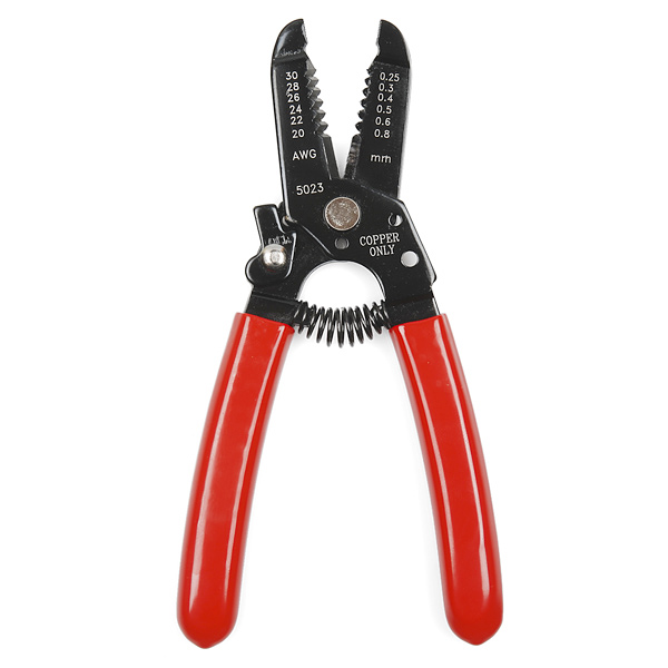

A couple Wiring Top Tips from a wiring semi amateur
1. you can always make the wire shorter (not so much the other way)
2. not all crimpers were created equal, treat yourself to a quality crimper, one tool at a time as you need it, don't go out an buy a set of 19 different wiring tools, 18 of which you will never need
3. these are NOT proper wire strippers, I don't care that your neighbors uncle wired his entire house with one of them when he was only 13 years old
4. Never Ever Never use these hard plastic shielded terminals, if I catch you I will drown your goldfish, now go throw yours out, I'll hold...

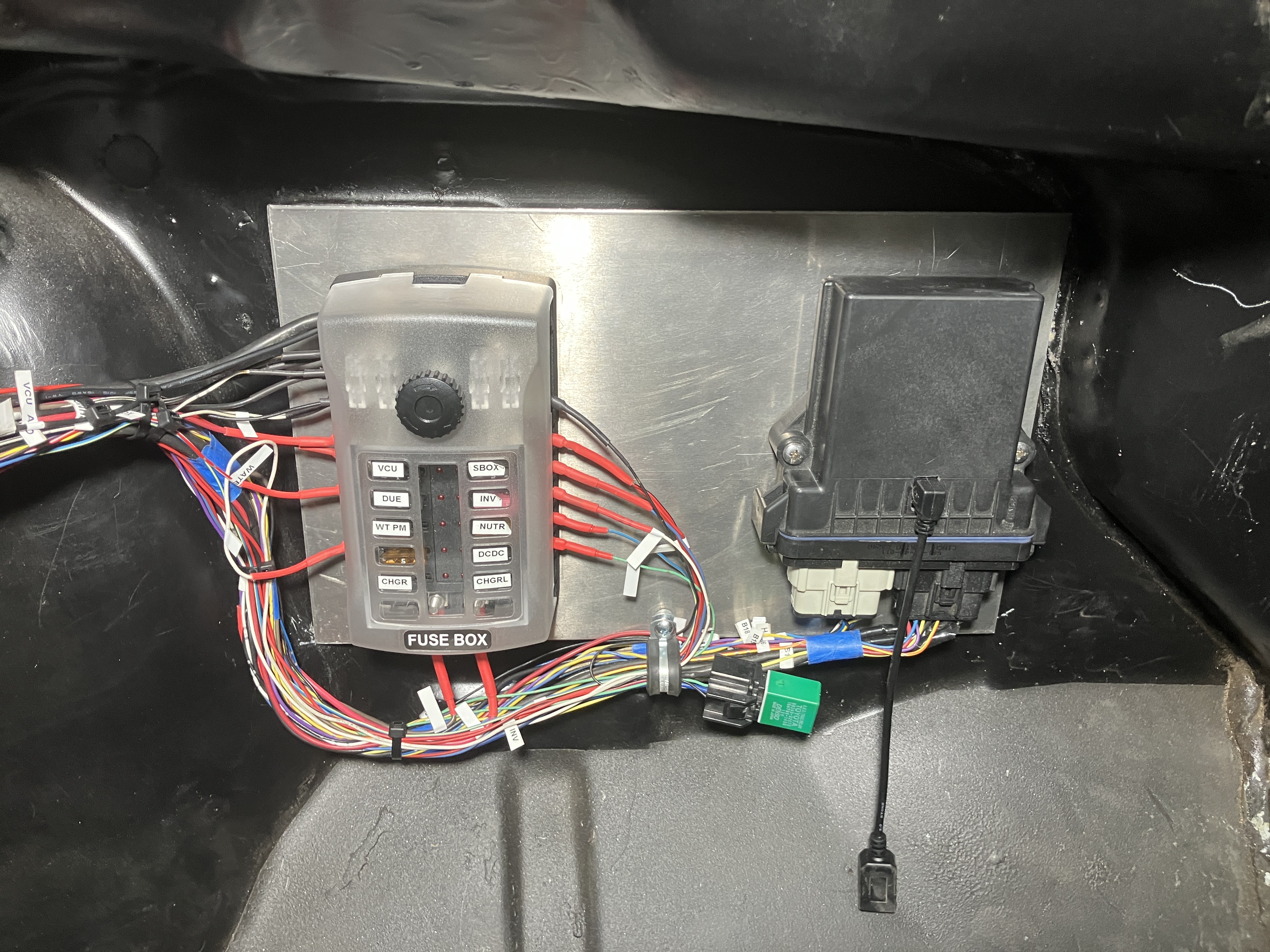

it's getting there, and I don't mean to sound pompous, I have literally been shortening some of these wires a foot at a time, and once I install some sort of EVSE charging solution module thingie I will do one more pass and thin it out some more now that we have the EV Fuse Block / VCU mounted in Siamese Formation
that green thing is a 5 pin relay that turns off my charger when in Drive Mode, it may be going away, again based on what charging solution I end up with

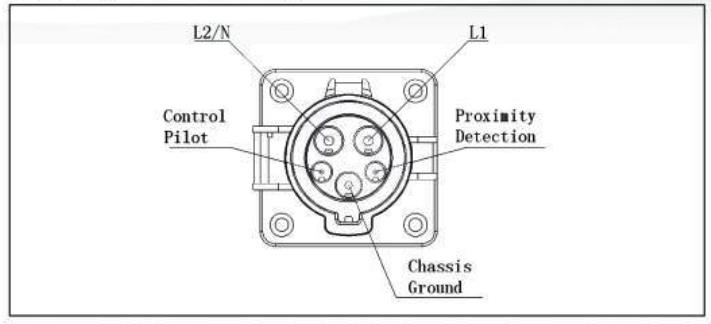

2. Control Pilot
So we pull up to a public charging station, plug the car in (assuming all the credit card account info jives) then what happens?
Well, the charging stations sends 12 volts to the car on both the Proximity Pilot and the Control Pilot pins.
Our plug in the States has 5 pins (pins are just connector thingies) 3 are used to send power and 2 are used for communication. Our focus is on the 2 communication pins, the Proximity and Control Pilots.
the magic happens on the Control Pilot pin simply using all hardware in the form of resistors and diodes, as the vehicle signals the charging station using different volts between 0 and 12, think smoke signals
  • 9 volts means we plugged in and want to charge
  • 6 volts means start charging
In addition to establishing the handshake if you will above, the charging station uses PWM to communicate still on the Control Pilot pin to the vehicle how much current it can pull, but that's some VooDoo for another day.
If we are dumb enuff to try and unplug it in the midst of charging [some] handles have triggers which while pressed will use the Proximity Pilot to signal the charging station to stop the charging so that we can remove the handle from the vehilce [safely]
