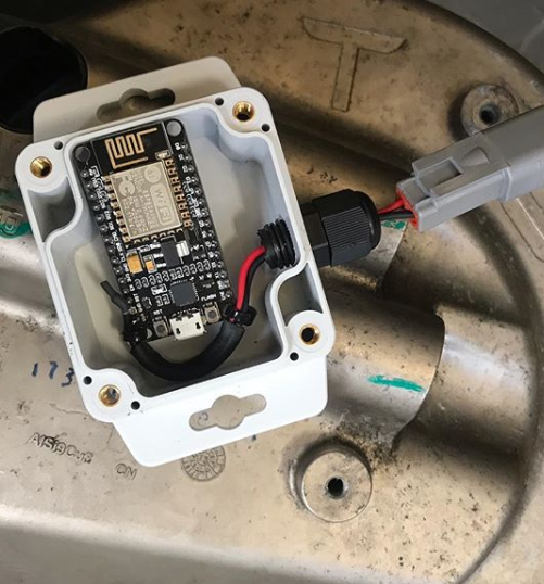

WiFi.setOutputPower(20.5);Re: Built in WiFi
The olimex wifi module didn't work in my inverter. Got no signal at all!!
viewtopic.php?f=16&t=186#p2349
Had to put it on the outside.....

Re: Built in WiFi
I had to be near the back of the car to get a reliable connection. I added a nodemcu as a wifi repeater in the trunk and I can be a few yards away from the car now.
Re: Built in WiFi
Did you make change in the code? Seriously 802.11b will go through anything, lead, metal, your skull
WiFi.setPhyMode(WIFI_PHY_MODE_11B);
