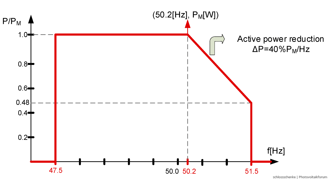

Re: Make grid tie inverter work off grid, $100 REWARD FOR SOLUTION
One thing to have in mind is, that grid tie inverters have to react on frequency changes of the grid. (at least in Germany/Europe)
As any change in load has an effect on frequency, the load/frequency control has to be rather fast I think.
Better hope the grid tie inverter also reacts to AC voltage changes, because cheap offgrid inverters surely won't implement any "frequency droop".
Random thought: If the grid tie inverter does react to voltage changes and the system still isn't stable, it could help to leave a length of wire between the offgrid and grid tie inverters, and to connect the load to the grid-tie end of that wire. Then the grid tie inverter is able to see more pronounced voltage changes when the load changes.
