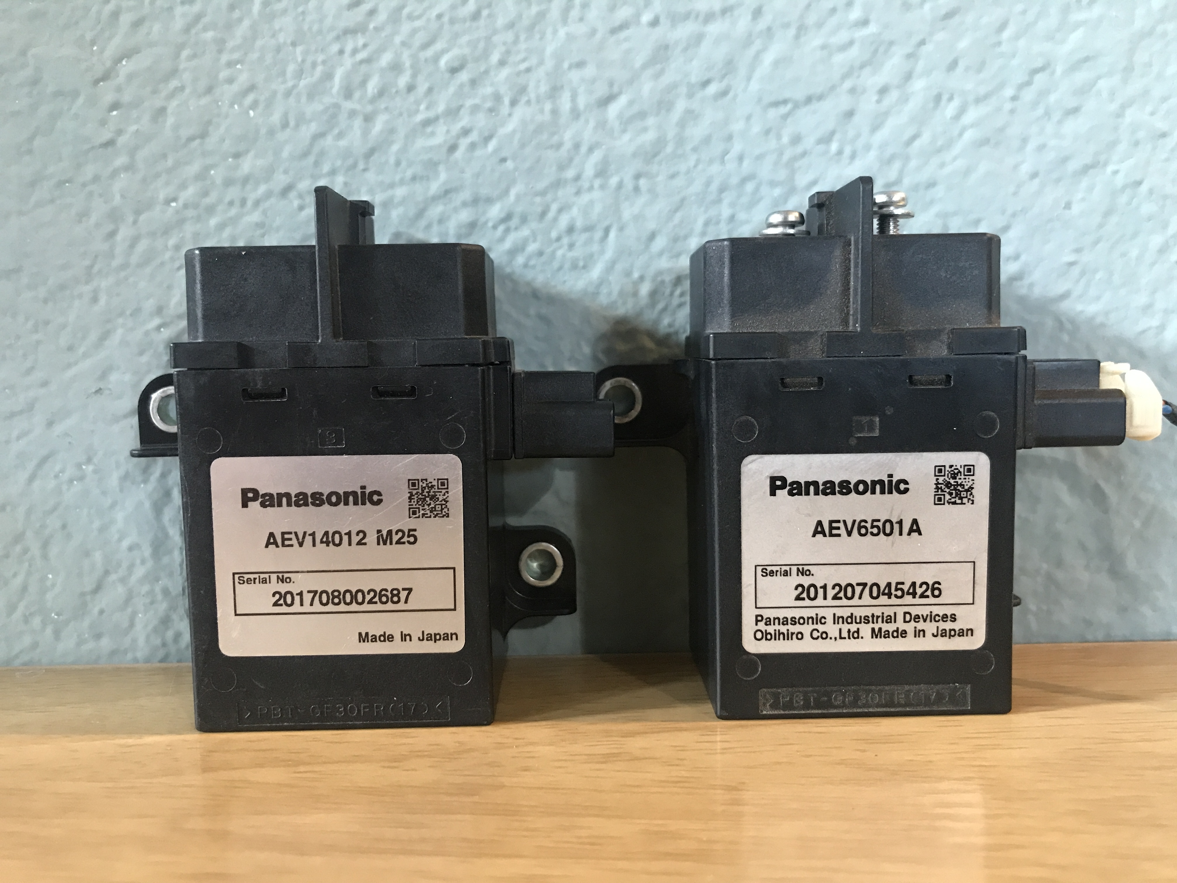

Mandatory Stare and Compare: our BMW 530e contactor on the left and the Leafster on the right

and a little comparison of the Three Amigos so far
