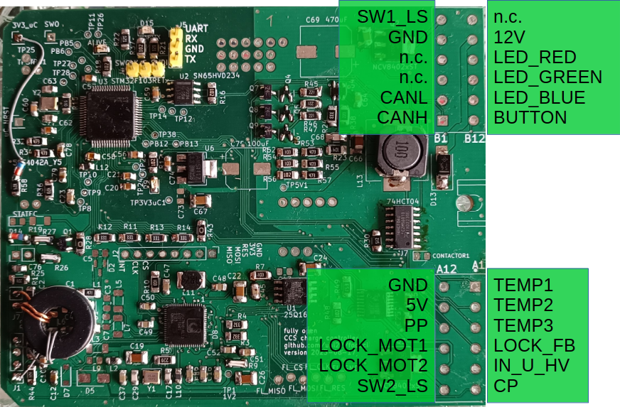

I thought about this pin mapping again. Since it is 2 connectors how about a clear split of signals that go to the charge port and those that go to the car? That would make it possible to have 2 separate wiring looms.
EDIT: just found you've done that as far as possible

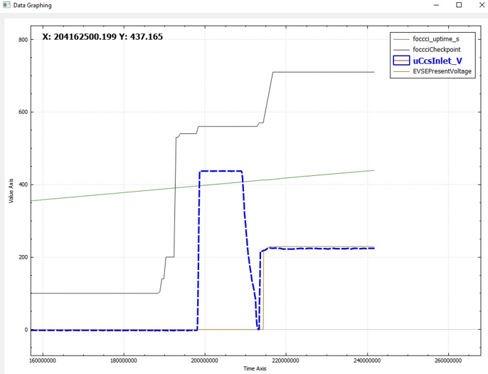

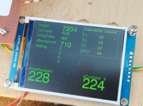

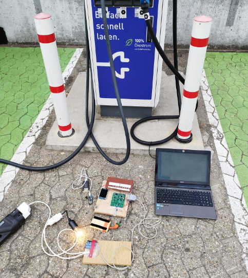

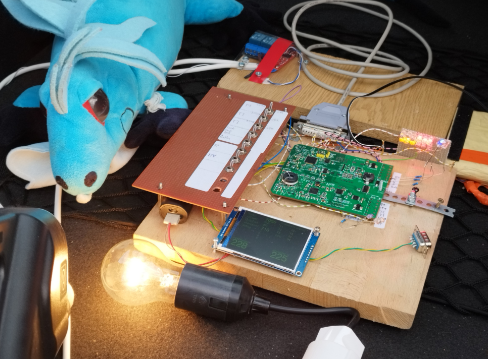

Light bulb demo on alpitronics and ABB, using the foccci V3 and ccs32clara worked on the first attempt. On Tesla supercharger it did not work. Need to improve the logging situation, to further analyze this. Using SavvyCAN via WiFi, this is really nice, but at the moment the stability of my interface lacks, and the clara should provide more logging details on CAN.
