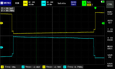

Hi Everyone, I'm posting this here as I think I'm starting over. Over 2 years ago my Rev2 kit was spinning the (Enova) motor ok on basic bench tests. I then put it aside to get on fitting/mounting the motor in my project car (2008 mercedes B200).
2 months ago I hooked up the inverter to the motor in the car, only to find the motor didn't turn.
I checked the motor for shorts, continuity and that it turned by hand - all ok. I then tested the inverter boards....

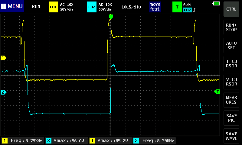

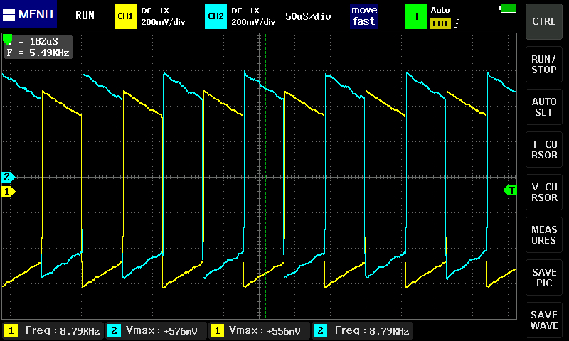

Gate inputs showed 50/50 waves but they have slopes on crests. Gate outputs 50/50 square waves and I also seem to have sq waves on phase outputs - no sine waves. Any ideas please? I'm struggling to know what to look for now.
(the fact that I haven't used a scope for 45 years may be a factor :) ).
I also tried Peter's idea from a previous years post - to connect bulbs across phase outputs. I used 21w bulbs (maybe too large?) and only got a glow at 24v, on each - no pulsing.
Thanks for any input here ...... Steve

Ok I think I've found the answer. Stripped down inverter and checked everything again - One IGBT was faulty... Now replaced
