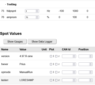

I just changed the Toyota Prius2 Inverter for the third time and replaced the wiring connections as well.
Tested the set with both program`s versions 5.27 R-foc,5.32 R-sine.
At the beginning there was perfect open loop performance.( Made a video clip of it ),but after shutting down the program and restarting get some confusing performance. The Spot value --Opmode is in manualset , but the motor & lamps don`t run. The spot value- LASTERR is stating LORESAMP instead of PRECHARGE.
After couple of restarting’s and version uploading’s get it again starting, but after shutting down and new start again the same error.
Who is causing the LORESAMP error ?
There is not a SINCOFS command in the both program`s versions. How can I perform the tuning process then ?

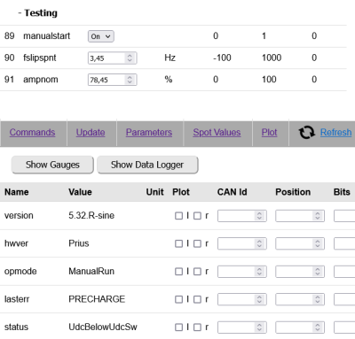

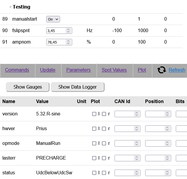

Here is picture of the 5.32 R sine programm with shown Manualrun and test settings.The problems is ,there is again no running motr at all.
- uhi22
- Posts: 1244
- Has thanked: 245 times
- Been thanked: 684 times
Re: Toyota Prius Gen2 board reports NOT implemented in FOC variant
Is there a wiki page which explains the meaning of lasterr=Precharge and Status=UdcBelowUdcSw? Everybody is invited to improve the documentation.
My uneducated guess: The battery voltage is below the configured minimum threshold, or the related contactors/cabling is wrong. Try to measure the voltage physically with Multimeter or scope and compare it with the voltage which the inverter sees, and with the udcmin setting.
- Been thanked: 1918 times
Can you post http://192.168.4.1/cmd?cmd=json as a text file while in this state? The portion I do see looks correct, but it would be important to see the rest as wellDIETZENBACH wrote: ↑Wed Oct 18, 2023 5:48 pm Here is picture of the 5.32 R sine programm with shown Manualrun and test settings.The problems is ,there is again no running motr at all.

Attached are frameshots from the settings.

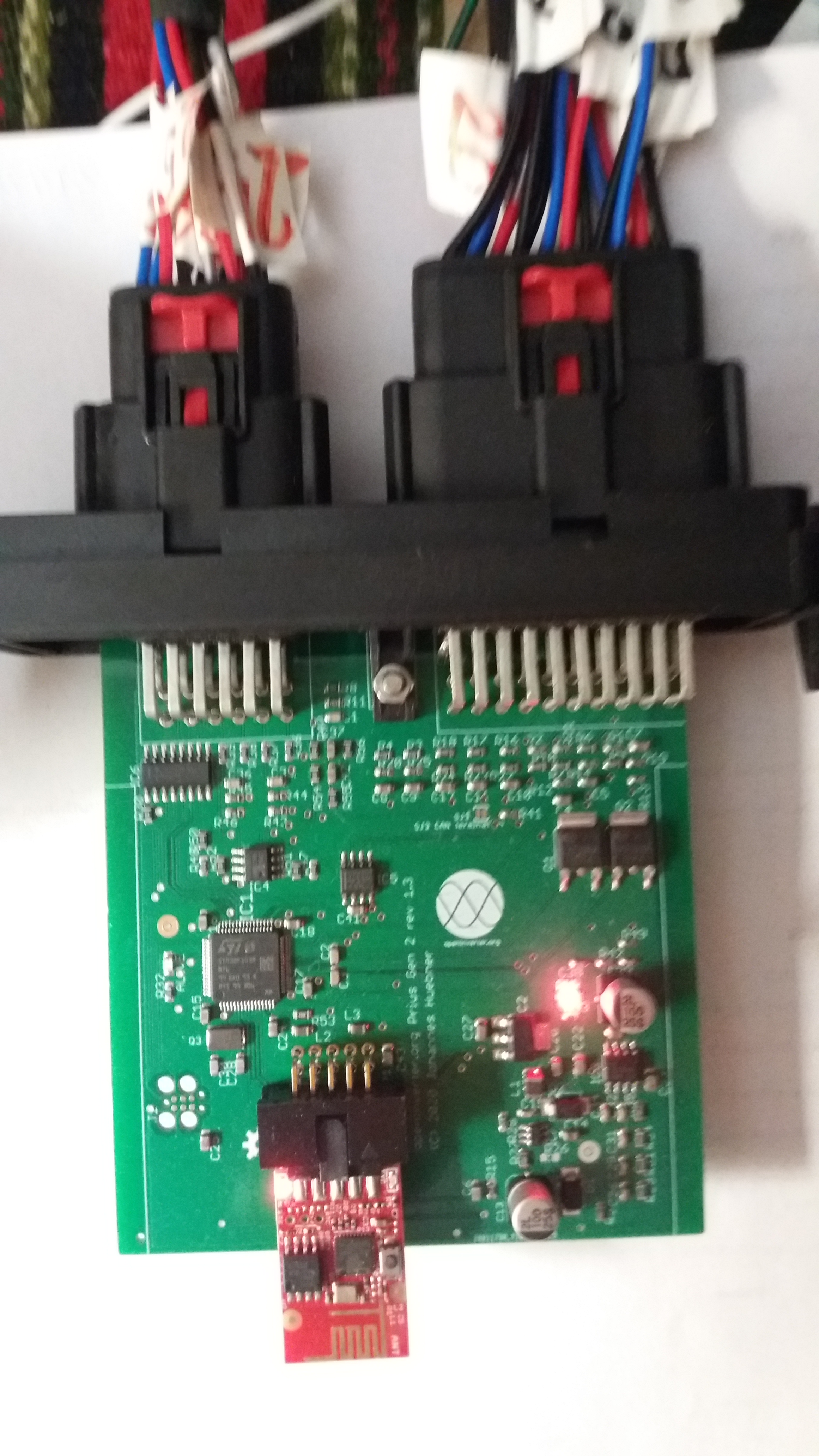

After some uploads of the sine/ foc program versions the blinking light on the board ceased work.
I am able to go to the website ,but without parameters.
Is the board clogged or damaged?
DIETZENBACH
- Posts: 62
- Joined: Mon Jan 03, 2022 11:34 am
- Has thanked: 22 times
ST LINK V2Here is the jammed VCU board .
Should I preprogram the board with the ST- LINK V2 to free it from the program`s clogging?
How could it be done then , where there are not pins but microdots for connecting to the board? Do You have one other special connector ?
Maybe first try to update over the web interface again, that should also repair it. Otherwise solder thin wires to the spots
