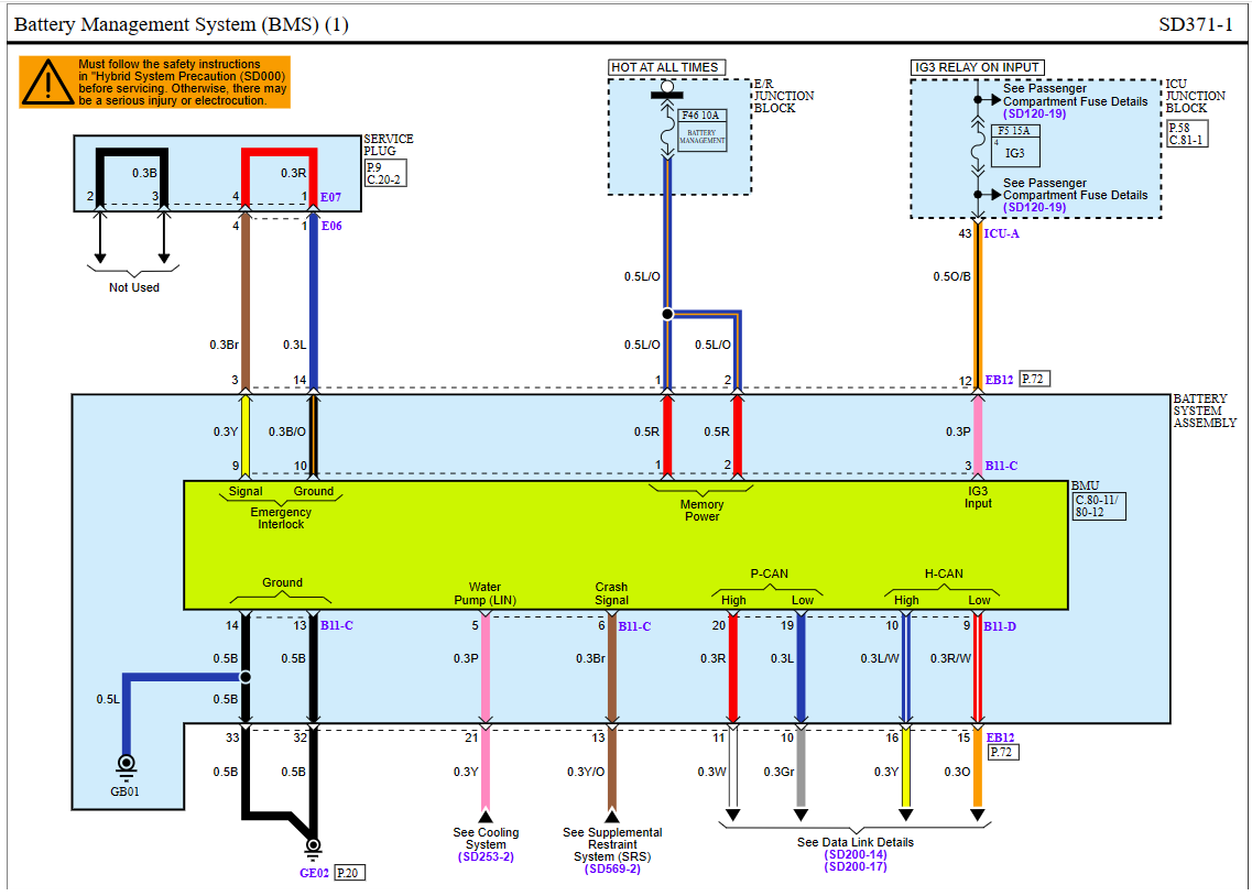

Hello,
i recently bought temporary battery (37501-CL500) for my ev conversion and i'm trying to close contactors. EB 12 connector has similiar pinout to other models and i managed to read some data via OBD II. PIDs are the same as in other models, for example: https://docs.google.com/spreadsheets/d/ ... 1176199607.
When i play can log from Hyundai Kona, UDS ReadById 101 byte 53 which is ignition state, and probably HCU ready, MCU ready, etc changes to correct value but contactors remain open. Additionaly 0.5 s after turning ignition on BMS fault appears which means CAN bus is innactive. According to service manual HCU has to send command to close contactors on H-CAN. Unfortunately i can't find on the internet any log from this bus, even from other models, or from KIA, only from P-CAN and others.
Has anyone tried using this battery, has can logs, or is able to record them?
You can find my logs and SavvyCan script to read diagnostic information here:
https://github.com/maciek16c/hyundai-sa ... ev-battery

Are you aware that there are BMS's on the market?

I know there are BMS's available such as SimpBms, orion bms or fox bms, but they are either as expensive as my whole battery or have to be modified. I think it shouldn't be difficult to use current bms, there is only few can frames missing and that's why i need h-can log
Re: Hyundai Santa Fe 2021 PHEV battery
I got it working. There are probably still few warnings but i can charge and discharge it.
There are 4 frames needed:
BMU closes contactors automatically with request in frame 0x200 or 0x2F0. If you want to run battery using this script don't connect anything with high capacity (inverter) to battery output because it doesn't measure voltage after contactors, only uses CAN messages to get this voltage, and could close main contactor with very short precharge.
I have also added support for this battery to zombieverter VCU: https://github.com/maciek16c/Stm32-vcu
For easier use i connected both CAN buses together

- Can you confirm you are connecting straight to the BMU (no other devices on the PCAN bus) and by only sending a 200 frame, you get your contactors to close?
- Would you mind sharing your CAN logs? It may help me finding out why it works on yours but not on mine.
- proably a dumb question - you do mention H-CAN. How is HCAN connected to EB12?

Thanks! So, there are indeed some differences with your PHEV battery and a kona/eniro EV one. The HCAN on EB12 (pin 15,16) (for me EB11) is not used on the cable connecting the battery to the rest of the car, but the wiring exists internally to the BMU. Unfortunately, there are no CAN messages on that bus I was able to get or receive.
Nevertheless, it means in a eNiro, the BMU must be queried only using the PCAN - as no other bus are available outside the battery.
Clearly, as I get no reply when sending a 7E4 "UDS" frame (either on the PCAN or by connecting directly to the BMU on the HCAN) it means the battery considers itself "off", even after a 523. (and a 200, 2F0 and a 2A1)

Can you read inverter voltage reported by BMS? Can you change this value by manually sending can frame with different data?
All interlocks have to be shorted (battery output, charging input ...) Does your battery have service disconnect? If not you could try finding interlock in EB12 connector by finding pin with 3.3V and connecting it to gnd via resistor (1 - 10 kohm). If voltage drops it should be input and can be kept shorted.

Precharge relay working is a really good sign. Contactors are controlled by bms, not by HCPU. HCPU only sends signal to turn on HV. BMS doesn't close main contactor and opens precharge after 0x200 because inverter voltage doesn't rise fast enough. Try manually sending inverter voltage high enough for example 0x2A1 0,0,0,0,0,0,0xFF,0. Remember to not connect bettery output to inverter when you try it.
Since you can view diagnostic information using elm327 send this frome using savvycan with 10ms trigger and change data to see how reported voltage changes. You don't have to send other frames while you try it.
