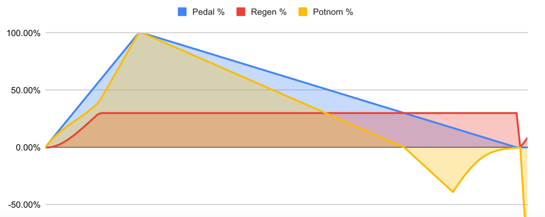

Some tweaks to regen calculation that I did for my branch of stm32-sine.
Added check for rpm, so when rpm is zero and you don't press the pedal, regenZone resets (regentravel disabled). Also added example output how potnom gets ramped with throtramp = 5. And usually it's always ramped, just added example for the most extreme drop to make it more clear what happens in reality.
Here's how it works when driving, when regentravel set to 30 and offthrottleregen to -100

pedal: 35% potnom: 35.000000 ramped (5): 35.000000
Starts lifting off the accelerator
pedal: 33% potnom: 4.285714 ramped (5): 30.000000

pedal: 0% potnom: -100.099998
(car did not stop)
Stopped: RPM 0, Pedal not pressed 0% pedal
pedal: 0% potnom: 0.000000

pot2 (regen pot) turned to 50%:
pedal: 40% potnom: 40.000000 (pot2 50%)
pedal: 39% potnom: 12.857142 (pot2 50%)

After some more testing, I decided to simplify this and use speed in regen calculation. Main annoyance in previous solution being that case when starting on top of the hill and pedal never travels past regentravel, and you get no regen. And what actually happened was that off throttle regen worked, but once you touched accelerator it went eg. from -70% to 5% in instant, and that was not very smooth feeling 😅.
So I added config parameter for speed (maxregentravelhz) where regen is in full power regentravel is at max (eg 30%). It grows linear when approaching defined speed and it goes to zero only when fully stopped.
Picture shows how it works. Uploaded the firmware to car this evening and testing it tomorrow, if it’s not too icy/snowy weather for summer tires :) I’ll update here after that.
EDIT: regen % is always at full power - it's only regentravel which gets adjusted. regenrampstr still works. You can see regenrampstr effect in picture where yellow line starts to go closer to 0% after being negative.
EDIT2: in picture, Regen % label should be Regentravel %

Posts: 251
Has thanked: 40 times
Been thanked: 41 times
Re: Accelerator pedal dead zone
Post by mane2 »
Updated the previous post, as I had few errors in text and in picture. Hope it makes more sense now :)
