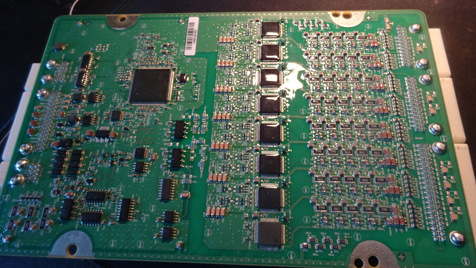

Hello, im trying to use your code and an Arduino to patch into a HEV BMS from a niro as i have been unable to find the CAN commands for the contactors, I have connected to the spi and i think im getting them to talk but the board design is different to that of the CMUs, It has 8X max17845 chips onboard.
I tried playing with the code but i dont know what im doing, and I keep getting "error byte cleared" in serial.
Is it possible to get this to work? could i get some help.
Thank you
bexander
Posts: 883
Location: Gothenburg, Sweden
Has thanked: 75 times
Been thanked: 98 times
Re: Kia Niro BMS
Post by bexander »
Yes, this seem to be a integrated BMS, interesting.
So you have connected via SPI to the onborad MAX17841, correct?
My SW is hard coded to 12 slaves with 4+4 cells connected at pos 1-4 and 6-9. This will have to be changed to 8 slaves with 9 cells connected.
The number of slaves also determines the value of check byte so this have to match.
Please provide a serial print out of your results so far, helps a lot for me to determine your progress.

bexander wrote: Thu Oct 26, 2023 4:17 am The number of slaves also determines the value of check byte so this have to match.
I ment the alive-counter. 0x0C with 12 slaves, 0x08 with 8 slaves. Will need to be changed in 3 places in the SW, daisyChainInit(), writeAllSlaves() and readAllSlaves().
That should get you through the setup.

Thankyou this is exactly what i needed to know.
Yes I have connected to the SPI of the MAX17841 and pulled up the respective pins.
So i have edited 0x0c to 0x08 in the code.
does this need to be edited too?

Im not exactly sure how to edit this i just want the voltages from 1-8 on each chip, there are 72 channels even though my bms only uses 64 of them there are no thermistors connected to any of the slaves,
Im not very good at coding i can understand some of it but this is way to much for me, if i start editing this its going to be more of a guess than anything else.

bigmotherwhale wrote: Thu Oct 26, 2023 1:46 pm void readData()
for(int i=0; i<4; i++)
readAllSlaves((0x20 + i), true); // Read CELL 1-4 of all slaves
readAllSlaves((0x25 + i), true); // Read CELL 5-8 of all slaves"
Try this:
void readData()
    for(int i=0; i<8; i++)
    readAllSlaves((0x20 + i), true); // Read CELL 1-8 of all slaves
  //readAllSlaves(0x2D, true); // Read AIN1 of all slaves (Cell temperature)
  readAllSlaves(0x50, true); // Read DIAG (Die temperature) of all slaves

bigmotherwhale wrote: Thu Oct 26, 2023 1:46 pm void storeCellVoltage(uint8_t dataRegister, uint8_t readRegisterData[29])
if((dataRegister >= 0x20) && (dataRegister <= 0x23)) // Cell voltage registers 1-4
uint8_t cellNumberOffset = dataRegister - 0x20;
for(int i=0; i<12; i++)
uint16_t measVoltage = ((readRegisterData[25-i*2] << 8) + readRegisterData[24-i*2]);
measVoltage = (measVoltage >> 2) * (uint32_t)5000 / 0x3FFF;
cellVoltage[i*8 + cellNumberOffset] = measVoltage;
if((dataRegister >= 0x25) && (dataRegister <= 0x28)) // Cell voltage registers 5-8
uint8_t cellNumberOffset = dataRegister - 0x20 - 1;
Try this:
	if((dataRegister >= 0x20) && (dataRegister <= 0x27)) // Cell voltage registers 1-8

I would also comment out this part:
if(dataRegister == 0x2D) // Aux voltage measurements (external temperature sensors)
			storeCellTemperature(readRegisterData);
Like this:
/*if(dataRegister == 0x2D) // Aux voltage measurements (external temperature sensors)

Change:
const uint8_t numberOfCells = 96;
to
const uint8_t numberOfCells = 64;

Also this function needs to be changed
boolean balanceCells(uint16_t lowestCellVoltage)
	static uint8_t counter = 1;
	static uint16_t cellToBalanceFilter = 0x0FFF & 0x5555; // Every odd cell
	boolean measureVoltages = false;
  //if(1 == counter) Serial.println("Balance cells");
	writeAllSlaves(0x18, 0x1500, true); // Set WATCHDOG timer to 5s
	if(0 == counter)
		cellToBalanceFilter = 0x0FFF & ~cellToBalanceFilter; // Every other cell
		writeAllSlaves(0x1A, 0x0000, true); // Turn off all cell balancing for one cycle to avoid any switch overlap
	if(1 == counter)
		measureVoltages = true; // OK to measure cell voltages
	for (int i=0; i < 12; i++) // Go through modules to set cells for balancing
		if(2 == counter) // Only set cells once every counter cycle
			uint16_t cellToBalance = 0x0000;
			for (int j=0; j < 8; j++) // Go through cells to set cells for balancing
				uint8_t cellNumber = j+i*8;
				if ((cellVoltage[cellNumber] > startShuntVoltage) && ((int16_t)(cellVoltage[cellNumber] - lowestCellVoltage) > voltageAllowance)) // Ok to balance
					if (j < 4)
						cellToBalance |= (0x01 << j);
					else if (j >= 4 && j <8)
						cellToBalance |= (0x01 << (j+1));
					else //Error
			cellToBalance &= cellToBalanceFilter; // To avoid enabling adjacent balance switches
			writeAddressedSlave(0x1A, cellToBalance, i, true); // Send request to set cell balance switches
			Serial.print(i+1);
			Serial.print(": ");
			//Serial.println(cellToBalance, BIN);
			for(int i=0; i < 8; i++)
				if(4 == i) Serial.print(" ");
				if(i < 4)
					Serial.print((uint8_t)((cellToBalance >> i) & 0x01));
				else
					Serial.print((uint8_t)((cellToBalance >> (i + 1)) & 0x01));
			Serial.println();
		if(dieTemperature[i] > 100) // Check die overtemp
			writeAddressedSlave(0x1A, 0x0000, i, true); // Turn off cell balancing for the module with die overtemp
			Serial.print("Die overtemp, module ");
      Serial.println(i+1);
	counter++;
	if(counter > balanceCellCounterTurnAround)
		counter = 0;
	return measureVoltages;
To:
	static uint16_t cellToBalanceFilter = 0x00FF & 0x5555; // Every odd cell
	if(0 == counter)
	if(1 == counter)
	for (int i=0; i < 8; i++) // Go through modules to set cells for balancing
					if (j < 8)
					else //Error
			Serial.print(i+1);
			Serial.print(": ");
			Serial.println();
	counter++;
		counter = 0;
