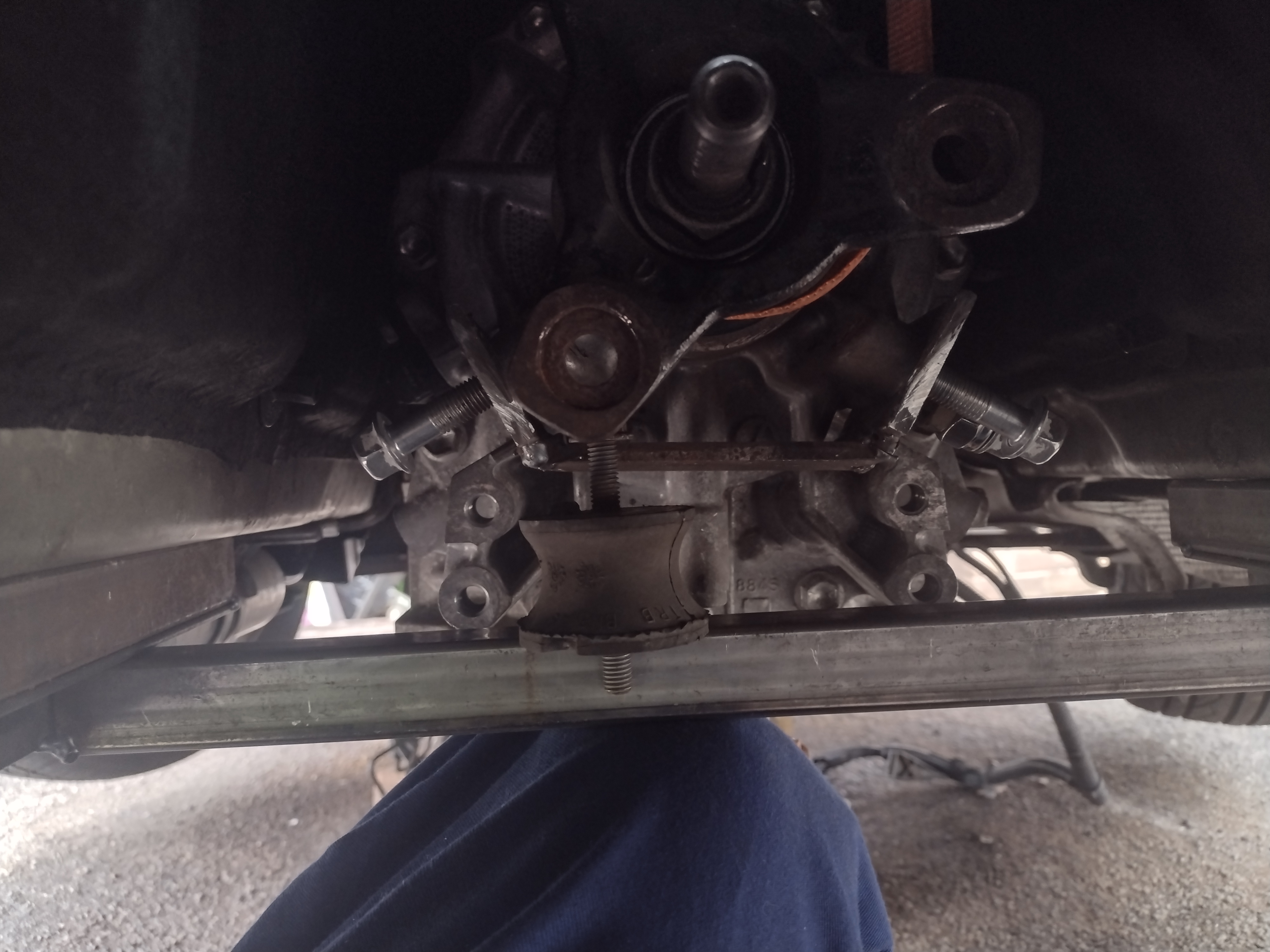

Re: [WIP] BMW E91 320d 2006
Got the gearbox sort of positioned on bricks. Need to tweak the angles and spacing a little then start on making up some mountings.
Still working on the rear mount, taking ages.
Once it's roughly mounted I can send the propshaft in for surgery, hard to tell if the angles and height is ok will a propshaft that's too long and wrong flange.
Transmission isn't quite level on the jack, also need to adjust the height a little before getting the brackets for the rubber thingies made up and then adding triangles everywhere possible. Once it's roughly mounted I can send the propshaft in for surgery, hard to tell if the angles and height is ok will a propshaft that's too long and wrong flange.
I made up a tube with the right ID to go over the gearbox output shaft and the right length to ensure the correct gearbox position and that it aligned with the spline of the rear half of the propshaft, rubber couplings and UJ's can only compensate for limited alignment errorsBigpie wrote: ↑Thu Nov 16, 2023 1:31 pm Still working on the rear mount, taking ages.
