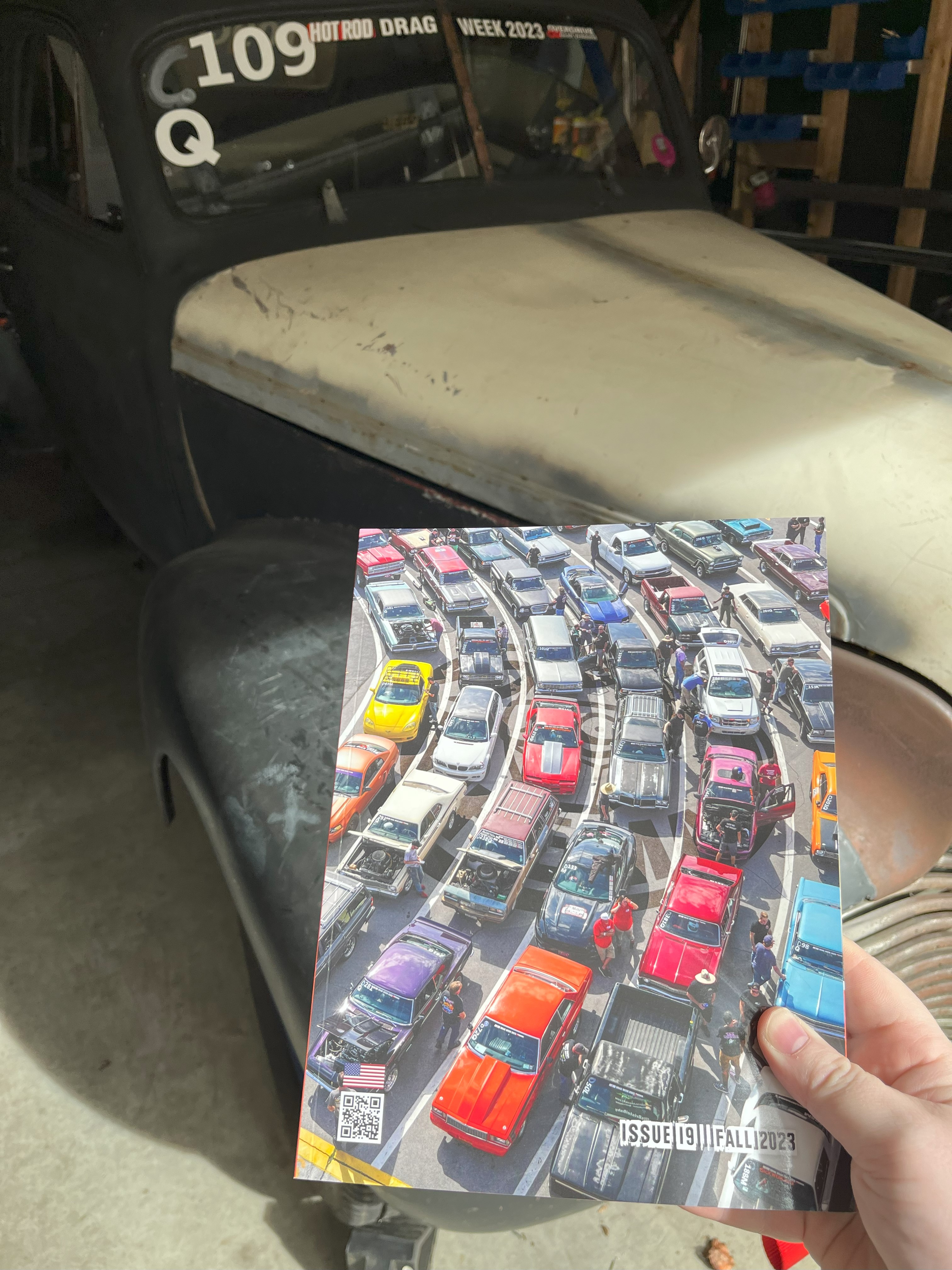

Ok so I realized I didn't update this thread, but I did make it to Drag Week, and survived the week, albeit with many many challenges. For more info, see here: viewtopic.php?t=4166 I think I've finally gotten caught up on sleep.
I've been taking it slow on the repairs. At some point, after spending all summer thrashing on the car, I needed a bit of a break. I've also been trying to fix things the right way this time.
Here's the list of everything that I need to do before I take on another Drag and Drive event:
I'm starting with getting the car back on the road, but even that has led to lots of decisions. Shortly before going on a day of Power Tour (which helped discover the need for new batteries before DW), I had picked up a Sport LDU that I was told had a bad gear set. After opening up the inverter, it has some bubbling in the Musk-goo, but the electrical measurements check out, meaning that it could be fine apart form the gears. When the motor mounts broke, one ear on the original base LDU broke (on the motor end), so now I have a conundrum. Do I repair and reinstall the base LDU for now, finish fixing the base tune, and later repair and install the Sport LDU, or do I wait until I can afford the parts to fix the Sport LDU gearing and add LSD, test it, and then install that, hoping that it solves the tune issue as well? Or do I take both units apart and Frankenstein together some functional combination?
For now, I'm working on rebuilding the motor mounts. Of course, two mounts broke but the third was always a bit sketchy and I think it contributed to my rear camber issue, as it was pulling on parts of the suspension. So I started by removing and refabricating the one intact motor mount (front). Last weekend, I also refabricated the rear motor mount, and I'm hoping next weekend I can sort out the third (motor end).
I'm also considering what to do about the charging. Here's my current line of thinking: The PCS has given me and others a lot of trouble. I've yet to find a public Level2 charger with more than 7kW available, meaning even if I get the PCS working properly I'm not really using its full 11kW capability. I need to add CCS (gut feeling is that DW will be in the midwest next year, where a lot of the fast charging infrastructure is GM and Ford dealerships with only CCS) which right now means adding a Zombieverter. Zombie can control the Leaf Gen2 charger/DC-DC, which tops out at 6.6kW, and as noted above, that's plenty with the stations I've seen. Therefore, it seems to make sense to replace the PCS with the Leaf components, and use the Zombieverter with i3 LIM to add CCS and control the Leaf stuff.
Regardless, my budget needs some time to cool off, so most of those changes will likely begin late this winter or early spring. I'd really like to have the car on the road and ready for the entire race season next year, so I've got to plan and prioritize. Right now, that's starting with fabricating new motor mounts.

The '40 made it in a magazine!
Sick the Mag is a magazine created to cover drag and drive events like Hot Rod Magazine's Drag Week, Rocky Mountain Race Week, etc. The magazine now hosts its own series of events including Sick Week, Sick Summer, Death Week and the Sick Shootouts.
The '40 got a two page spread, with some nice photographs and a great write up about the amazing and brutal experience I had at Drag Week 2023. (for anyone wondering about the "sick" magazine name, the magazine was founded and is published by Tom Bailey, who became known for "Project Sick Seconds" his '69 Camaro built with the aim of running six seconds on Drag Week. Sick Seconds 2.0 became the first car to make a pass in the 5's on Drag Week and complete the week a few years ago.)
