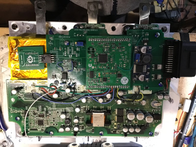

I have not encountered these problems. I just use the v3 O.I. board in the ima inverter, the current sensors and the driver power board are regular, the ima processor did not solder off and did not close any legs to the mass. from the ima, I take two wires with current sensor signals relative to the total minus of the 12 volt power supply. +5 volts current sensors are received from the standard board. also, relative to the general minus, I supply 6 pwm wires to control the transistors.
and everything.. it works by itself.
Previously, I tried to use my own isolated 6 pcs dc/dc (12/15) to power the drivers, and I took +5 volts for current sensors from the OI board, then I also got a shutdown of the inverter at a voltage above 78 volts.

8 kHz, 160 deadtime.
do you remember that in all circuits for the ima inverter, the upper lower control points are confused in places?
I showed it somewhere. the TOP of the dome is closer to the transformer. the input BOT is closer to the current sensors. and in the existing pdf files with diagrams, the opposite is indicated.
Hah! That figures!
I used Lebowski in sensorless and i guess it is way more sensitive. thenk you for that info.
I will test this with HSG and 360Vdc sometime when i assemble Lebowski board again.
