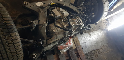

Hello.i m some kinda new to this but whit medium skills of electric cars so please accept me as i am.

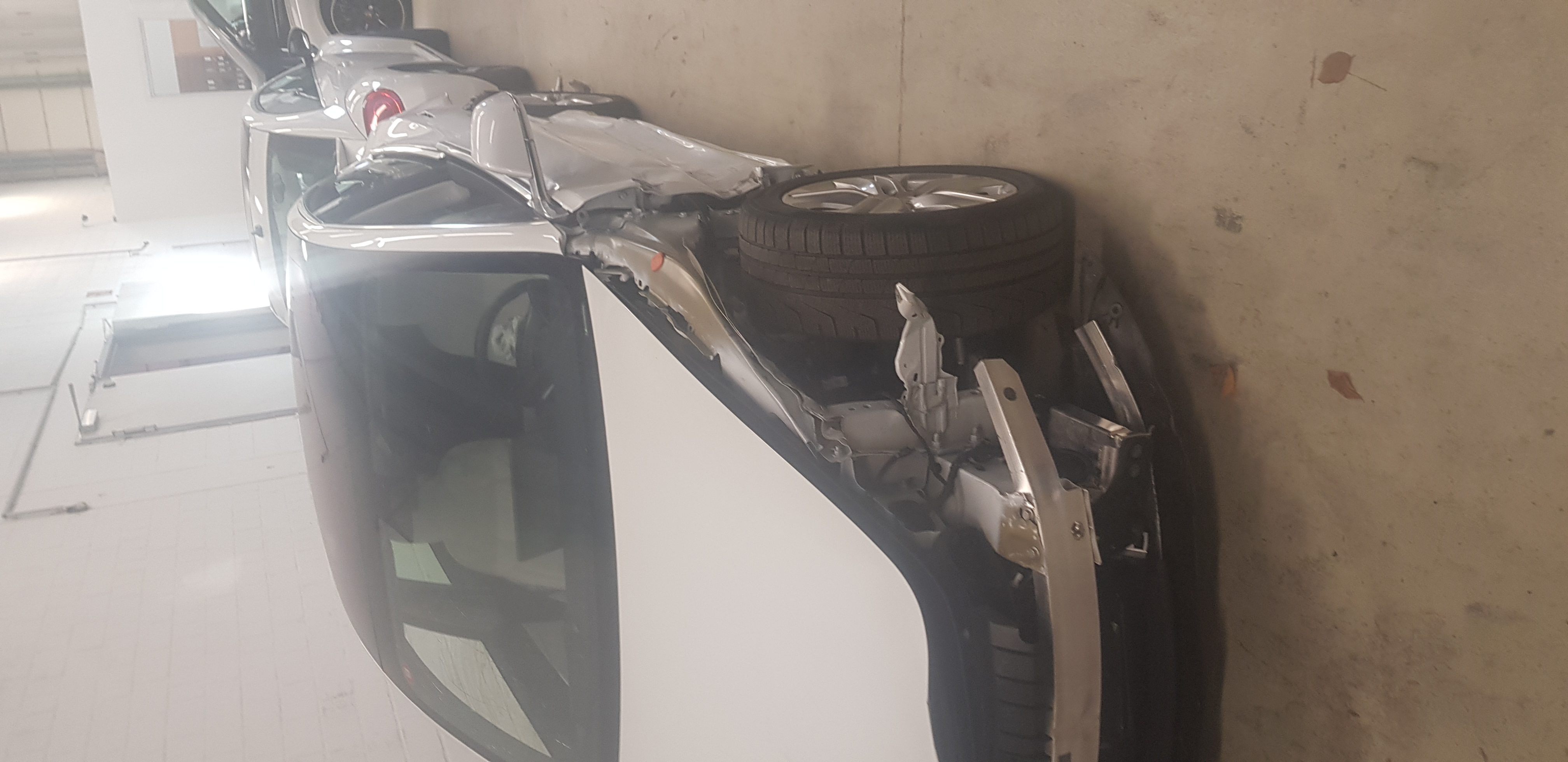

I recently bought a complete tesla car that it was involved in accident model 3 2019 awd that i wanted to swap into another car so..i studied the forum for diferent options to swap this thing.
I need advices that what i need to buy to make my dreams come true.
What should i buy for both motors ,batery pack ,recharging to a complet swap.dont wanna transfer all tesla to another car:))..
Whit links should be ok.
I will buy all i need to make this car.thks for understanding me

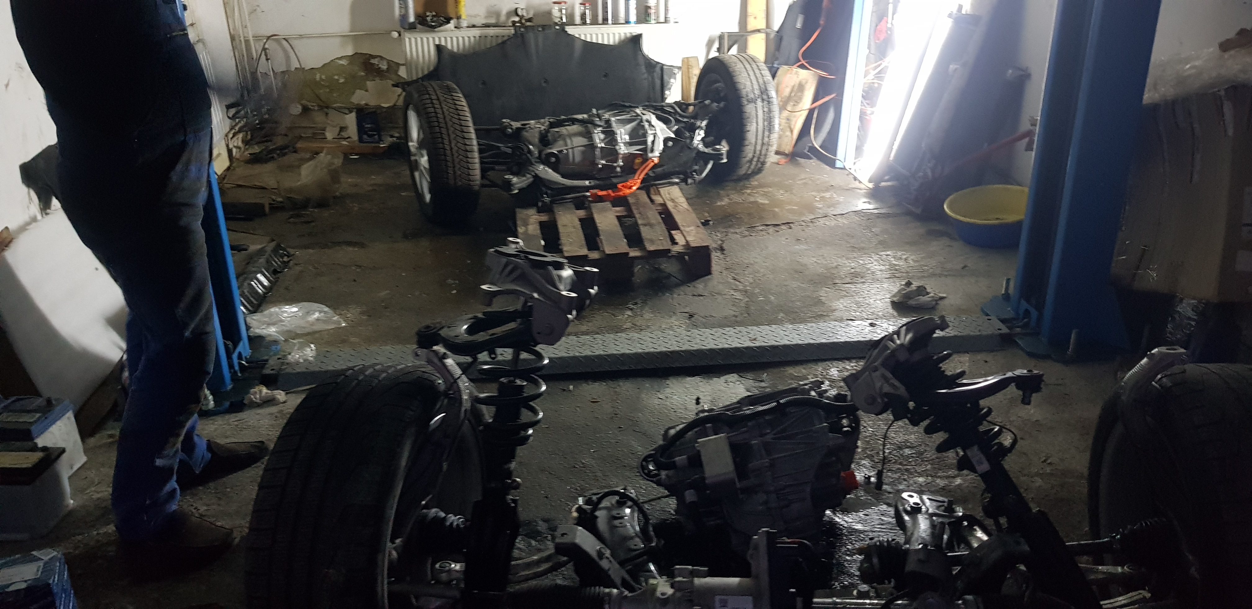

I saw what i have to move...all.that why i need yo know if the pcb for inverter will work.want to put both motors.in sunday i will take down both motors and batery..i will put pictures

The motors are down and i will prepare for shipping to you
