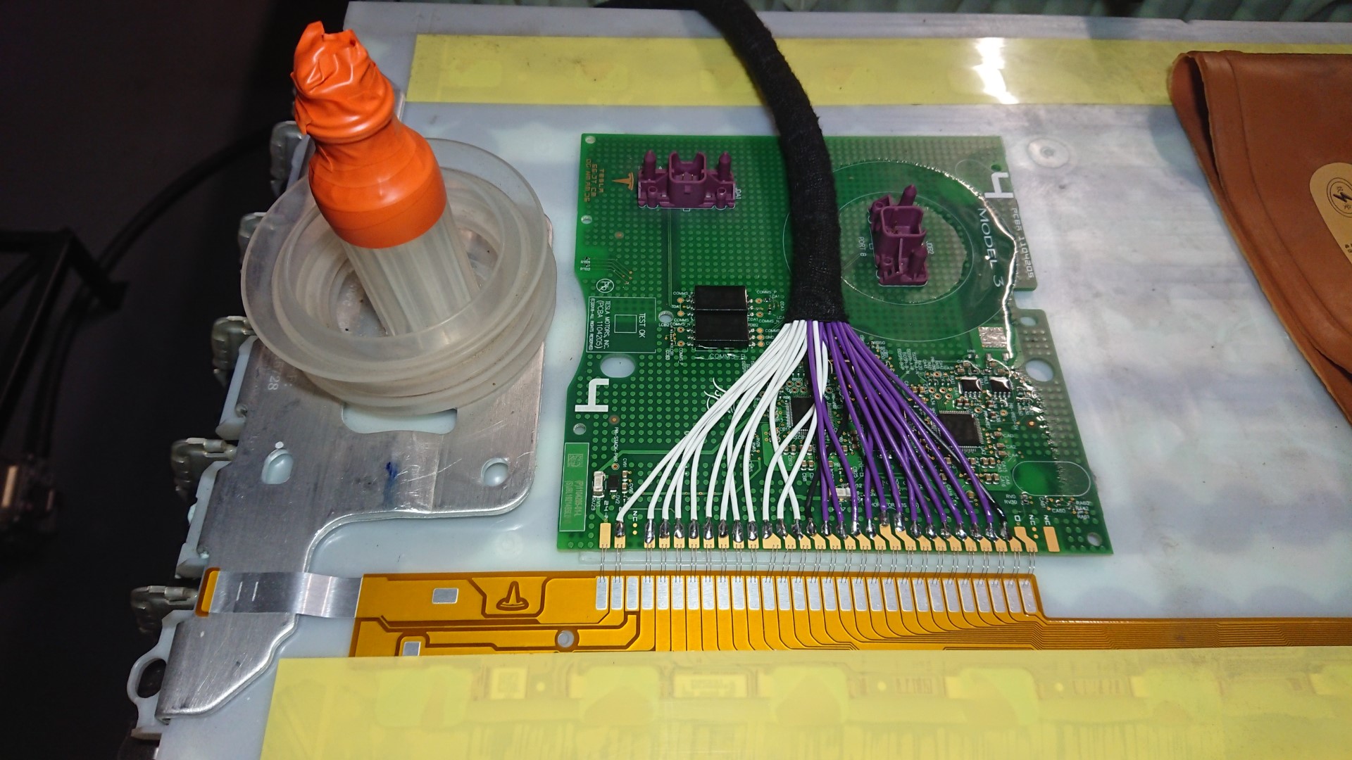

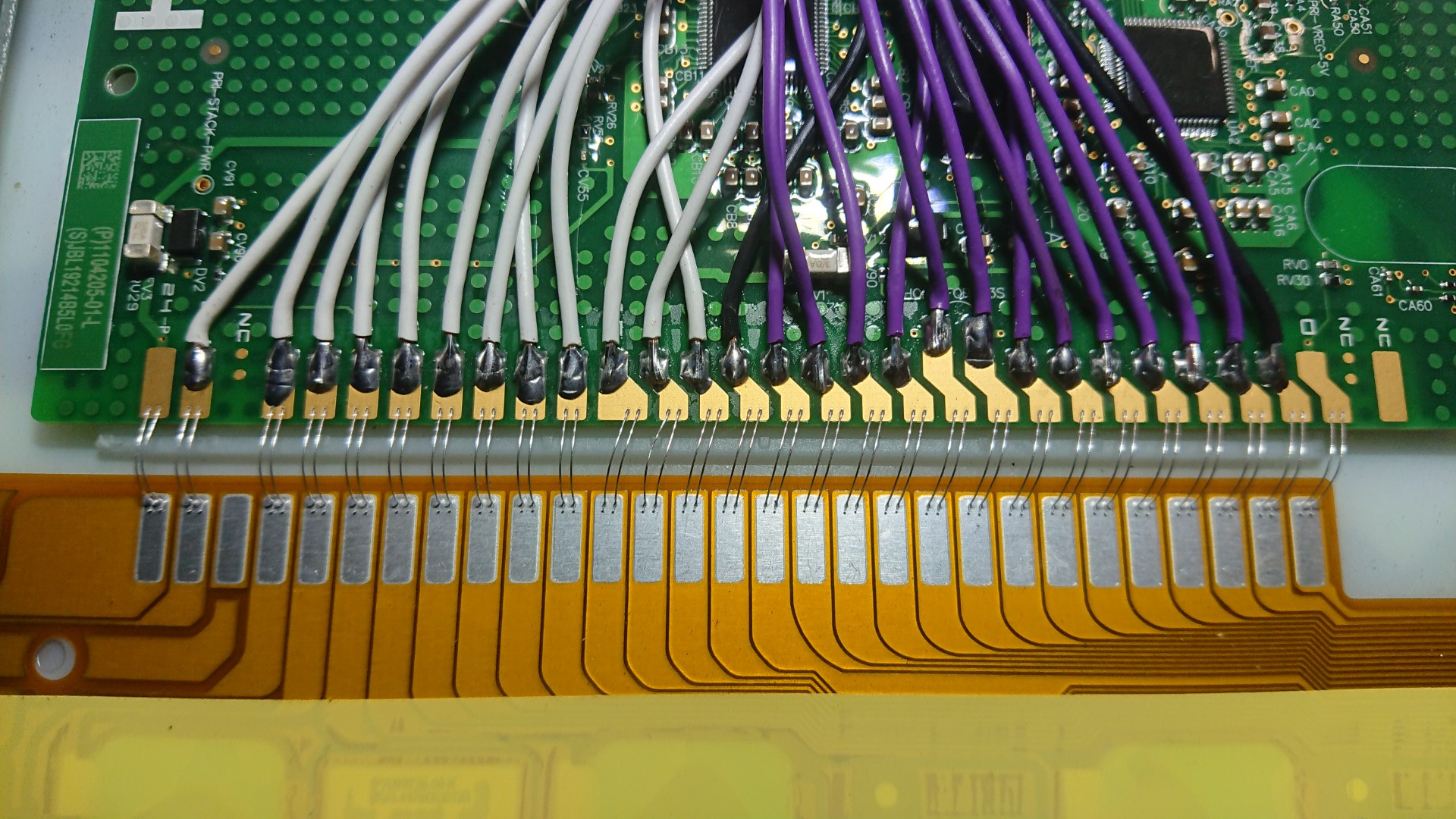

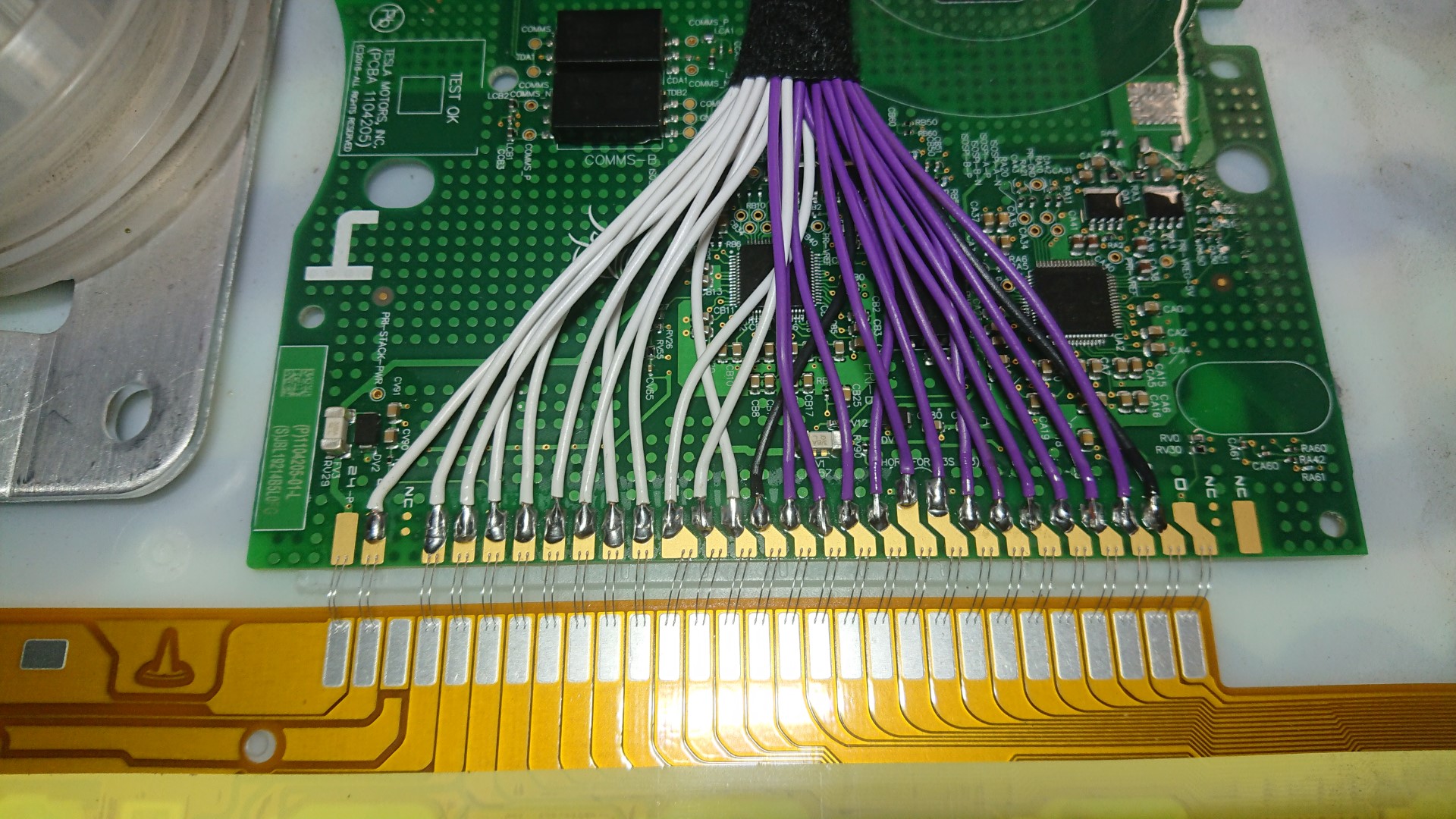

Coupe of photos of the BMB

After soldering the tap wires, the individual cell voltages were checked (before and after) and showed no sign of shorts or issue, so looked like all was good. Don't think the Tesla BMB board on the module does anything in this isolated state so I'll need to go back and recheck the 24-way plug and unwrap the wires to see if anything shows up there now that some time has passed.

nkiernan wrote: Fri Nov 10, 2023 10:22 am Its an interesting one to me becuase the modele has been isolated and not connected to the other modules or anything that draws power for a year or so. The only work on it was adding the BMS tap wires as shown in the photos above. So those wires go to a 24-way plug ready to connect to the BMS but it has never been plugged in and the Orion BMS was never connected.
Do you have a way to disconnect the ribbon cable from the battery and check resistance across the 2 wires to that cell group? I'd guess you see a very small amount of resistance between those wires like 10k that you don't see between other cell group pairs.
Definitely worth checking. Check for flux residue between cell groups too.
For 24 cells in series, I would have thought at least the cells either side of this low voltage cell would start dropping also, but it doesn't appear to be. Would that be normal?
Resistance between that cell's connections would only draw power at that cell group. Think of it as if you had a tiny light bulb between that cells connections. The bulb (the short) will pull power from that cell group only. It's not connected to other cells unless you skipped a couple series wires for the bulb / resistance connections.
These are the expected results if there's resistance between the problem cells connection. It won't spill over to the cell groups on either side.

i can think of 2 mechanical possibilities:
- residue flux from solder cell taps/ left over solder blobs

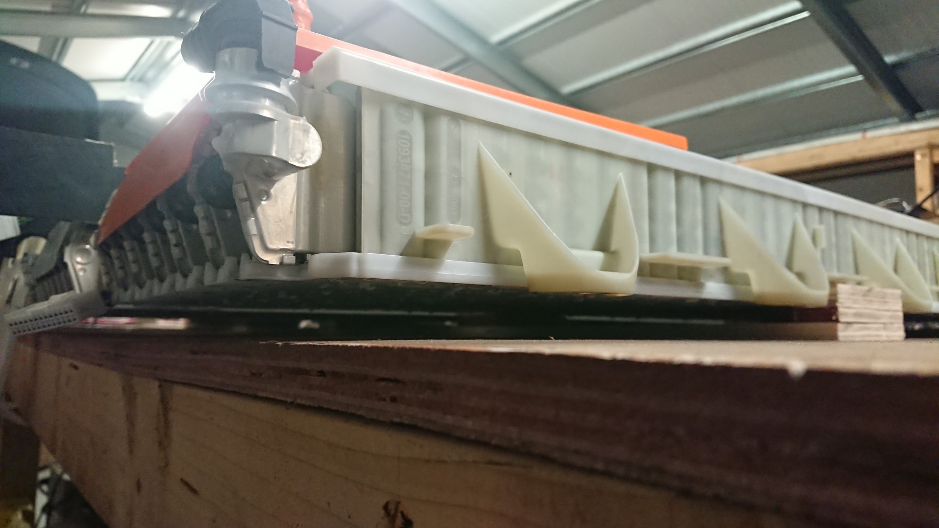

- broken/ interfered cell fuses on the bottom of the battery module. (as you know) these m3 modules are very exposed on the bottom and moving them around is challenging without damaging any of the cell connections
how shaft have you been with keeping the bottom clean?
My first TM3 pack was delivered in the back of a van with no protection on the underside, and found cells with 0V readings because of those damaged cell fuses. Was lucky that they changed the pack for me and we both learned from that.
So I have them raised on a plywood frame that keeps the underside safe, and they've been like this for a long time. So flux residue or solder blobs or something around the pads sounds most likely at this stage. Will get the magnifying glass at it tomorrow, cheers
