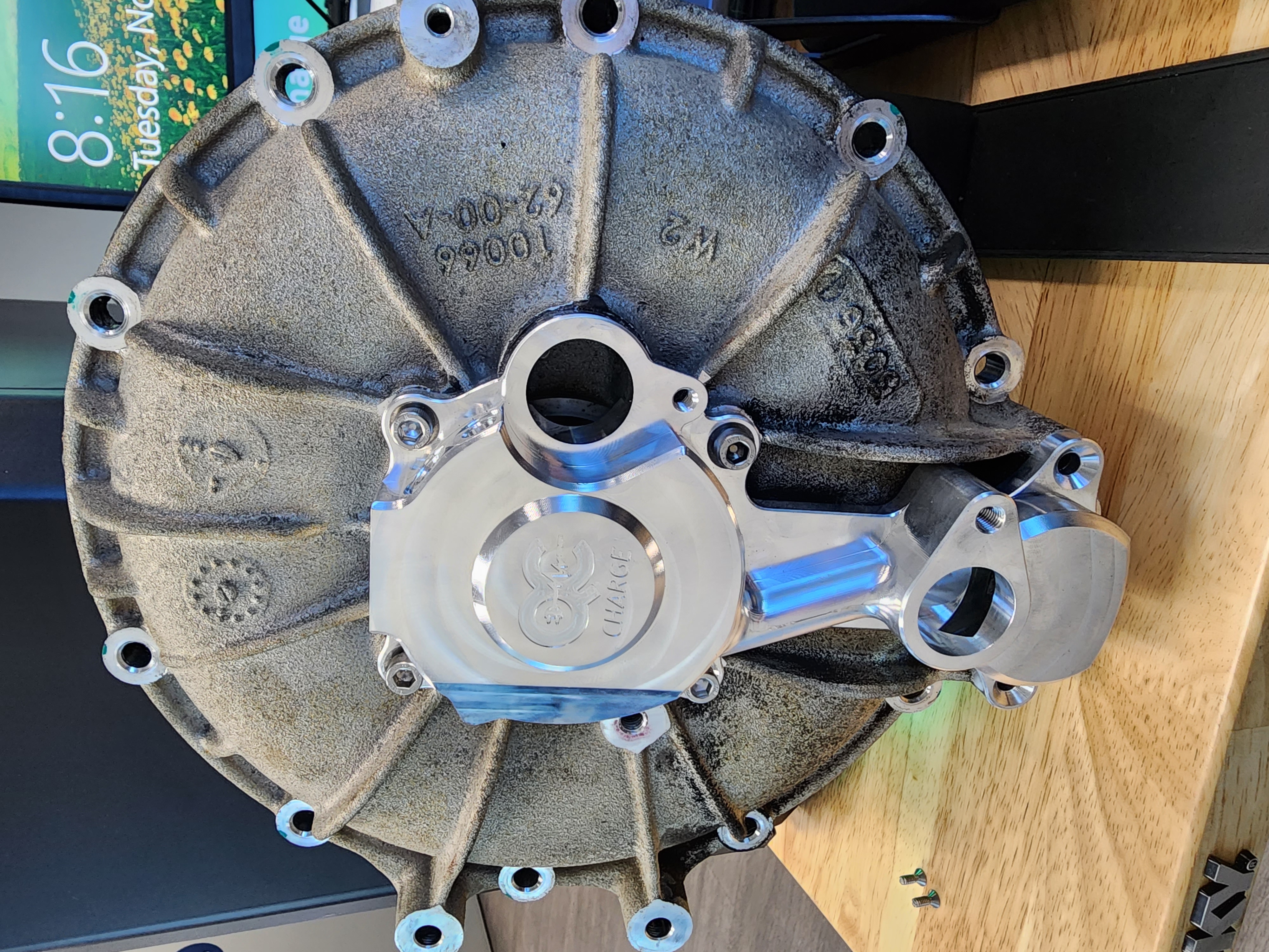

Hello everyone, I joined so I could add the pictures of the new 1002633-00-U Base-Drive-Unit here for everyone. These were taken in an Orange County Tesla Service Center.
One more consideration for gap calculation is the 2x bevel washer on the outer bearing of the rotor. This will allow rotor shaft extend outwards some distance (I think @Johan guessed 0.5mm.) Don't know if the o-ring in the bearing bore will reduce the travel. Its not much resistance but the o-ring is not lubricated.muehlpower wrote: ↑Wed Nov 08, 2023 1:11 pm Moodifying an existing manifold should be easy. The tube is difficult to press out, but shortening it up to the retaining ring should work. Then you only need a cover in place of the sealing ring that leaves enough space for the shaft and has a gap to the shortened tube. If the gap becomes too small, a hole can be drilled into the duct below the pipe. I could imagine that omitting the rotor cooling works for lightly loaded engines, but I don't want it for my sport unit! Plug.png
This seems to be a brand new LDU made in 2023. T23*** printed on the motor end plate shows it was first manufactured in 2023. And no R + number at the end means its wasn't a reman (R1 = 1st reman, R2 = 2nd reman etc). Can you confirm?
Quite interesting if Tesla is still making LDUs in 2023.

Hi! Great photos. Could you possibly be able to take the coolant connection from the motor? We would sure like to see how it looks inside. If the coolant really has been blocked from the rotor or not.

We're building our own version of a "rotor coolant delete manifold". This one can be used either as a straight up coolant delete (like the Rev U drive unit), or oil cooling can be added on for the folks that want it. We expect to have production ready units in stock starting in January.

Other than development parts, the only coolant delete manifolds in the wild are ones that Tesla has installed via reman units, so it's unlikely that we would have any information available to us (unless Alex/Tony/QCC elect to release such development information on their own manifold and testing, and I wouldn't hold my breath on that).

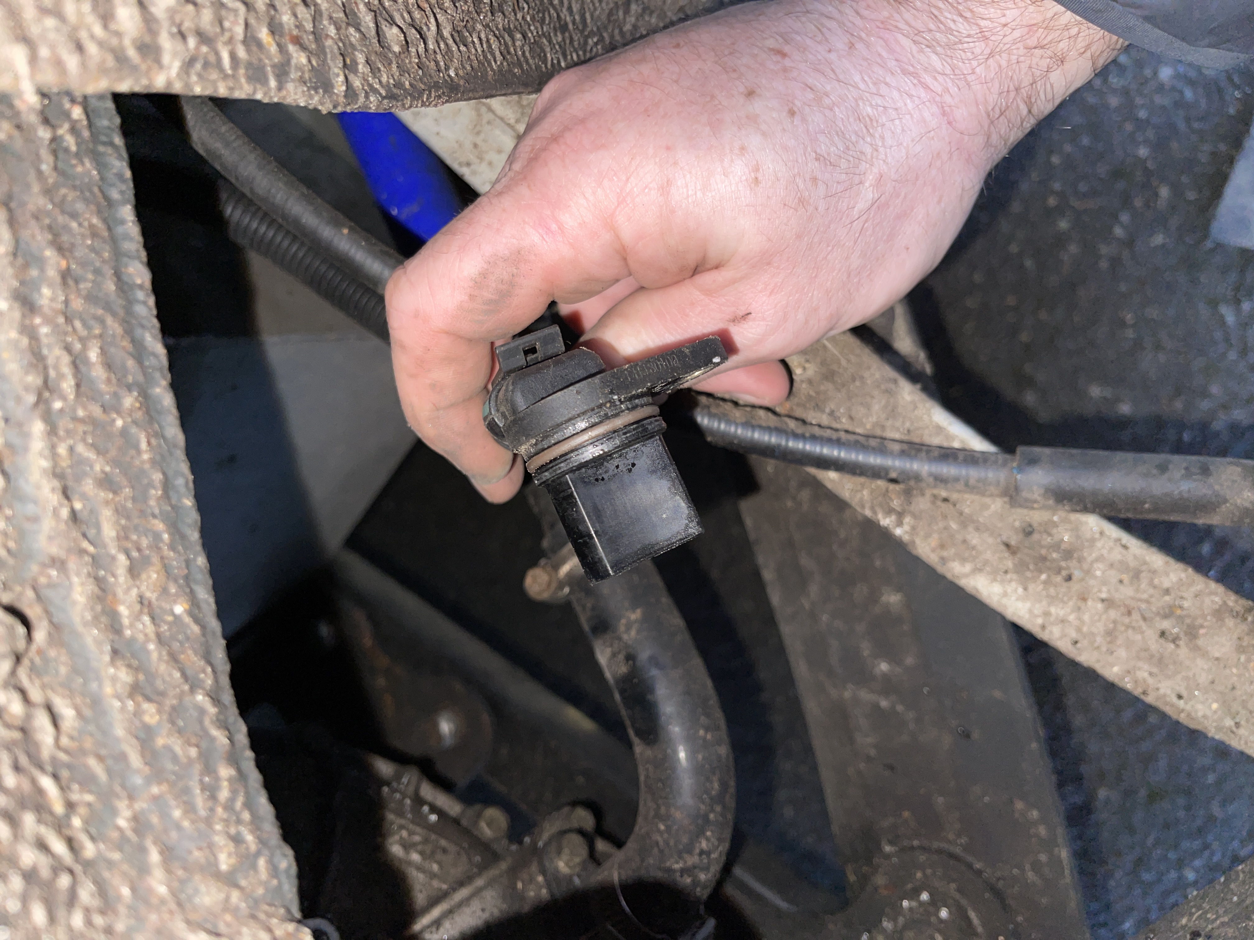

A small update regarding my SKF seal and speedi sleeve.
I pulled the encoder whilst fault finding this issue. The wheel was still dry. A little residue on the encoder but that might have been from the silicon used to seat the seal.
Edit: forgot to mention that I think that's 17k miles on this set-up but I haven't done many miles over the past few months.
