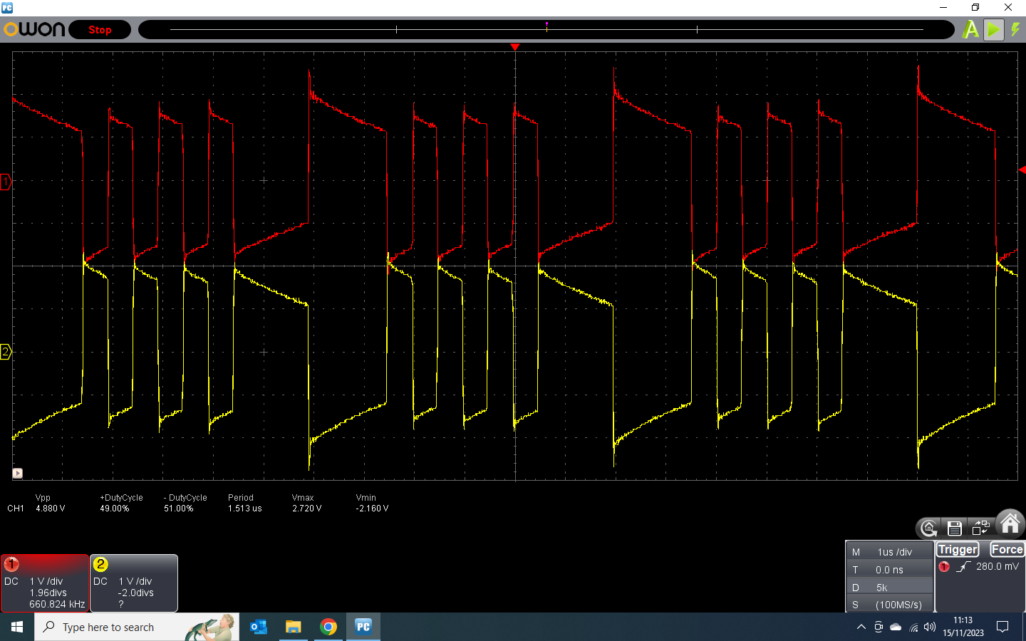

AndrewM314
Posts: 2
Joined: Wed Nov 15, 2023 11:17 am
Re: Kia Niro BMS
Post by AndrewM314 »
I have been following this subject with interest for a while now as I am using Kia Niro/Hyundai Ioniq PHEV batteries for a solar energy storeage system(personal use), I have just built the BMS master following the drawings kindly shared by bexander(very much apreciated thanks).
unfortunately I don't appear to be receiving a reply back from the battery slaves.
firstly, do these Mobis slaves need powering by an external supply.
secondly, could someone please tell me if my transmission signal is ok or not.
i have attached screenshots of the transmission signal before and after the isolation transformer(CH1 is TXpositive, CH2 is TXnegative)
bexander
Posts: 897
Location: Gothenburg, Sweden
Has thanked: 78 times
Been thanked: 102 times
Re: Kia Niro BMS
Post by bexander »
No external power neede other than the battery cells.
Are you using the OEM wires and all modules connected? How does your RX lines look in the scope?
AndrewM314
Posts: 2
Re: Kia Niro BMS
bexander wrote: Thu Nov 16, 2023 12:13 pm No external power neede other than the battery cells.
Thanks for the reply, I found the main problem, I had the transmit from the master to transmit on the slave "Doh", I've corrected it and am now getting a signal on the RX lines.

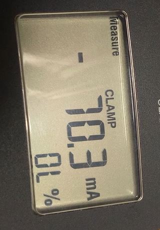

Dear Bexander
I have some problems with balancing (with your original code).
After Balancing ON cell current coming from cell to BMS (+70mA / 20second / good condition) but after this current coming from BMS to cell (-70mA 20second). These both directions are in the loop.
Could you please check if you have same condition in your BMS.
In my opinion only current coming from cell to BMS is OK for ballance.
Thank you
Marek

maarek2 wrote: Tue Feb 20, 2024 9:20 am After Balancing ON cell current coming from cell to BMS (+70mA / 20second / good condition) but after this current coming from BMS to cell (-70mA 20second). These both directions are in the loop.
This is normal and expected behavior.
The slave chip (MAX17823) can not handle balancing adjecent cells simultaneously so in the code I do all odd cells first for a period and then switches to all even cells for a period.
Example using only cell 1 and 2.
During first period all odd cells (cell 1) is discharged and the current is flowing according to green line and arrows. During second period all even cells (cell 2) is discharged and the current is flowing according to blue line and arrows. This results in the behavoir you are observing, that the measured current changes direction (sign) periodically when two adjecent cells are balanced.
Balance current during different periods
maarek2
Posts: 10
Joined: Wed Sep 06, 2023 7:06 am
Re: Kia Niro BMS
Post by maarek2 »
Dear Bexander
Thank you very much for explanation. I found this part odd/even in * Balancing of cells * part.
Time depends on balanceCellCounterTurnAround.
Thank you again.

Post by StephanL »
Hi!
I was a "silent follower" since month, because we are converting a VW T2 to electric. Its nearly done - next week we want to go to the TÜV in Göttingen :)
One problem still has to be solved: The additional battery is using CATL Modules with the MAX BMS. I used the original CATL BMS Master and soldered some wires to it and it worked unstable, but it worked with my arduino and the kindly supplied code from the forum. After some time i couldnt get it to work anymore. Now i bought a new MAX 17841B Chip, just to be sure that it is not the problem. I also used a new Arduino.
On the original CATL-Master im still using the isolation Transformer. Its connectes via 0,5 mm2 wires.
I will attach some oszi prictures. Can somebody have a look at it?
My guess is, that the signal is too bad. It reaches the first BMS board and after that its not going to the next board. At the moment just two boards.
Thank you very much already for your help!

Post by bexander »
What is the bandwidth of your oscilloscope? The base frequency of the signal is 2MHz and a low oscilloscope bandwidth will explain the rounded corners of the signals.
Measuring on the secondary side to ground means you are at the same time shorting out the isolation that the transformer is to provide. This way you might pick up a lot of interference. The signals are differential signal so should be better to measure them differentaly, especially on the secondary side. Measure SEC2_3 referenced to SEC2_1 and SEC1_3 referenced to SEC1_1.
MAX17841 schematic
MAX17841 schematic
However I would not suspect the signal as the first source of error.
What is the response from the code when trying to run it on the Arduino? Where does it fail?
