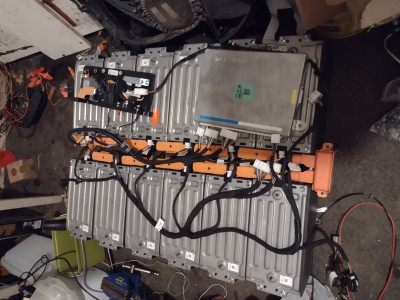

My battery pack has arrived. Need to get some can logs and label up the wiring before working out how to cram it all under the bonnet
36kWh 33 usable from a Renault KangooBMW E91 2006

Re: [WIP] BMW E91 320d 2006
Nice layout. Got some weights and dimensions for us?
- Posts: 1757
- Has thanked: 80 times
- Been thanked: 410 times
Modules are roughly 14x21x31 cm 16kg each.

added: https://openinverter.org/wiki/Batteries#OEM_modules
Assuming 8s
Assuming 8s
Not checked, but assuming it is 8s modules
Can't workout how to create a wiki page, so dumping here for now.
The pack has 2 low voltage connectors, a black and a grey. [insert mating part numbers]
It only has one contactor, rated at 150a and a pre charge relay. No negative contactor.
There's a service disconnect (I'm missing the plug if anyone has one available)
There's a 275a mid pack fuse and also a 275a fuse in the contactor box. In there it looks file a field effect current sensor also.
The grey connector has 4 connections (even though its a 12 way connector)
Yellow becomes Black/Red this connects to the BMS
Blue becomes Black/Green this connects to the BMS
White becomes Green/Red this connects to the contactor box (connects to both precharge and contactor coils)
Black becomes Brown and connects to the BMS
The Black connector also a 12 way, but only 4 pins
Red becomes Black this connects to the BMS
Black becomes Red this connects to the BMS
Green becomes Red/Blue this connects to contactor coil
Blue becomes Green/White this connects to precharge coil

https://openinverter.org/wiki/Renault_Kangoo_36 I've started documenting the pack as I go.
