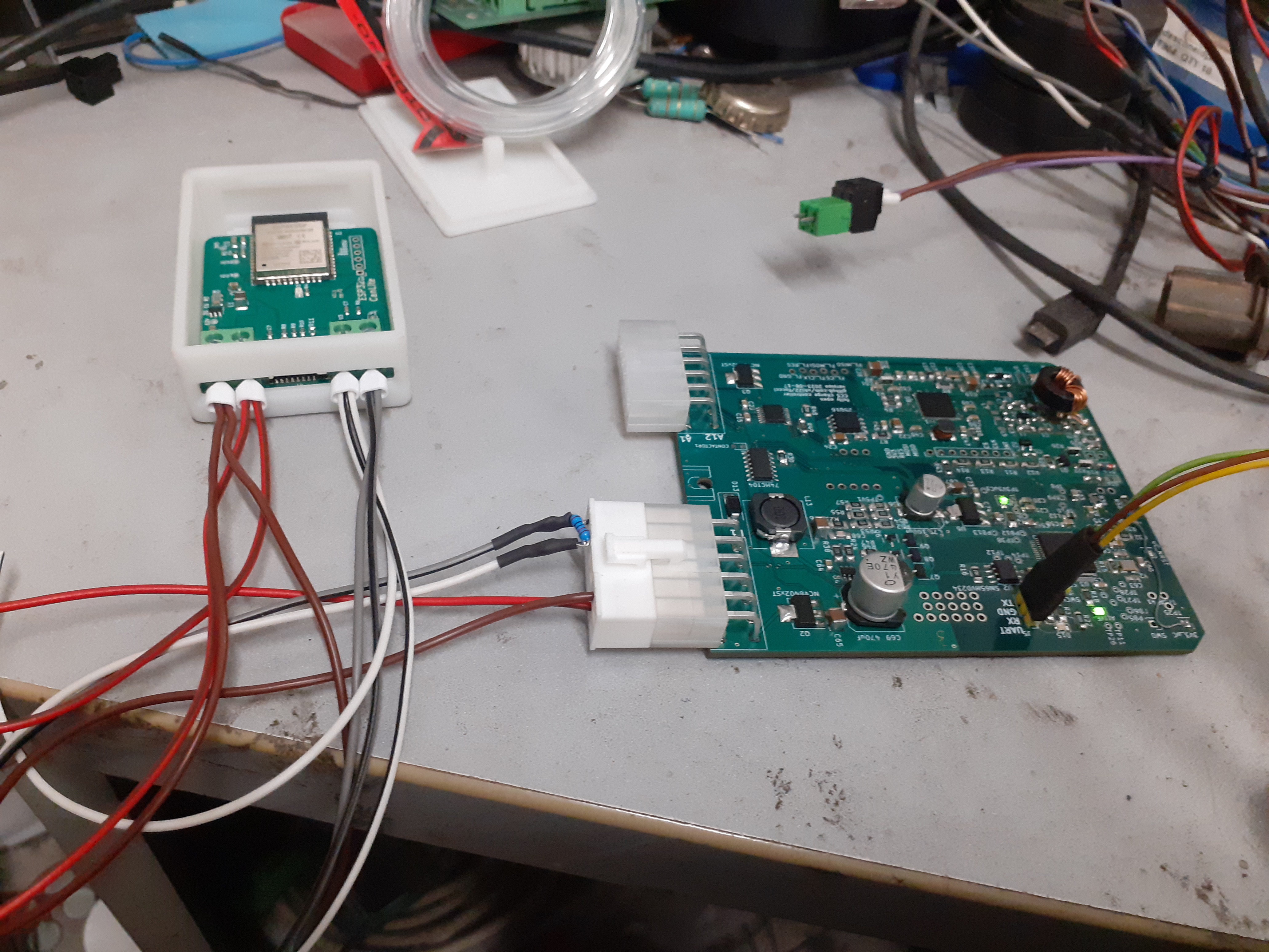

Quick return to hardware. I have populated the second board now but no joy.
Processor runs fine but I see no comms between QCA and STM. STM sends 4 bytes, I think 0xC3 0 0 0 and reply is all zeros. Also on bootup I don't see any activity between SPI flash and QCA.
3V3 and 1V2 measure ok, so at least the voltage reg in the QCA is running.
Powerline RX/TX have the correct resistance between them but don't sit at 1V6
I've reflowed the chip a couple of times and the joints look fine.
Any idea what to check?
SOLVED! L2 was missing, conducting 3V3_D to 3V3_A

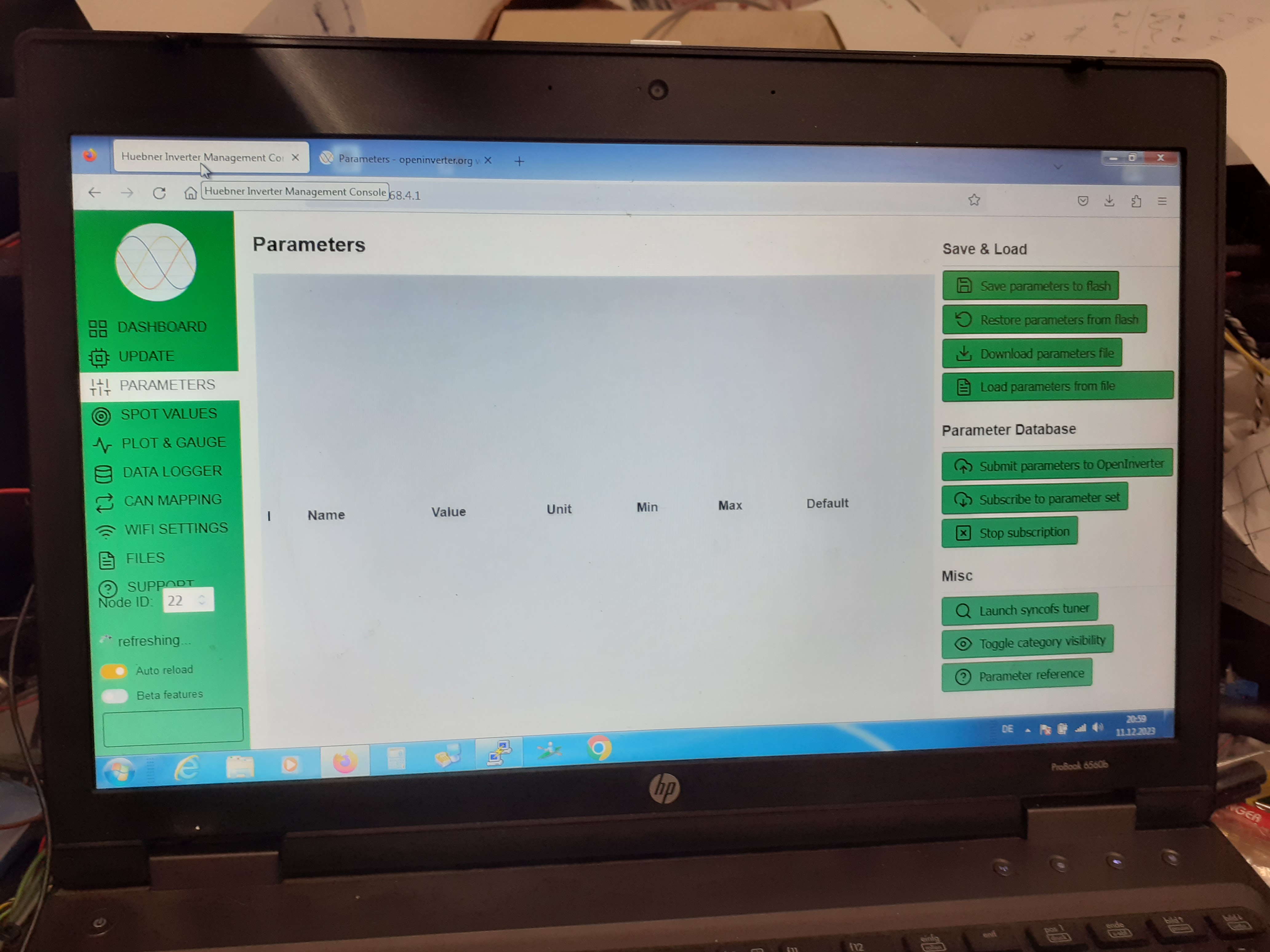

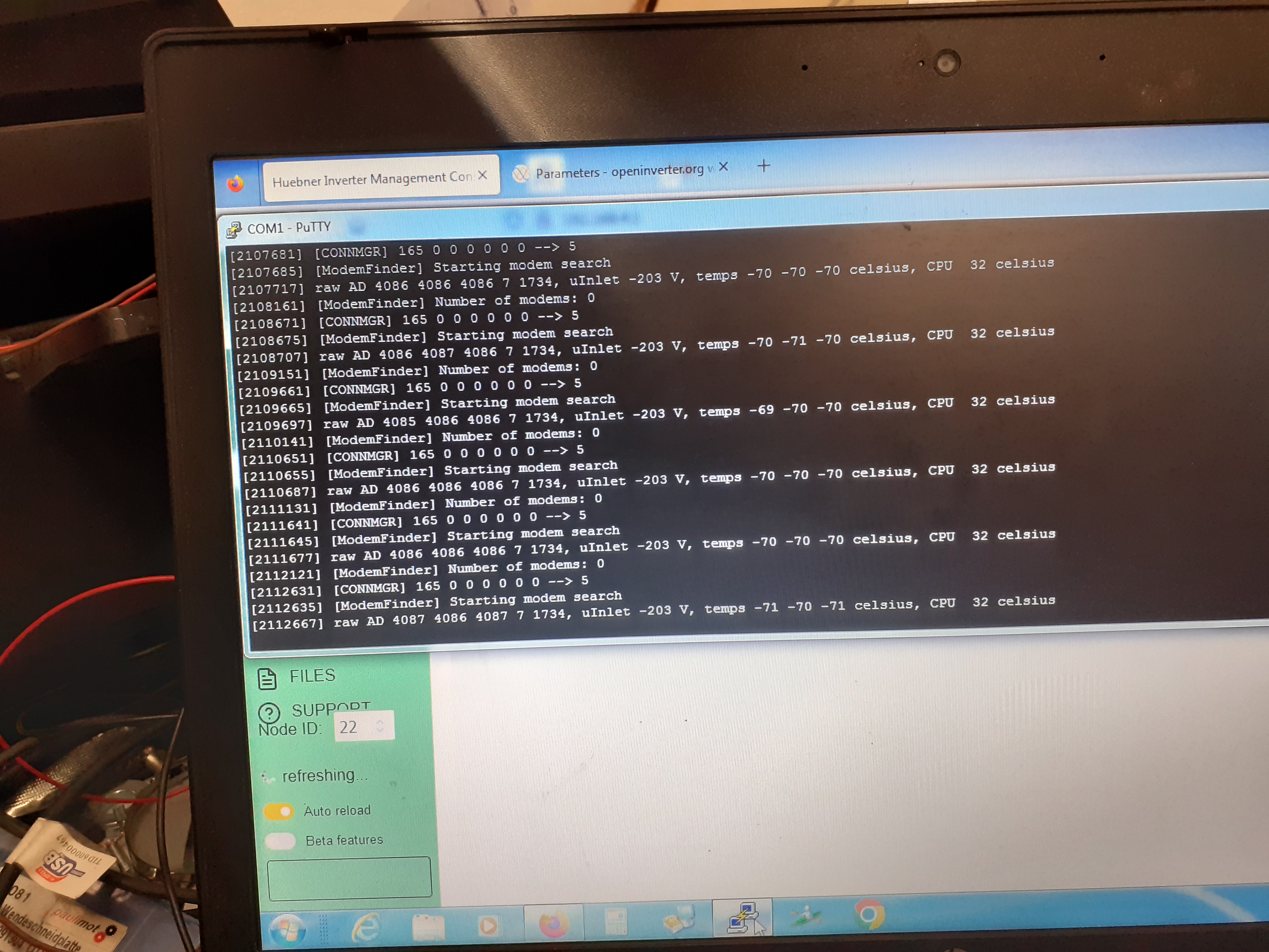

Some progress with the web interface. The setup was not easy, I collected my notes here: https://github.com/jsphuebner/esp32-web ... ace/pull/3 Finally it works, I can flash software updates to foccci in the browser, see spot values, can record a graph and change parameters and CAN mapping. All very well prepared, thanks to the openinverter library and tools. Nice :-)
Finding3: The temperature values show zero and do not react on changed voltages on the pins.
Finding4: The make does not see if the param_prj.h is changed. Just calling make (or in my case mingw32-make) should see the changed file compile all dependent files. Unfortunately I'm not the make-file expert, but my impression is, that the .h files somehow should mentioned in the dependencies in the makefile.

I added a logging parameter that lets you select which modules messages you want to see. Also multi selection is possible by adding the flags.
Not all messages are tagged yet, so even with everything turned off you get some messages. I added dumping raw TCP (RX) traffic as one option.
EDIT: I see you worked on the state machine. Will retry Tesla soon.
EDIT2: Finding4 fixed
EDIT3: Finding 3 because temperatures_calculateTemperatures wasn't called. But when called we lack the log() function. There is an ln() function in my_fp.c
EDIT4: it links with "-lm" added to the END of the linker command line. Lets see if it also runs

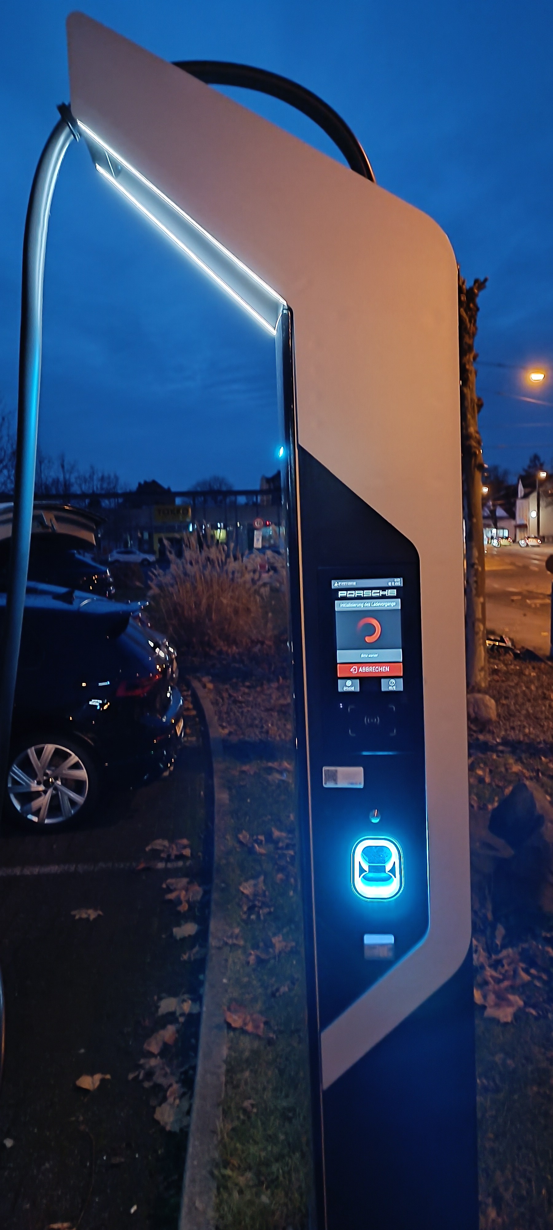

Went for another charger round
1. Ionity (Tritium) - delivers current for a few seconds then stops. Same behaviour as Audi with pyPLC. Log attached
2. Tesla SC - now stops when stopping in the app (more below)
3. ABB 50 kW at VW dealer - works
4. ABB 175 kW at VW dealer - works
5. Posh looking charger at Porsche - does not work at all. No SLAC, modem goes to sleep (picture attached). One of them had a note "Defekt" maybe the other one is also defekt
The shutdown happens a bit too quickly now for my taste. Like the moment I hit stop in the Tesla App the port relays open. Would like to see a little grace time and verification that current flow has stopped.
Addition: what I like about Ionity is they run in an endless loop. If charging fails they start over without interaction so you won't be zipping your cup of coffee while your car fails to charge.
Addition2: I'm also surprised about evsemaxcur and evsemaxvtg. Voltage always seems a bit low, like 437V on that last HPC wouldn't even cut it for the 108S packs. And also it only reports 200A max current. that way we certainly don't arrive at 175 kW. Interestingly Compleo reports 530V here which seems more plausible.
So overall increased success rate :)

Very good, was looking for something like this today.
I hope CCSKnowitAll can analyse that Ionity log. Will go there again maybe tonight to also record TX frames
EDIT: looked at the EXI-ed logfile myself and found DC_EVSEStatus.EVSEStatusCode sits at 1 and ReponseCode="OK" while we still get around 40A and then changes to 6 (EVSE_MalFunction) and "Failed". Current than drops over a couple of 10 messages and reaches 0.
Also the ChargeParameterDiscovery totally doesn't match what I expect. It should be 500A, 1000V and 350 kW but we get 100A, 398V and 98 kW. Is that some sort of fallback? Are we communicating an outdated protocol version or so?
