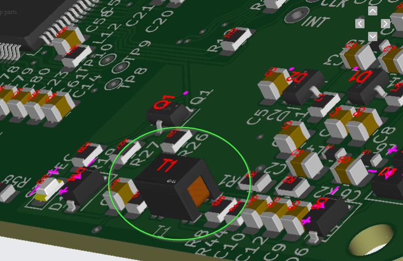

Progress with the board: fixed some of the todo items. The most relevant is the transformer:
catphish wrote: Sun Sep 24, 2023 11:31 am ... I would strongly recommend making some layout improvements here for the next revision of the board. In particular, the current paths for the input and output capacitors are much too long.
Which JLC part number has this inductor? I today changed from
https://jlcpcb.com/parts/componentSearc ... t=C3000379 (which is 12.3 x 12.3mm)
to
https://jlcpcb.com/parts/componentSearc ... t=C5127462 (11.5 x 10mm),
but this still looks bigger than the one in your screenshot, and we do not need the 8A rated current.

uhi22 wrote: Mon Dec 18, 2023 2:22 pm Which JLC part number has this inductor? I today changed from
to
The inductor I originally suggested was https://jlcpcb.com/partdetail/Sunlord-M ... MT/C408412
Sorry I didn't get a chance to do these PCB changes for you.

No worries :-) Thanks for the hints, now it's way better (but still some room for optimizations):
stepdown on foccci, optimized layout and L size

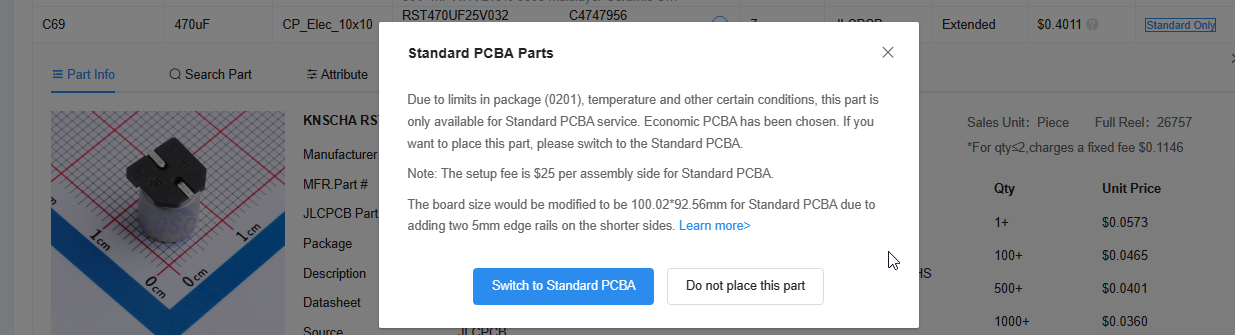

And each time something new at JLC:
1. The rotation of some components was again wrong, even if two months ago it was perfect, and I did not change anything with these parts. Maybe they had a data base update where they changed the default orientation. Lesson learnt: always check in the jlcs viewer the orientation of all parts.
2. More irritating: The economy service does not populate the big elco anymore. They did the last time, but this time, they give the choice to either not populated it or switch to the expensive service. Any idea how to workaround this?
jlc limits for economy service
royhen99
Posts: 265
Location: N. Wiltshire. UK
Has thanked: 22 times
Been thanked: 134 times
Re: Develop a QCA7000 board?
Post by royhen99 »
Footprint is for 10x10mm part number is 8x10mm, not sure why error mentions 0201. Works ok with C3445244.
C75 is also incorrect, footprint is 8x10mm part selected is 6.3x5.5mm.

uhi22 wrote: Mon Dec 18, 2023 3:11 pm 2. More irritating: The economy service does not populate the big elco anymore. They did the last time, but this time, they give the choice to either not populated it or switch to the expensive service. Any idea how to workaround this?
The best way would be to get rid of all elcaps. I've done so by using converters that only need like 10 uF input and output capacitance. Elcaps also have the nasty habit of falling off, at least when JLCPCB populated them. Alternatively do thruhole ones.
Have you added wakeup via PP and a powerful 12V output (say, 5A) for running components needed for fast charging?
EDIT: viewtopic.php?p=64221#p64221
EDIT2: issue created https://github.com/uhi22/foccci/issues/2

royhen99 wrote: Mon Dec 18, 2023 4:37 pm Footprint is for 10x10mm part number is 8x10mm, not sure why error mentions 0201. Works ok with C3445244.
Thanks a lot, this works. Pushed the update.
royhen99 wrote: Mon Dec 18, 2023 4:37 pm C75 is also incorrect, footprint is 8x10mm part selected is 6.3x5.5mm.
Yes, this is "a little bit on purpose" (but not really consenquently). I tend to use bigger footprints, to enable hand-soldering with just available parts. Even if the jlc parts are smaller. Yes, I see, it's a bad habbit, to stick to the old things, but I need some more steps until I'm convinced that the time for hand-soldering is over. And if it is, we could move to even smaller sizes for the many 0805 parts.
The short answer: don't use it. Use multiple smaller caps that they *will* populate. I don't use electrolytics at all in my designs (I just use 10u ceramics), but if ceramics won't work, then I would hope there are smaller electolytic caps that they can populate.
