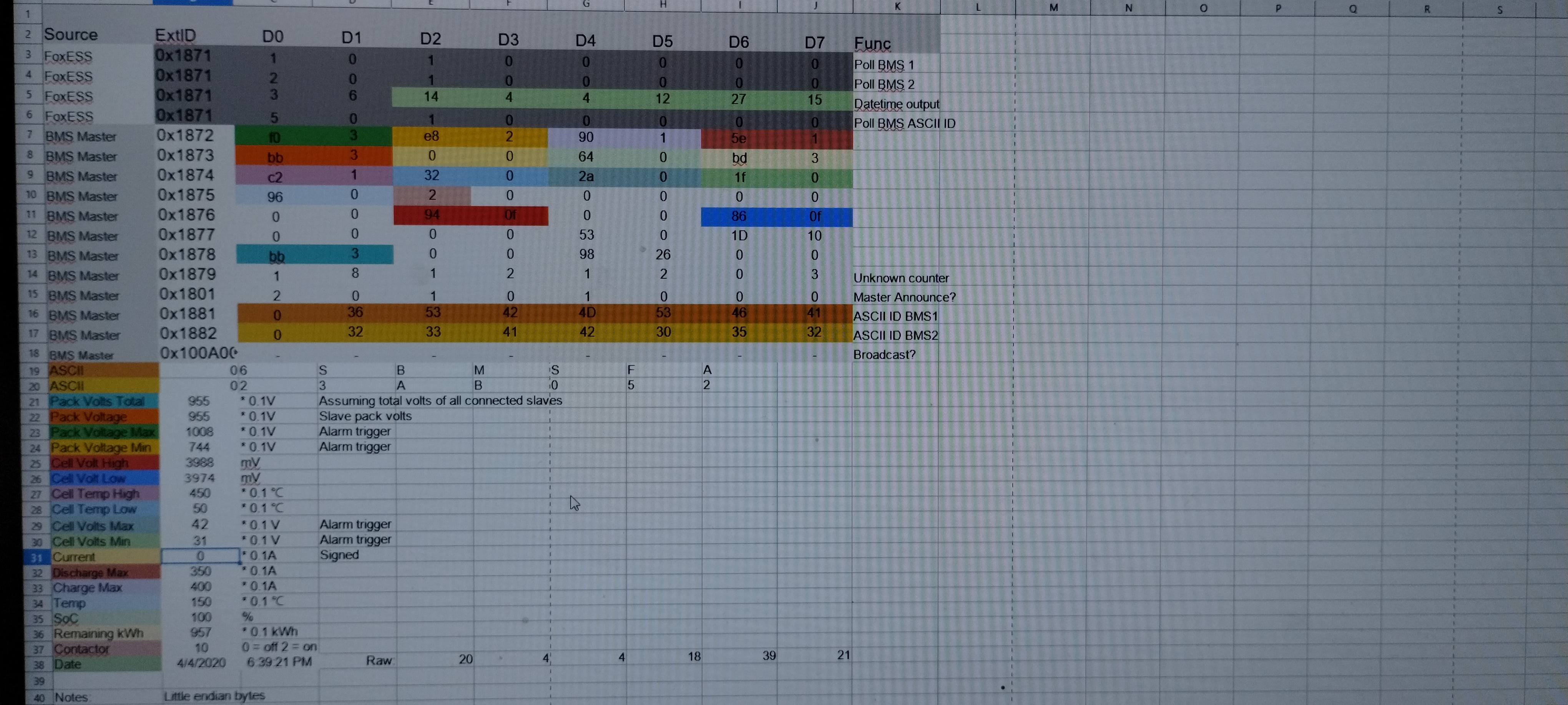

I seem to have a problem the inverter never feed omre than 37w to the load even thou it is reading 700w, I thought it would try and match the load from the batteries so the grid current is roughly 0?
Here is the BMS data
And the results from your excellent spreadsheet
And what the inverter is reporting the battery as
The inverter is set to feed in first, out max power, 0 export to grid but also tried upping this and made no change
And suggestions please 😃

What is your grid load like? Are you drawing from the grid? Where is your CT clamp?

Drop your remaining_kWh, * 0.1 should suffice. I assume you don't have 95.7kWh installed.
Set pack_volts_min to 860 (86.0V) and see what happens. I think the minimum spec is 85V (?)
Other than that I would double check your CT setup. If that reading is wrong the inverter won't do anything. It should be on CT1 and it should rapidly monitor the actual load on that circuit.

Thankyou for your suggestions, in trying to get the BMS working, I did a factory reset the other day and forgot to re-enable the CT clamp, doh.
As far as I can tell it is working, supplying the garage from the batteries so 0w from the grid are now being consumed.
Thank you for taking the time to reply and helping me, if there is anything I can do or test please let me know and I will do what I can to help.
