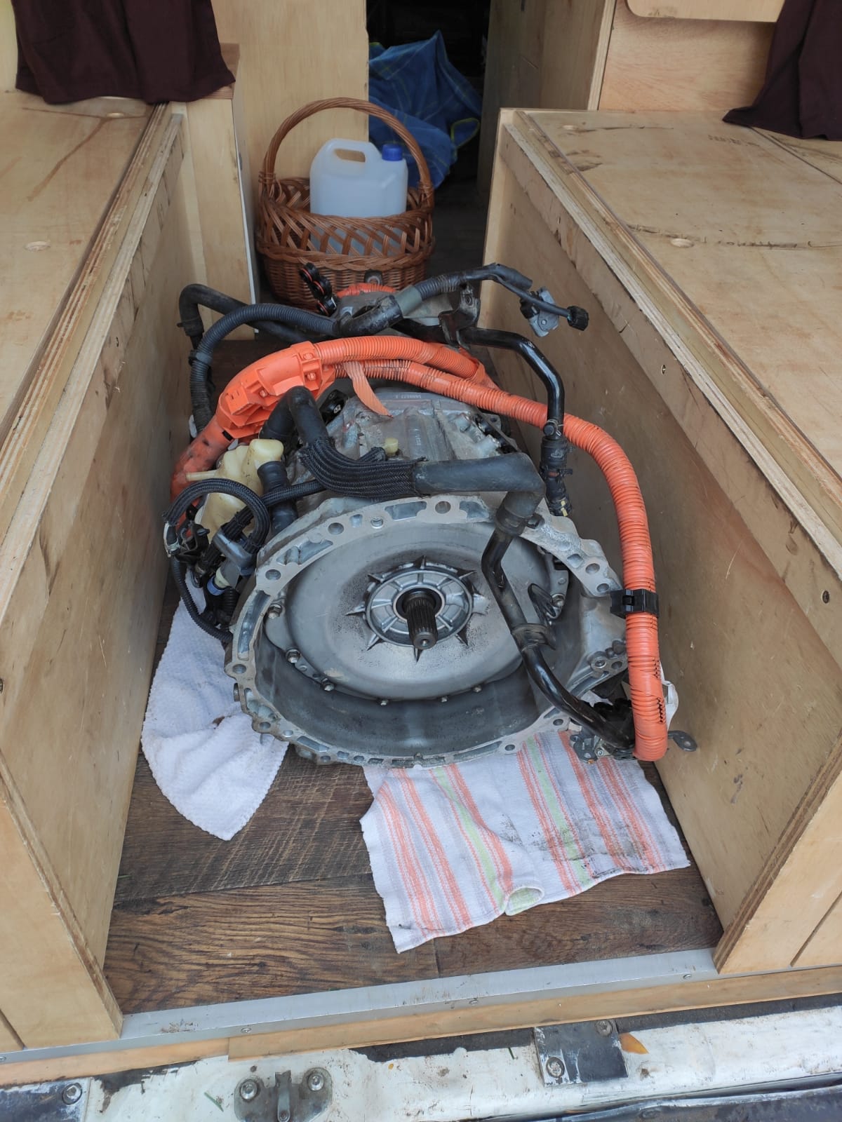

Getting ready, I have bought the gearbox/motor, now will focus on inverter and there I have soooo many doubts. Will see if anyone will reply about which kind of inverter are under Zombiverter code for this engine. Happy Christmas !!!
Posts: 1786
Has thanked: 83 times
Been thanked: 431 times
Re: Jaguar XJ6 V12 will be electric!!!
That's a gs450h transmission right? You'll want a GS450h inverter to do with it. Pretty standard setup for RWD cars and Zombie will have no problems.

Have you seen Artur's videos?
Posts: 1786
Not sure we have Camry inverters here in the UK, not sure where OP is from, but the plates and vehicles look outside of US, so may not have Camry inverters available. Note the GS450h seems to have have LHD and RHD variants, see wiki.

Hi Bigpie, Yes it's a gs450h, I'm base in Poland. There are a lot of versions of inverters here but among all of them, the one for gs450h (G9200-30030) is the most expensive. I saw the videos of Artur, totally inspiring, I will follow his build. Just need to confirm if Camry or other inverters like gs450h version from 2014 or 15, will work.

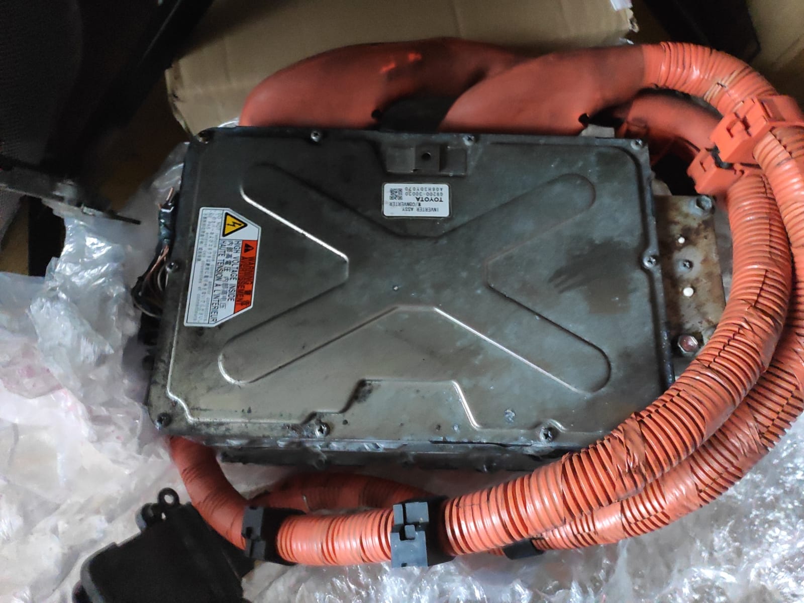

The inverter has arrived, now waiting for the Zombiverter and getting ready to start tinkering. I need to find the batteries; I was thinking about 40-50kWh, but it raises a question. I know the Gs450h can operate from 288V; initially, I was planning to go with 400V to make all components more compatible. However, here's the question: would increasing it to 600V allow me to develop more power? Is there a difference that justifies going from 400V to 600V, for example?
LRBen
Posts: 576
Location: Somerset, UK
Has thanked: 78 times
Been thanked: 230 times
Post by LRBen »
Tachopis wrote: Sun Jan 07, 2024 8:59 pm The inverter has arrived, now waiting for the Zombiverter and getting ready to start tinkering. I need to find the batteries; I was thinking about 40-50kWh, but it raises a question. I know the Gs450h can operate from 288V; initially, I was planning to go with 400V to make all components more compatible. However, here's the question: would increasing it to 600V allow me to develop more power? Is there a difference that justifies going from 400V to 600V, for example?
The increase in voltage does increase the power. But only by increasing the rpm at which the torque starts to drop off. So you wouldn't neccesarily see any increase in power low down. But you would notice it higher up the rev range.

Great for the response LRBen, therefore, it is the increase in RPM between 400v and 600v that I would notice. I have to assess whether this increase is worth the extra configuration and components.

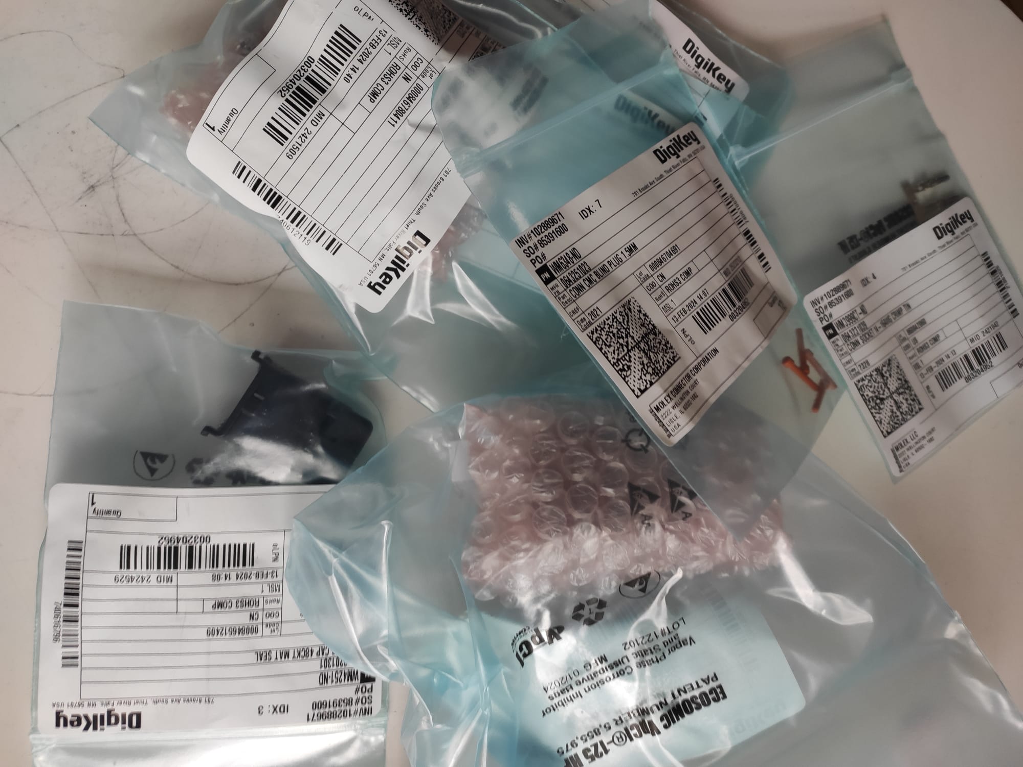

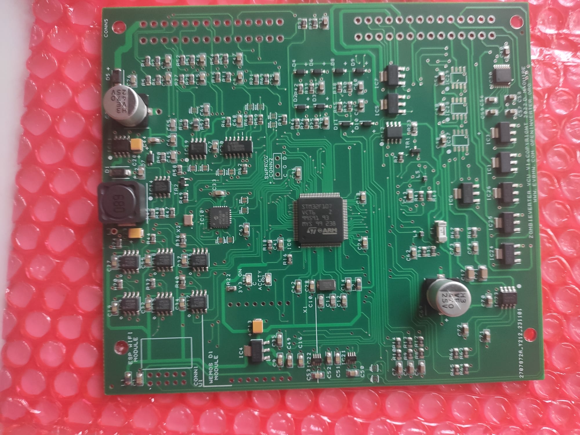

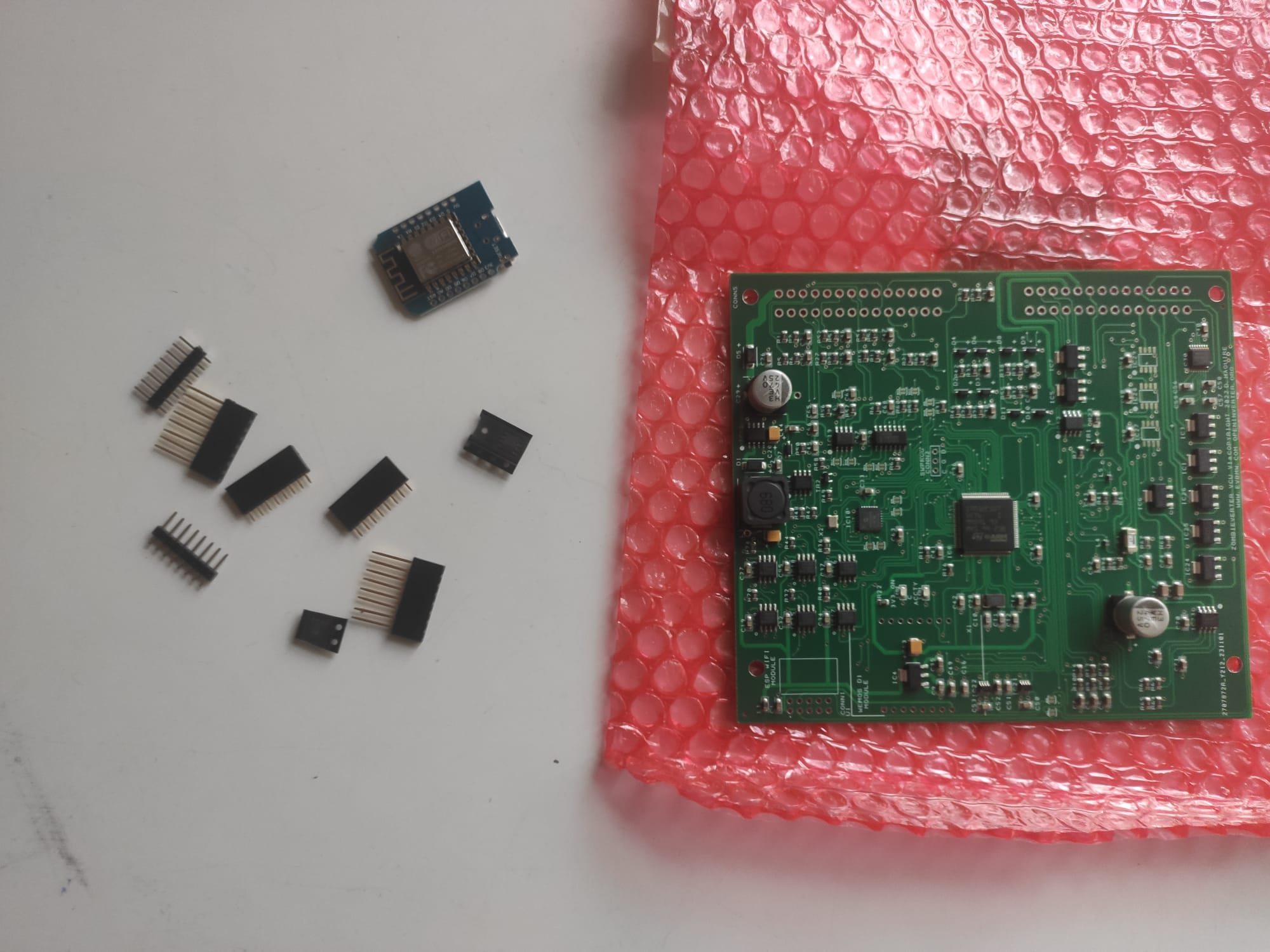

Well well well, look what came yesterday. Now I'm waiting for the connectors to start the wiring. One question I have is if there is a possibility to use the DCDC converter that comes with the Lexus gs45h inverter. If not, I will have to look for an external OEM one. Thanks a million Damian!!! will keep you posted.
Tachopis
Posts: 55
Joined: Mon May 08, 2023 5:35 pm
Has thanked: 5 times
Been thanked: 14 times
Post by Tachopis »
surprise surprise, some connectors arrived too!!!!

Posts: 1786
There's no built in DCDC for 12v within the GS450h inverter
Tachopis
Posts: 55
Post by Tachopis »
Ainsss, I thought so, since it has DC outlets for the heater. I was saying that I was finding it difficult to find information ;) . Thanks for the info.
